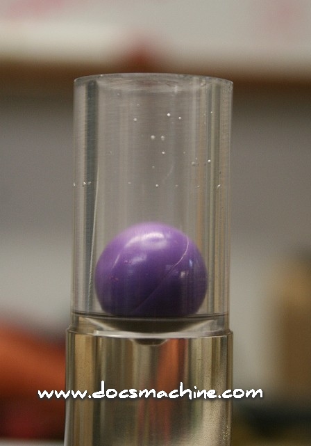

Mcmaster has both the acrylic and polycarb tube; so sourcing material wouldn't be a problem. this would be more of a wall hanger than a playing marker, but I would want to use it at least a few times for fun.
Here's a short barrel doc's machine did, that's basically what I'm going for, but over 8-10 inches.
From the thread, he used acrylic, slow lathe speeds, and sharp tools and that worked. For the polish he used a "block of white rouge and a new polishing wheel."
