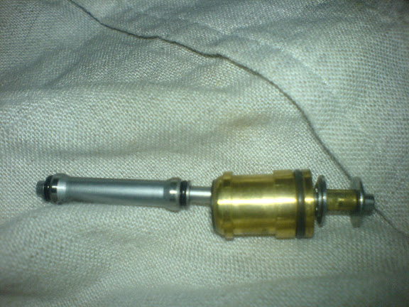

Hey Gumby,
This guy has a serial number of A10170. Can you tell me if it's an AT85 or a TS1 ?
I'm just wondering if I need to get the internals updated to the newer HPA setup.
Thanks

That serial number puts it right in the change-over. It may have the updated parts, plus there is the chance they sent it in for repairs/upgrades after it was made. There are a couple of fast ways to check the level. First way is to remove the housing from the receiver and look at the top of the cycle/spool/3-way valve. If it is a one piece stainless spool it's the new one, if it's brass it's the older style.

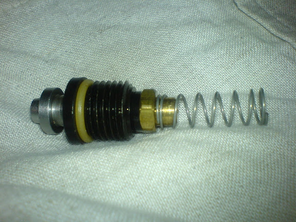

Finally got a chance to dig into this marker and it looks like it may be the old style CO2 setup.
Are there any other ways to tell if it's been upgraded has been done on it? I don't see any marks near the serial number.
Thanks.

Old style cycle valve, new style main valve. Look in the ASA. If there is a brass filter then it is set-up for CO2. No filter does not 100% mean it is HPA but better than average chances.
