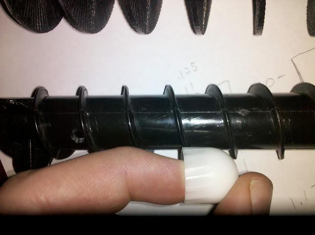

So I sat down, took some FS rounds, and a Q-loader... I decided that I was just going to find the big problem with using the latter to feed the former, redesign one part, and then make it work.
I ended up redesigning the center screw. I made the threads a lot larger, so that they will support the entire fin section, to keep it from cocking while feeding. I also changed the threads per inch, so that an entire FS round will fit between the threads. And I changed the minor diameter, so that the number of rounds being indexed would match the threads on the inner body tube. (I wish I knew Q-pod nomenclature better.)

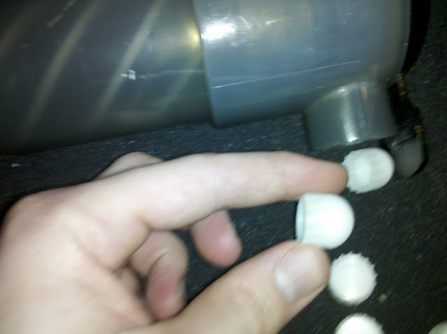

Here's some sample rounds hand fed into the subassembly, to prove it doesn't bind up anywhere.

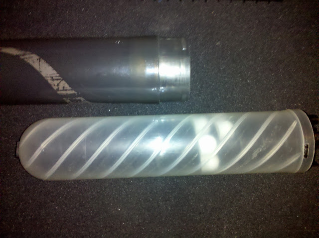

After assembly and ejecting them. I kinda forget that putting the receiver on makes them shoot out.

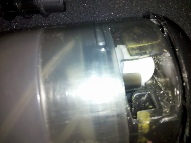

The receiver had to be dremmeled square. And so did the cap on the pod.
Capacity is down to 80 rounds. But FS rounds are sold in tubes of, 8, so you're golden.

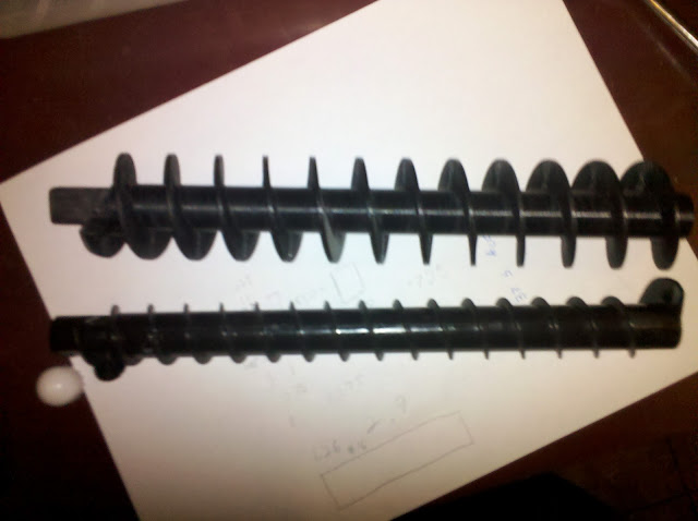

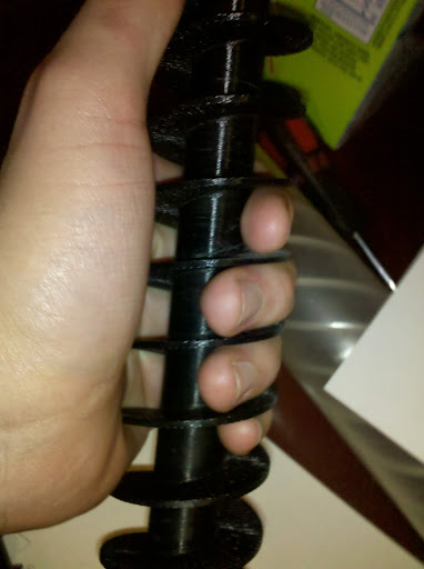

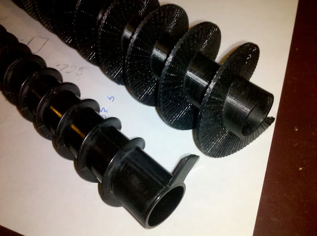

Here's the internals. Sorry for the delay, I had to do some disassembly on the pod. And I had some nelson stuff that needed cleared off my work space first.
Top is new part. Bottom is old part. Left bottom is FS round. Ignore the drawings on the paper. They're not relevant to this project.
Top is new part. Bottom is old part. The texture is the resolution of the manufacturing process. It will need sanded out before the production version gets made. The texture doesn't slow or obstruct feeding in the prototype.

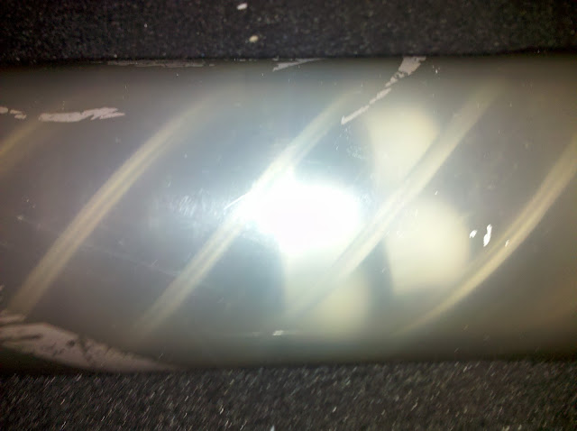

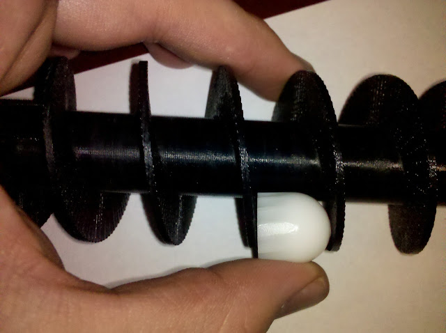

This is how the old auger handled the FS round...
This is how the new auger handles the FS round.
A real man's threads!
