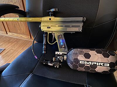

    Morbox is a good name for a Morlock'ed shoebox right?
    Still working on it but I want this
    To be like my old IR3, but you know shoeboxy and I am getting there
    With any luck, I can get the timing on it to where I can use a Reloader B without eyes or detents, if not there is going to be a fair bit more customizations. This board so far, has been super easy to work with too. Easy to locate the components, the battery is the perfect size to fit in this Angel A4 frame too. Doing a bit of modification to make the trigger work for me, obviously I won't have the wheels to dial in the trigger that the A4 has. I could use some sort of plate in the tray with setscrews to push on the trigger pins, but that would be super hard to adjust. I figure if it is going to be hard to adjust, I might as well just cut them down with a file till I have them where I want them at least that way it can't come out of adjustment.
    Right now I have a Cherry MX blue as the trigger switch, I might switch to something like a Cherry black or a proper roller microswitch, but it has enough force to not need a spring which is important because I don't really know where I would locate one.
    I think the hardest part is going to be just making the frame fit, and figure out how I want to do the mounting for the frame. I can hack it up a bit, I plan on either Duracoating it or Cerakoating it because I think I want to do a WWI white and black Dazzle camo scheme and Anno just doesn't do white well. The Dazzle camo is appropriate because I want people to know I am using a big obsolete ship that may have lost it's technological advantage but the main batteries are still mighty impressive.
    Anyone have tips on adapting an Angel frame to a Shocker? I know it used to be done alot, should I use a plate to adapt it, or drill and tap the tray? Will the front grip still fit okay since the grip frame won't reach that far?
  • Euphie
    • Jul 2021
    • 291
    This is the I stayed up all night watching youtube and building a gun update:
    It was surprisingly easy to adapt the frame, so for anyone who wants to do this here is what I did:
    1. Line up the rear screw on both the tray and the grip frame.
    2. Drill out the rear frame screw to make it large enough to accept the proper size of screw (I didn't have a drill on hand, I used a file to widen it)
    3. Use a file or a mill to flatten out the area for the rear screw, it is much larger than the original one and will set at an angle if you don't flatten it out.
    4. Line up the front grip screw with the trigger slot in the grip.
    5. Pass a screw up through this slot and put a nut on it
    6. line up one of the edges of the nut with the edge of the area that the circuit board rests on top of, use a bit of loctite and screw the screw in.
    7. Put a tiny little piece of aluminum with a hole in it in the slot that is milled into the vertical maxflo. so that it can't rotate without pushing on the front of the angel frame
    8. inset the tray to body screw then screw in the vertical maxflo adapter, it will prevent the tray screw from coming out. I also put a dab of blue loctite here as it isn't as strong as having the two screw holding it on as it now only has one and a plate to push against the grips.
    Took me a bit to do all of the filing, because it was late at night and I didn't want to wake anyone up, but pretty sure you could bang this out in 10 minutes with a dremel.
    Now, I have to finish the electronics, this is what was in it.
    That's right, the original owner took a bunch of those little non-rechargeable lithium camera batteries and created a modern day Smart Parts battery pack. Pretty sure no Shocker has ever been hurt by 9v, so this is an impressive level of dedication. It trips the noids just fine so it still has a charge, I guess those batteries do last a really long time.

            So I hit a snag, I just can't make the morlock make the solenoids click. The multimeter says voltage is going to them, and curiously if I have the morlock plugged up to the PC it will like half cycle only the 4000 solenoid, I can't make it do anything to the 3000 solenoid it seems. Any ideas? I am at a loss as the multimeter spikes up on the shot it is clearly doing something.
            I Figure the next thing to check is perhaps try it with a 9v? I tried adjusting the voltage in software and it didn't seem to make a difference and the second I unplugged it from the PC and it's 5v source is gone it no longer even half cycles the solenoid so to me it seems like it isn't getting enough power.
            • Euphie
              Euphie commented
              Also to note, I can manually press the button on the solenoids and they will cycle pneumatically, so the trouble has to be electrical in nature, and right before I connected the Morlock the DS board made the solenoids make a nice click when the trigger was pressed.
          • Brokeass_baller
            Pick it up!
            • 1129
            • Ohio
            What are the voltage requirements of the solenoids, and what's the voltage output of the board? Furthermore, can you adjust the board output voltage?
            I'm not an electronics guy, but I am very familiar with electricity in general.
            • Euphie
              Euphie commented
              I believe they only need 5vdc, and you should be able to adjust the board between like 3.7 and 20vdc but, it doesn't seem to change the way the solenoid acts, the only thing that seems to change it is if it is plugged up or not. I suspect either I am doing something wrong, Or I have something wired wrong, but I don't think I can even. I don't think the trigger switch (which appears to work fine) or the solenoids have polarity, but I have tried swapping them around just to check and it didn't change the way it behaves.
              I am no expert, but the change in behavior when plugged up makes me think a voltage regulator is bad. It is hard to get a read on the exact voltage out in the multimeter because it is just a pulse, but the needle clearly jumps on the solenoid output pins, how much though it is hard to say, I bet a digital one would make this easier to diagnose.
              I did install the capacitor included in the kit to see if that would help but, it also lead to no change.
          • Euphie
            • Jul 2021
            • 291
            Confirming, yes when I bypass the battery and hook up a 9v, I get a nice positive click from the solenoids again. Whatever the board uses to step up the voltage from the rechargeable to whatever you set it to is either broken, I was using it wrong, or I misunderstood and the source voltage always has to be higher than the output voltage and it can only regulate it down perhaps?
