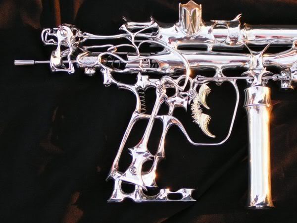

      I mean if you're going to hack it up then hack it all the way up. Exposed linkage arm, second cocking slot on the right hand side, DIY shark fins (less good on these newer ones where they moved the logos around), the slice it in half across the trigger guard screw quick strip mod....
      There's so many choices for a beater 98c

      Edit: If you're going for it anyway...
      • Myrkul
        Myrkul commented
        That's kind of what I was thinking. It's getting hacked, might as well go all the way with it. I'm not confident I can do shark gills or a second cocking slot with just hand tools, but might as well go all out since we are already there. It'll most likely get the quick strip mod too.
