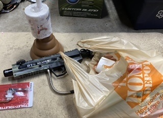

    After trying to find a neglected and abuse gun locally and striking out, I’ve turned my attention to my old BT-4. Used to have a marijuana camo job, but took a grinder to it so I could could lend it to my cousin’s 12 year old. Since it needs a nee paint job anyways, might as well use it for the build!
    Click image for larger version  Name:	3410F753-AACB-407E-9B8C-2CC1DA6371A8.jpeg Views:	1 Size:	33.0 KB ID:	52845
    Got most my supplies ready and a theme in mind! Just need spare time. (End of original first post)
    COST UPDATE:
    Squatty Potty Poop Emoji Plunger - $17.94
    Moen Toilet Tank Lever - $11.20
    Tremclad Flat White Spray Paint - $8.97
    EZ Strip Paint & Varnish Stripper - $15.97
    Sparkle Spray Paint $13.97 (didn't end up using)
    Star Wars Plush Storm Trooper Squeaky Dog Toy $11.99
    Total Spent: $80.04 CAD or $62.39 USD plus taxes.
    But if my wife asks about $25.....

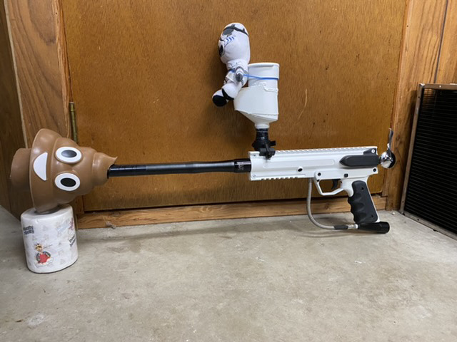

    Final Product: Bolt Action Storm Pooper. Be sure to read through my entire thread to learn the exciting origin of this gun! Origin story starts at post 20.
    Click image for larger version  Name:	C33C6B16-6E04-44DB-BAF2-58873DFB1E22.jpeg Views:	0 Size:	111.1 KB ID:	85295

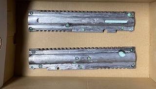

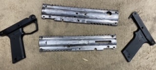

    Paint is coming off now, so soon I will get to learn to paint a paintball gun. And as an added bonus my six year old daughter has taken great interest in this build (kids love poop!) so she’ll be my assistant and artistic advisor for this built.

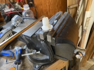

              • 4559

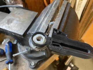

              Just cut off the plastic collar and the metal rod, make sure The cut is low enough not to interfere with the cocking action.

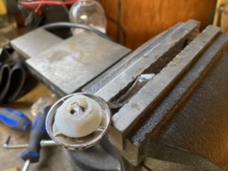

              and double check it fits with my Rocket Cock. Looks good! Now just need make sure everything fits securely.

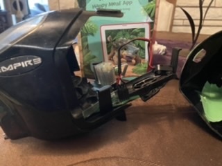

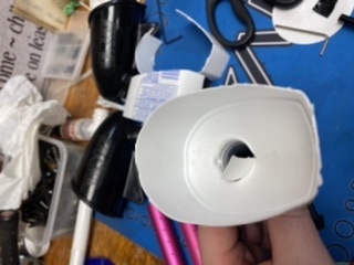

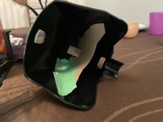

                As I jump around on this build more than Kris Kross I’ve now moved into working on my hopper for the build. I have planned on using an Empire Magna I received in a deal, and after finally getting around to test it realize it’s missing the floor panel that goes in the nose of the hopper. Sort of lame compared but whatever, I’m up for a challenge. The hopper works at least
                Well, I haven’t got a lot of material to work with, but the kids had Happy Meals last night, so there’s some scrap cardboard kicking around. A little bit of cutting and trimming and I manage to make a floor tray. Add a little tape and it’s good to go.
                Ran a speed test and found the hopper just jams as the feedway was integrated into hopper floor. A little more donated Happy Meal box and some experimenting has given me a fully functional hopper now. Feeds well, no jams. Not bad for cardboard and painter’s tape! If I need to I can use plastic from the Barbie toilet to make things a little strong but I’m pleasantly surprised at how well this has worked. Going to need to figure out the logistics of mounting the toilet into the hopper next. A little worried about the height of things....

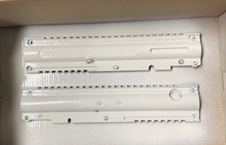

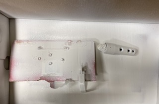

                  Paint Time!
                  Before:
                  Click image for larger version  Name:	3F5DC195-4D28-4B77-A786-C27B92EE1DB4.jpeg Views:	286 Size:	22.0 KB ID:	56351
                  After:
                  Click image for larger version  Name:	0B588AA1-960B-4DB1-8A26-D80FDFA16472.jpeg Views:	280 Size:	18.6 KB ID:	56352
                  Well, likely not the best paint job ever, but that was pretty easy! First coat is on and to quote Kid Rock: “I’m going paint his town and and paint his gun white!”
                  I’ve also conclude that the Empire Magna isn’t going to work. Just way too big when the prop is mounted to the top. So that means I’m building a custom hopper now too!
                  Click image for larger version  Name:	08399A41-1F5D-4E1C-AB6A-A44EDC746B77.jpeg Views:	277 Size:	22.0 KB ID:	56353

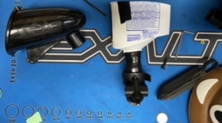

                  Using the black pocket hopper as my template I’ve turning my prop into a hopper. I’ve elongated and reinforced the feedneck using a 10 round tube. Need to have a decent balls stack. With a little thickening of the tube it now sits nicely in my feedneck. Capacity sits at 40 balls currently, so same as the the pocket hopper. Feeds about as poorly as well, so going to have to get creative on fixing the jamming issues.

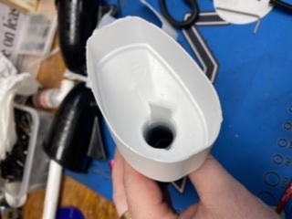

                      It’s Friday night, and I don’t know about the rest of you but tonight I’m going to play with my balls! Have a few minutes to work on my hopper design. Apparently shampoo bottles aren’t tested for their ball dropping ability, so I’m going to have to think of something.
                      So starting with some baseline drop tests, my feed port jams more than a Bob Marley song (we’re jamming, I hope
                      you like jamming too!).
                      First things first, ball stack. These BT aren’t speed demons but it’s still nice to have a decent ball stack to keep things flowing. So this little crapper has a 5 ball stack, before the jammed starts. The bottle also feeds best from the front of the hopper more so than the rear, so so need to keep the balls jamming at the front. My initial test I put a little teepee on the front of the feed, but that jammed it worse than raspberry jam! (Cough, cough Spaceballs reference). So I need to move my de-jammer towards the back of the hopper.
                      And there is what I’ve come up with:
                      Click image for larger version  Name:	B25C8E0E-F6D9-4D87-B879-20E4ADC97710.jpeg Views:	0 Size:	25.2 KB ID:	57981
                      Another shot:
                      Click image for larger version  Name:	1AC11FFB-5246-4A4C-9F8C-19952DF07ED2.jpeg Views:	0 Size:	22.8 KB ID:	57983
                      Yup, it’s just a little strip of plastic wedged into a space between the 10 round tube and bottle’s opening. It prevents balls from jamming the tube and directs balls towards the front of the hopper where it feeds better.

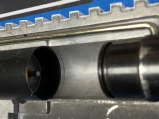

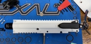

                          Progress! Slowly but surely I’m getting bits and pieces painted. Did some minor internal modifications to see if so can get my desired effect:
                          Removed the hammer oring and added a small oring on the valve pin. I don’t necessarily want to stop air flow, just reduced blowback to essentially make it bolt action. If the o-ring shuffle doesn’t work I’ll with JB weld and sand the pin to drill a dime and go very old school.
