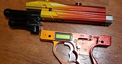

                Here are some pics of the internals:
                Sent from my SM-G950W using Tapatalk
                  • 3414
                  Not sure If I wanna try after seeing your pics, lol. Here is what I got.. A regretful ebay buy. Needs a cupseal return spring, detents, and eye covers that I know of. Not sure that large valve would fit in my frame.
