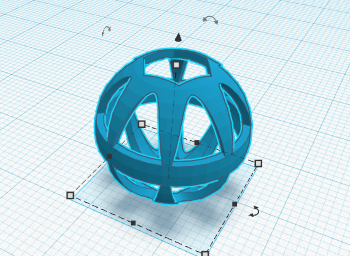

        I'm not waiting! I'll design something tomorrow and print it out, I'll let you guys know how it goes...

          I have some barrels printing on my printer I use for TPU printing. I should have something in hand tomorrow.

            It did not go well! They basically fell apart when I tried taking them off the print bed. I updated the design to make them more hardy, and I am printing again. I may need to switch the print nozzle from .4mm to .2mm for better detail.

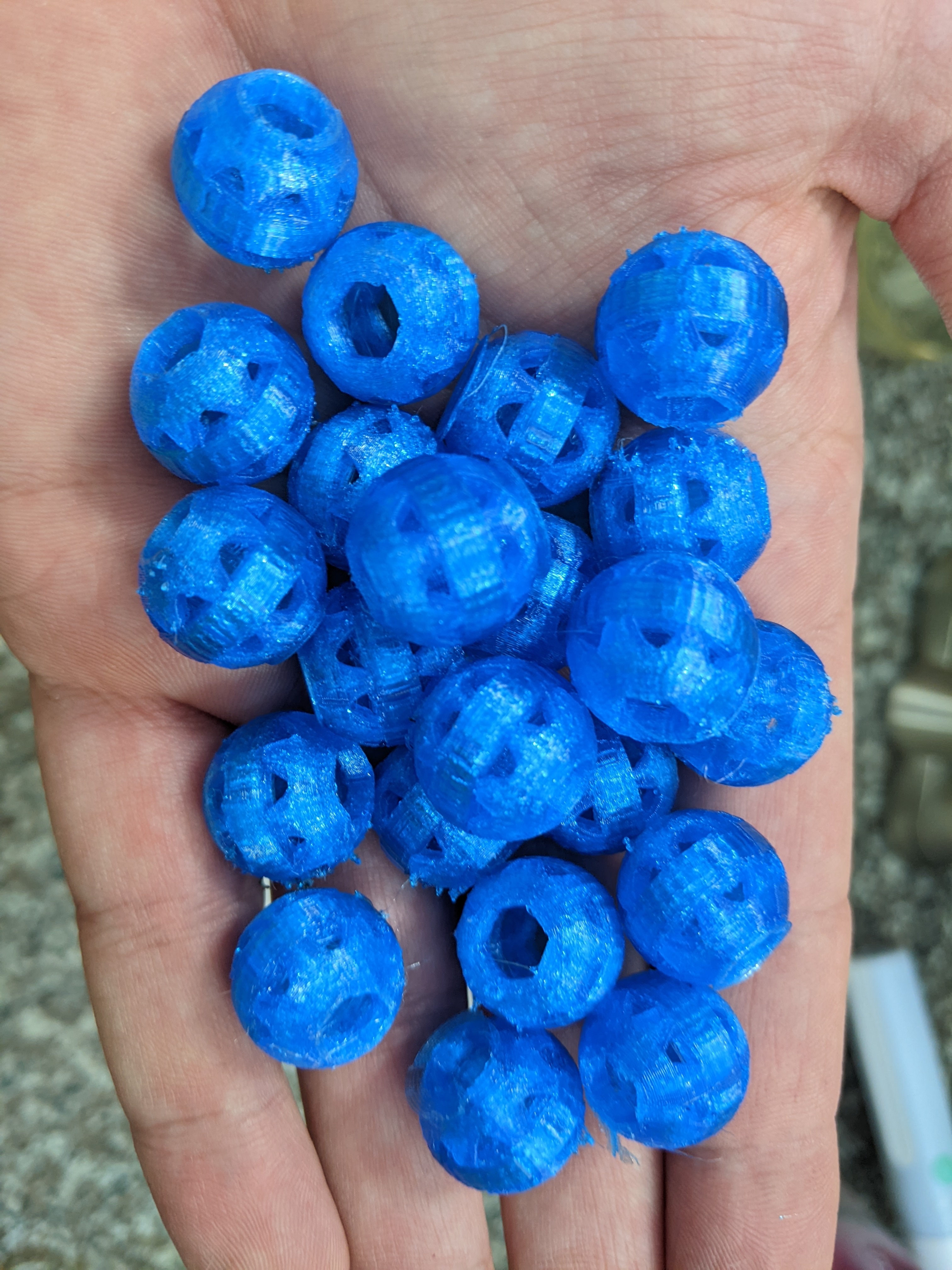

                I just printed some and one worked great. I shot it at cardboard maybe 30 times and it held up just fine. However, I am shooting from a gun that was shooting paint close to 300fps. This pickle ball would go through a cardboard box (just one side) at 10ft, it would dent it at 15ft, and not make any mark at 20. Would a pickleball do the same or would it be less impact?

                nice work. I would prefer that for basement shooting, instead of the reballs.

                  I printed these and they do the trick. My kids and I had some fun shooting cardboard. My wife won't let me have the kids shoot me with it. I'm going to try to make some more that are lighter and more airy, one of the designs that printed well was very light and too airy it wouldn't shoot out of the barrel unless I shot it three times, I think no it let too much air through and not enough to catch it and propel it down the barrel. These seemed to work fine through a rotor, but that wasn't on a marker. we were using a stick feed to shoot.
                    That is awesome. Dang wife for taking all the fun out of letting kids shoot you.
                    Did you just TPU?
                    Thank you so very much for taking the time for this.

                      Yeah it is just tpu. It took about 5 hours to print 25 of them, two didn't print right, but I have 23 that came out pretty good.
                    Concept to product in no time, nice work shooter311.
