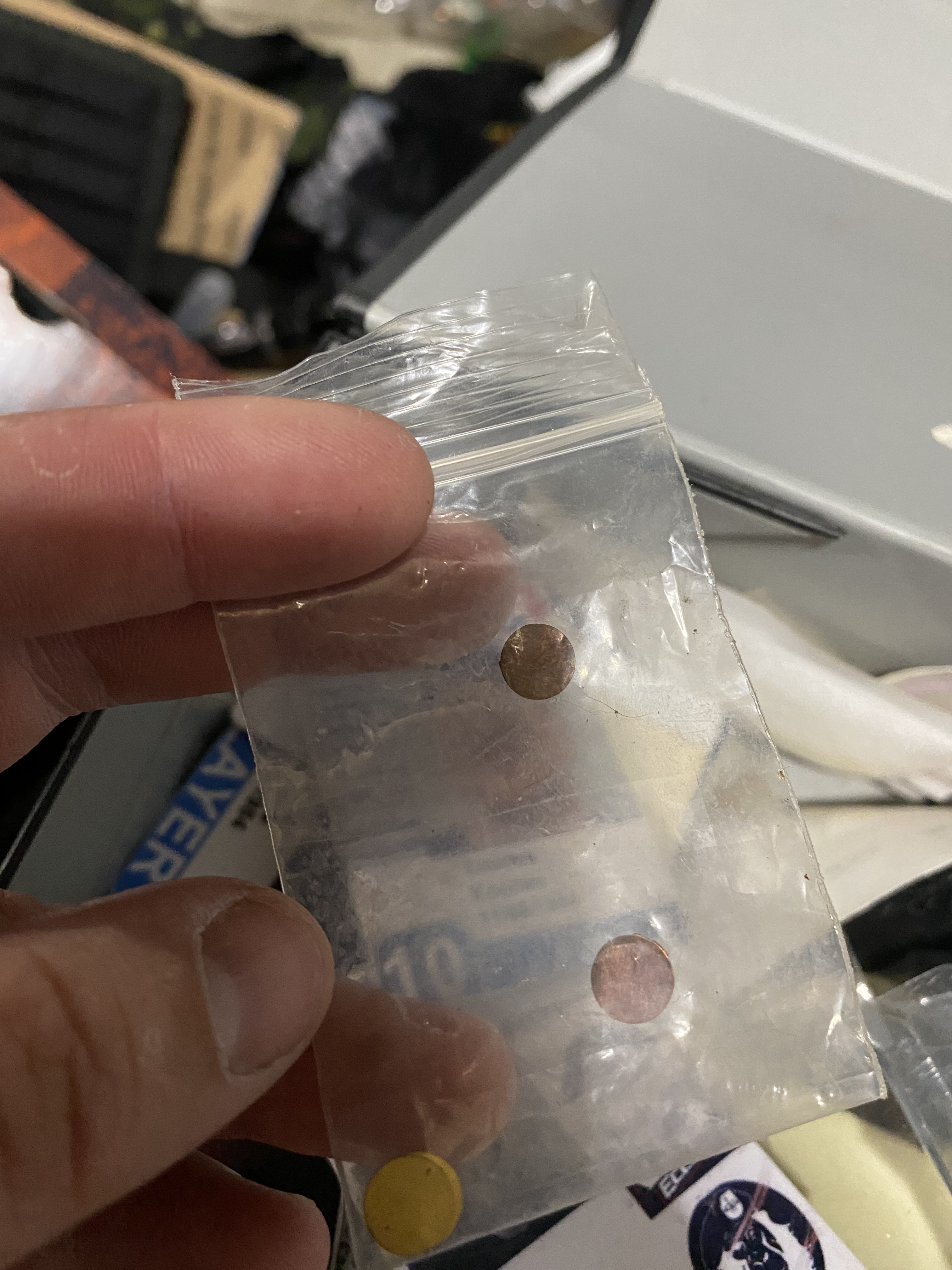

          I think I may have some of those old disks my old CP reg took them and CP gave me a extra bag of them when I had it serviced by them. Let me see if I can find it.
          Edit: this what you are looking for? If so PM me your address. I got two of each I will send you.
            Ducks: Those discs should be printed with a value- they have ratings just like the Unified ones. Was it a CP inline reg? I can't recall if CP made a tank reg.
            If it was an inline reg disc, it's probably rated for 1800 psi. If it's a tank reg, it's rated for whatever the tank was. (4.5K for a 3K tank, etc.) The Apoc will need a 7K or 7.5K disc.
            Doc.
            Paintball in the Movies!
              This was for a CP bottle reg. So standard 4.5k reg high and low. Not sure if that helps or not.
                If that's the case, they should work just fine. Are they stamped with numbers?

                  Chuck E Ducky
                  commented
                  No one is thicker then the other so that’s the Hp one.
