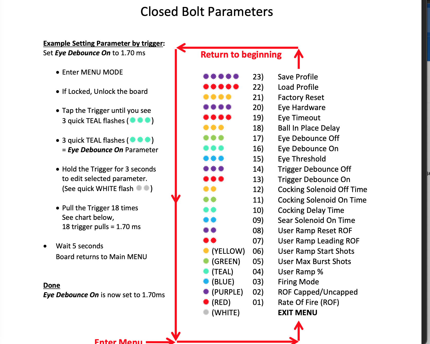

    does anyone know the two solenoid dwell times for a shoebox? and how that relates to pressure?
    I am trying to get the Sci-Fi board setup and it seems the parameter used for the bolt dwell is the cocking solenoid for eblades, which is capped at 60ms, where the min on other aftermarket boards was 70ms.
    When looking at the old Glacier AT board parameters the
    Fire solenoid pulse time: 5ms-15ms
    Bolt solenoid pulse time: 70ms-120ms
    O-scoped my stock board before Morlocking my shoebox. See waveform below, using these settings it shot ropes no issue. 10ms and 44ms.

    Thanks Roger7pball these settings helped
    sear on 10.5ms
    delay 10ms
    cocking solenoid on 44ms
    cocking solenoid off 60ms
    psi @190ish
    shooting 285fps
