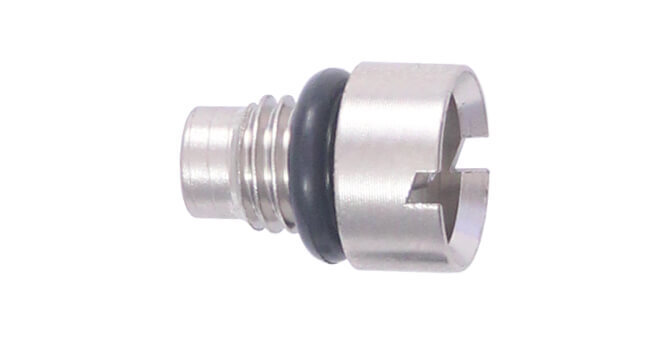

    What tool do I need to use to remove the Puncture pin assembly on a phantom?
    enter over there..☝
    • 4941
    • ....on the 13th floor!
    Just to clarify....Are you needing to remove this?
    Click image for larger version  Name:	Phantom-Puncture-Pin-Assembly.jpg Views:	0 Size:	13.0 KB ID:	448187
    Or the puncture adapter assembly for the bucket changer?

        You can see the notches on the sides. Get a wide enough flathead

      I used my widest flathead and it’s still not wide enough and the tapered edges on my widest flathead make it so the screwdriver doesn’t fit all the way in. I will keep trying different sizes until one fits.

      I do have a specific too designed to remove these. I forget who made it. However the best way is to get a cheap harbor freight wide regulator screw driver and notch the center out with a grinder to clear the piercing pin.

        I just replaced one of these, I used a pair of snap ring pliers
