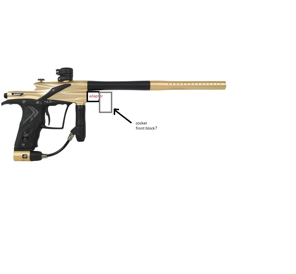

    Has anyone converted an ego to a autococker before? I would like to give it a shot since eteks are gettting pretty cheap because the majority of players seem to be too scared to touch the pre Lv1.6 egos because of noid supply shortages or whatever.
    I was thinking of taking the lpr body out and replacing it with an adapter that has a 2k speck banjo hole in it for the front block (might be able to just use a cocker fb if I get lucky with the alignment).
    Sorry for the poor drawing, I'm no giraffe-ic artist
    edit: forgot to mention my goal is to convert it to a fully mechanical marker. I'm just starting with the front block mount bc that seems like it would be the simplest to start off with
    This is a lot more work than I think you realize
    Mechanical is not an option because you would have no dwell control
    Stock ego board will not work because it cannot run two solenoids, I don't think a cocker board will work due to differences in the planet eclipse solenoid from the autococker clapper, remember right it has a maximum of four milliseconds of dwell for The clapper solenoid
    Universal t board might and I have to stress might work
    Last I heard sci-fi was also working on a universal board but I have not heard anything about capabilities or release date.
    Since the planet eclipse solenoid is a pneumatic design you also have to split the LPR output so you potentially could run into flow rate issues as you are essentially driving two rams now with a fair amount of hose all around

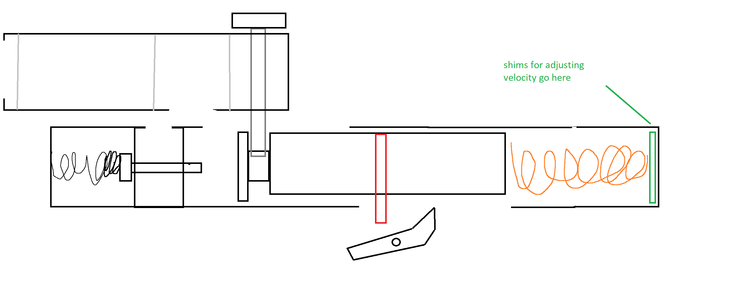

        I should have clarified more, my bad! I am wanting to do something like this with the lower tube.
        edit caught a mistake in my diagram : would need to slot the ram/hammer like you do on a midblock cocker. the hammer would be a modified stock ram

          An Ego ram has so much less mass than a cocker hammer that I think you'd have a hard time achieving usable velocity.
        As stated..... this is going to be a daunting amount of work with basically nothing being bolt on.
        I've got years of experience doing custom paintball stuff , cad/cam software and a CNC at my disposal and even then bailed because the reward was not worth the effort
        God speed fellow tinkerer.

          Ok, much more plausible with a sear
          One question though, why are you connecting the ram and bolt? You would lose the ability to be closed bolt. It would be some weird stacked tube not blowback thing.
          Rattle this around, if you turned down the head of the ram, the bolt pin would push it back but then be free to come forward to then run as closed bolt.
          Ok, new thoughts, I don't think any of these are deal breakers but things that are worth thinking about. I agree with Ecapnation that the reward doesn't really seem to match the level of work required but hey, your project your work so whatever.
          1) I would start by measuring a cocker body that distance between the bottom of the body and the bottom of the lower tube. If you are lucky there is more meat on the ego body and you can simply Mill it flat and figure out your frame screw location and if you are really lucky planet eclipse hasn't changed the frame screw locations for a long time and they might still match up with a cocker frame.
          If none of that ends up being the case you could still potentially Mill the ego flat and create a sandwich piece to go in between the body and frame.
          2) I had number two all written up and then I realized you are essentially going to have to create your own hammer and back cap assembly let me explain. My first concern was that the stock ram would be too light to really do much you would get really low velocity but then I realized there's not enough space behind it to put a spring and adjuster. So if you have to cut down the ram to make that space it's going to become even lighter but I think the solution is that you can cut down the ram sleeve so it essentially is just a valve body that opens up the diameter of the entire back half of the lower tube. You'll need your own back cap or maybe ivg because the stock back cap screws into the ram sleeve
          Honestly at that point it would actually be less work to drill out the entire lower tube to accept standard lower tube internals but that's assuming there's enough space to do that
