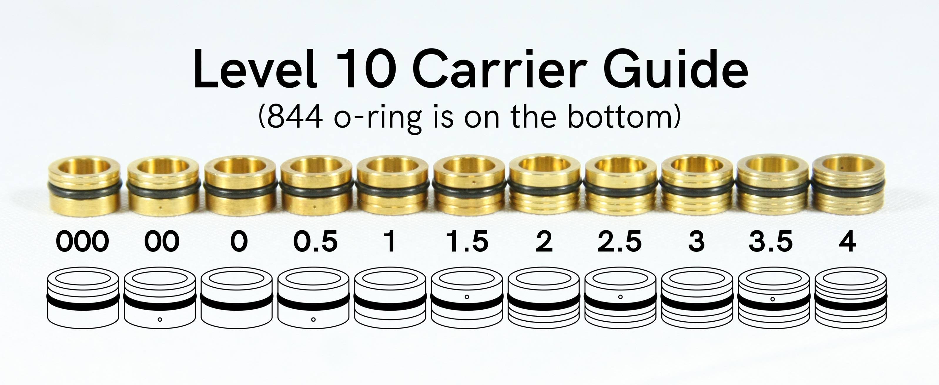

    Make sure you have the sizes correct as the 2 smaller sizes can look like other sizes. Click image for larger version
      One of the first things I did, just in case.
