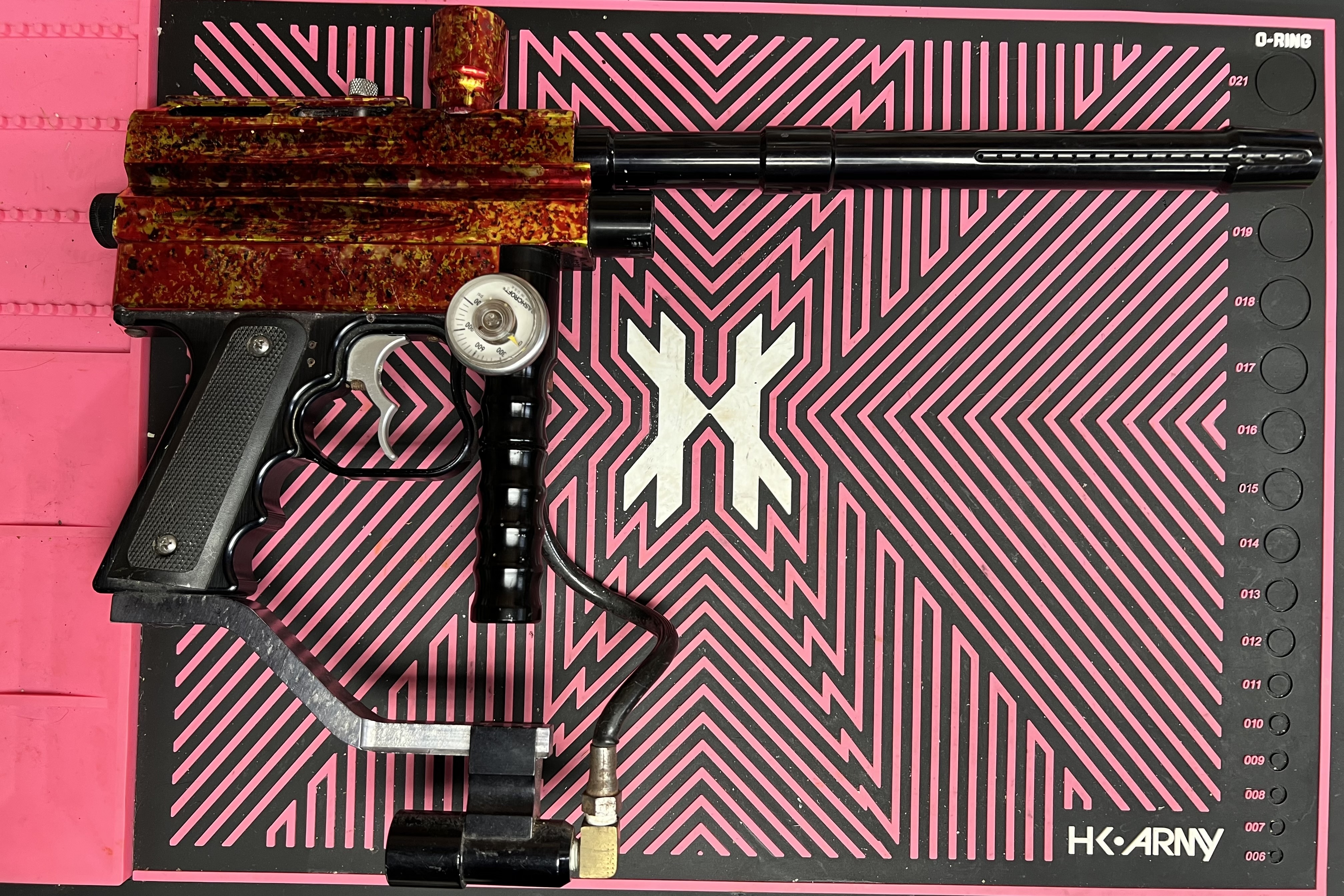

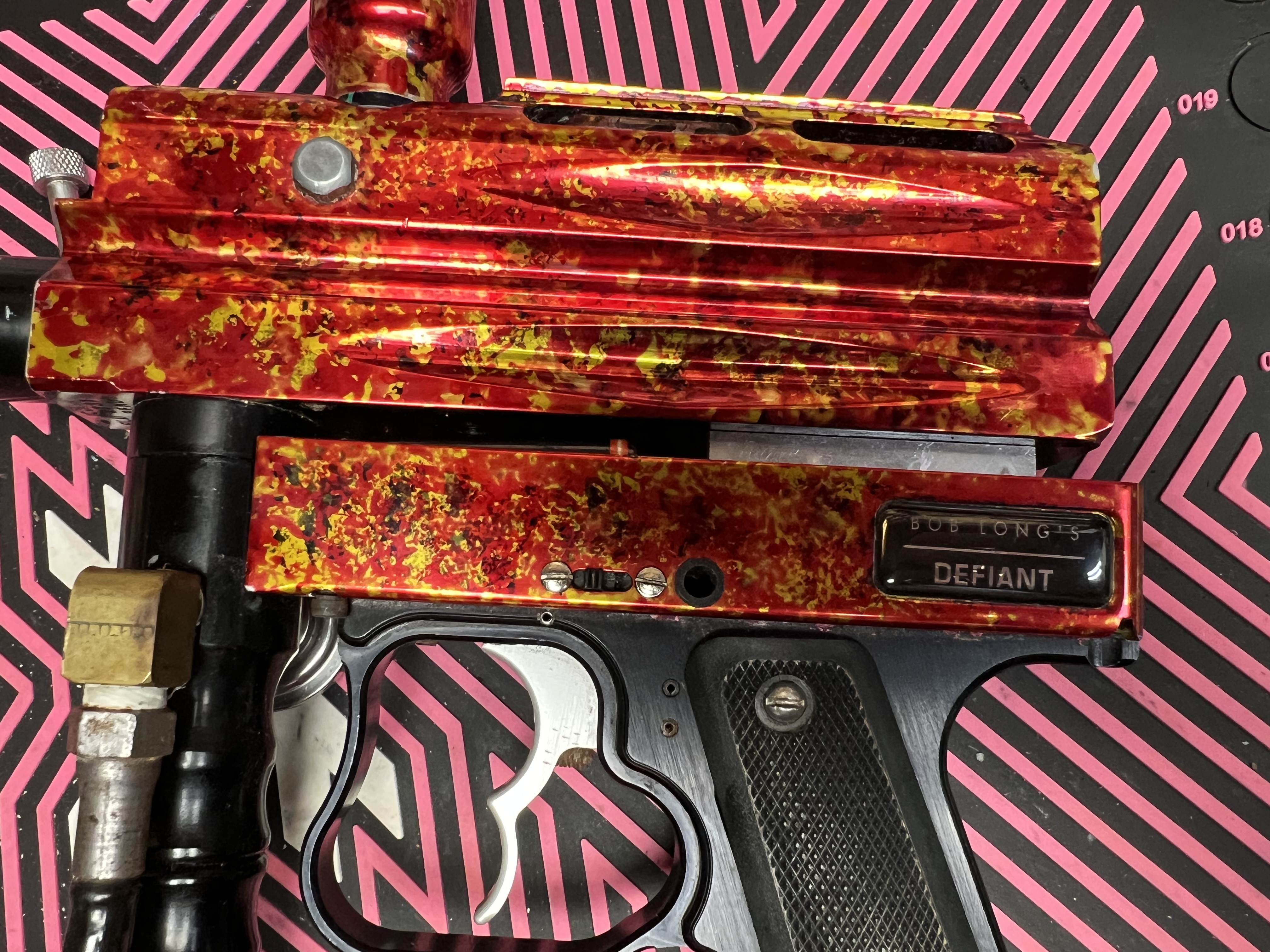

    This has been sitting in my bench for longer than anticipated, but it’s time to see if this old beast and be revived. So we’re got a Bob Long’s Defiant, circa 1999, in Lava anno.

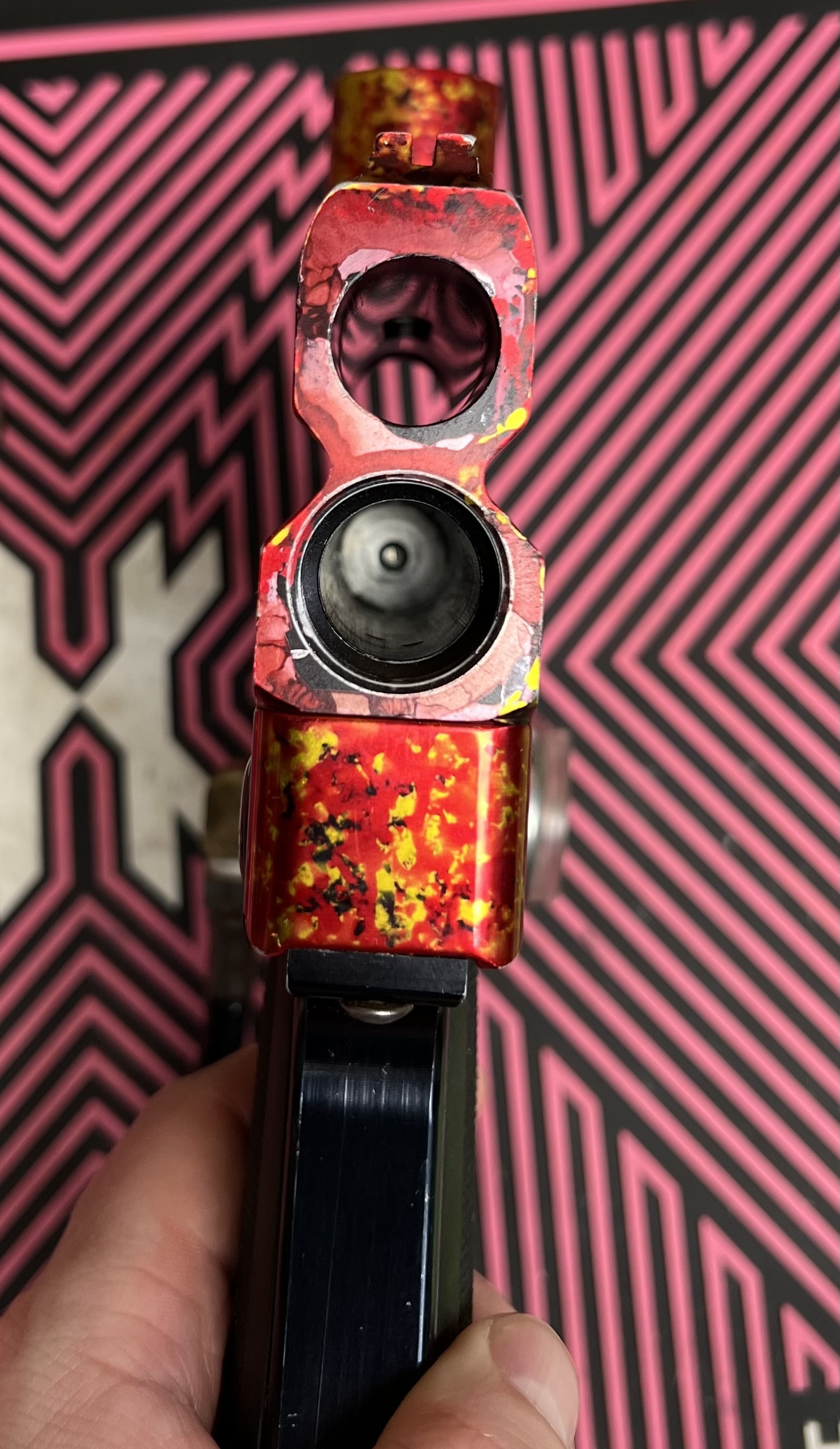

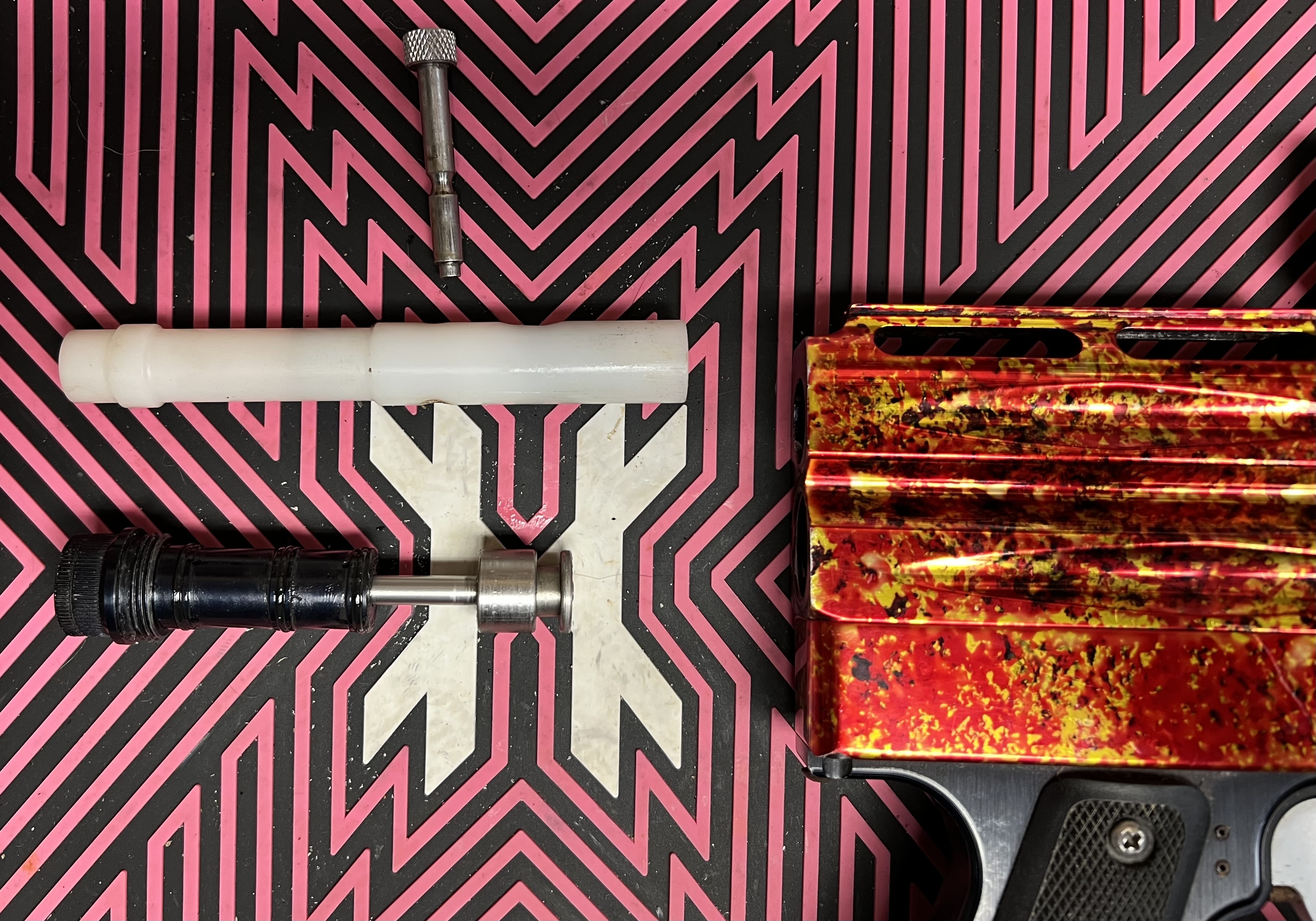

    First the easy stuff! The rear tube easily disassembles by hand, just pull the bolt pin and the assembly slides out.
ID:	673676 Click image for larger version

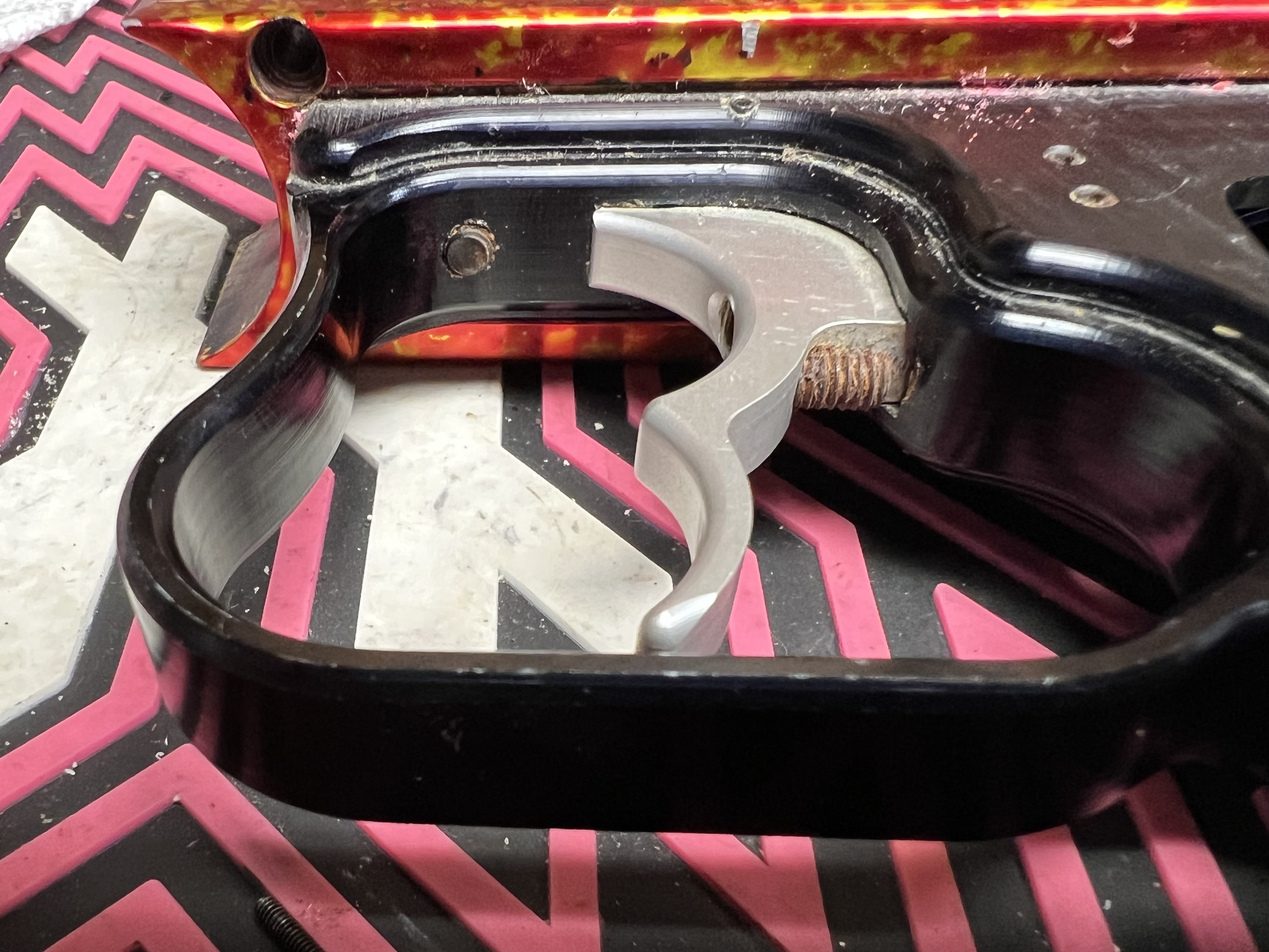

      Next is removing the frame. At first I was worried it may have a broke frame screw, but the front grip frame screw is actually top mounted in the tray.
ID:	673679 Click image for larger version

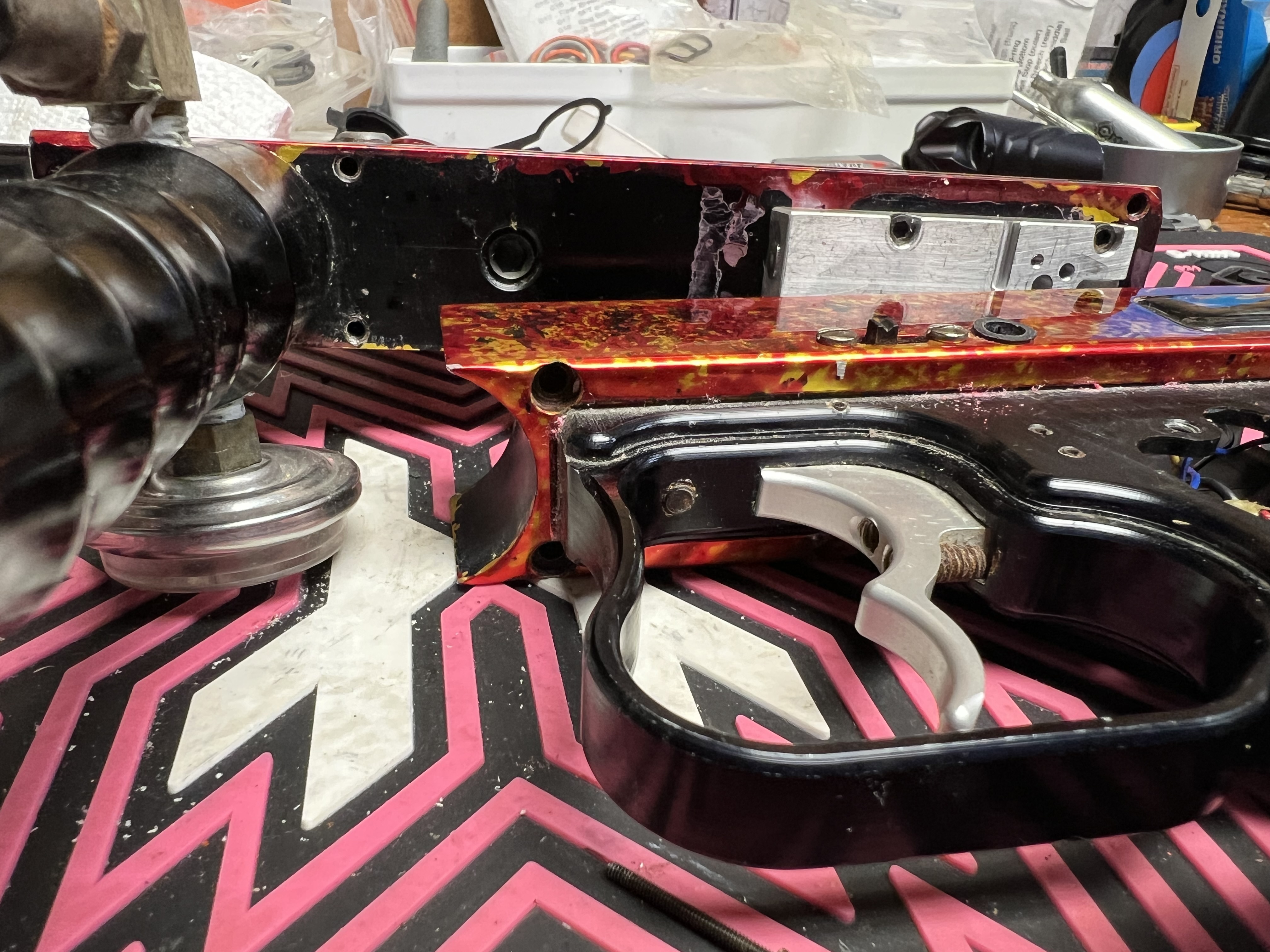

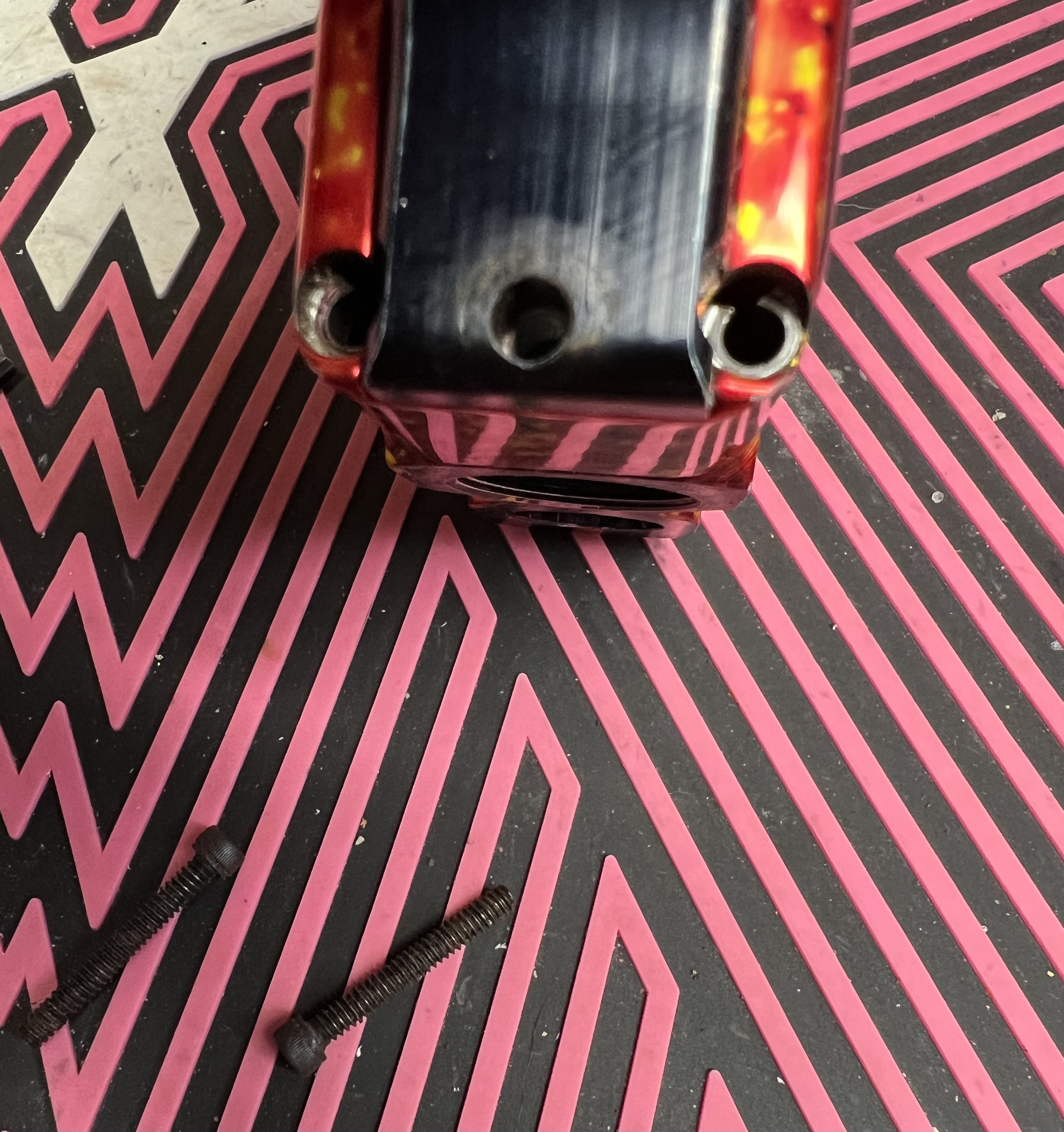

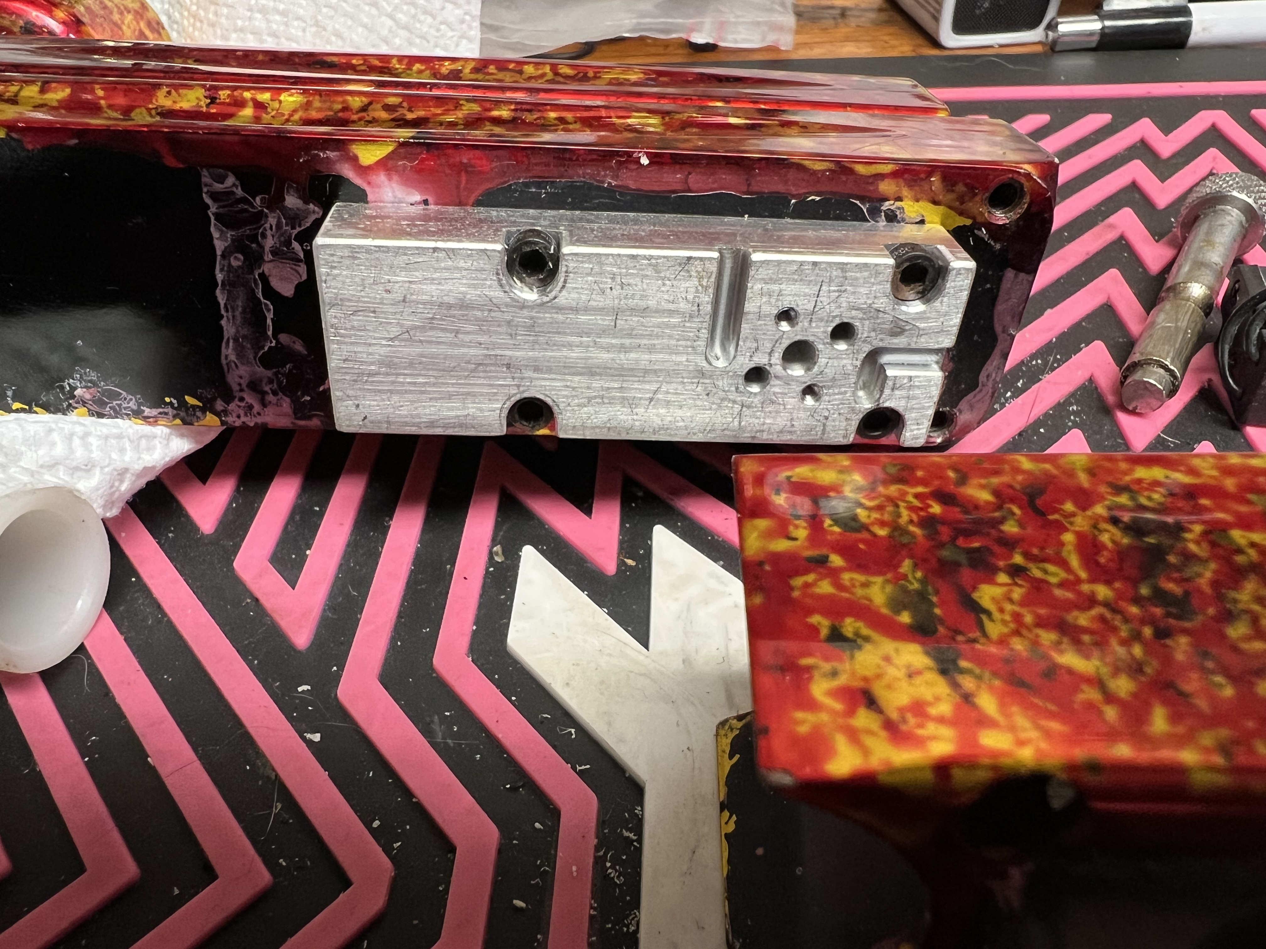

      To remove the trigger frame from the body you need to remove both the tray and the trigger frame by removed the 4 long bolts two of which are located at the rear of the marker and two just behind the front grip.
ID:	673681 Click image for larger version

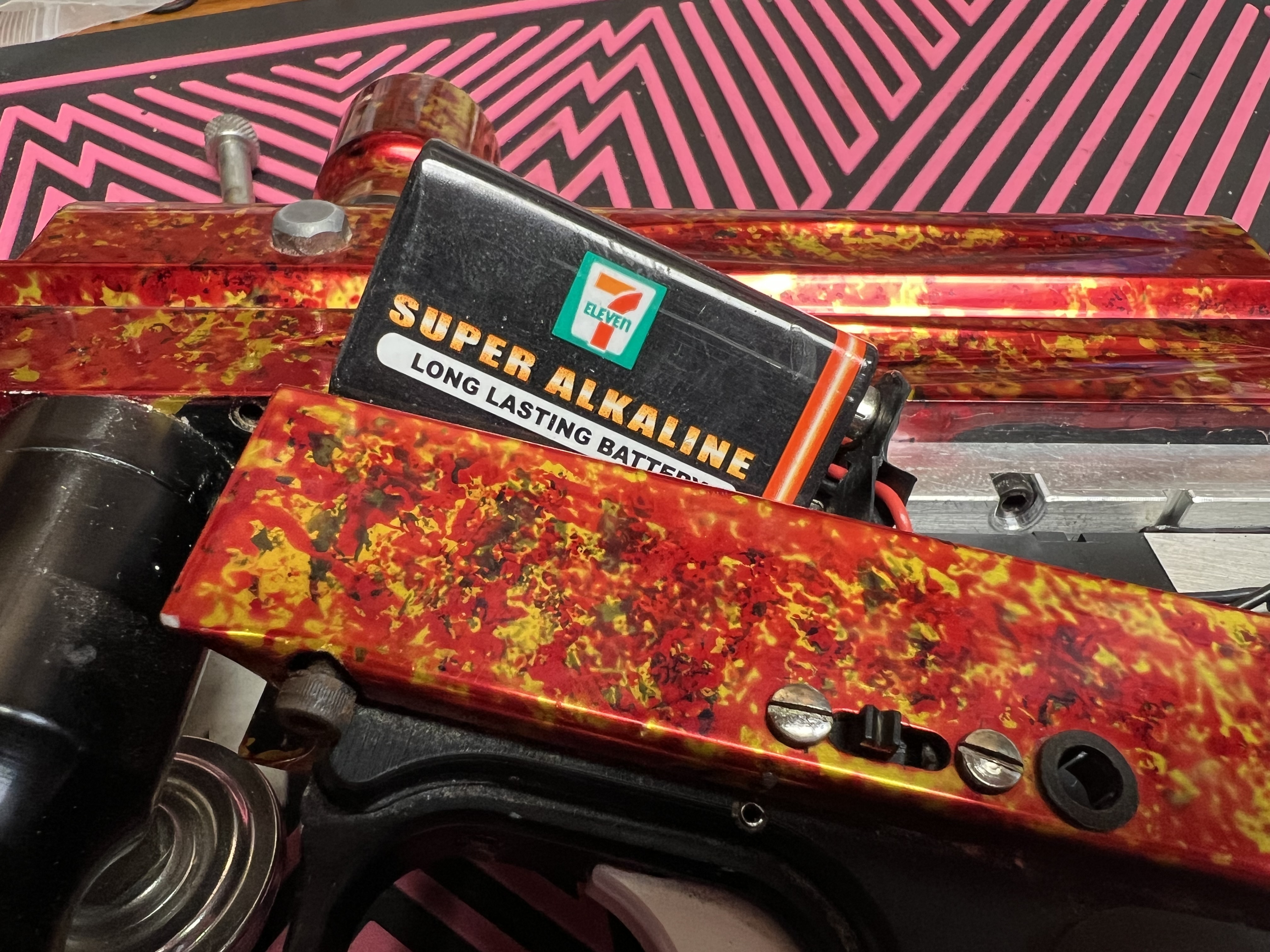

        • 4559

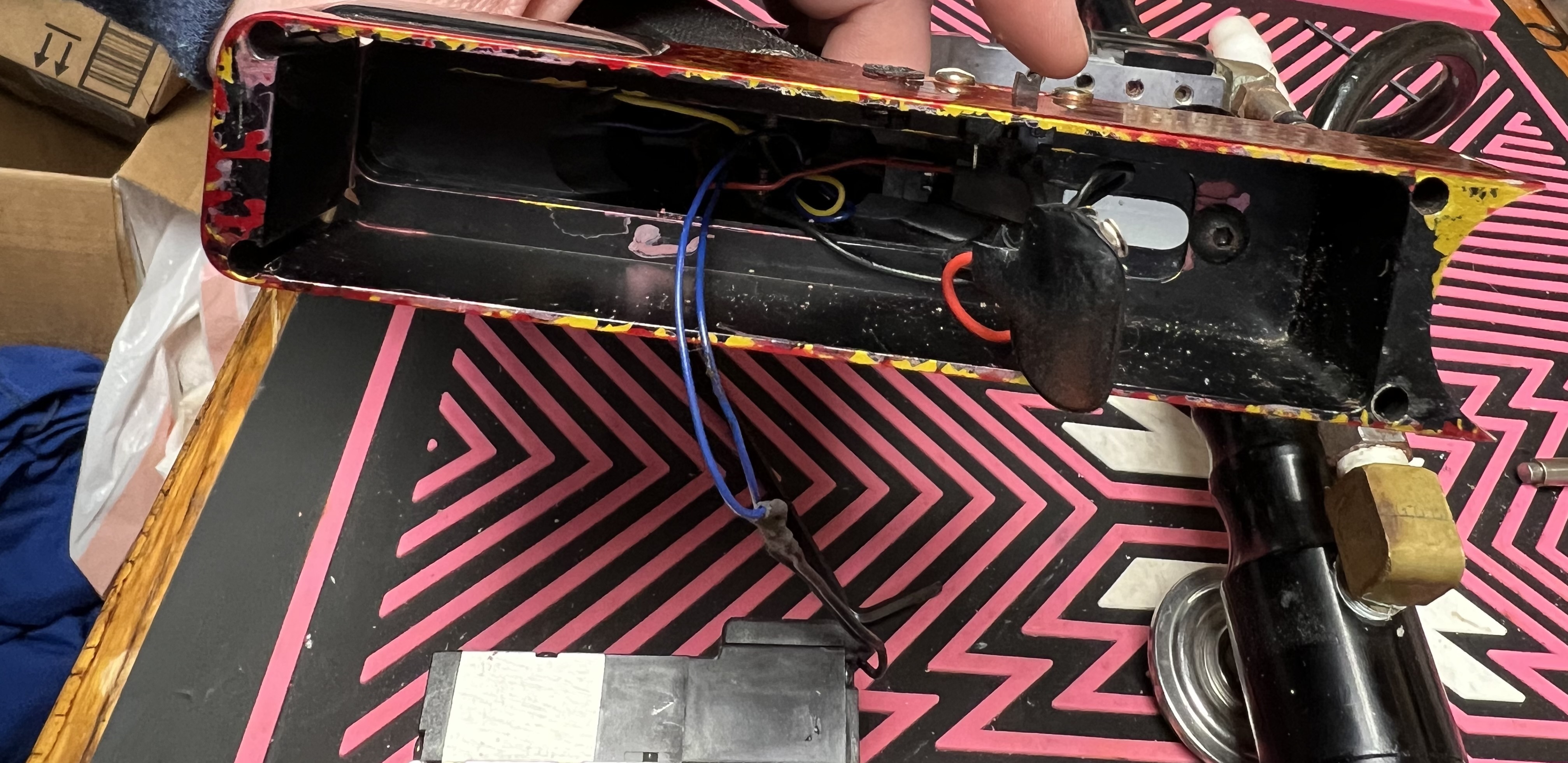

        While separating the tray and trigger frame from the body you can access the battery. It’s alway interesting to see just how old of a battery is in these old markers. Gives you an idea of the last time it was use.
        And here we have a 7-11 special, so someone needed to grab a battery on the way to the field before being able to play.
        And here’s a view of the battery tray:

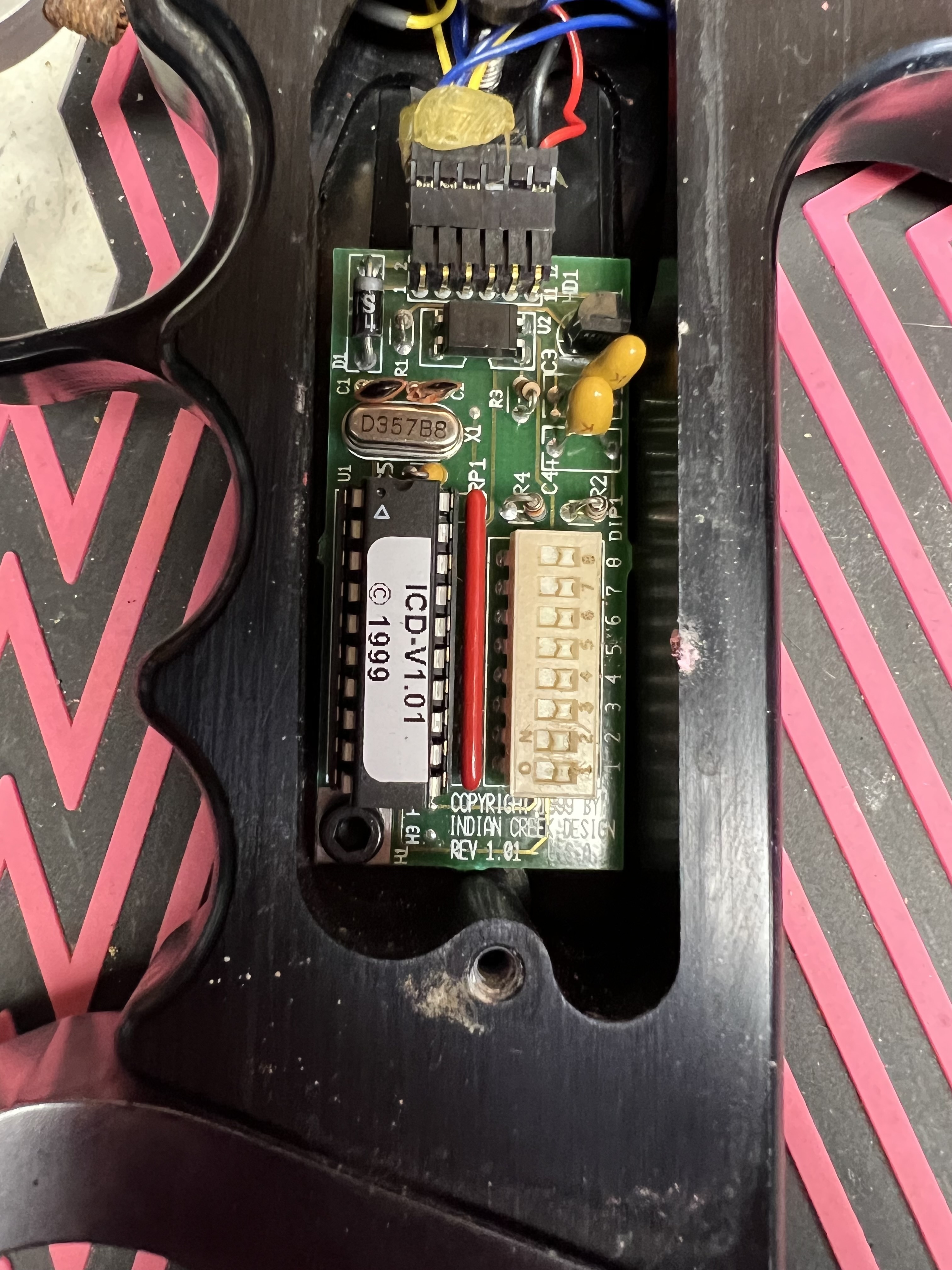

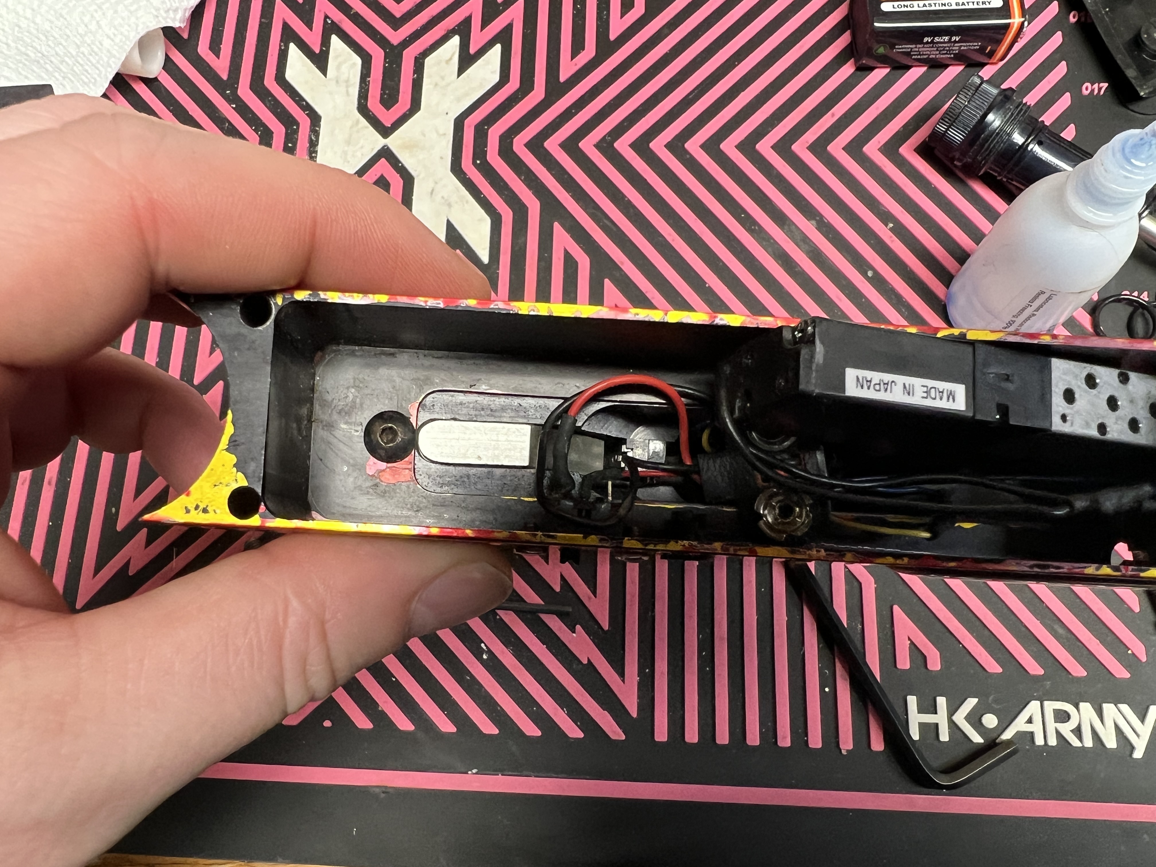

        And the board, located in the grip frame. Note the ICD board dated 1999.
        • Jimmydee
          Jimmydee commented
          Why does that battery just give me nostalgia chills? I didn’t even buy 711 batteries

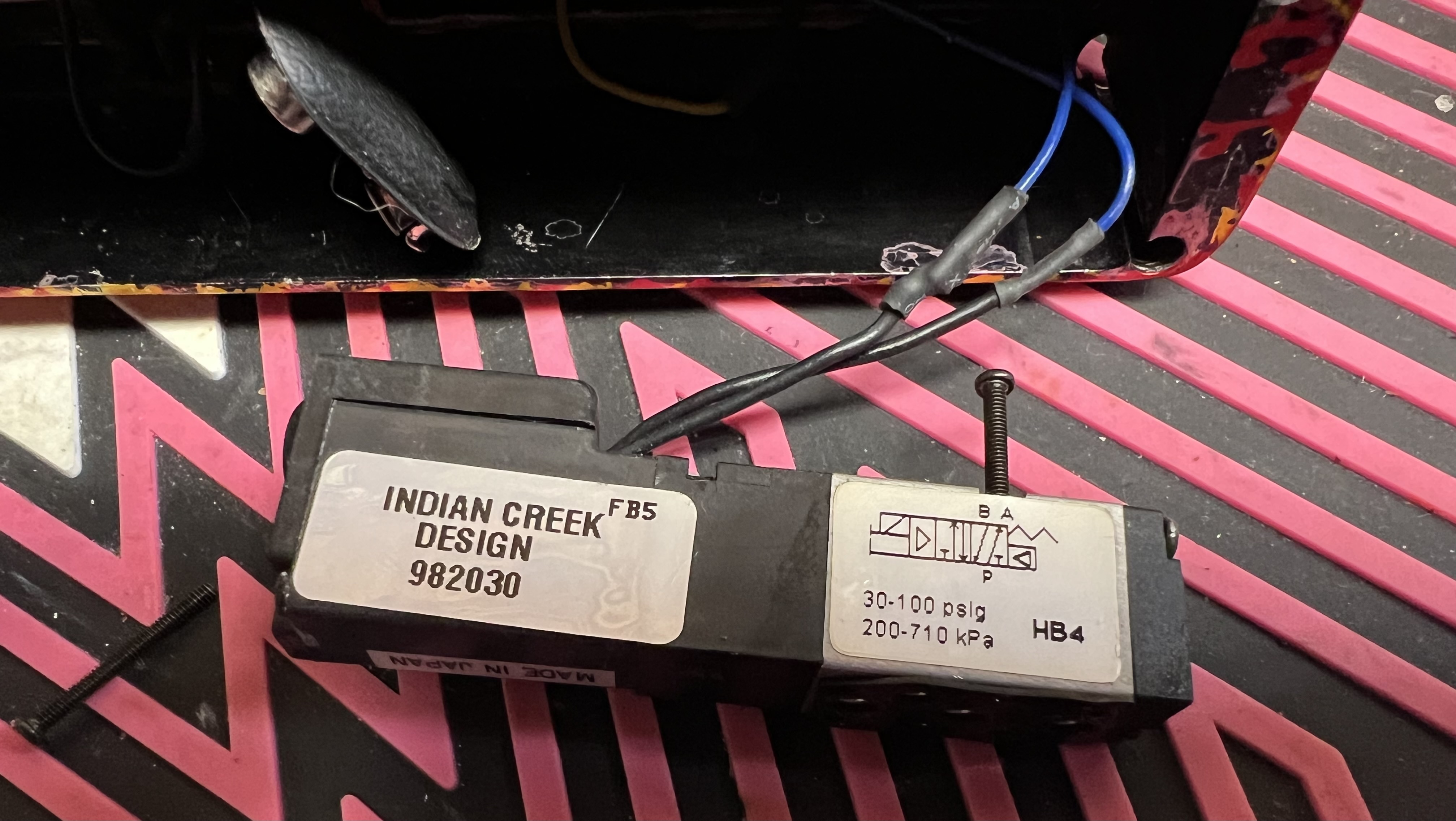

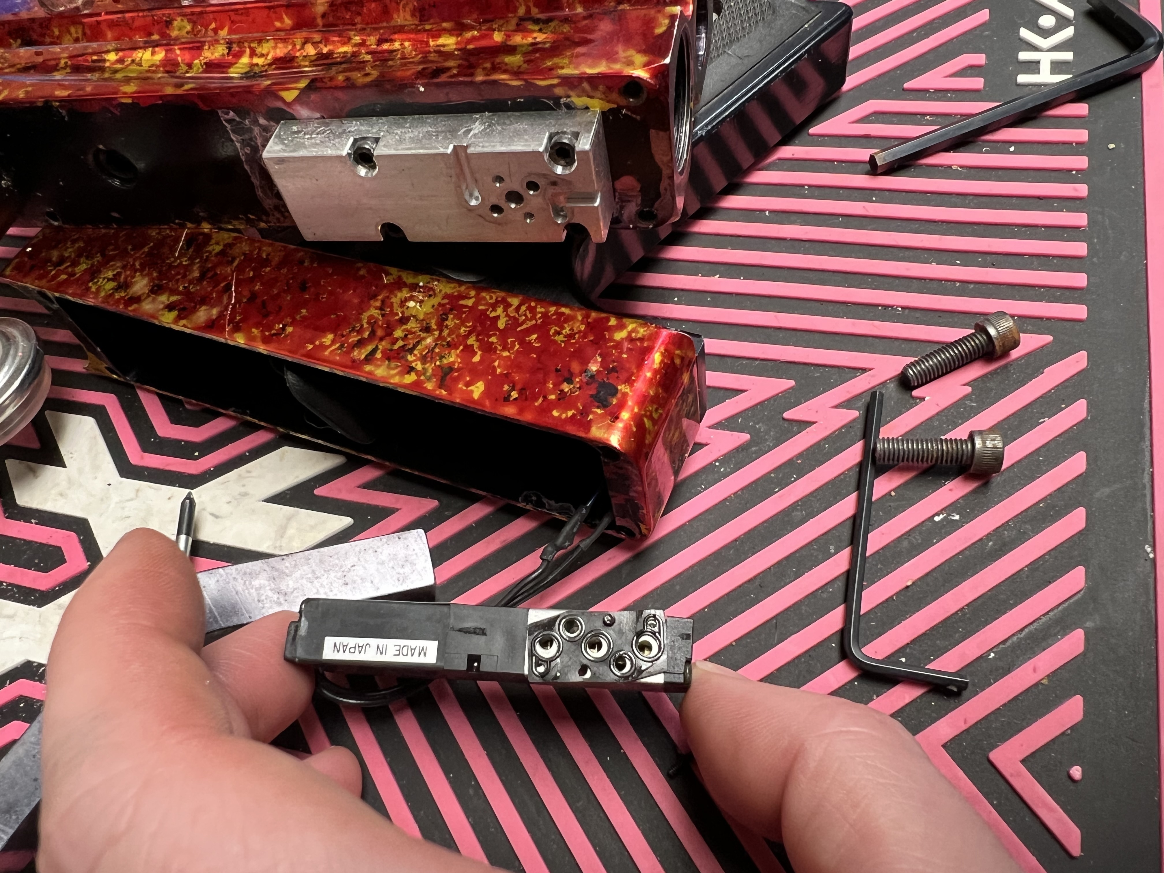

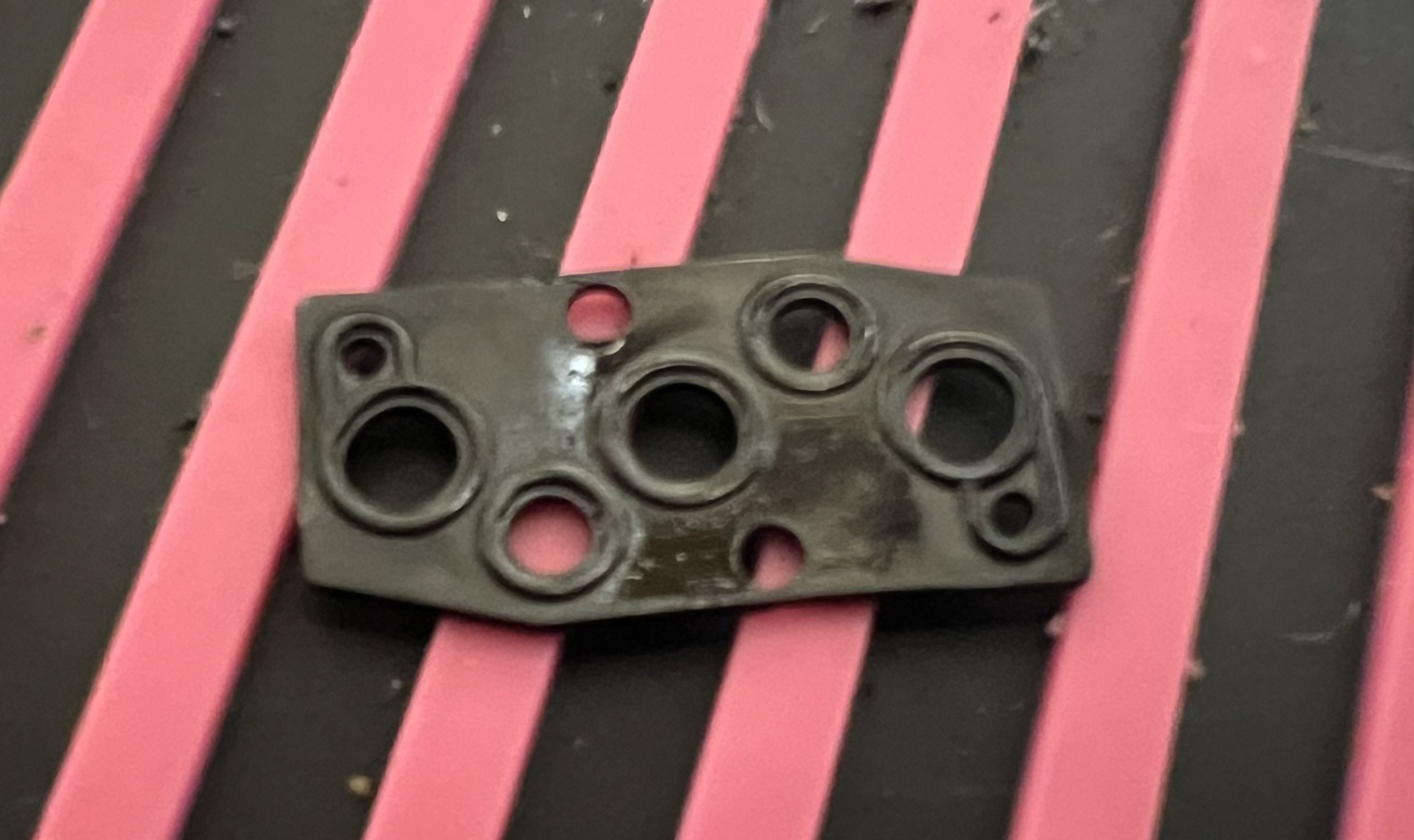

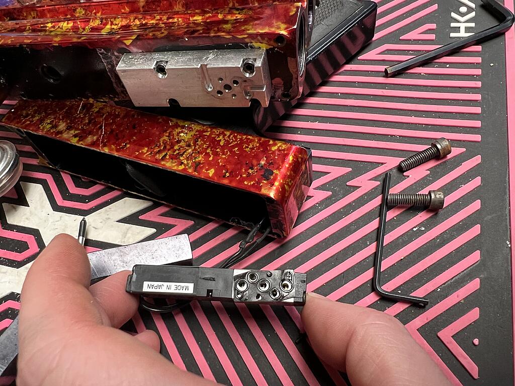

        Next is to remove the solenoid, so I don’t accidentally break a wire.
ID:	673689 Click image for larger version
ID:	673690 Click image for larger version
        As you can see, it’s an ICD solenoid. Be careful with the solenoid gasket! Mine appears to be in good condition, but don’t want to break it and need to find a replacement.
        • Myrkul
          Myrkul commented
          There is like a 95% chance that gasket is still good to go. Looks like it's in great shape.
        • lhamilton1807
          lhamilton1807 commented
          At this point I was thinking it looked a lot like a B2K. And yep, icd parts all over. Is this just a private label B2K? Or is it the other way around?
        • Myrkul
          Myrkul commented
          It's actually neither.
          The Bob Long Defiant and ICD B2K was a joint venture between Jerry Dobbins and Bob Long. They are almost completely identical, with a few big differences:
          1: Defiants use Autococker Threaded Barrels, Pre 2003.5 Bushmasters use ICD threads.
          2: The Bob Long Defiant Grip Frame has finger grooves, the Bushmaster Grip Frame is Smooth.
          3: The milling is different on the defiant body, and there is a smaller recess for the Jewel. The sight rail on a defiant is also taller so it needs a longer bolt pin to accommodate it.
          Other then that, the guns are identical. If you look closely at the serial numbers on the Defiants, they are actually stamped:
          ICD
          BLD ####
          So I'm assuming ICD milled the blanks prior to sending them off to Bob long. It's also worth noting that all the Defiant Solenoids and circuit board also have ICD stickers on them.

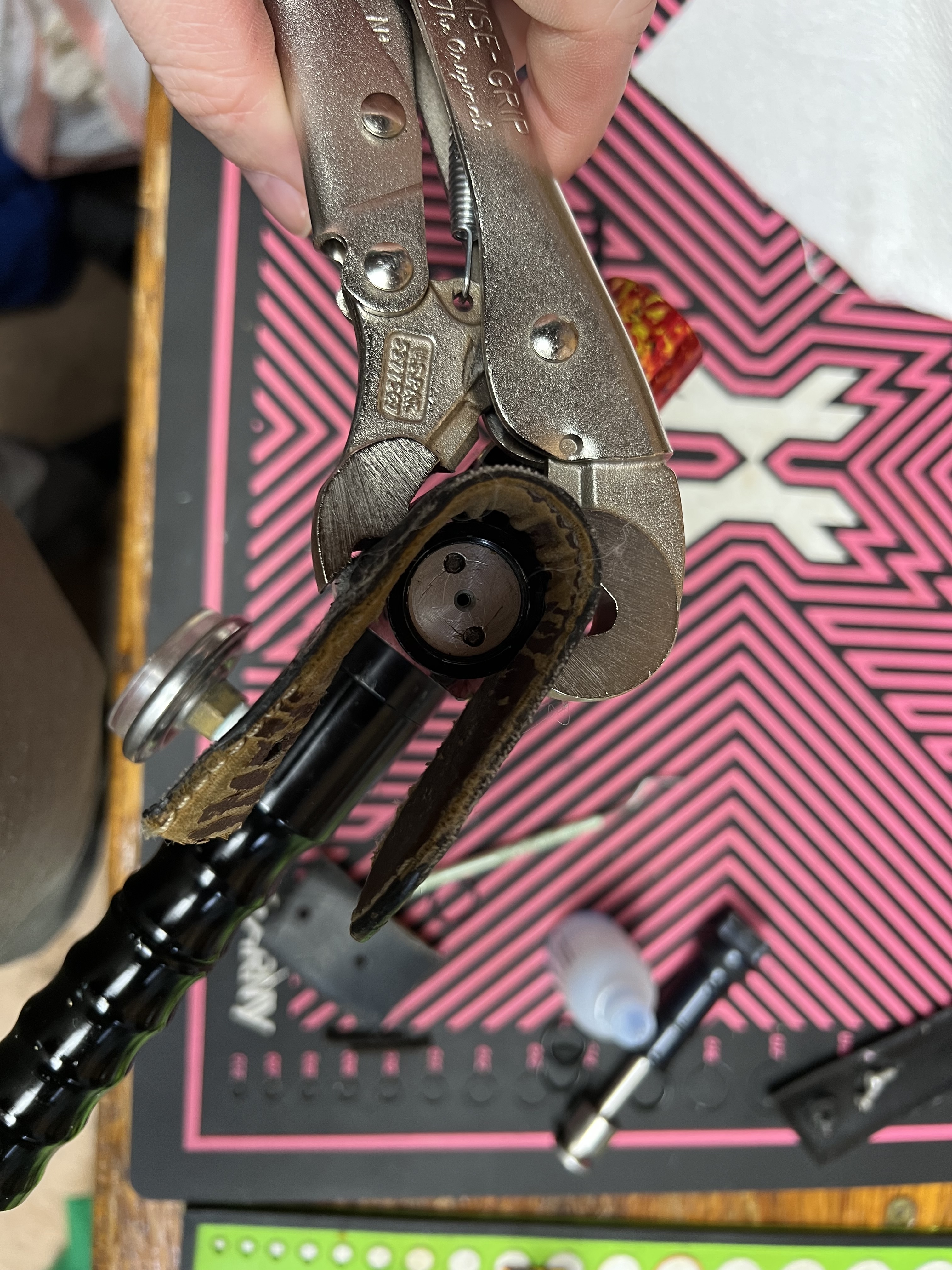

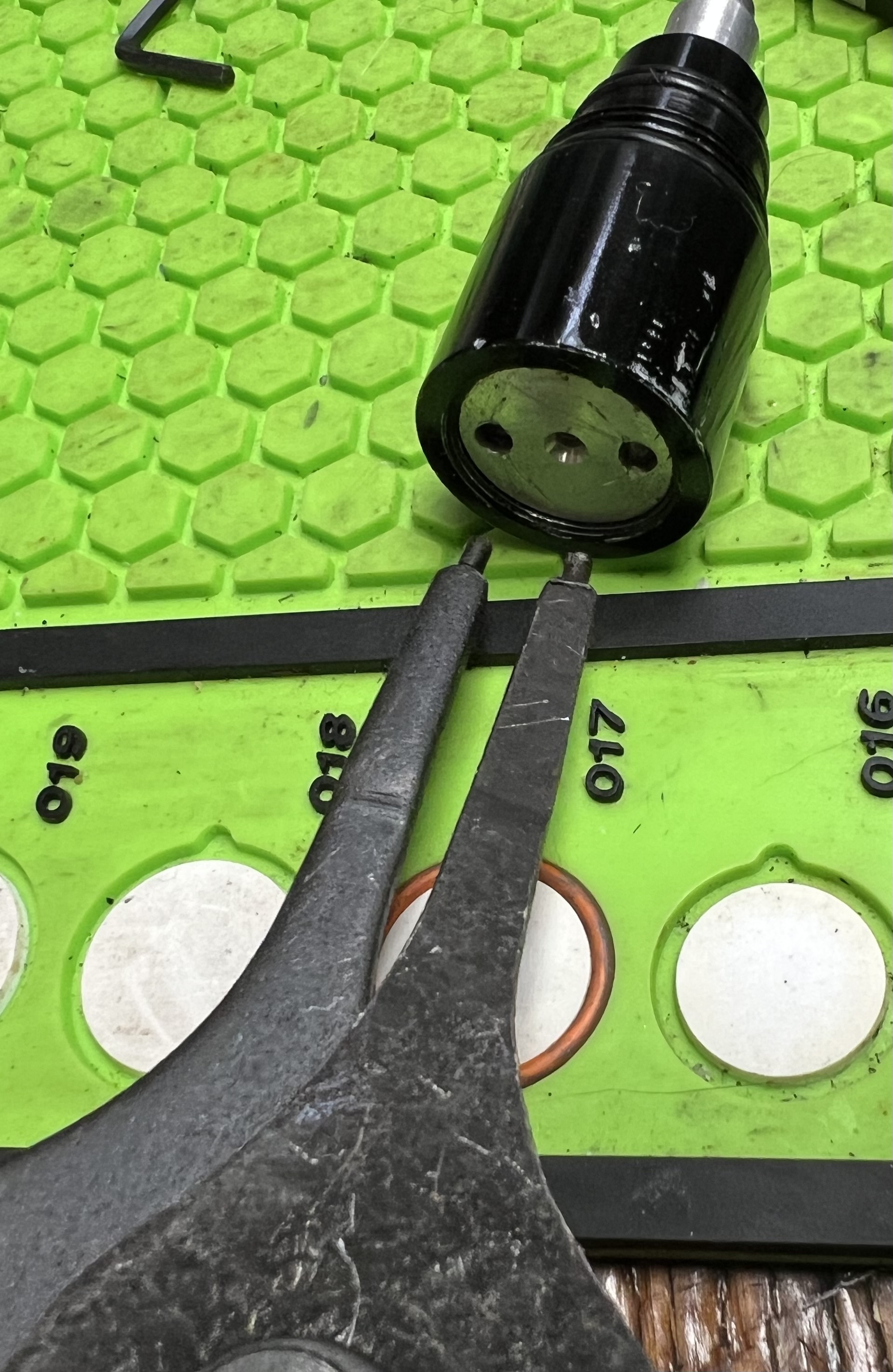

                    Alright, got more done last night, so let’s continue!
                    Going back to the LPR, which is Required some love to remove.
                    Click image for larger version  Name:	IMG_3161.jpg Views:	3 Size:	2.64 MB ID:	674911 Click image for larger version  Name:	IMG_3162.jpg Views:	3 Size:	1.67 MB ID:	674913
                    So with that removed, all the little fun bits fall
                    out:
                    And removing the front cap on the LPR:
                    And the LPR internals:
                    Need to remove a little more, but it’s not wanting to budget yet…

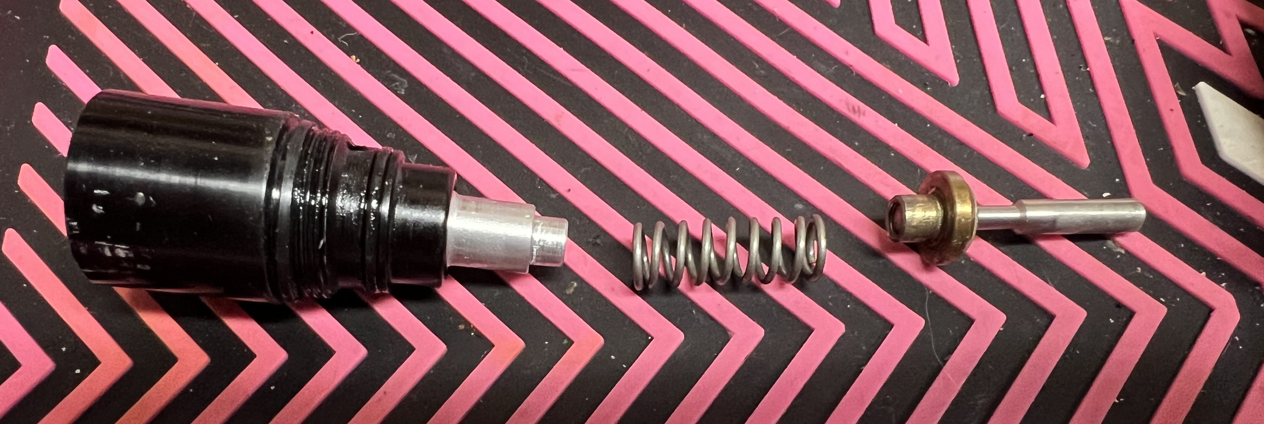

                      Now to the HPR. I was surprise how easily it actually disassembled except for one piece.

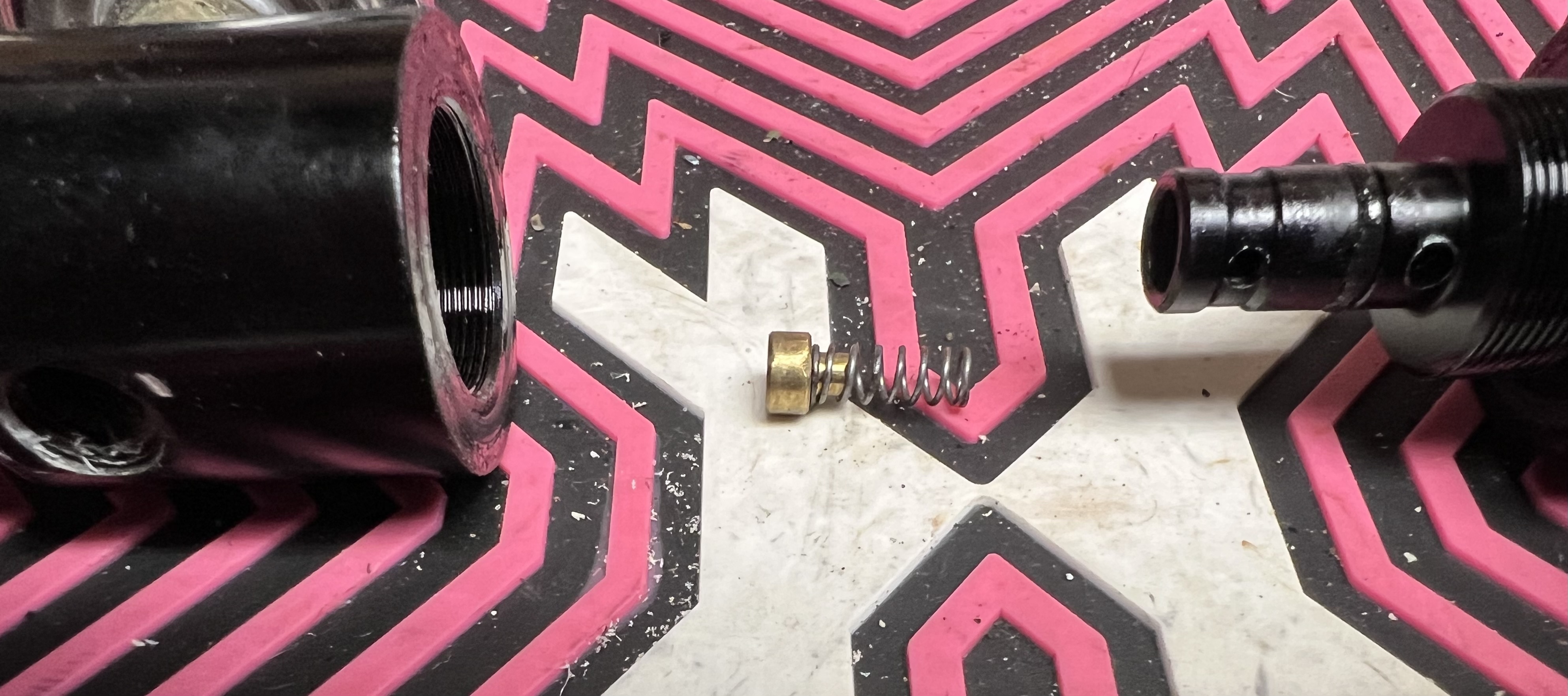

                      Turns out three main body of the HPR comes off nicely and the bottom of the HPR, the hollow section, just screws right off.
                      Couple little pieces to keep track of when the main body section.

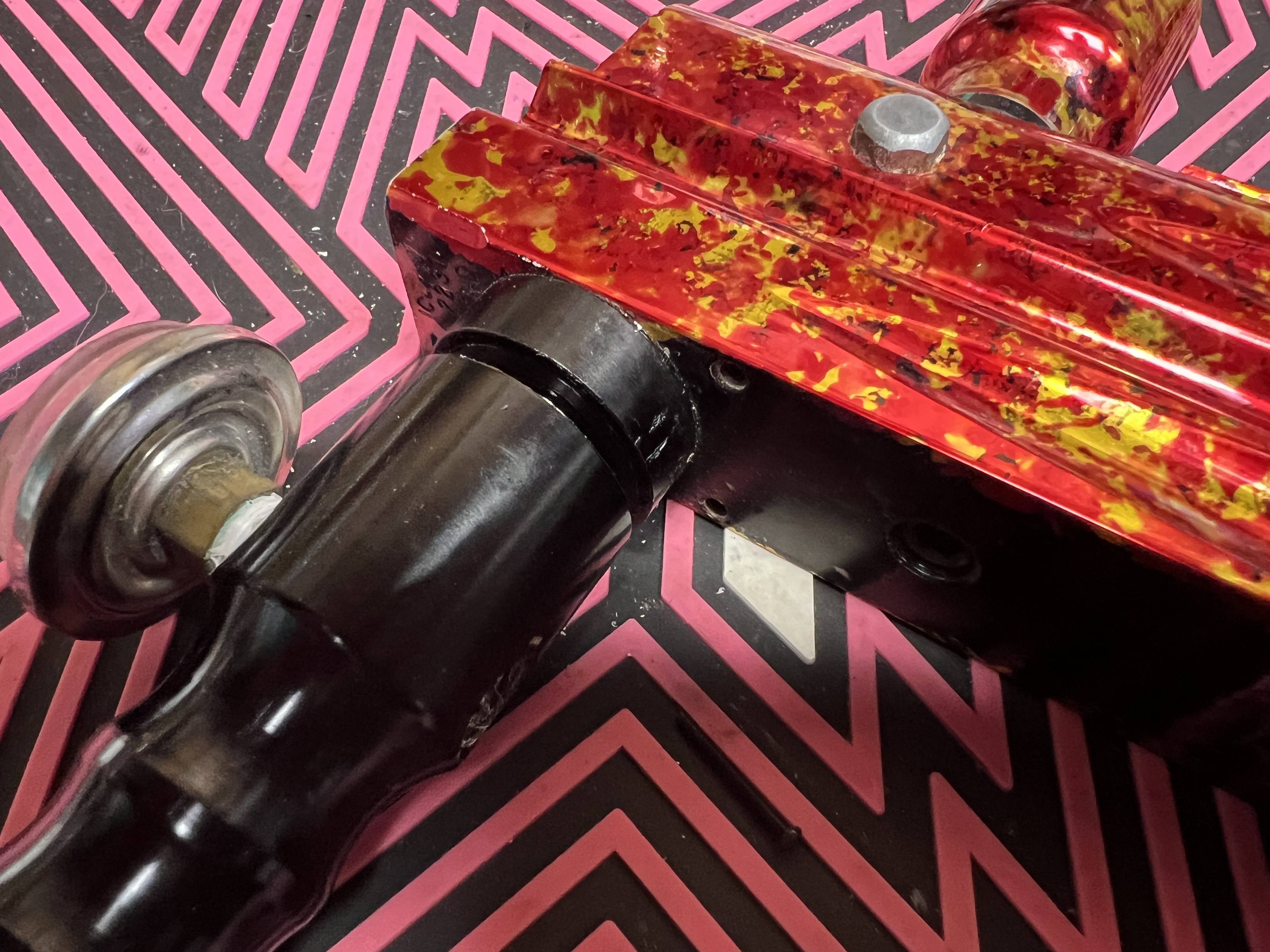

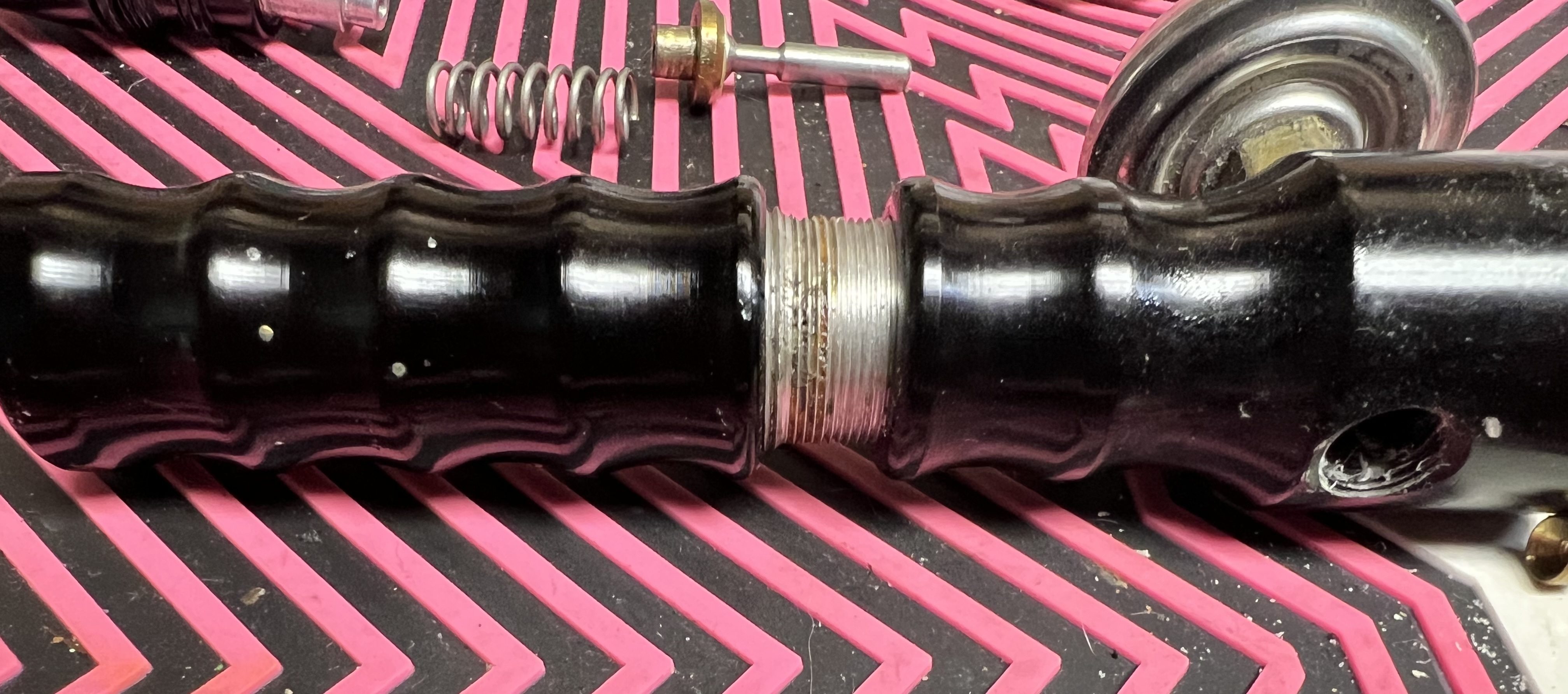

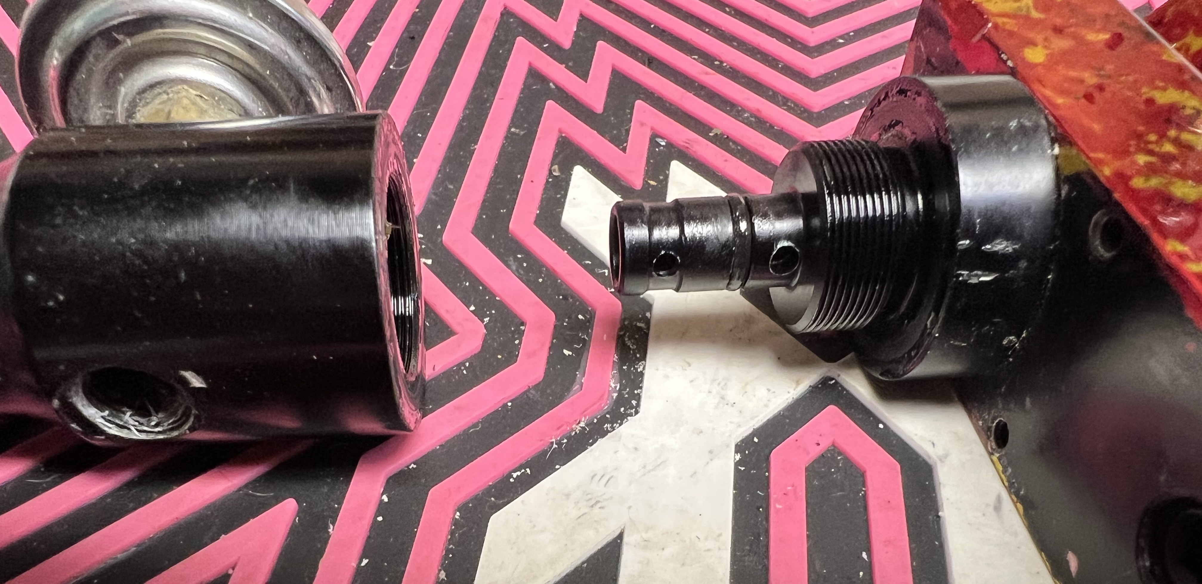

                      Now getting the HPR adaptor off the body was a pain. No wrench flats.

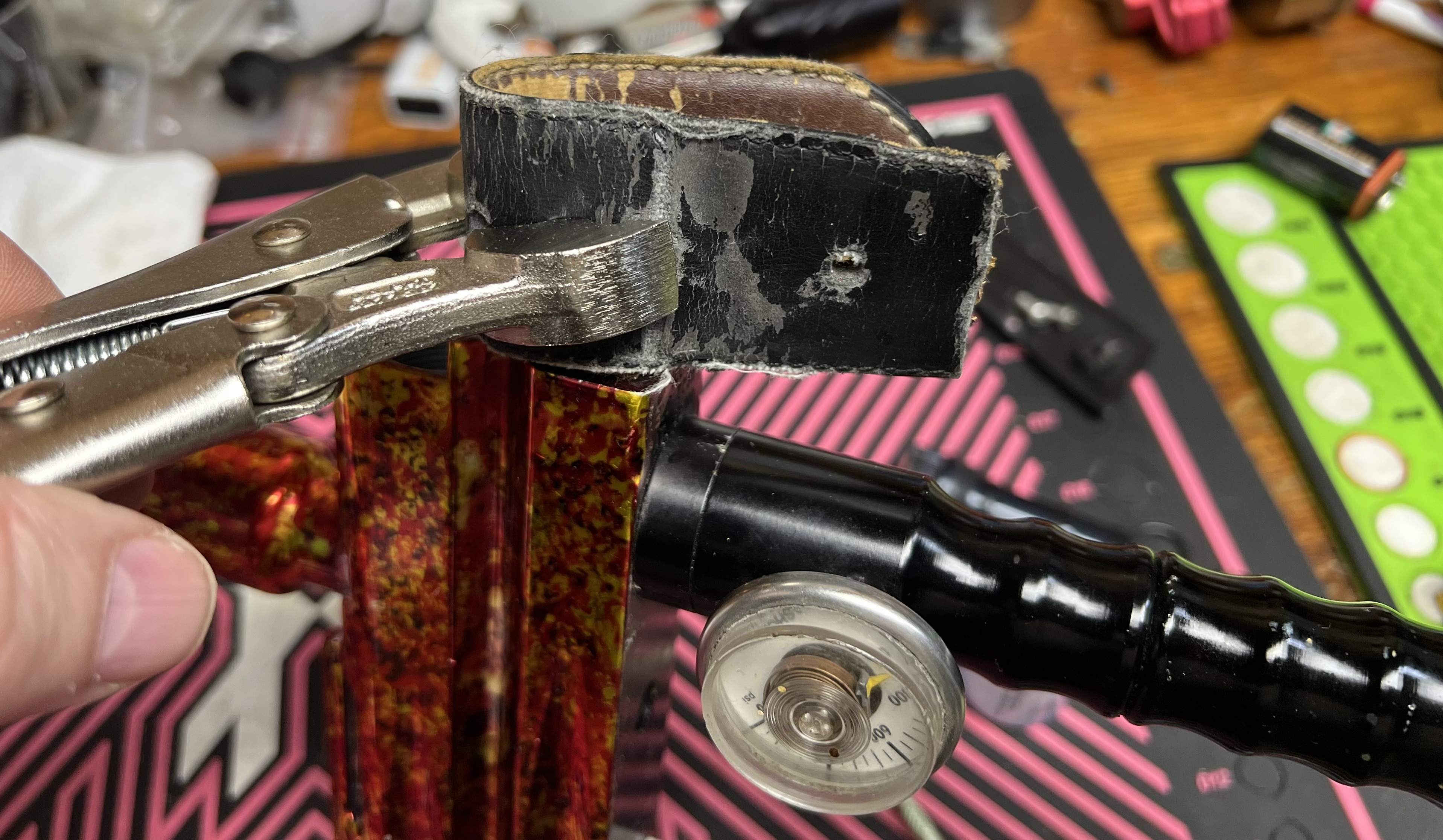

                        • 4559

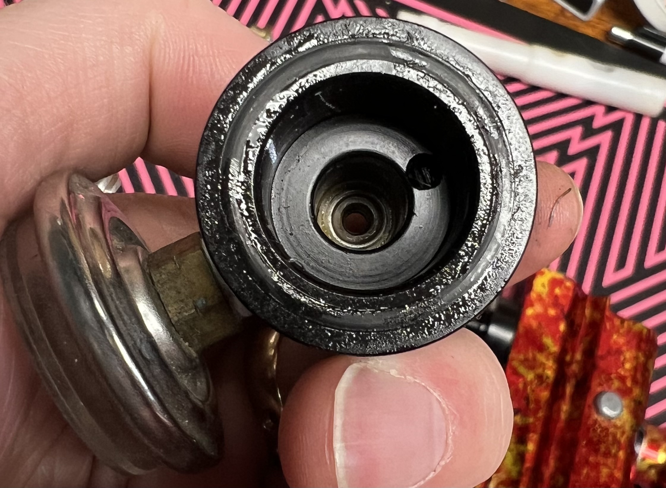

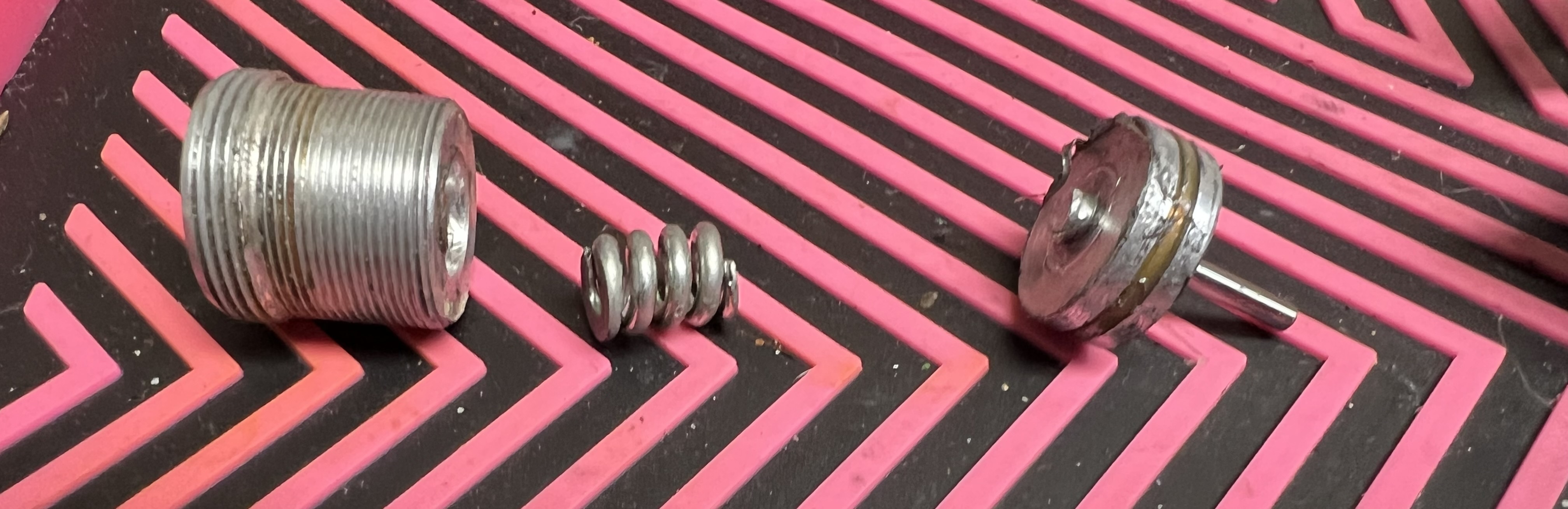

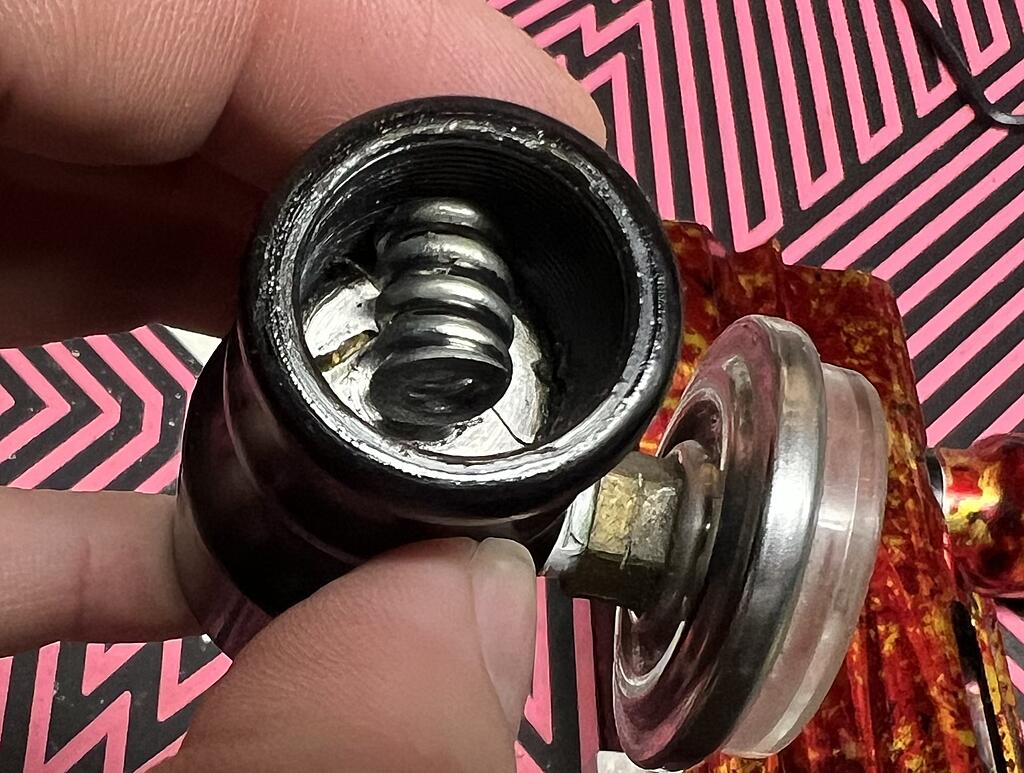

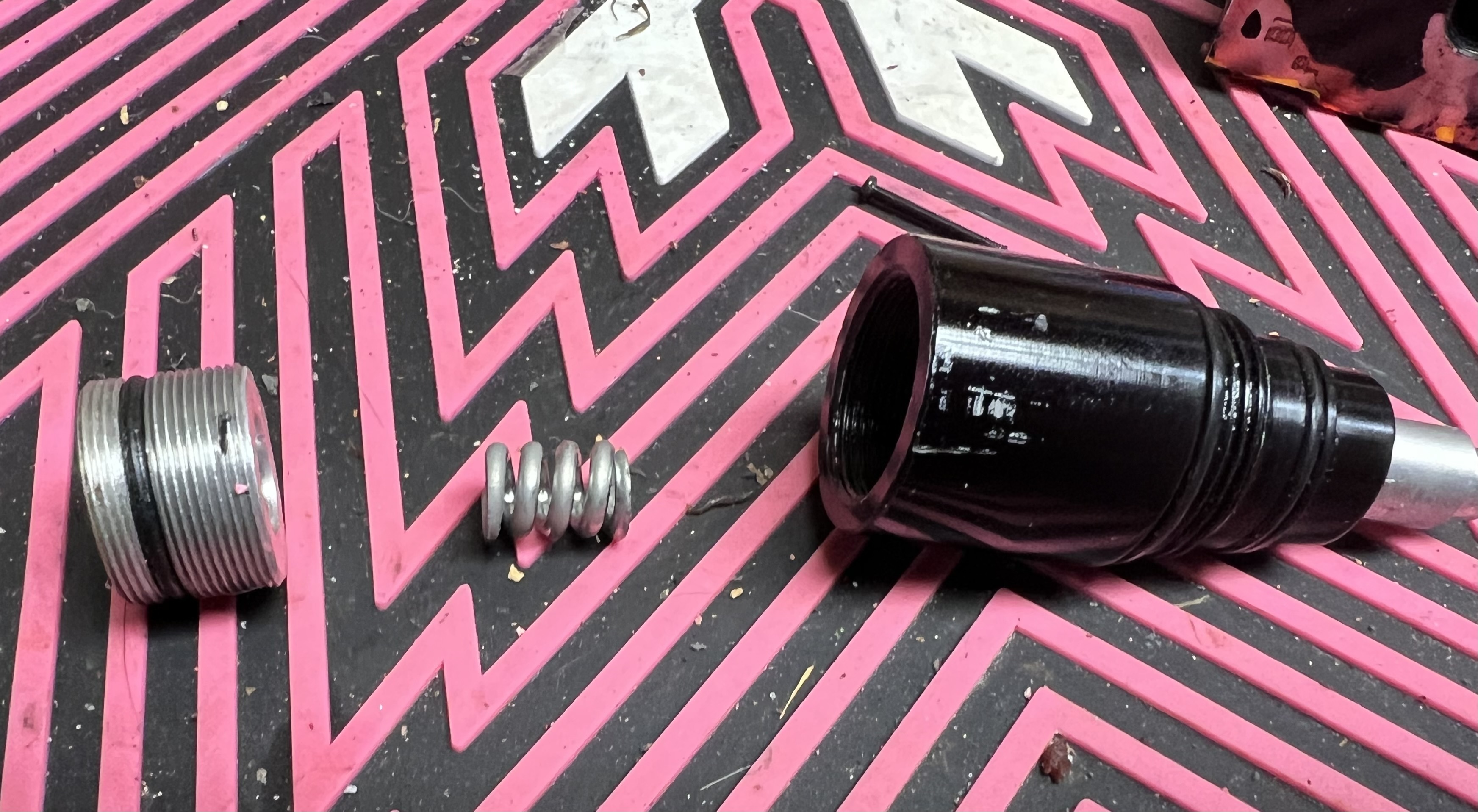

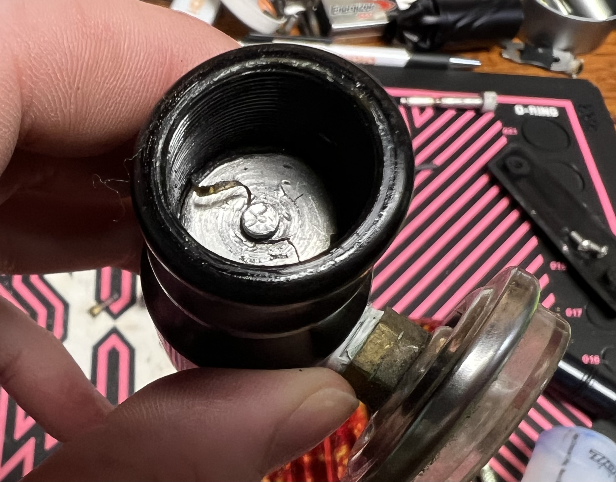

                        Now to disassemble the HPR. A slotted screwdriver remove the bottom piece:

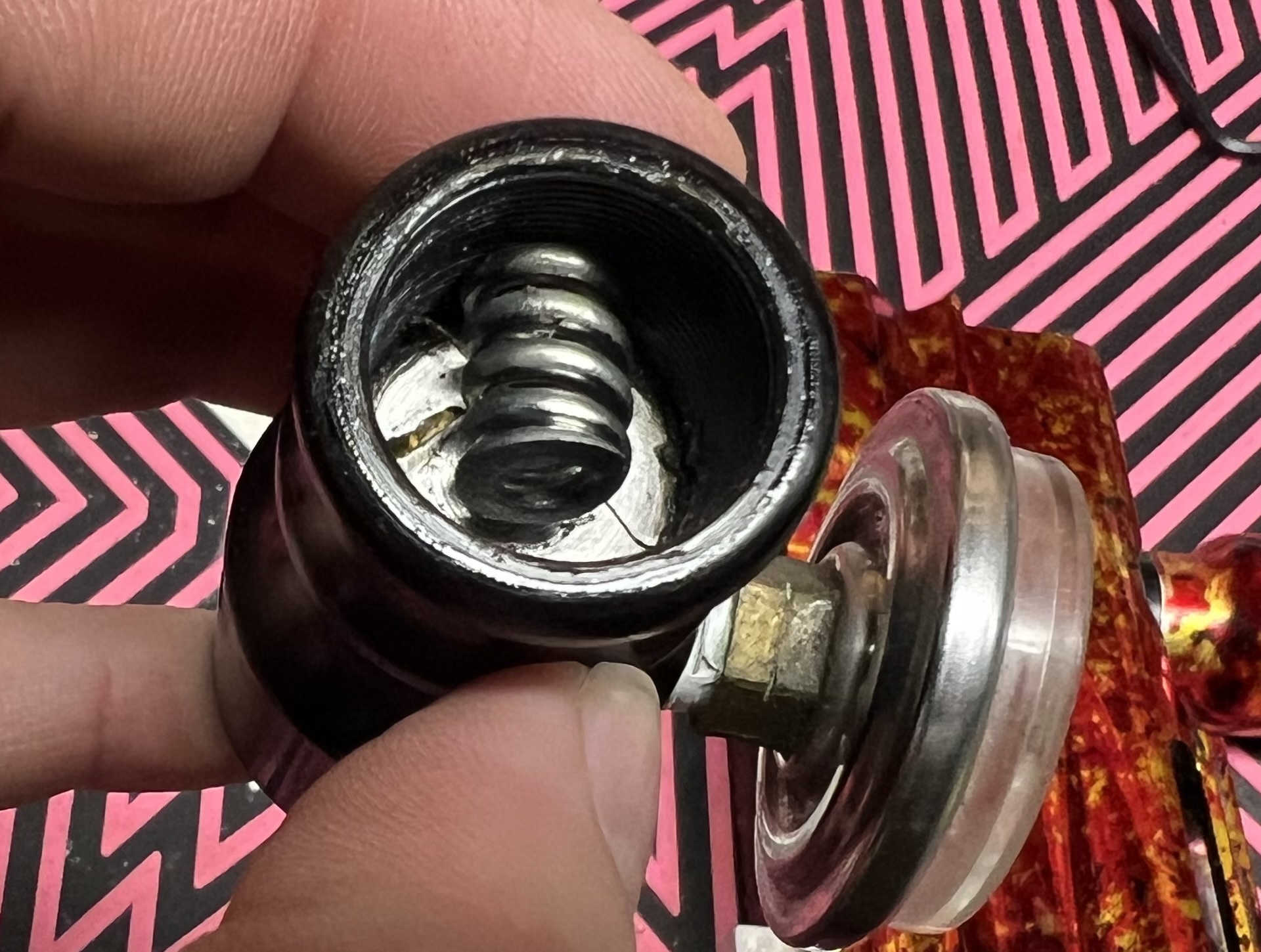

                        Pretty sure the spring isn’t supposed to be sitting like that. Good thing I didn’t try to air this up right away.

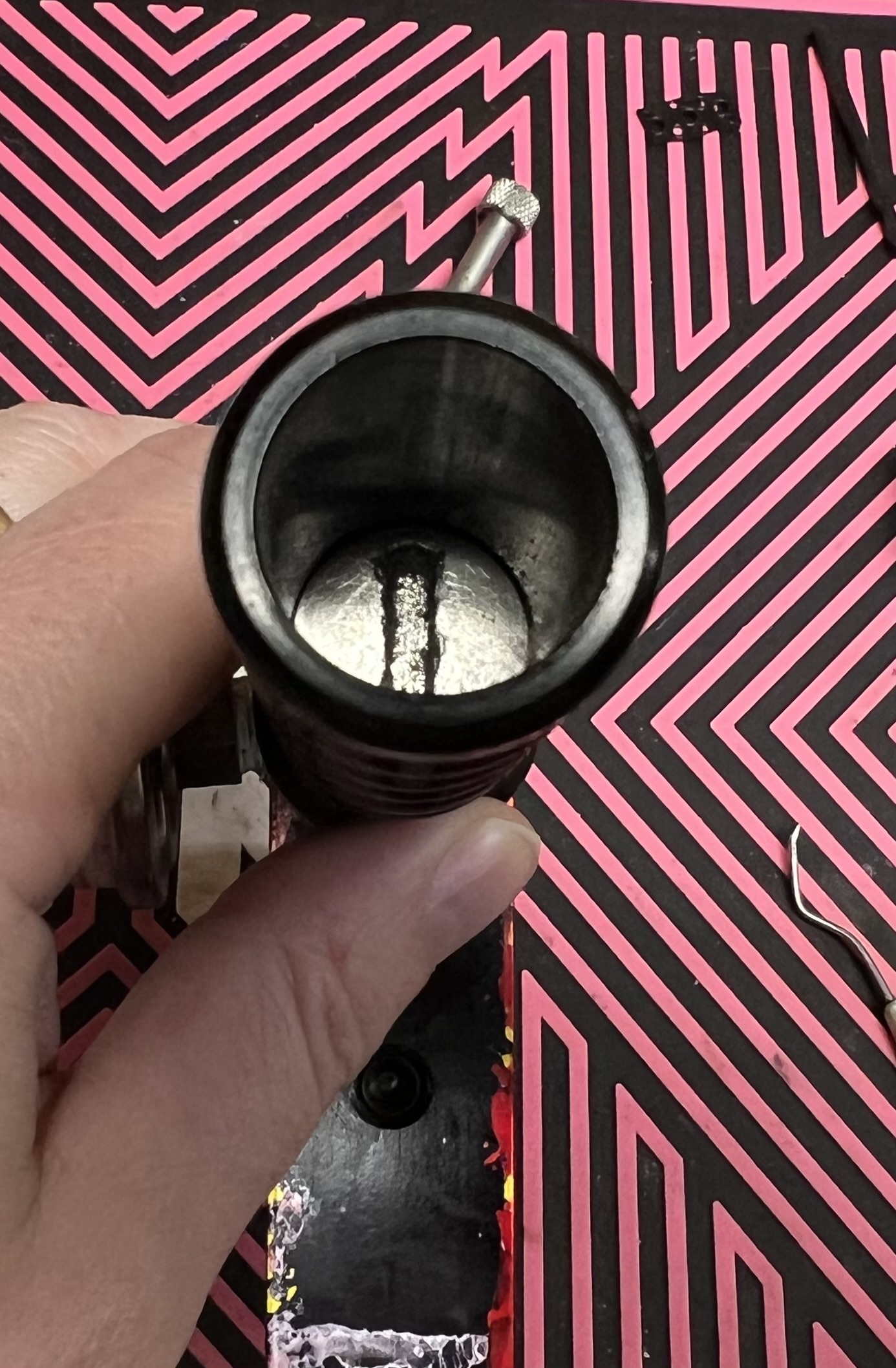

                        And man is it ever dirty in there! But considering this marker is 25 years old… not too bad.

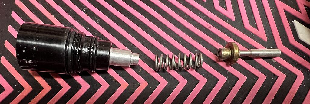

                        And here is the full assembly laid out:
                        And what the reg seal looks like in the reg housing;

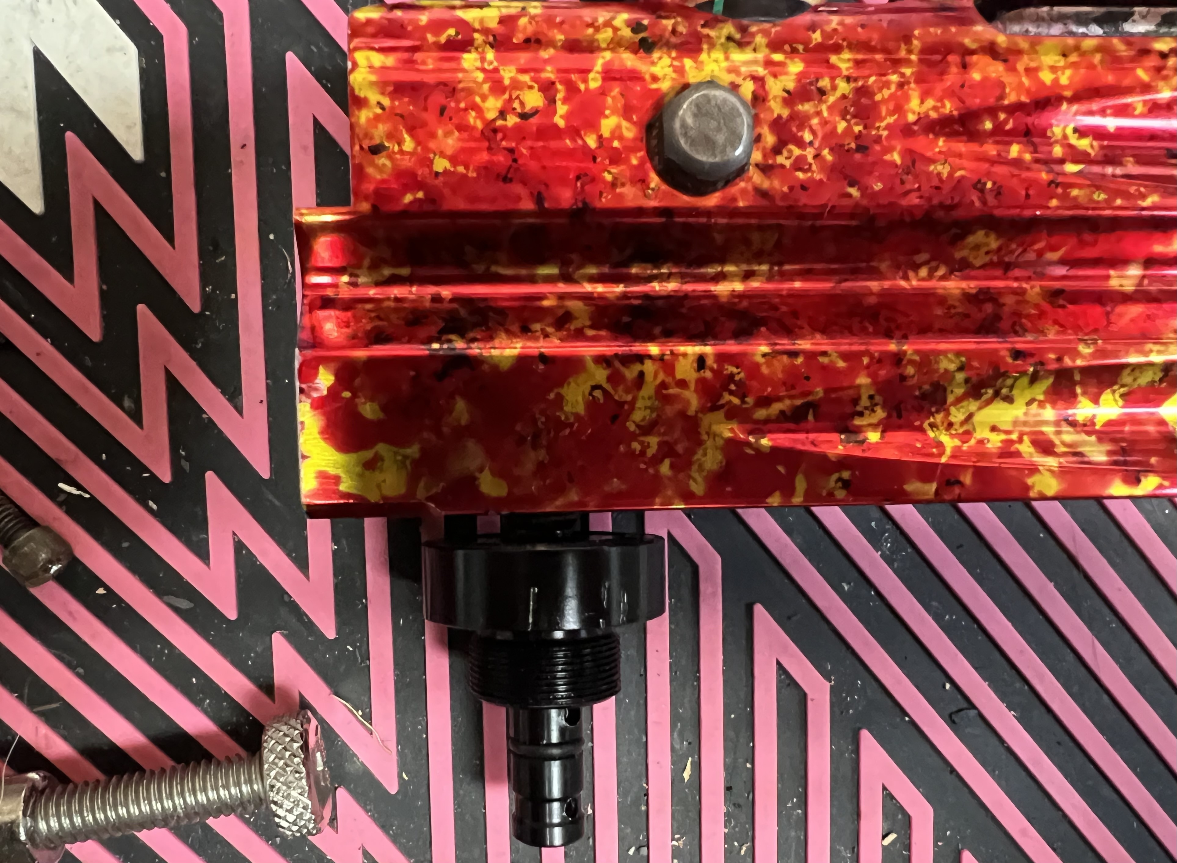

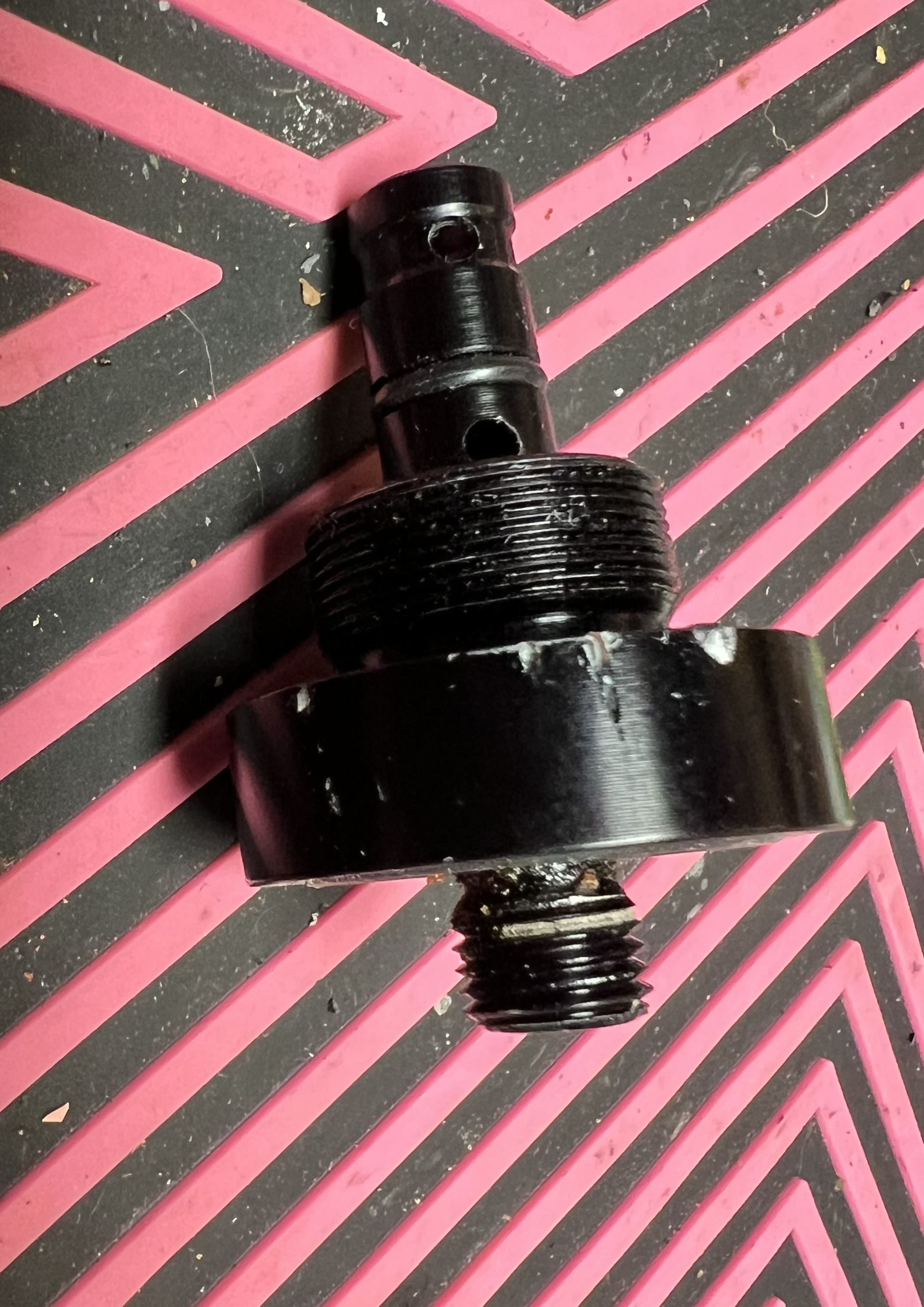

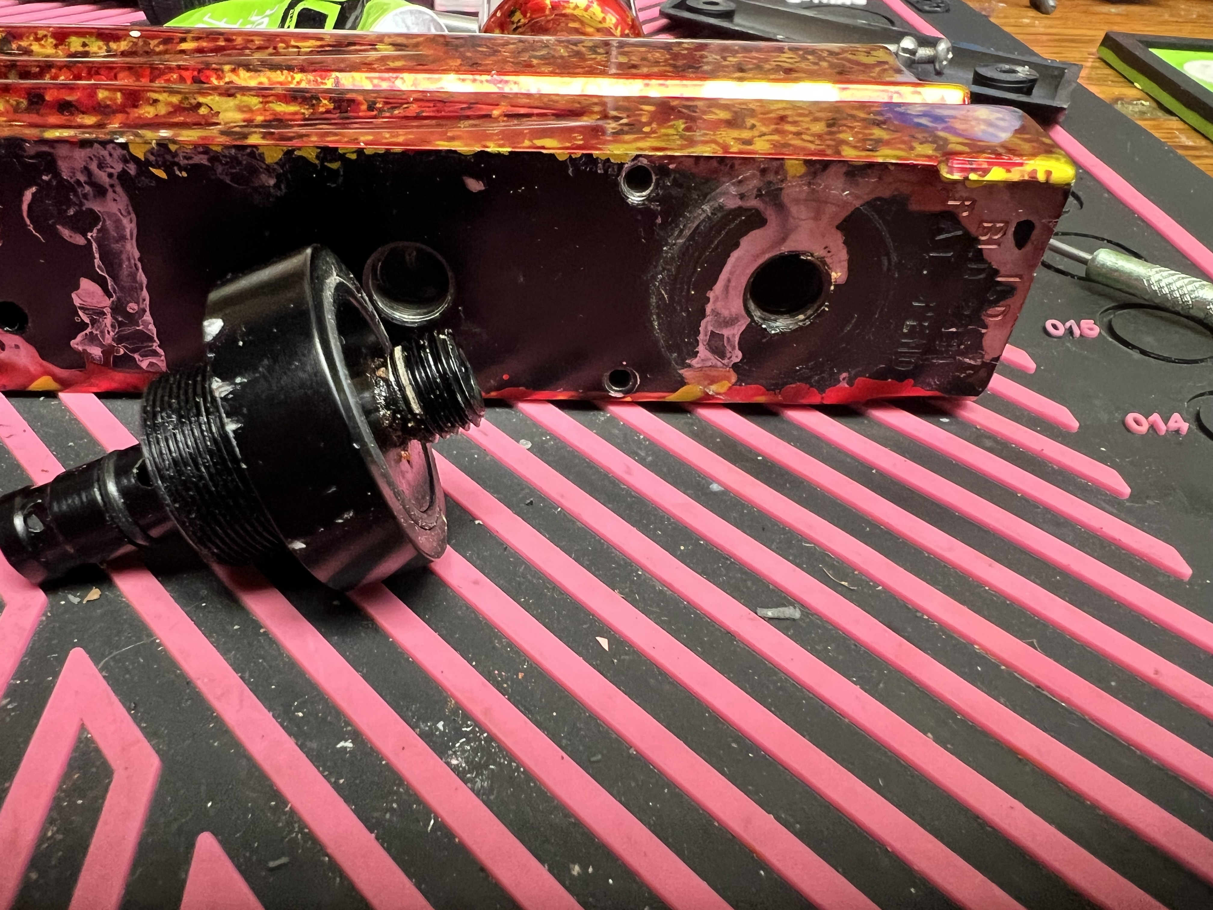

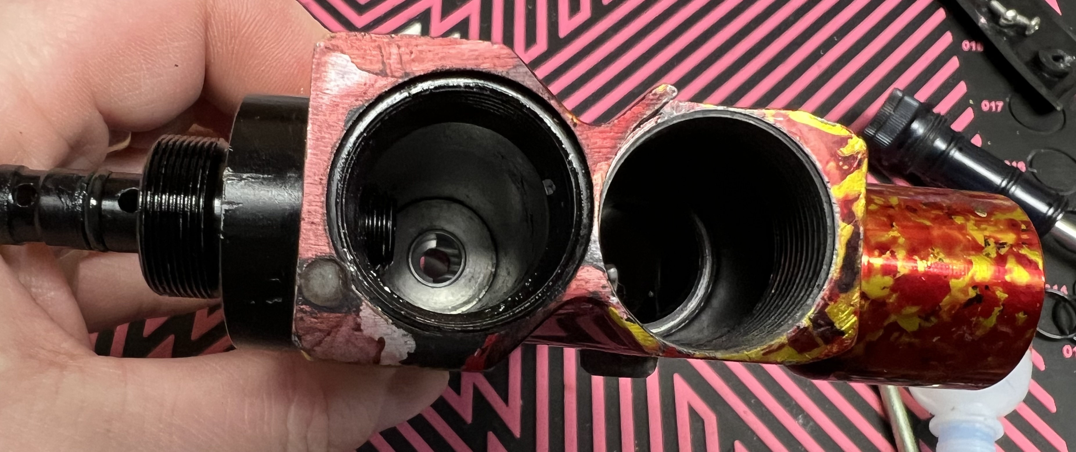

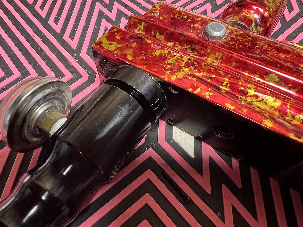

                          And now to deal with the regulator adaptor. To start I hit this with a blow dryer for a bit to loosen the loctite that ended up being on it. Couldn’t find my usual one, so don’t tell me wife I used the good one….
                          Click image for larger version  Name:	IMG_3178.jpg Views:	0 Size:	1.57 MB ID:	674969
                          So this price threads into the body, and up into the rear lower tube of the body and blocks the value… so it has to come out.
                          After a bit of persuasion the adaptor started to move and o removed it entirely from the body:
                          Click image for larger version  Name:	IMG_3180.jpg Views:	0 Size:	2.11 MB ID:	674970 Click image for larger version  Name:	IMG_3179.jpg Views:	0 Size:	956.7 KB ID:	674968
