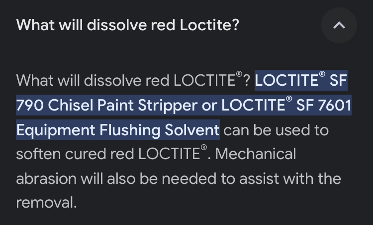

    +1 on soldering iron, the ones from walmart are fine. there's a few chemical solutions as well (soak in acetone overnight). and you can email EV about getting a raw body with loose inserts

      Acetone will probably be my first move, after that a cheap soldering irons gonna be the next. Unfortunately the part I need to remove the insert from is a dropout valve which EV doesn't seem to carry
