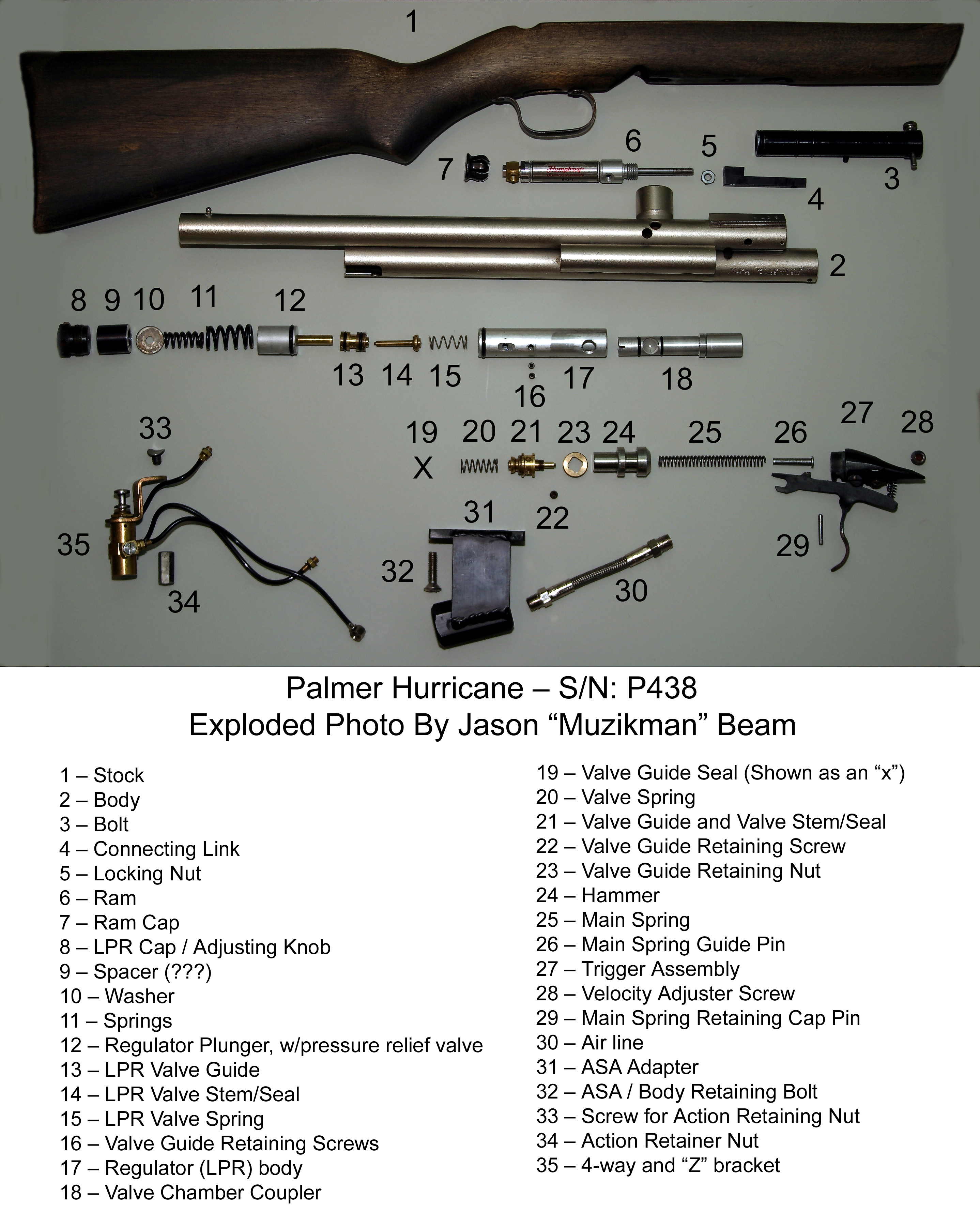

        Hurricane Exploded View. I don't know who to credit with this image, downloaded from the old MCB long ago.
        ~edit~ probably should have just looked at the image... proper credit is in the image.
          Carp commented
          Palmer Hurricane - S/N: P438
          Exploded photo by Jason "Muzikman" Beam
        • Interl0per
          Interl0per commented
          I've lost my part #22 any idea what size it is?

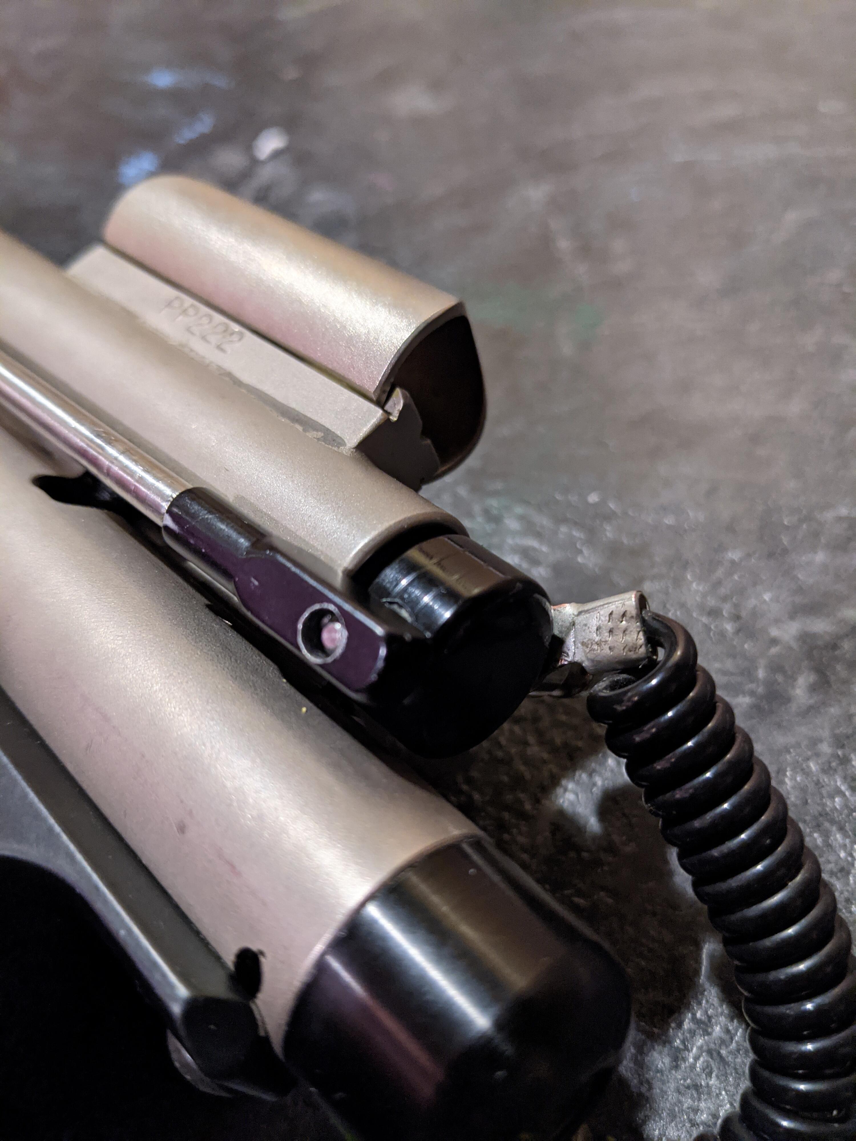

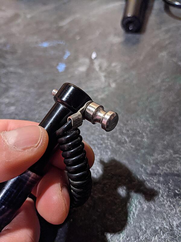

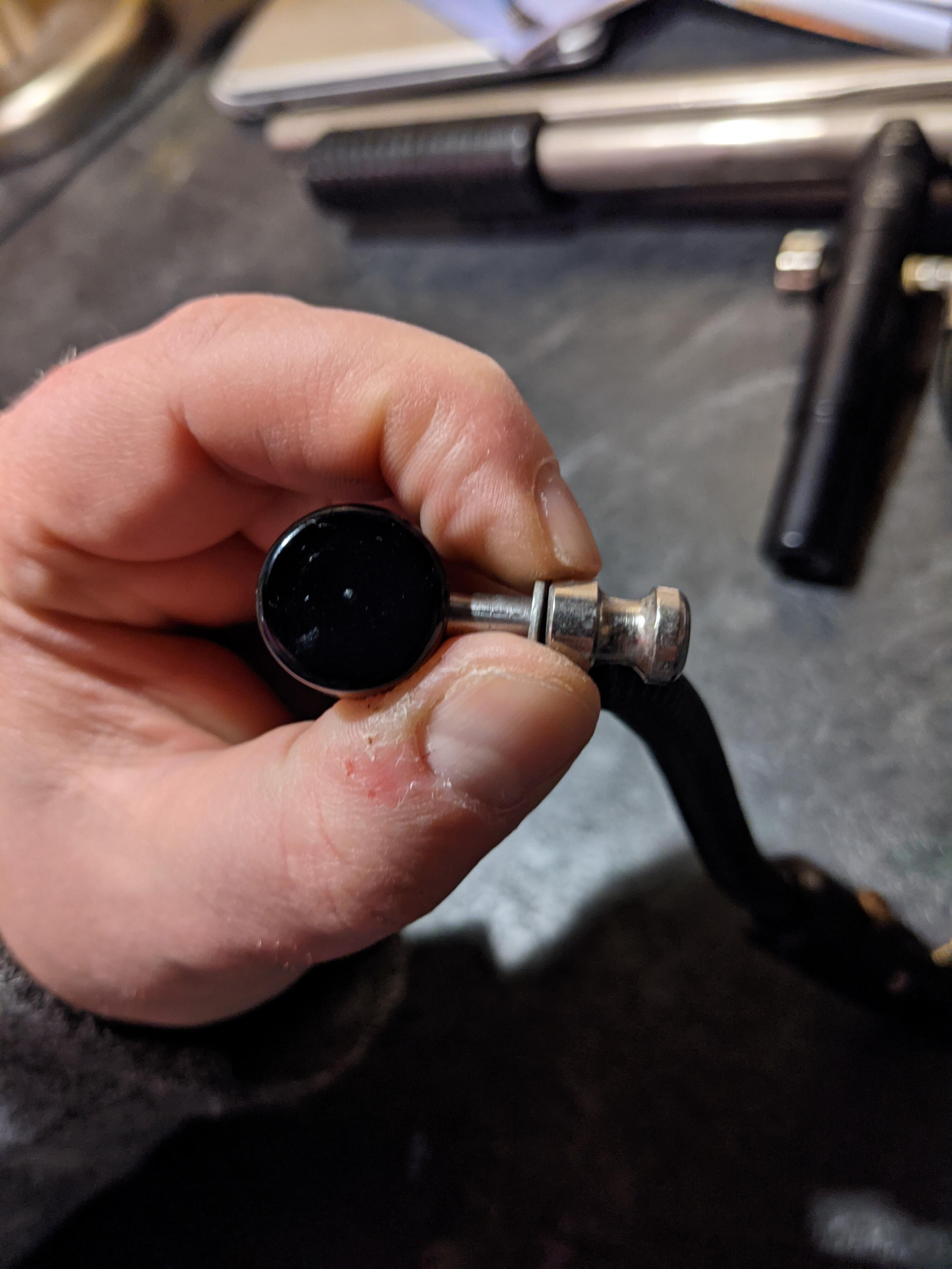

        How do I remove the spring loaded pump arm/bolt pin?
        The pump arm keeps coming off the pin despite having been tightened down. I believe it is because the feed tube lanyard is getting in the way.
        Is there a trick to removing this pin?

          I am pretty sure that the pin is threaded into the knob. Have you tried giving it a little heat?
            I. Am. Canadian. 🇨🇦
            • 3508
            Yup, it is.
            A few minutes with a lighter shouldn't harm the finish.

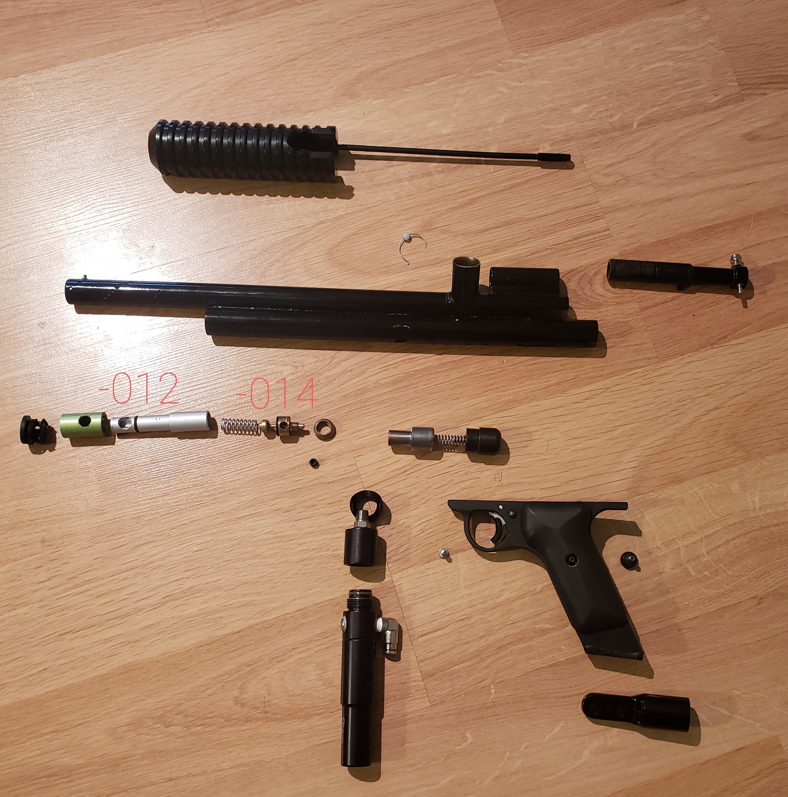

              Exploded view of a Houndstooth
              Click image for larger version  Name:	20221102_143200.jpg Views:	5 Size:	1.85 MB ID:	331129
              • stockclass48
                stockclass48 commented
                Do you happen to know if this break down is similar to the Super Stocker? likewise, will a PGP tool work, or is there another type of disassembly tool needed? Thanks in advance.
              • netsurferdude2
                netsurferdude2 commented
                Yes a sheridan valve tool will work.
                Does your Superstocker have a vertical ASA?
              • Loophole
                Loophole commented
                Yep, it should be the same if it has a VASA and as Netsurferdude2 stated, a Sheridan tool will work. Where is your leak coming from?
