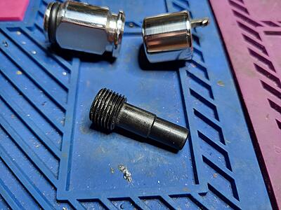

    Who has pics of different types of antikink internals?
    I seen some that use a tube in the hammer, some use the spring adjuster in the bolt, and some that have a pin sticking out that goes into a hole on the top of the set
    I'm gonna attempt to mod some non anti kinks internals so all ideas will help
