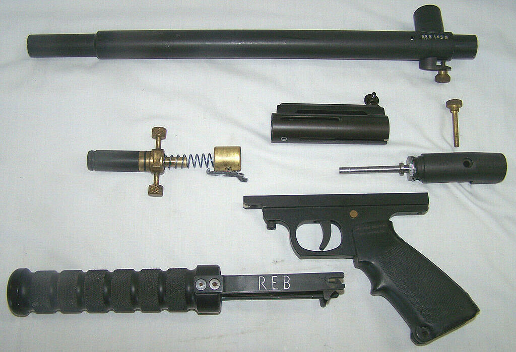

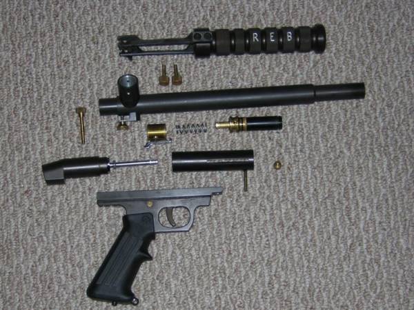

      If you look near the top of the feed neck, you'll notice two little holes. They are threaded! In a time when feeder elbows were normally held in place with electrical tape, the guys at CASL used a screw! Drill a little hole in your elbow, put it on the neck, put the screw in place, and WHAMO! no more lost hoppers!

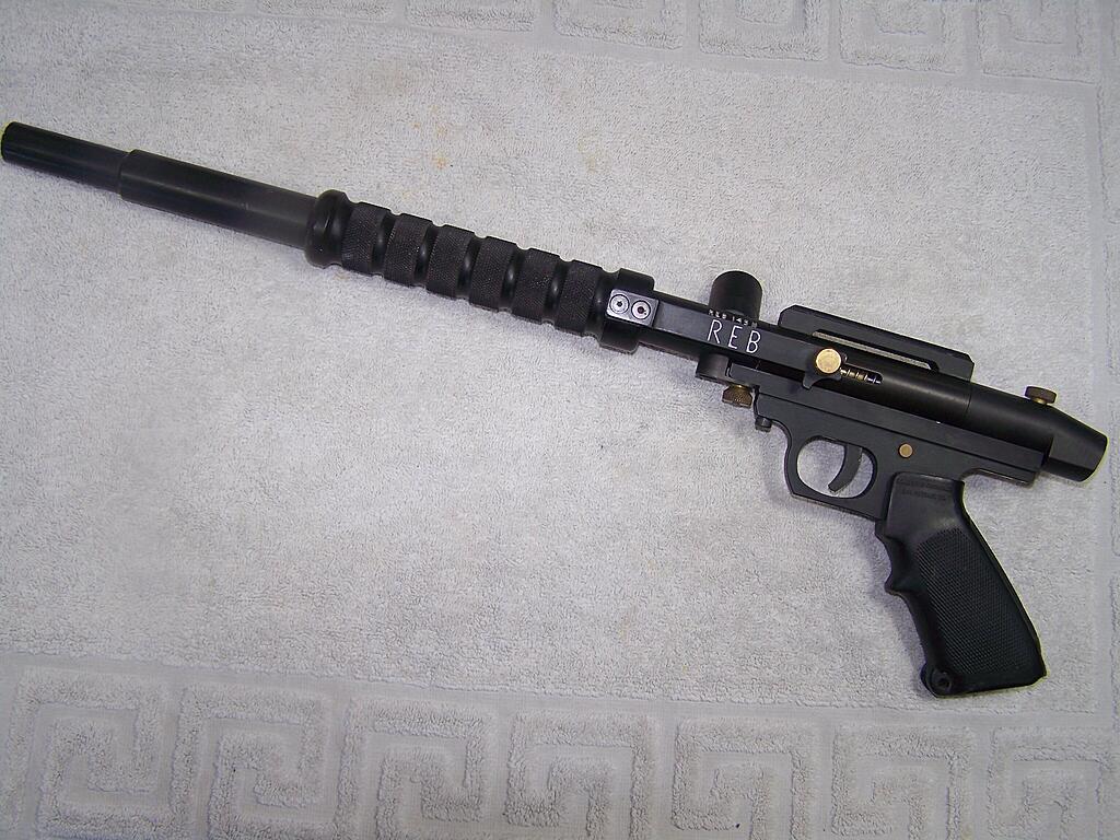

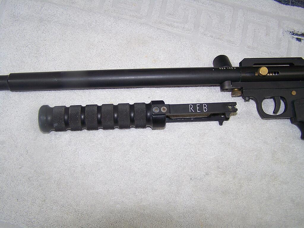

              From Dale's For Sale Reb Line, which I personally now own:
              This was made in 1990 (the 1989 models had Nelson grip frames on them) and is in great shape for being 31 years old! No leaks, no rust, pumps smooth and fires. It doesn't fire hard so you might have to re-spring it fyi. I miked it and bore appears to be .688ish. Some of the amazing features this had for the time were:
              Quick change pump with snap on/off pump arms.
              Longer pump for easier gripping of big hands or with gloves
              Adjustable rear sight rail (up and down)
              Tapered Bore drop, honed both feedneck and barrel
              No friction double O-ring (tip & shoulder) brass bolt and hammer
              Lock down screw on feedneck for feed tube or elbow
              Hard anodized for durability

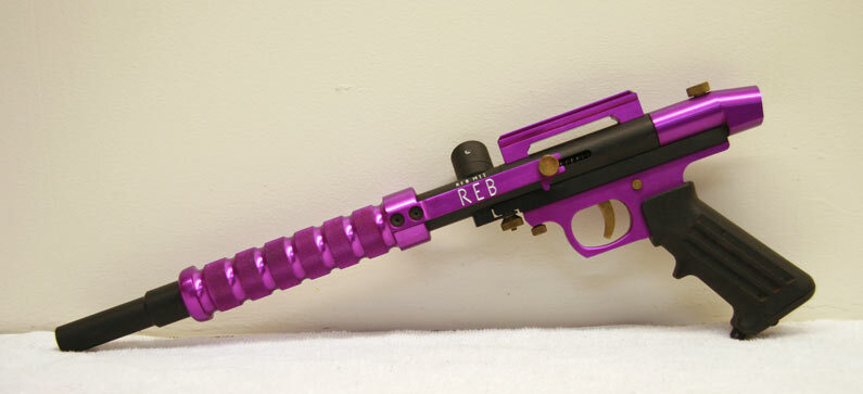

                  • Painthappy

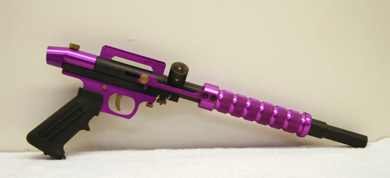

                    Painthappy commented
                    Yeah, I want/need that gun...
                  • capitalpaintball
                    capitalpaintball commented
                    You and me both!

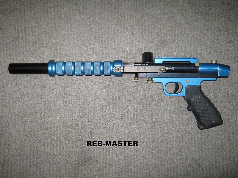

                      Mine Click image for larger version

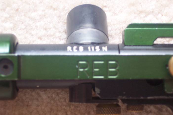

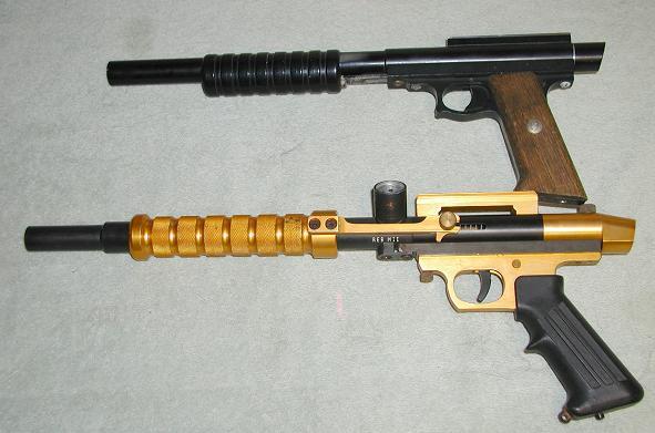

                      Questions I have on these are the differences between the 115N, 145N, and MII... I believe I have it figured out, but this is only deduction and not verified so may be corrected/adjusted in the future
                      ***Interesting side note, in the original APG article this is a mention of an "R" designation. The "N" was for Nelson paint and the "R" was for R.P. Scherer paint. I have never seen an "R", so can not confirm if any were actually made yet.***
                      Now the 145 number seems obvious, and when measured the barrel is 15 inches long in total with 14.5 inches being the center of the direct feed. But I've only ever seen two numbers: 115 and 145 - So this are the Gen 1 version of the Rebline - as seen in the ad a few posts above about "5 Industry Firsts in Two Fine Reb Line Models"
                      Click image for larger version  Name:	Screen Shot 2023-02-16 at 10.26.08 AM.png Views:	0 Size:	133.8 KB ID:	371842
                      The MII versions (Gen 2 I can only assume) I have in sizes ranging from 11.5 as my smallest and 17.5 as my largest. Advertisement photos show a snub nose version, and I do not own one so can't comment on the size.

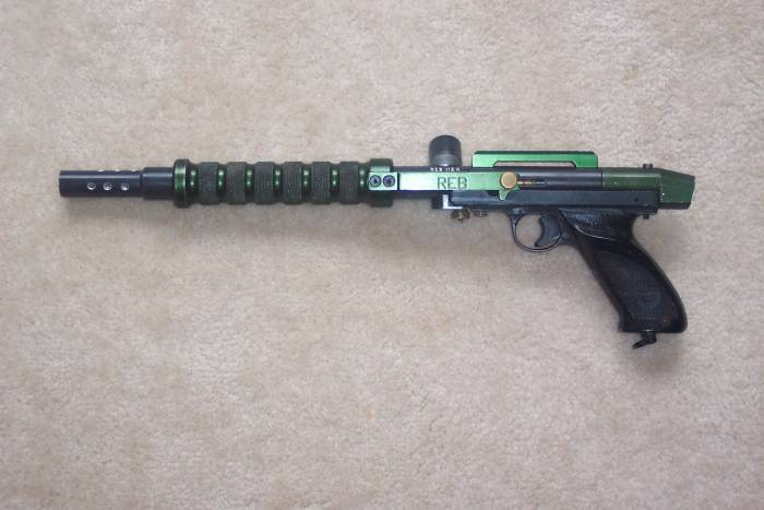

                      Original Reb 115N with Nelson grip frame - Circa 1989

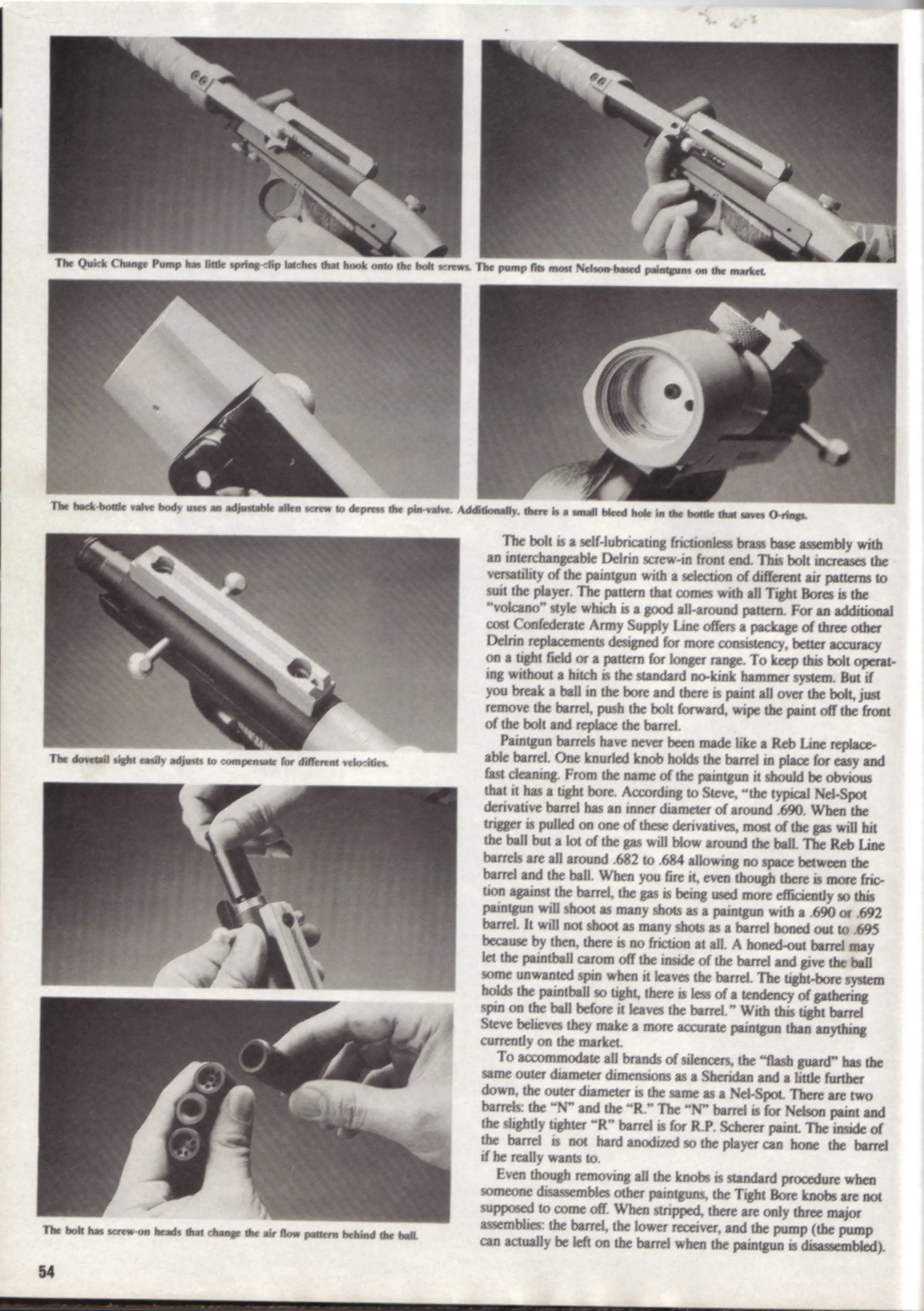

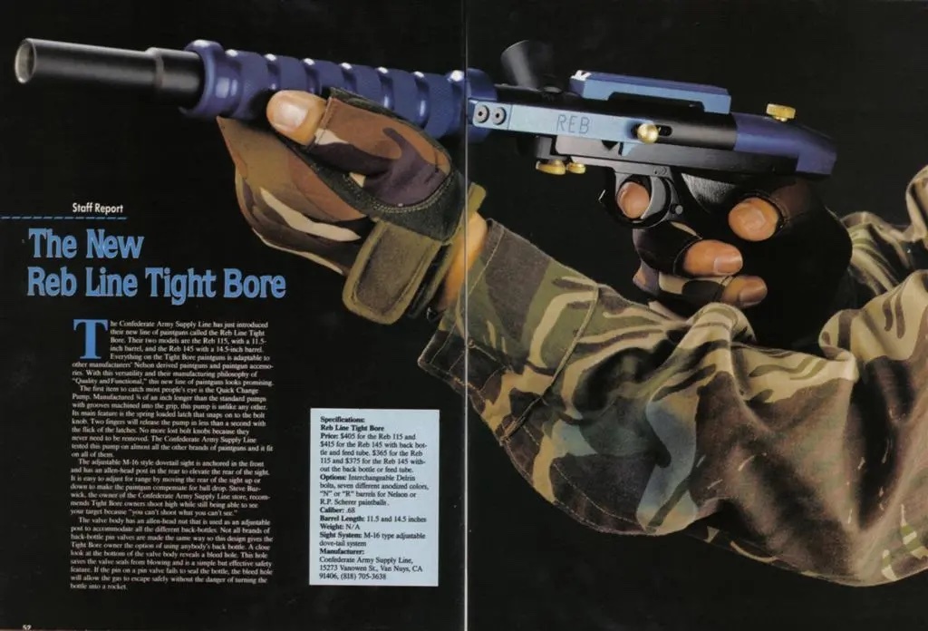

                        These are hard to read, but show the Gen 1 version of the Reb Line. I will find the APG with this and get clear scans of them when I can.
