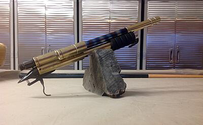

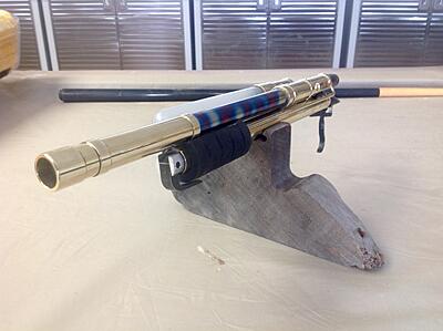

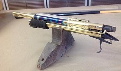

    Making of a pirate marker for a member here..
    Alexndi requested a small bore right feed cram and jam pirate gum and this is what I have
    Come up with so far...
    New .680 titanium flame anodized barrel at 12"...
    cram and jam setup on right.
    enlarged transfer ports at 1/4" I.D.
    drop out slot cut
    quick release slot cut for fast removal of bolt..
    Co2 lever action in the works
    kp style trigger group
    longer brass cocking rod for pump to bypass cutout
    new old style knurled pump grip...
    accent rings added for flair...
    walz emblem added...
    Need to make a pirate stock to fit... it will be dark wood with a flailed bottom..
    tsay tuned for part two... Axexndi's Pirate gets wood... coming soon...

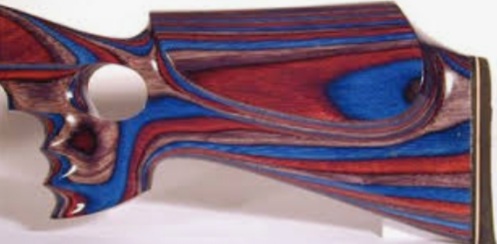

                        Wow, love the flamed barrel! This would look so nice with a laminated wood stock like this...
                        BigRed's feedback
                        • WALZ
                          WALZ commented
                          Yes, it would, i love those laminated stocks.....love the colors but if that's a Boyd stock they are way heavy...must be the resin...

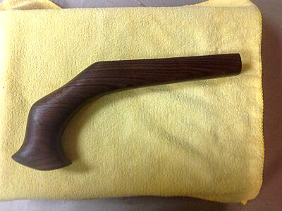

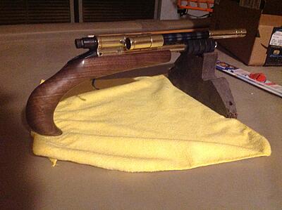

                        I found a piece of black walnut in the wood stack today and shaped out a pirate looking stock...
                        its rough, only filed and sanded to 120 so far but I think it going to fit the look we are seeking to achieve...
                        Hoping you might like this design... lmk what you think.. I can always do something different..

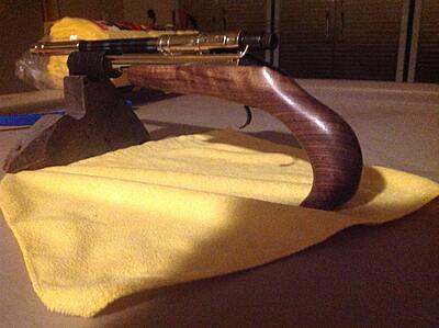

                          Reworked the stock making a fang bottom instead of the double flailed end..
                          inletted stock and marker installed...
                          Very comphy to hold and points nicely...
                          Lmk what you think this one......
                          still,have some nuts and bolts to add, make up the lever changer setup and a long brass trigger guard
                          I have room to make the lever spring action in you might want that... lmk please..

                            Wow, I love it!
                            spring action lever sound like a very usefull option, so yes I would like it
                            I dont remember if the trigger group was already drilled for RVA? If not, could you make it?
