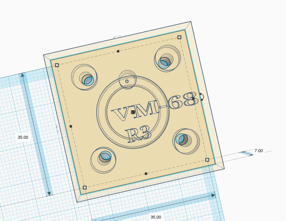

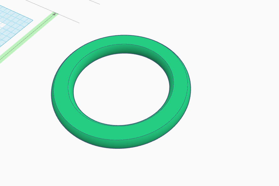

    Hey all,
    I’ve been working on a few small reproduction projects lately — currently also developing a replacement WGP Select Fire switch — and wanted to share another one that might be useful to the VM-68 crowd.
    I’ve been recreating the original hammer seal for the VM-68, since as most of you know, the factory part isn’t a standard O-ring and can be a pain to replace properly.
    Using measurements from original parts and the Paint Magazine teardown, I modeled a flat urethane seal that matches the original geometry:
    • Flat-sided (not a round O-ring)
    • Sized to fit the hammer groove correctly
    • Designed to install with proper stretch and seal against the body tube
    Instead of die-cutting from sheet (which is what most replacements have been), I’m making these using a mold process so they behave closer to the original molded parts.
    Material:
    • Urethane (targeting ~90A durometer)
    • Slight edge radius to reduce wear and drag
    • Designed to seal without excessive friction
    What I’m offering:
    1. Finished hammer seals
      Ready-to-install replacements for VM-68 rebuilds
    2. DIY mold kits
      For anyone who wants to cast their own:
      • Mold designed specifically for this part
      • Works with common urethane casting materials
      • Lets you make batches as needed
    The goal here isn’t just to sell parts, but to make sure these markers stay serviceable long-term. The hammer seal is one of the few non-standard pieces that tends to hold people up.
    I’ve test-fit the design against known hammer dimensions (0.73" tip OD, 0.072" groove width, etc.), and it should be very close to the original function-wise.
    I’d also really appreciate hearing from anyone willing to help test these (I'll send you some free)— I don’t currently own a VM-68 myself, so real-world feedback would be extremely helpful before I finalize anything.
    If there’s interest, I’ll post some test results and photos once I’ve run a few batches.Click image for larger version

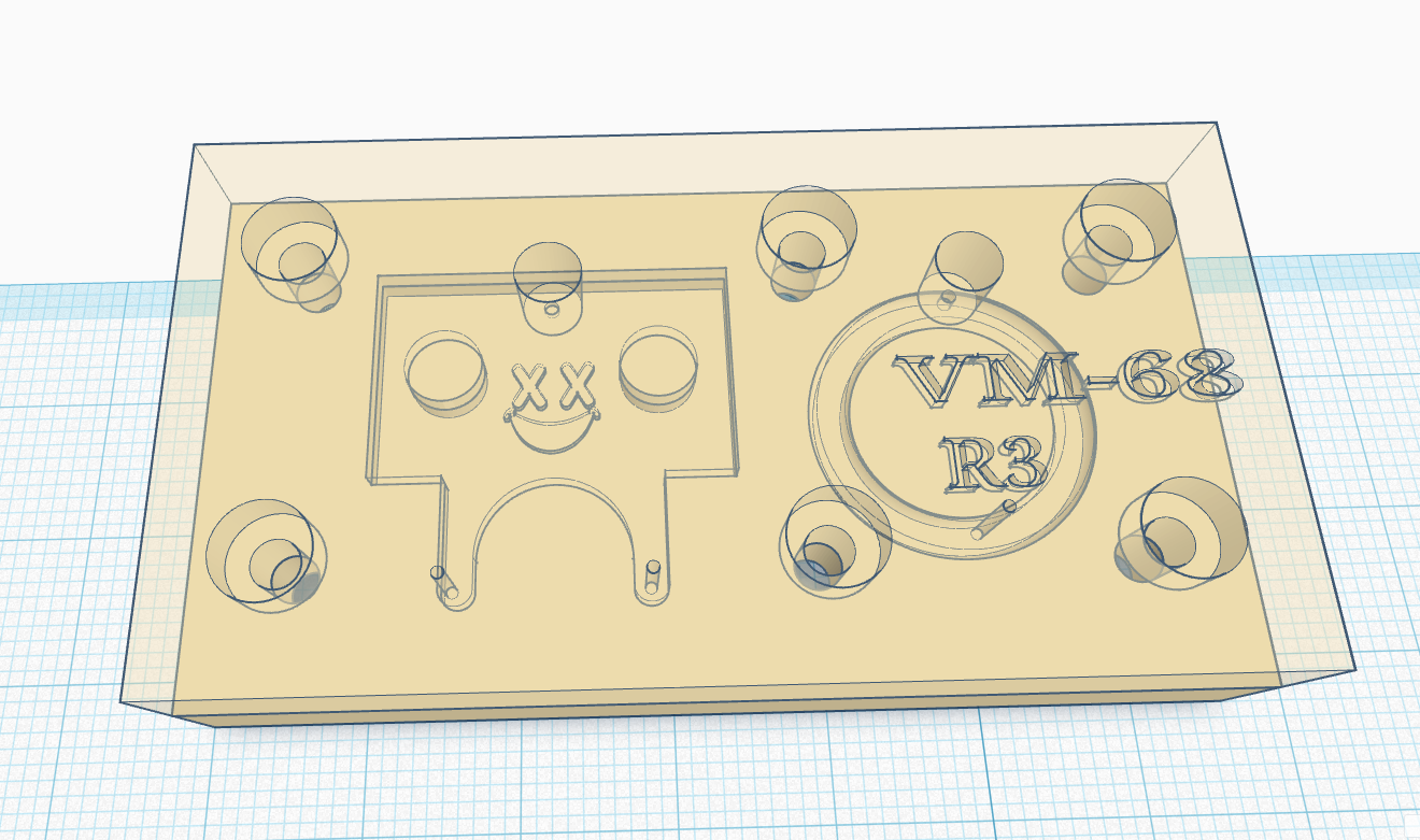

      Quick update:
      Added the VM-68 ball detent to the mold per user feedback on Reddit. Finalized the design, and should be sending out for the first mold within the next week. Click image for larger version  Name:	Screenshot_20260423_222916.png Views:	0 Size:	570.4 KB ID:	827905
      Still need a few people who want some O-rings and detents to test out. I'll ship them to you at no cost if interested.
