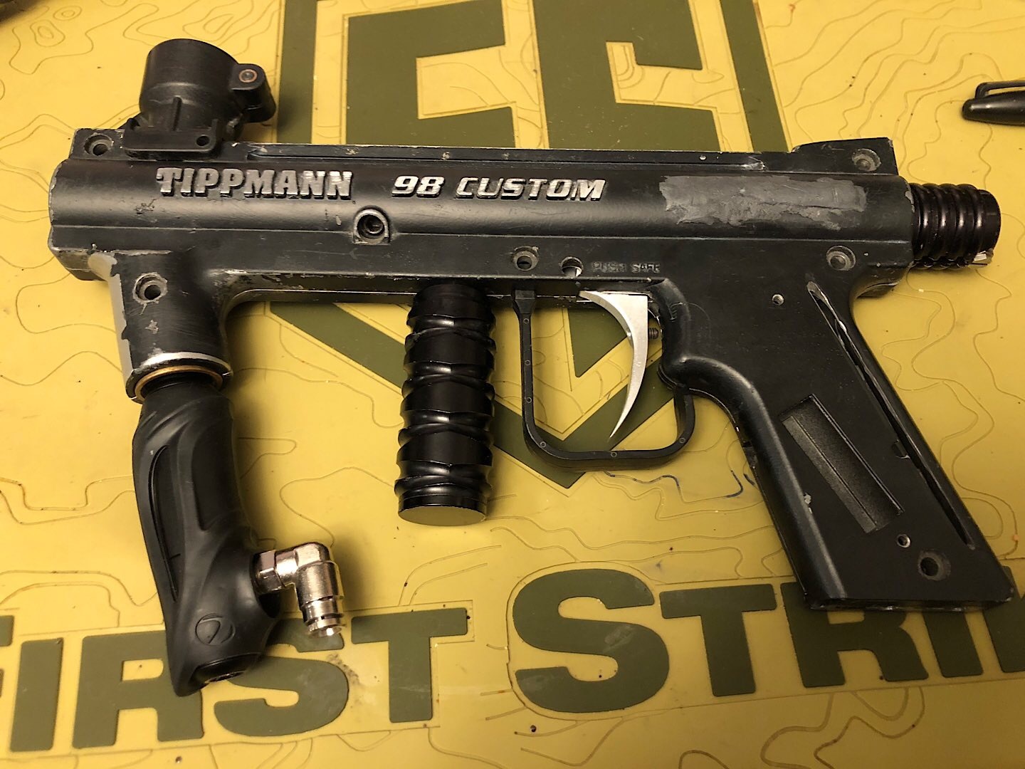

    Filled up the cocking window.
    Waiting on a package.

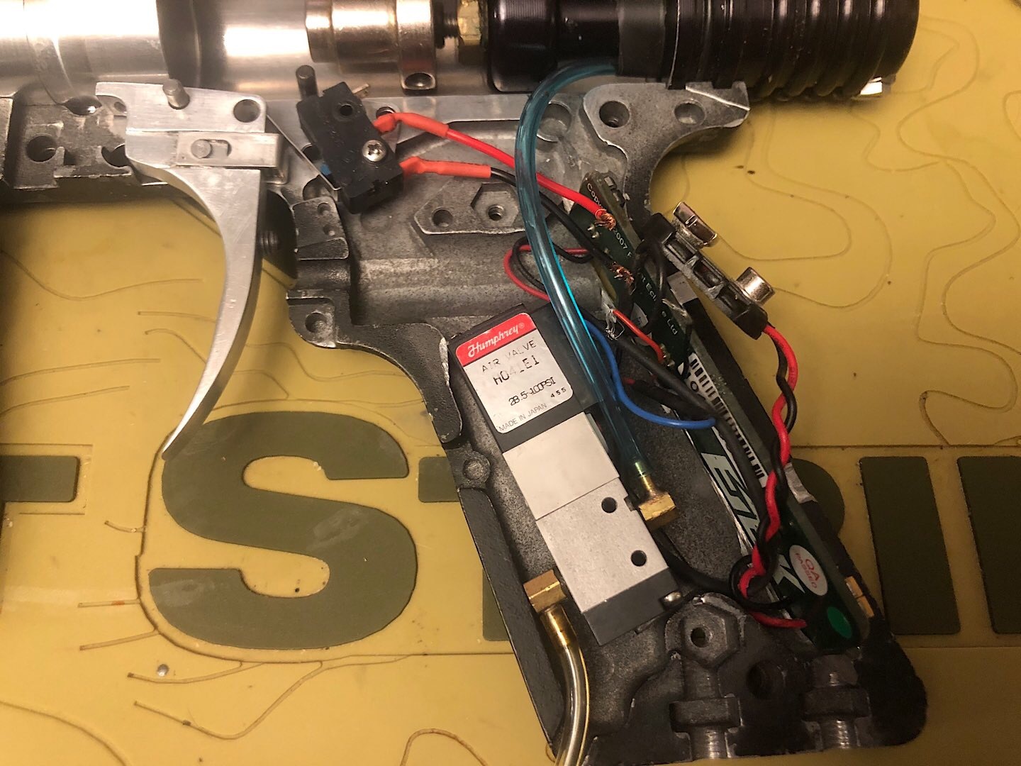

        Option #1
        Still waiting for the mail
        Option #2 in picture(No modification yet from previous owner other than filling)
        Need the slot widened for the board.
        Need a cut for the battery wires if I do it external.
        Need the switch wires soldered.
        Need button for the board.
        Board: Tested and work.
        Solenoid: Clicks, no air in it yet.

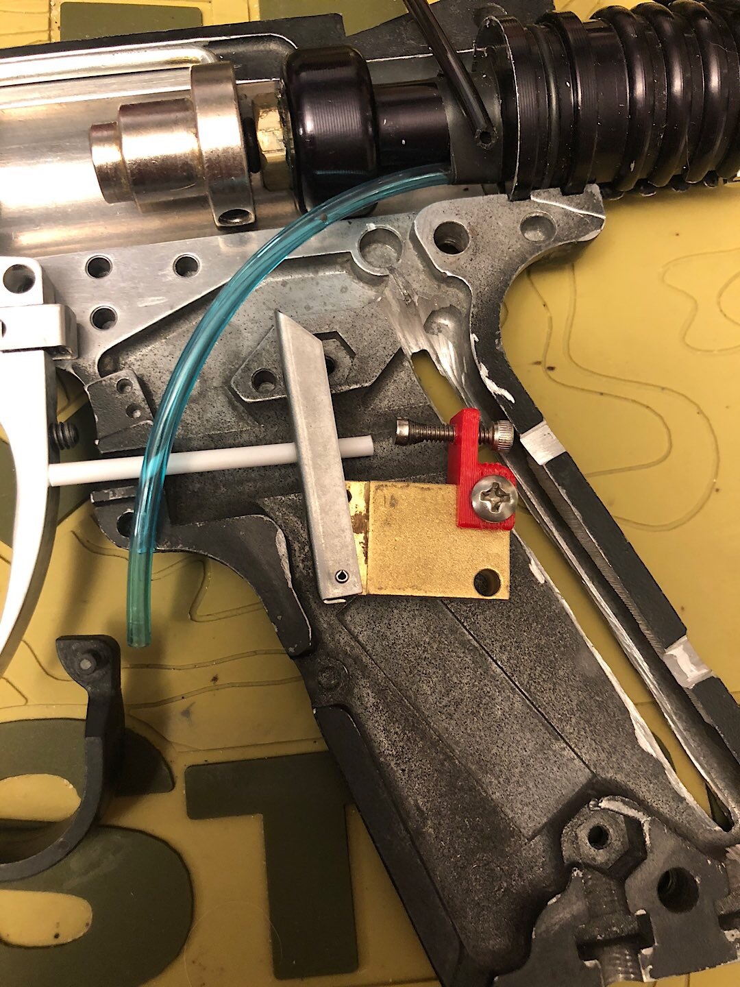

            #1 is gone
            #2 is on the way.
            this is surprising, there is an Etek board with a pimp solenoid.
            I need more barbs ... that tight space doesn’t like my straight ones.

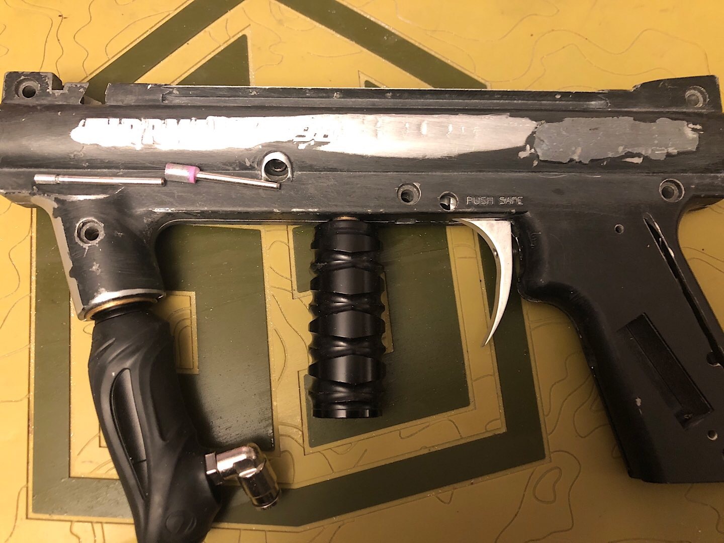

              Damn the cheap grinding bits hate doing the work!
              finally found something that grinds fast but can’t do smooth.
              • boarder2k7
                • 246
                • Laniakea, Pisces-Cetus Supercluster Complex, Virgo Supercluster, Milky Way, Orion Arm, Sol System
                Aluminum is too soft to grind worth a damn, it plugs up wheels like you see there. If working by hand you'll have better luck with a carbide burr and moving to a grinding wheel or file for only the finish work. You'll have less clogging issues that way.
