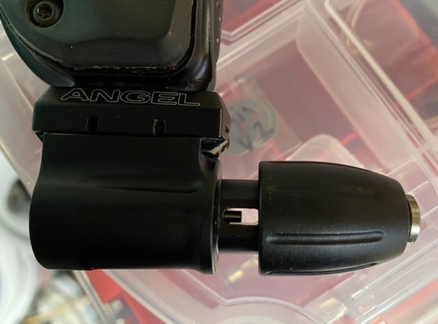

      Got my tank down to LP and looking back at the ASA and I’m confused. How does screwing the cover in push in the pin for the tank valve?! Me thinks I’m missing a piece.

        Cdn_Cuda commented
        Missing my cross pin. Now going to have to figure out a replacement part.... good thing I’ve got lots of random crap kicking around. Fingers crossed I’ll find something that works.
      • 4560
      Cut a the end off an old Allen key to replace the missing part. Was a little too thin and didn’t engage the pin well enough but a little hockey tape fixed that issue. Tightening the on/off now engages the pin properly. Now just recharging the battery and if I’m lucky I have enough air in my now LP tank to shoot!

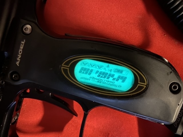

        • 4560
        Battery has charged up but now I get a flashing screen. Any ideas of what I’ve done wrong?
          Cdn_Cuda commented
