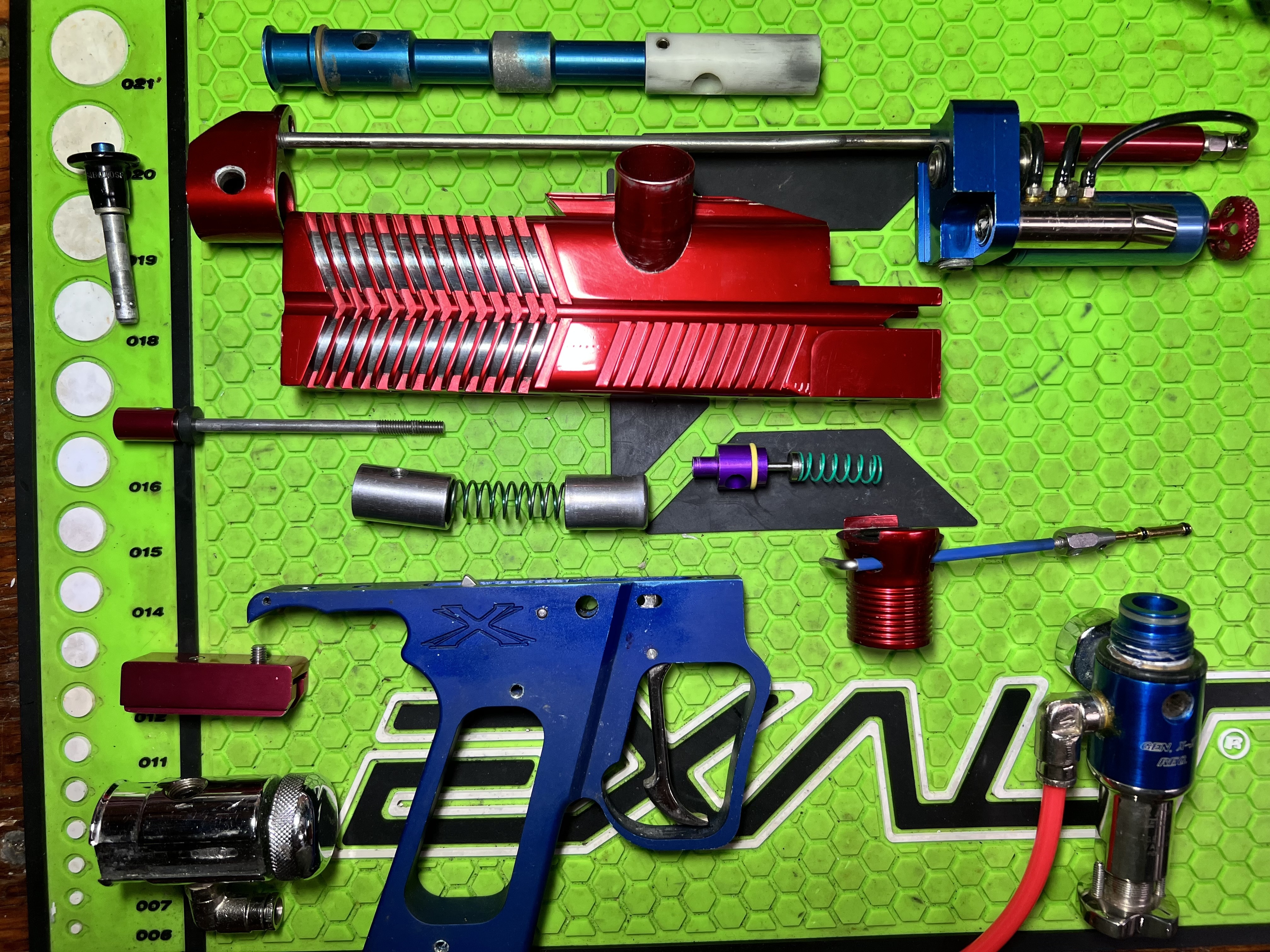

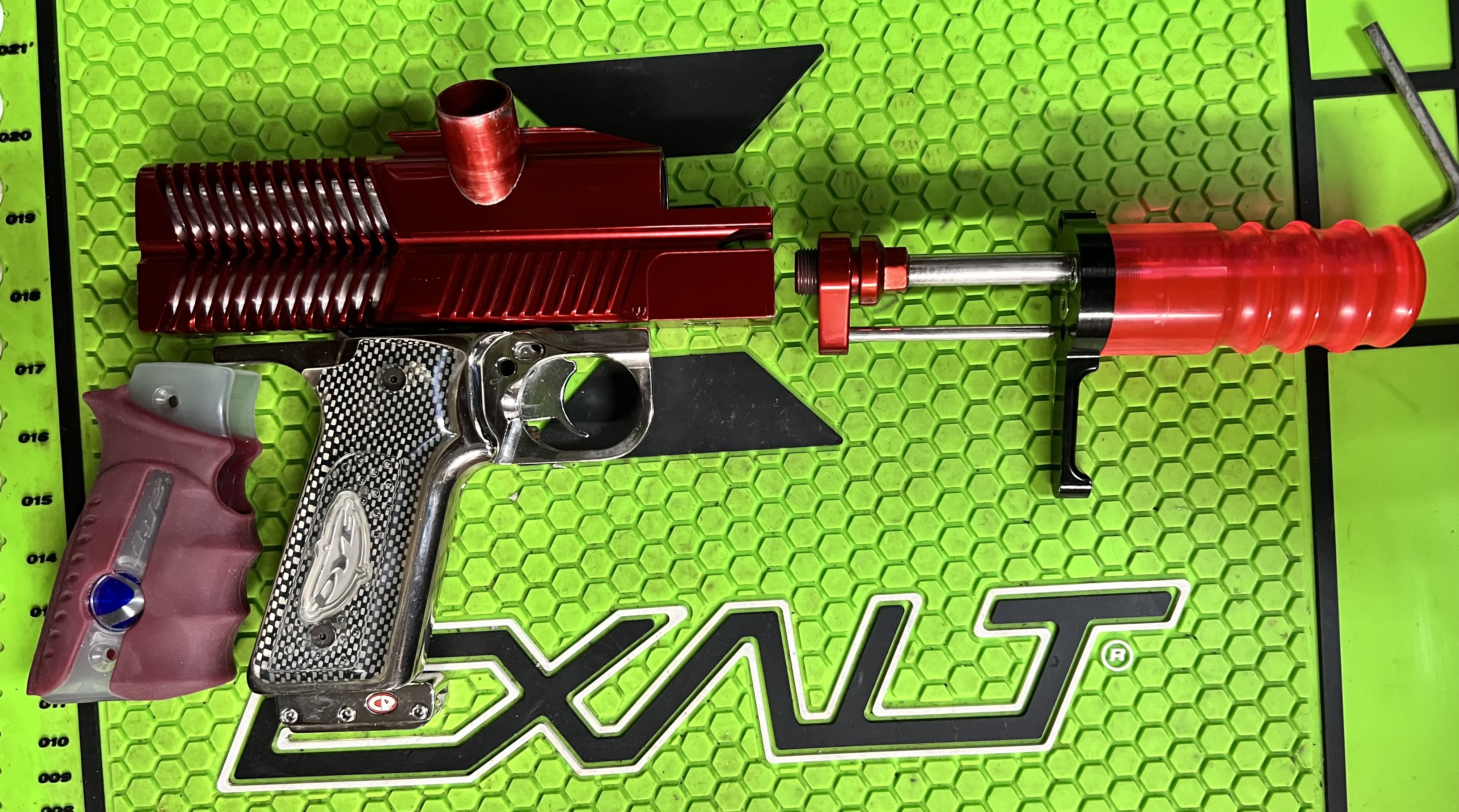

      And here we are in bits and pieces!
      Click image for larger version  Name:	IMG_5392.jpg Views:	0 Size:	3.52 MB ID:	796853
      So has what looks to be a Shocktech Rat valve, an unknown unthreaded RVA, and stock hammer.
      Front pneumatics look to be a WGP ram, Oracle 3-way and a nice Palmer LPR. All needing rebuilds.

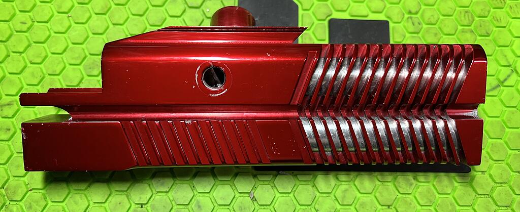

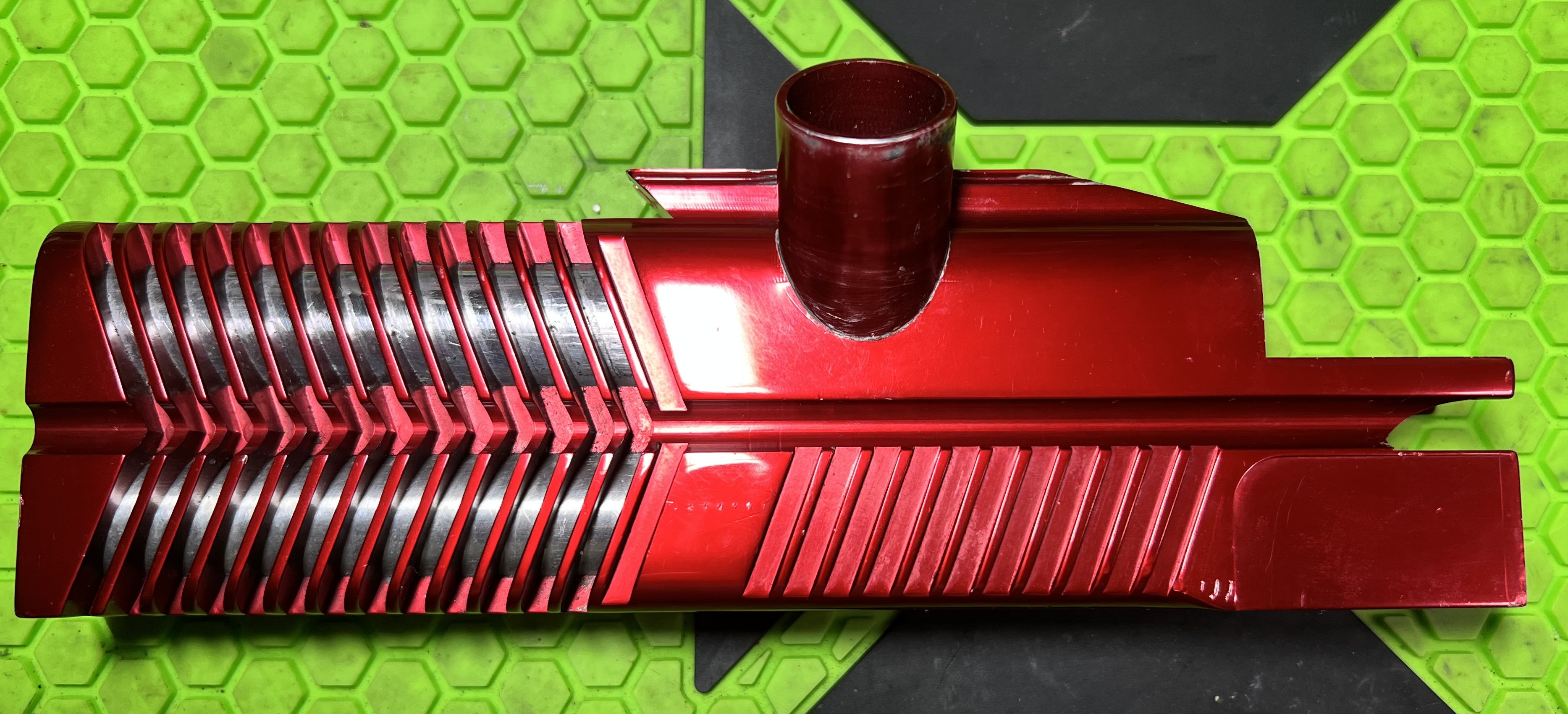

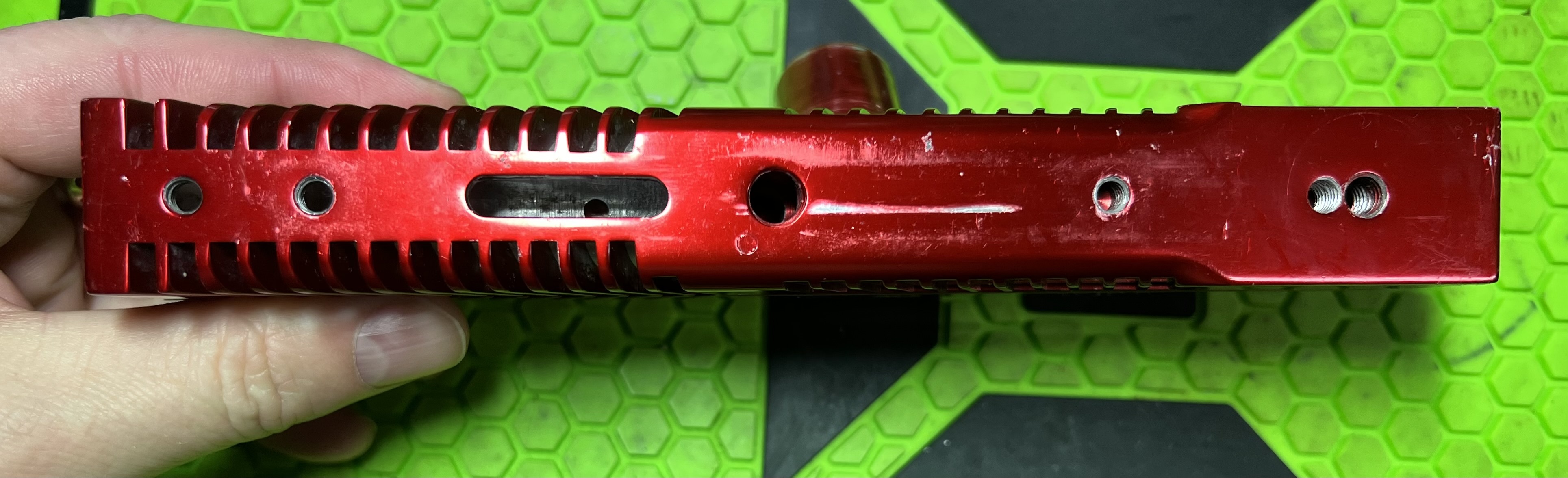

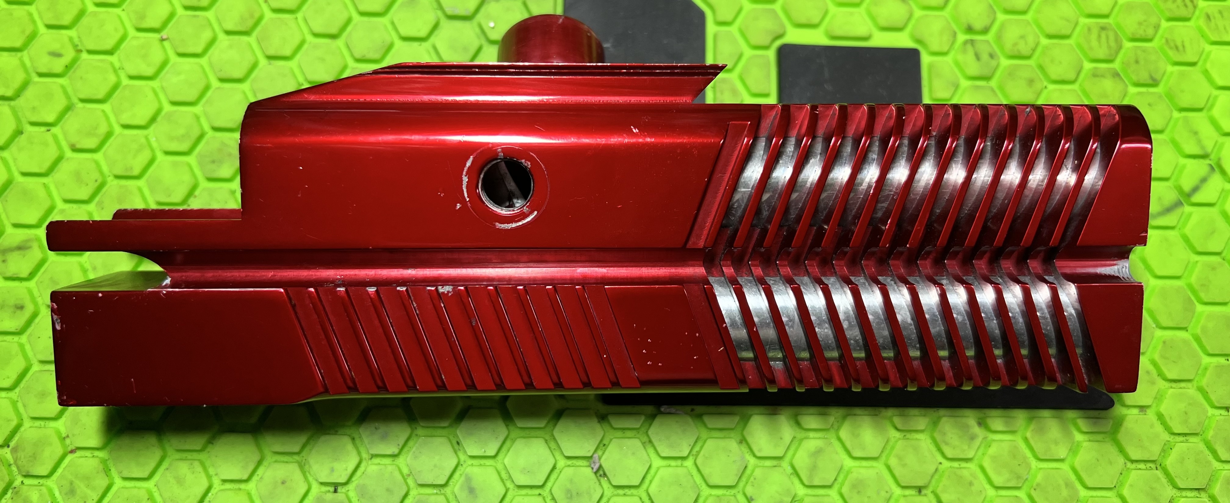

      And after a bit of cleaning, here is a better look at the milling on the body. It’s more impressive than I originally thought. This is the first time I’ve had a fishbone in my hands.

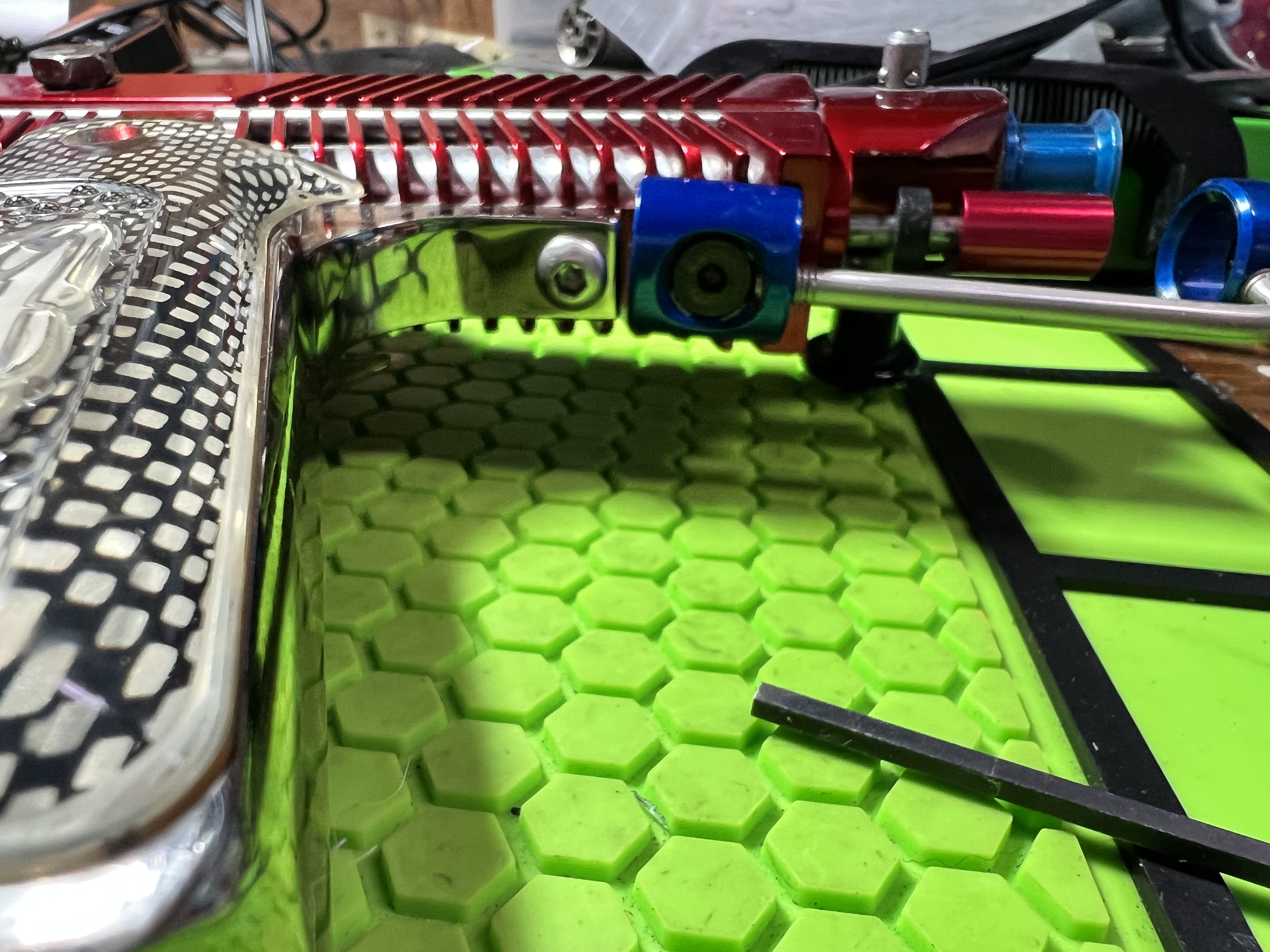

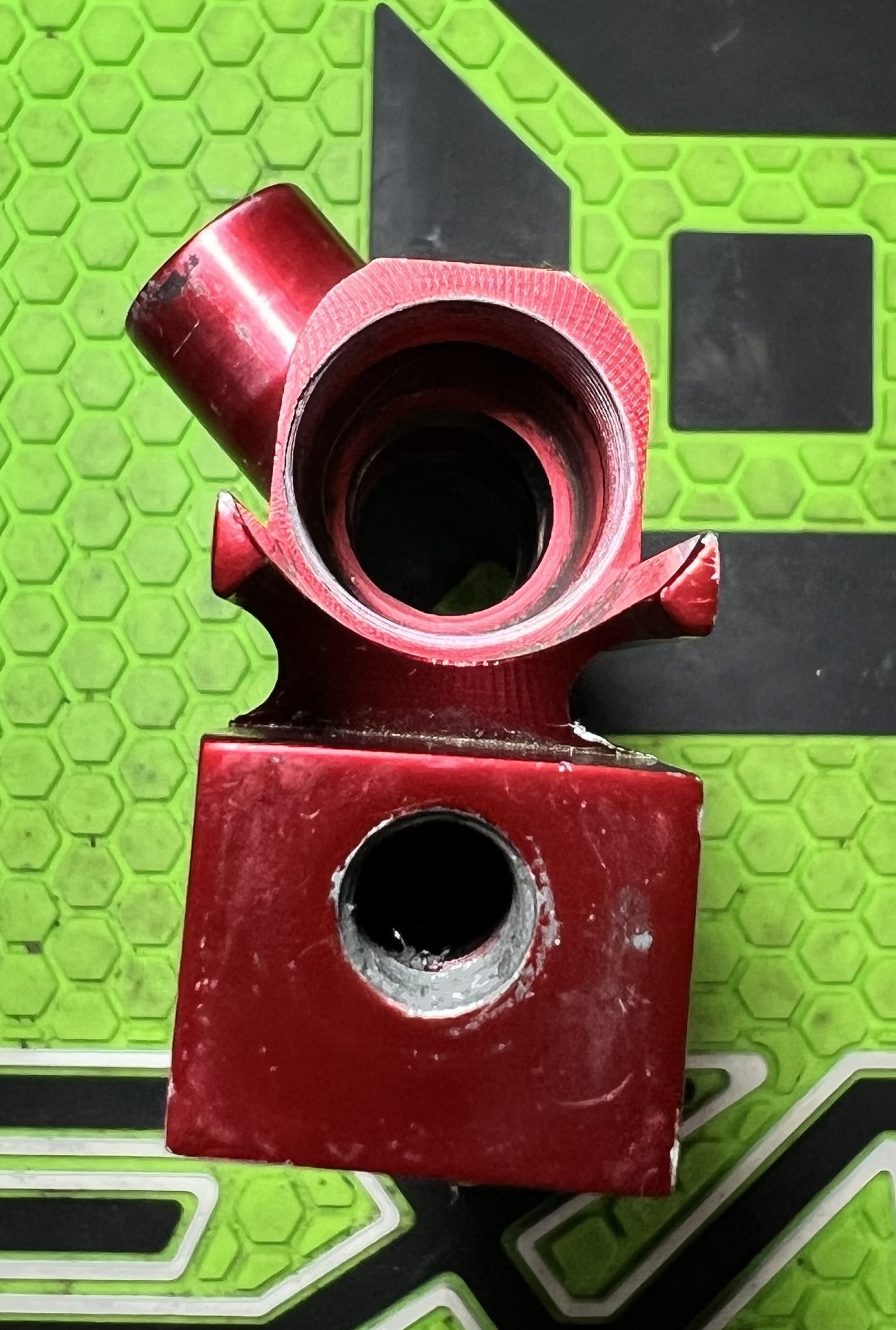

        And the front and back as well. The front has extra milling by the barrel

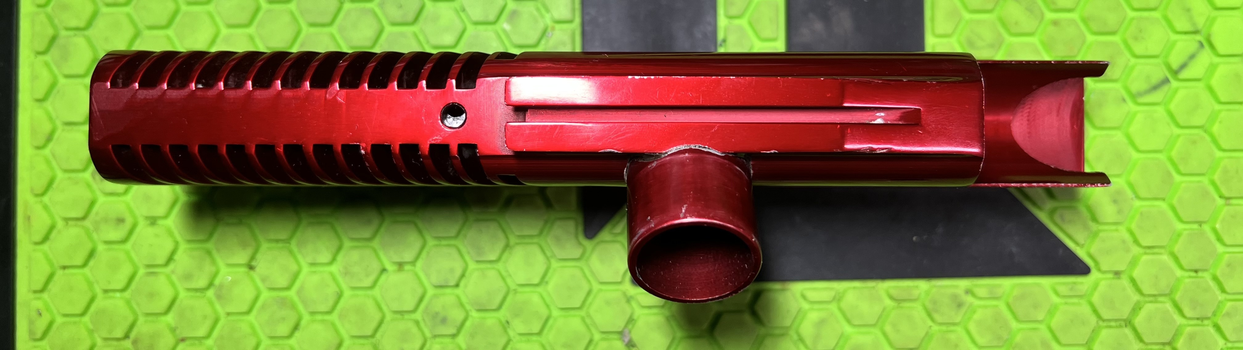

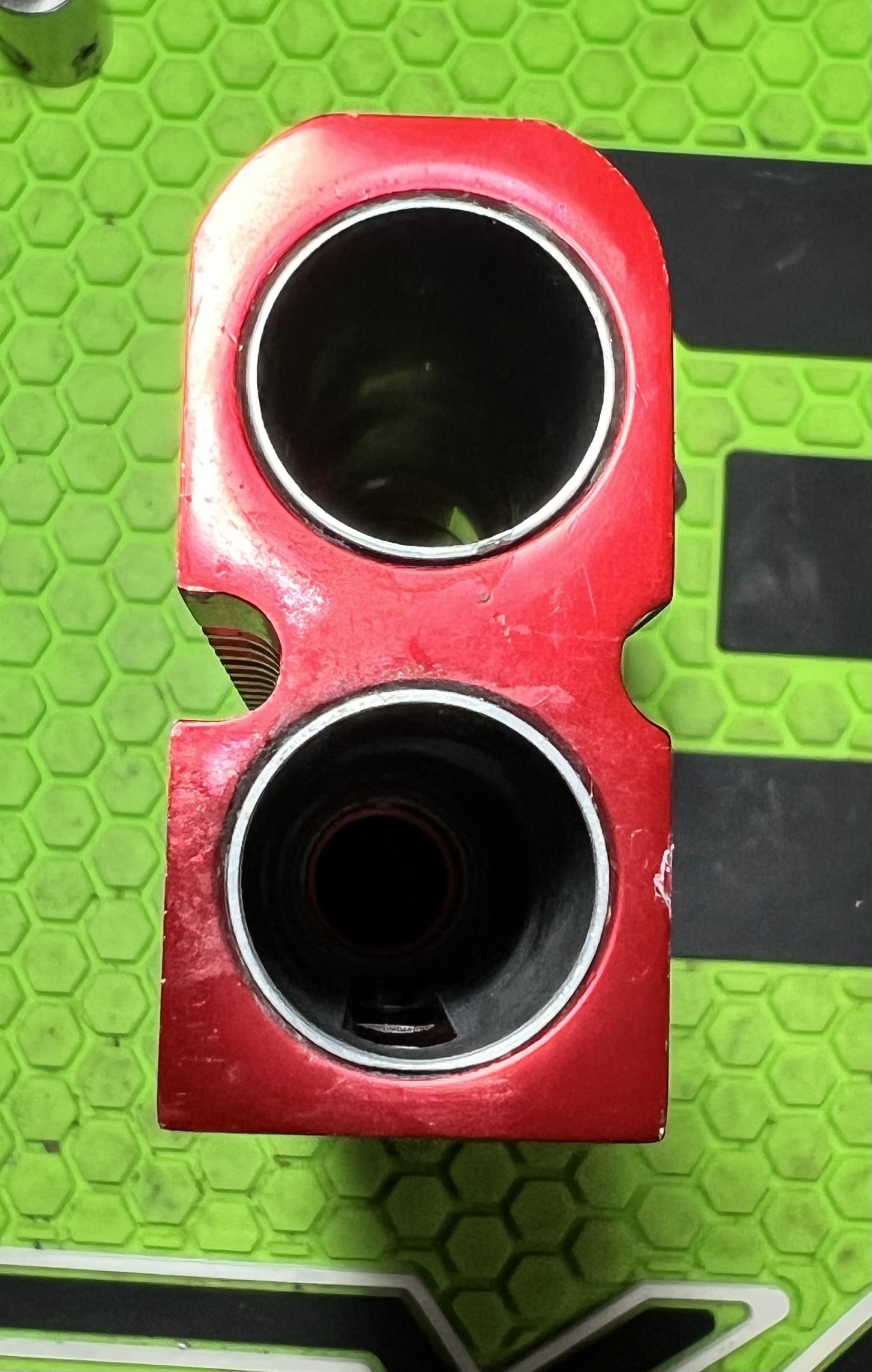

        And the back you can see the tubes pressed in,
        • Folly911
          Folly911 commented
          I'm just seeing the opening of this for the first time..... Unbelievable, never knew it didn't have jam nut threads
          Cdn_Cuda commented
          Folly911. It may have had them but if it did the threads are stripped.
        • 4560
        UPDATE: The lower tube does have threading for the jam nut, the marker just didn’t have one.
        Now I was thinking about a modern overhaul, maybe even a Nova valve but there is no valve nut on these markers. The tube does not have any threading for it. So I may use a CCM valve I have kicking around, or the Rat valve if I have an o-ring that will fit on the valve pin.

                I was incorrect. It does have threading for a jam nut. Whoever built it last just didn’t put one in.— or maybe it’s stripped. Can’t get the nut to thread.

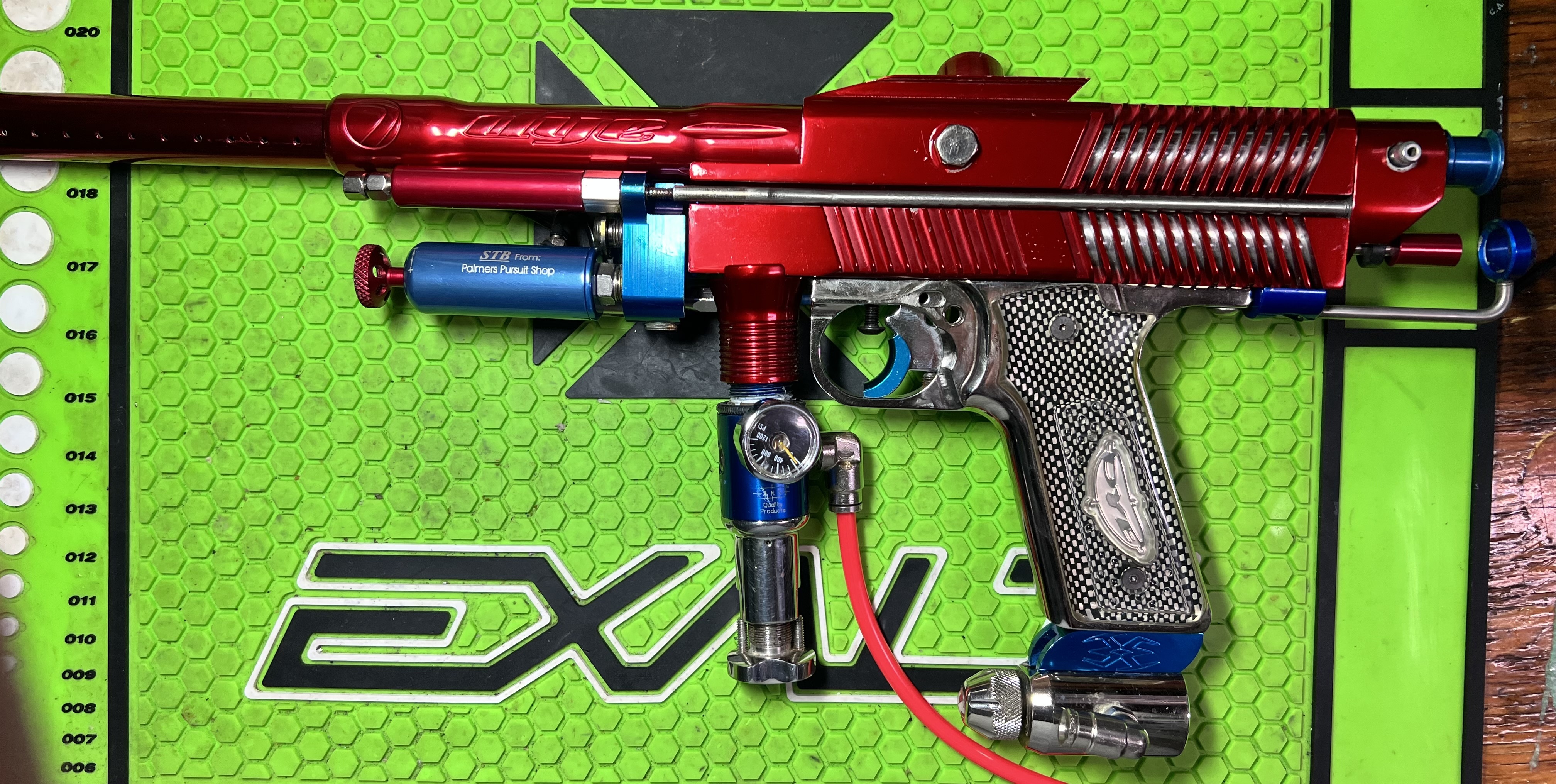

              Playing around in my parts bin yields me this option. It’s a 2k pump kit but give an idea. Still not sure if I want to be mech of pump. I own more pumps than mechs though.
              Click image for larger version  Name:	IMG_5423.jpg Views:	35 Size:	2.63 MB ID:	797977
              Definitely like the Chrome Slider with the body though.

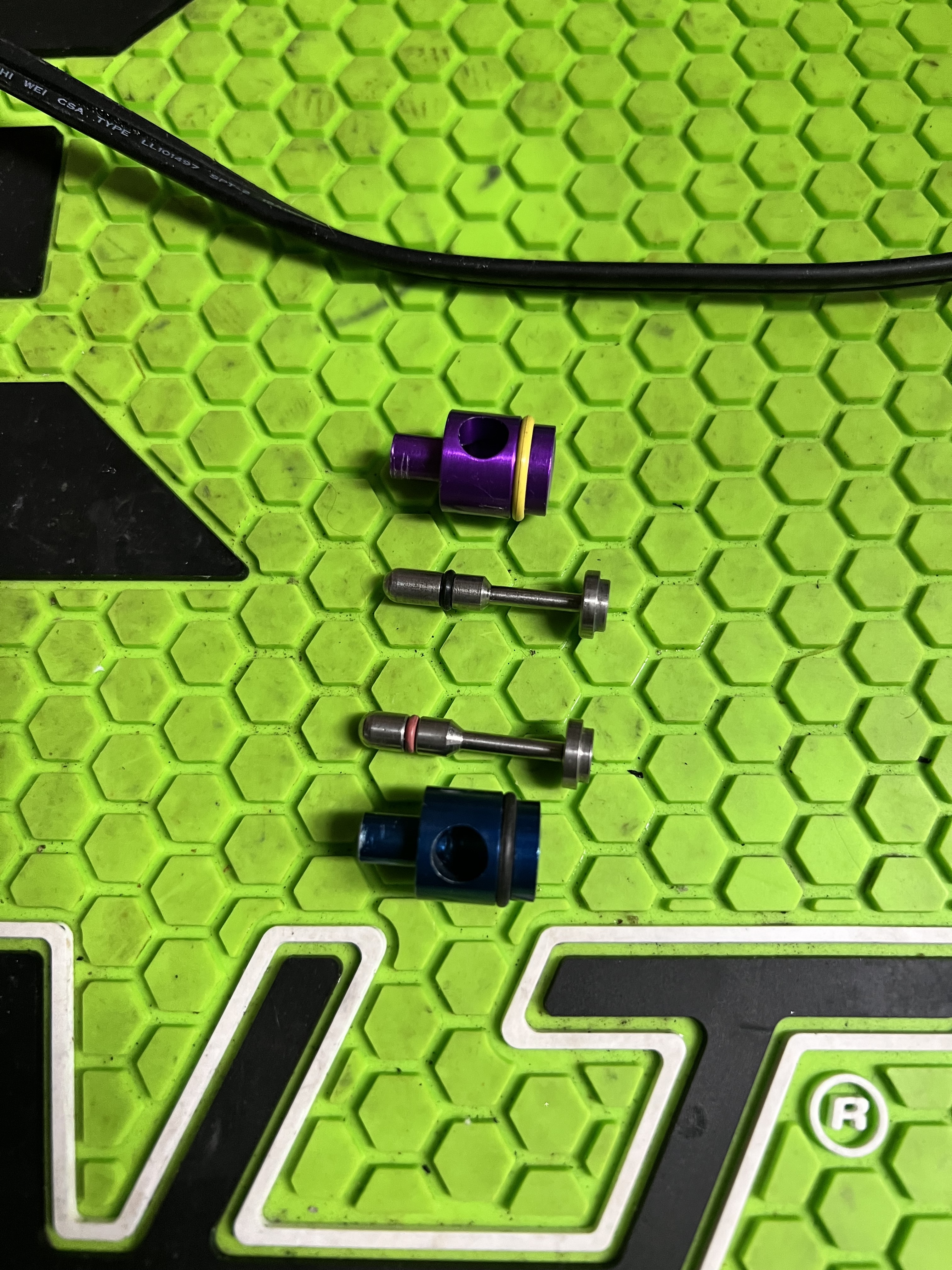

                Now onto the fun part, getting the internals
                sorted. Turns out my spare valve also appears to be a rat valve with a slightly different stem. The purple one is the original one from fish, the blue one is from my parts bin and several replacement seals!
                Being this was a Superman build (and still might be) goi g with the blue valve now with the springs that came with the fish as I assume they will work fine.

                    • 4560
                    The slider really helps show off the Fishbone milling. The swing frame was wider so obscured it more.
