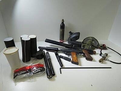

Am i crazy or is that a F****** Brass eagle eagle?
  • Filter
    Im bid on it .
    046- Assorted Paintball Lot Please check shipping price- Estimate Shipping before bidding: We use USPS for shipping services. Item:046- Assorted Paintball Lot Additional Information: 2 Markers 1 Mask Accessories All...
    Yup.... Not crazy.
      so either their are 12 total now instead of 11 of these or this is one of the 11 that was never returned to brass eagle for its recall. very cool piece of history, hence my excitement. its fitting its would get turned into goodwill. hey atleast it wasnt the dump.
        Production numbers are hearsay.....

        I like the upside down CA adapter, perhaps an attempt to get liquid CO2 from a tank to try and get it to actually work. Luckily it also has the proper extended 12 gram knob in the lot.

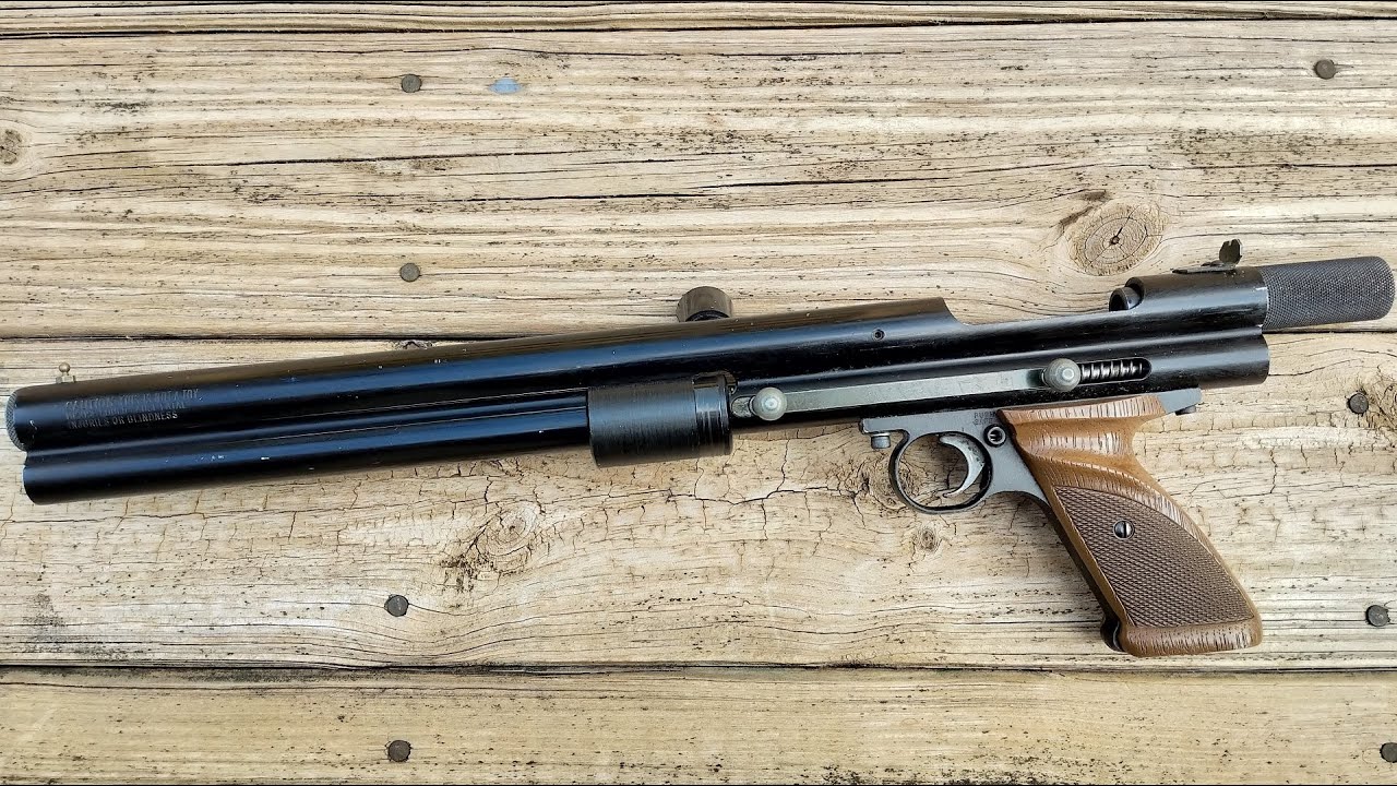

              For fun, here's mine, Cycling! I had a whole teardown thread I think on the old MCB, but did not recover it

                        Originally posted by Diomedes View Post
                        ...can anyone explain the significance of this, the backstory?
                        The Brass Eagle pumps used Crossman valves, not daisy (Nelson) or sheridan. They look similar to nelson-based guns, but the hammer sits behind the valve, not in front.
                        A quirk of crossman valve guns is that, with lots of use, the valve seal starts to wear out. The effect of this is that when you fire the gun, a small blast of co2 will also hit the hammer.
                        Over time, this blast gets larger and larger until its enough to make the hammer move, creating the unique "Brass Eagle burping sound", aka hammer bounce.
                        So in 1988, the Brass Eagle engineers though "What if we make the hammer bounce so bad..... its enough to recock the gun??"
                        Well, then the Brass Eagle "Eagle" was born, make from modified pumps. The idea in principle is solid, but they should have started a new gun from scratch

                          Made from brass eagle nightmares to be exact
