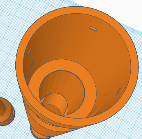

    So I know several guys who want to try paintball and bring their kids (ages 10-14), but they worry about the horror stories of huge bloody welts. I needed more 50 .cal markers to get them on the field, so I made a .50 cal conversion kit for a sniper.

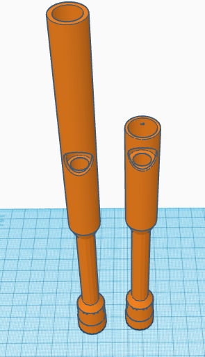

    The bolt extends past where it normally would, and has a drop hole in the top. When the pump handle is forward it slides into the opening of the barrel sealing the drop hole. I also made an insert for the hopper. I also put tiny nubs in the bolt as a ball detent.

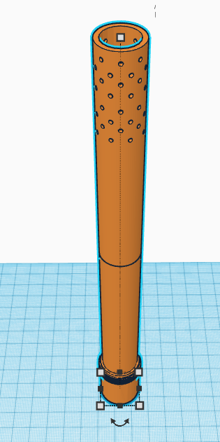

    I shot about 100 rounds and only had 1 break. Once I sand down the barrel, it should stop the breaks.
    I made a second bolt that extends inside a normal .68cal barrel, so from all appearances it looks like .68 cal, but really it is .50 cal, thought that would raise some eyebrows at a actual field with refs though.

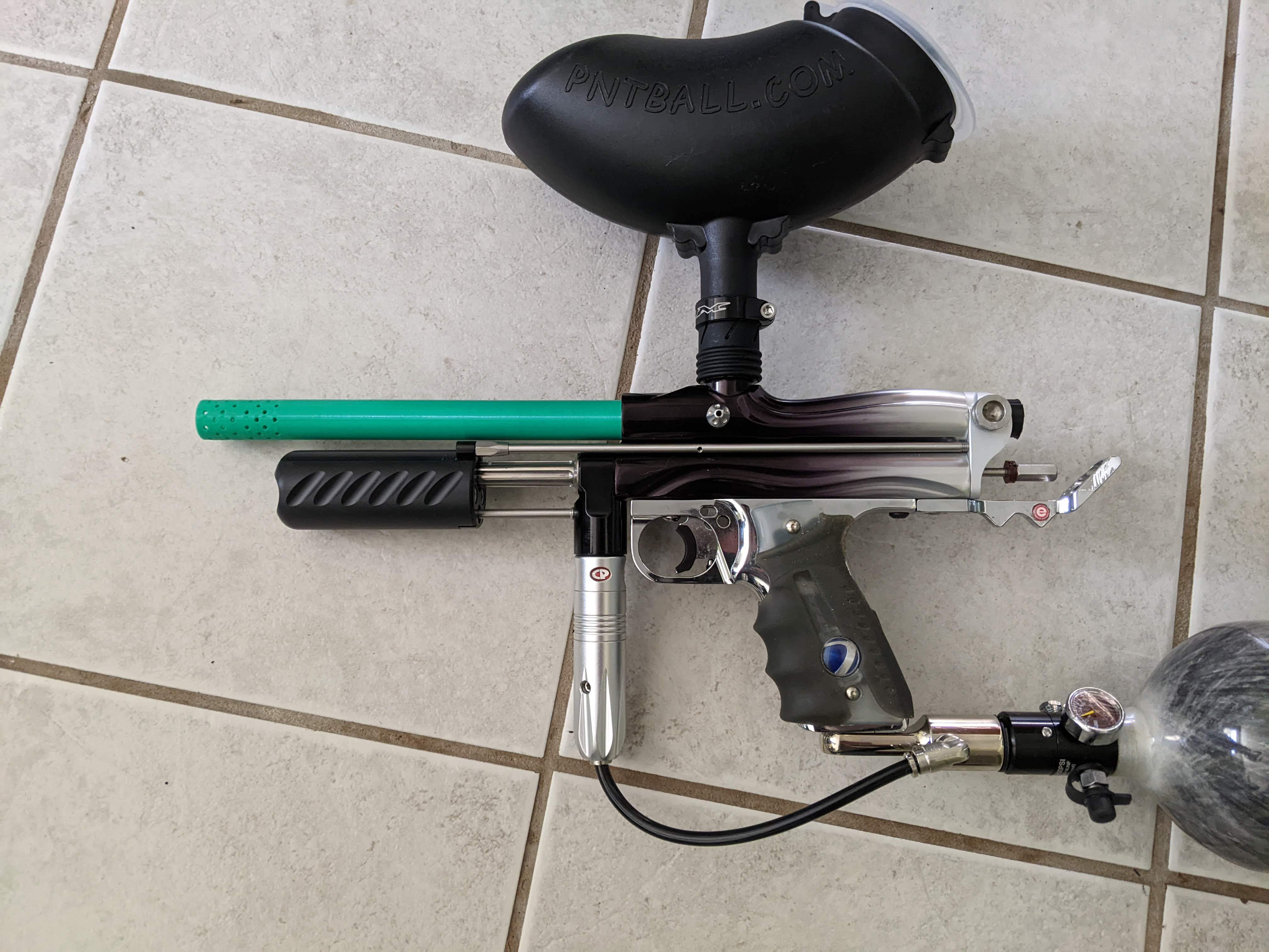

                      So I worked on this a bit more and I got it working well, but I was still having problems with barrel breaks. Sometimes I could get quite a few shots off before I would have a break, but the .50cal was not easy to swab since I didn't have one made for that. Also, if I had a swab I didn't think the barrel/bolt would clean well as it is not as slick as metal. So I contacted PE and long story short I had to buy a Etek 5 conversion kit to get a cocker barrel (They were absolutely great and did give me a bit of a discount since I didn't care about anything but the barrel).
                      Anyway, I made a new bolt and ended up creating a drop in insert for the chamber so the ball was level with the barrel. It worked well, but I was annoyed that due to the small opening on the bolt I had to really crank up the FPS to get up to 280fps. Well, I was working on that problem when I screwed up and some how in my haste shot some .50 cal out of the gun and it worked perfectly! In fact it was shooting way too fast. I then realized I didn't swap out the parts and I was using all .68cal parts with the .50cal barrel. So I did some testing, and it worked great, if I tried pumping super fast (autotriggering on a empire sniper) the ball would not make it into the barrel properly and pop. However, normal non-auto trigger play was perfect! I went and played some games with it and we had a blast, but they quickly wanted to upgrade to .68 and I haven't touched the barrel since!
                      So in my experience all you need is a .50cal barrel.
