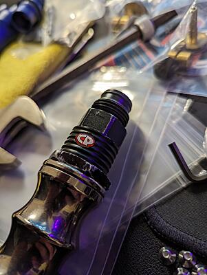

    Working on a mid 2000s regulator today, before the industry really started putting a hex in the top of the reg to take it apart. So, had to grab the top end with some pliers which left a small mark and it occurred to me, why has nobody made something to clamp the top end of a regulator?
    I'm thinking about chopping a ASA in half and putting it in my vice to hold the top end of a regulator but figured I'd ask if anyone has ever made a block of aluminum/steel to do this?

        Lol, was sitting here thinking about it and was like, I have spare asa's and a flex shaft so I just went and made one. It works great. Not sure why it took me so long to think this up
        minimag03 put the reg in the two halfs of the ASA, put the ASA in the vice that way because of the cut in the ASA the vice can allow the threads in the ASA to clamp down on the top of the reg and I avoid putting any marks in the reg to hold it tight

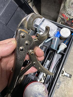

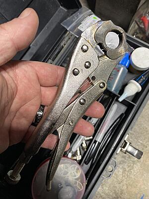

              I have Vice grips with a ASA threads welded to them I use. I got it from SSC years ago.

                Got a picture? I kind of want to see this

                    • 6378
                    This is the one SSC made back a while ago. I don’t recommend ordering anything from him that’s not in stock. But he made some cool Paintball specific tools.

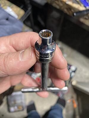

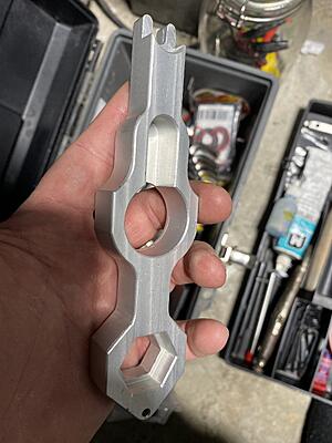

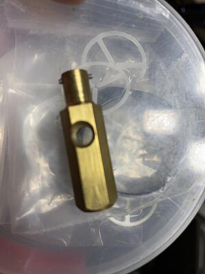

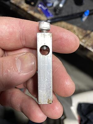

                    I love tools that make my life easier.
                    1.Piercing pin removal tool
                    2. CCM AT cam lock (only way to do it)
                    3. Feed Neck removal
                    4.VASA tool (annoying odd odd shaped bolt on old cockers)
                    5. Reg removal tool
                    This gallery has 5 photos.
                      I contacted SSC a few years back about some of these, but he's no longer making them. I ended up just picking up a brass CGA320 nut and had it cut in half and braised on to some vice-grips. Not as pretty or strong, but it's brass, so less likely to cause any cosmetic damage.
                      I can haz feedback?

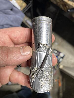

                        Brass I bet works even better. You still need to be careful with mine because it can damage the threads due to the mechanical clamping force you can apply. I won’t use it for removing bottle regs it will strip the threads out for sure.

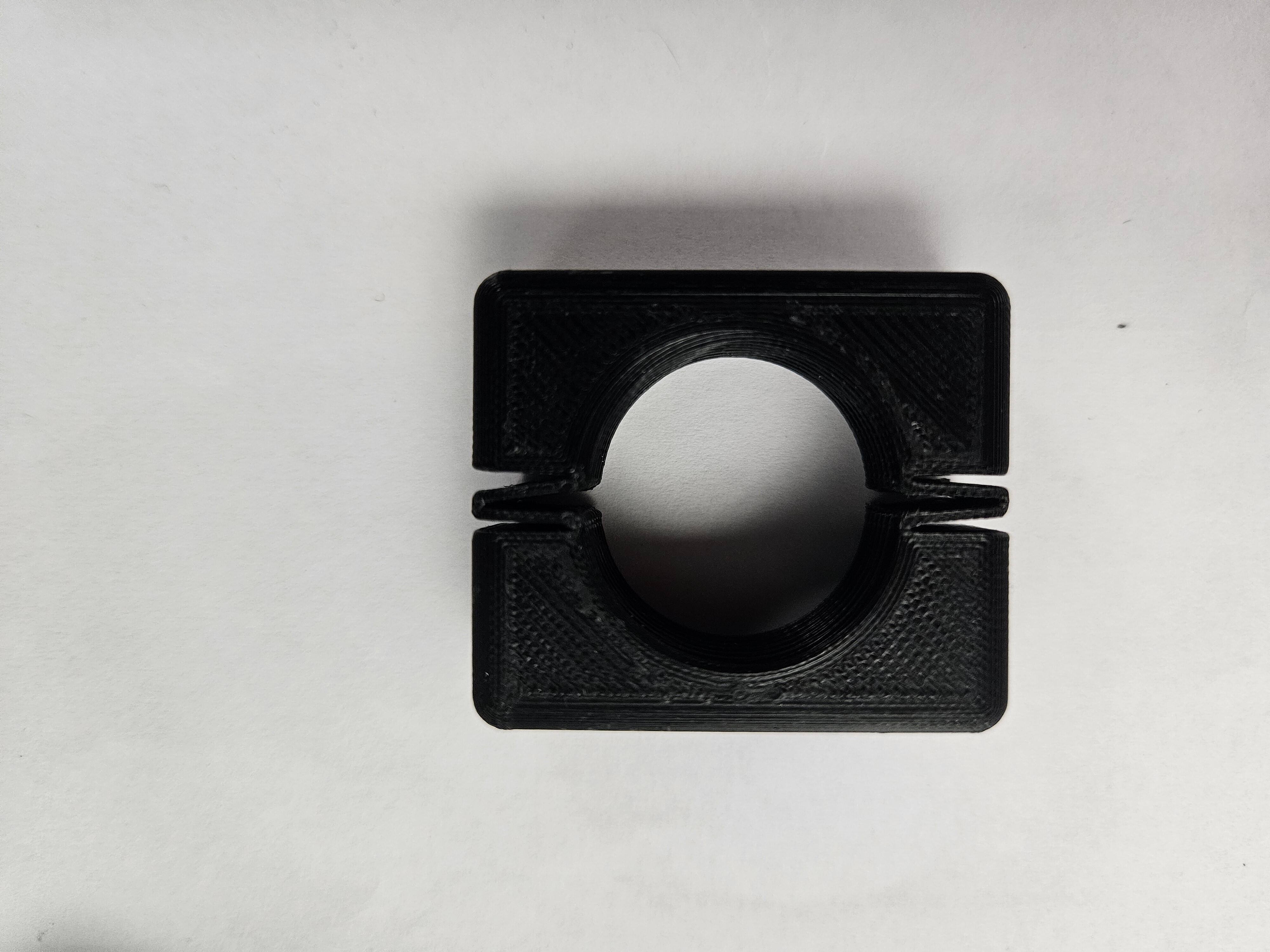

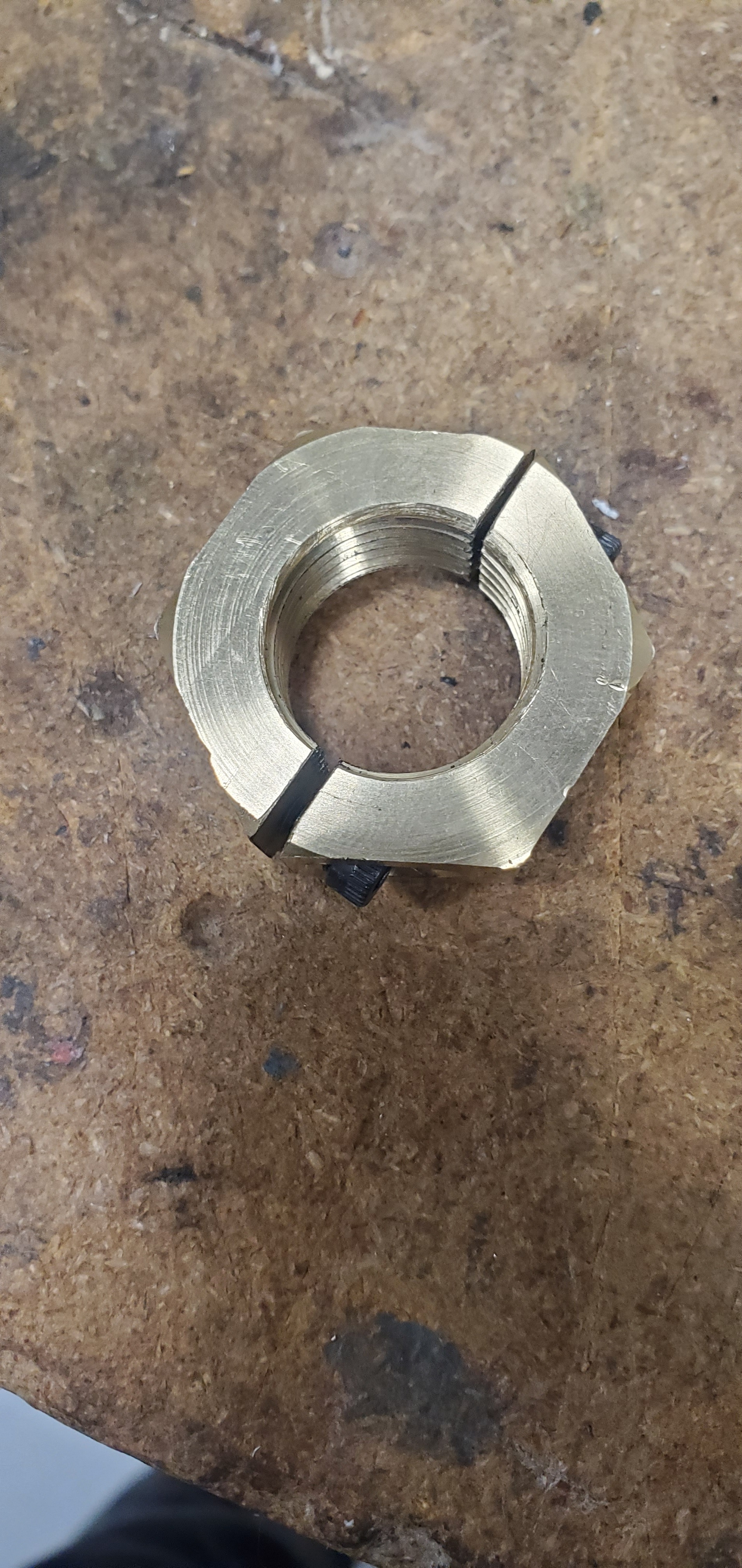

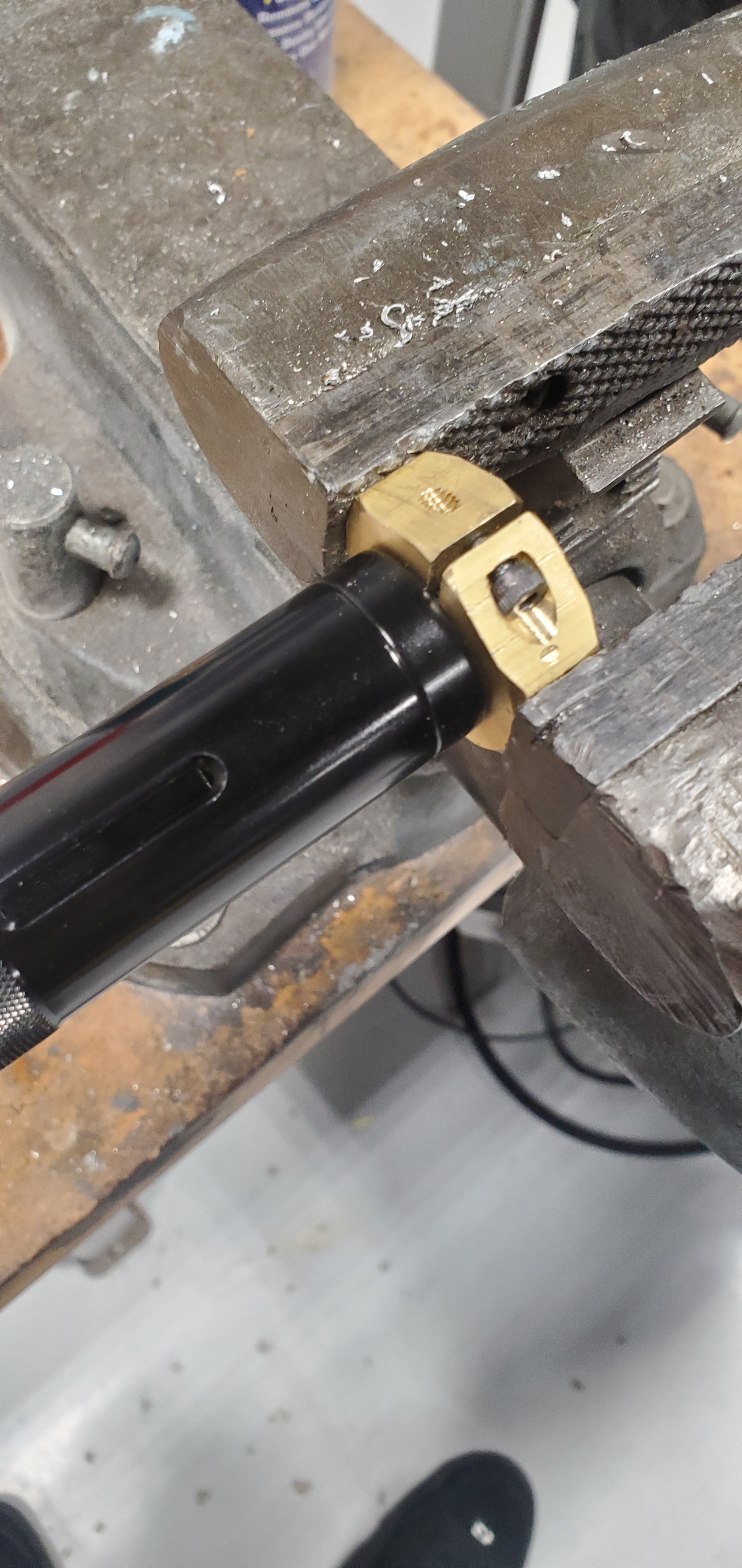

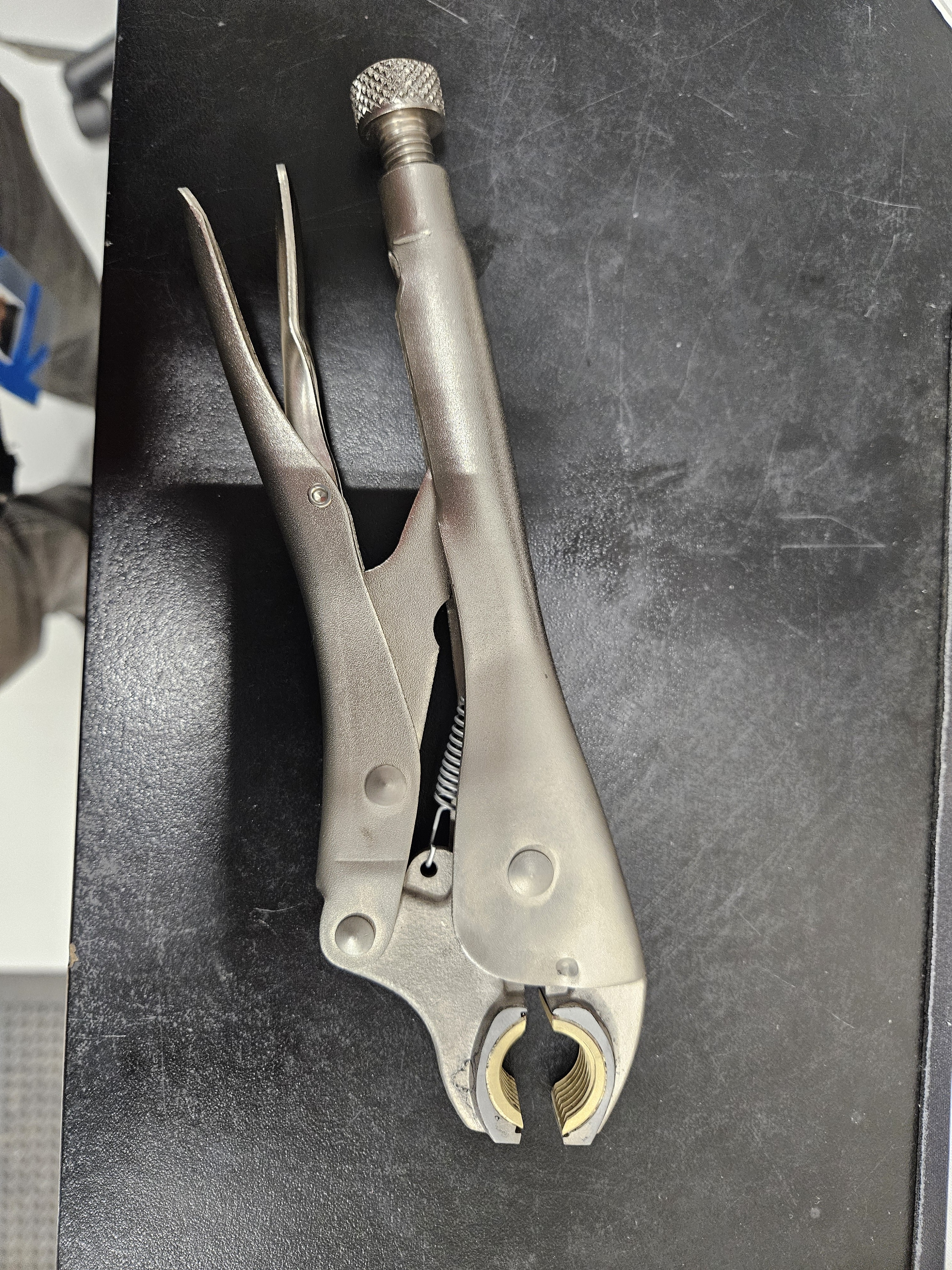

                      I've made a couple different styles for myself and friends.
                      A 3d printed threaded block with a flextures for holding in a vice or with knipex parallel jaw pliers. Same idea with the split brass hex stock, the screws are just to hold the two halves together.​
                      A copy of the SSC vice-grips, but with brass jaws.
