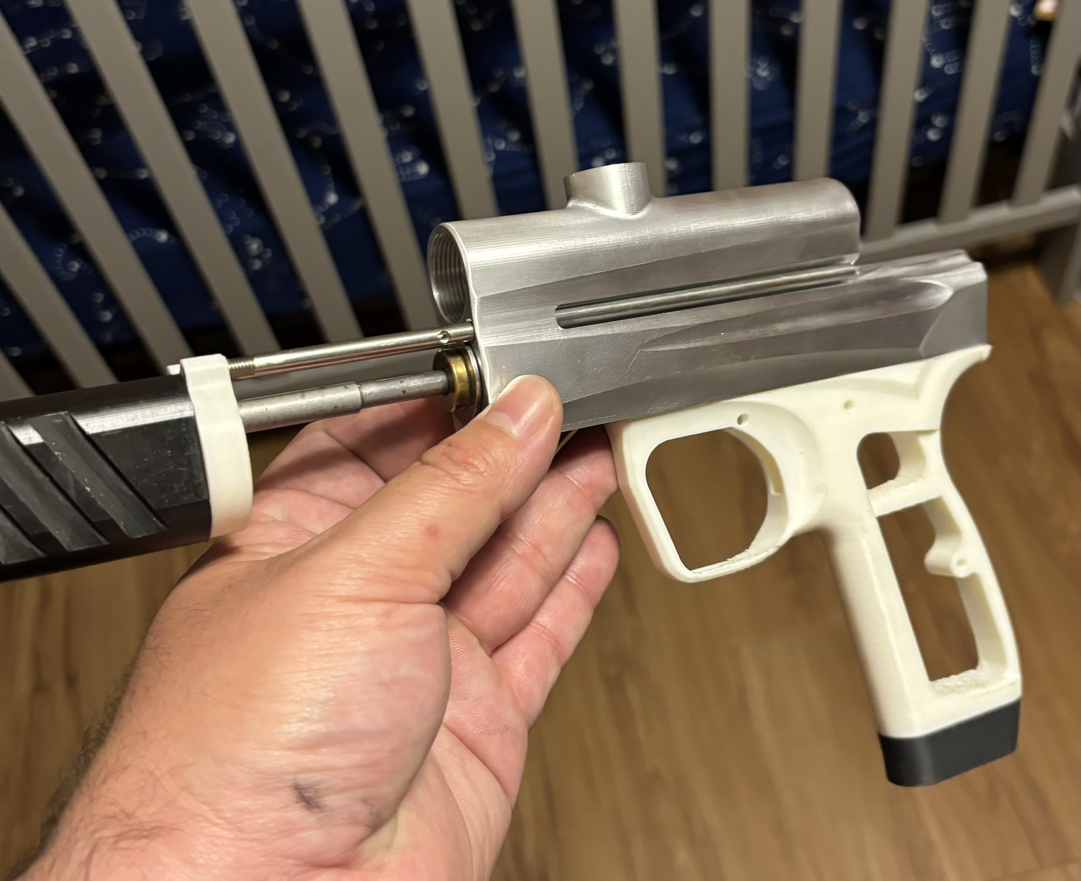

so I designed a hybrid. Sterling in all the ways that mattered, with refinements that make life a little better. I made the valve independent, now secured in place by 5/16-24 grub screw, valve cap is ASA threaded so a port reducer with gauge can be installed or 12 gram charger or any other air source (if you so chose). 86 frame up-scaled to fit my murder mitts. Will have three guide rods (two routed through body channels connected to back block), one driven into the pump handle. The guide block for the hammer catch assembly was elongated and has two treaded ends for oil filled bronze bushings that are easily replaceable (should they ever wear out). Gas thru frame, and will have Bob Long/Field one quarter turn ASA.
of course design elements are still being worked out on the fly. Frame is currently 3d printed but will hopefully be machined soon enough (as soon as I decided if I want to add an internal regulator or not). The pump handle adaptor is 3D printed as well. All a work in progress..
