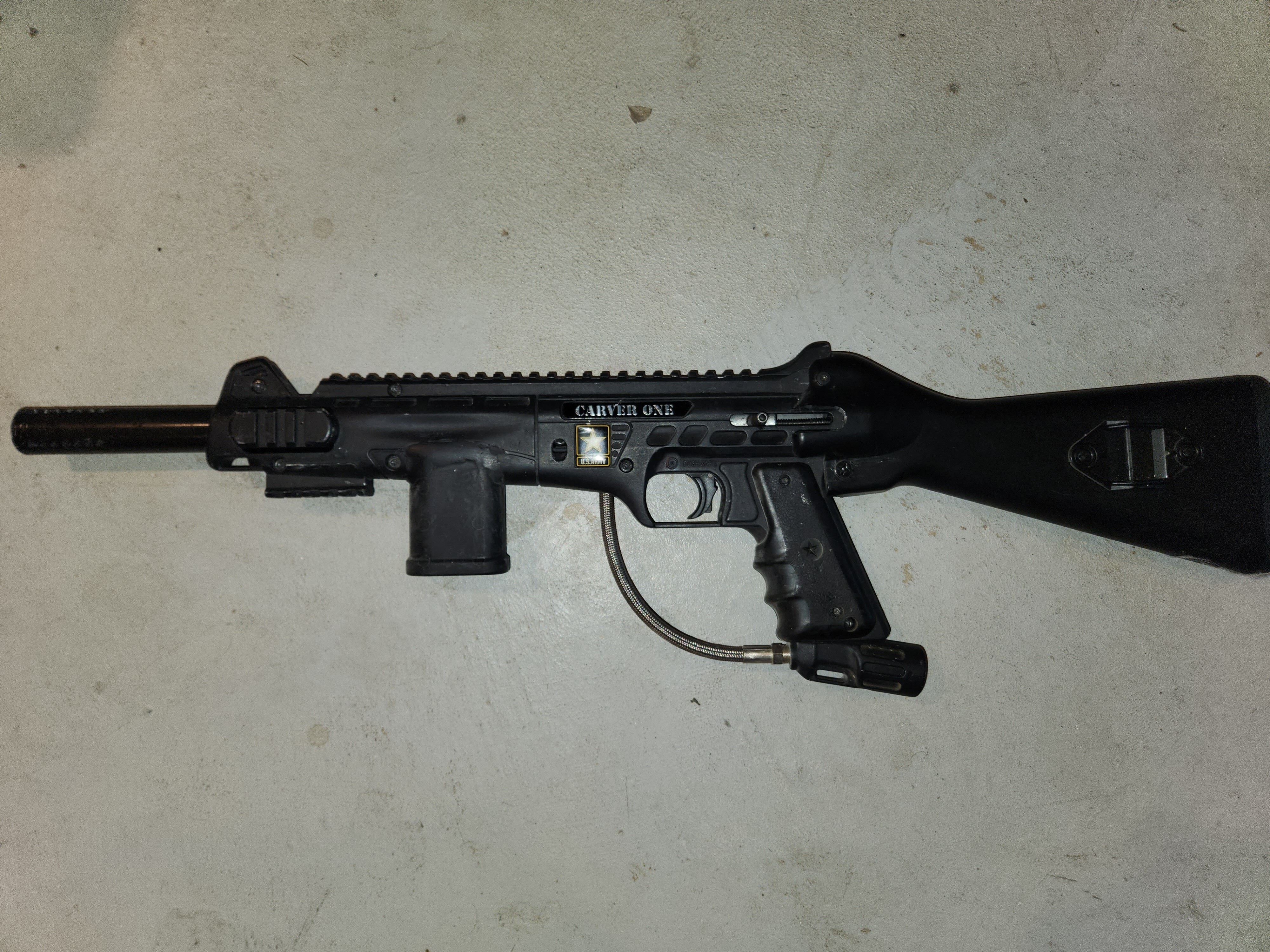

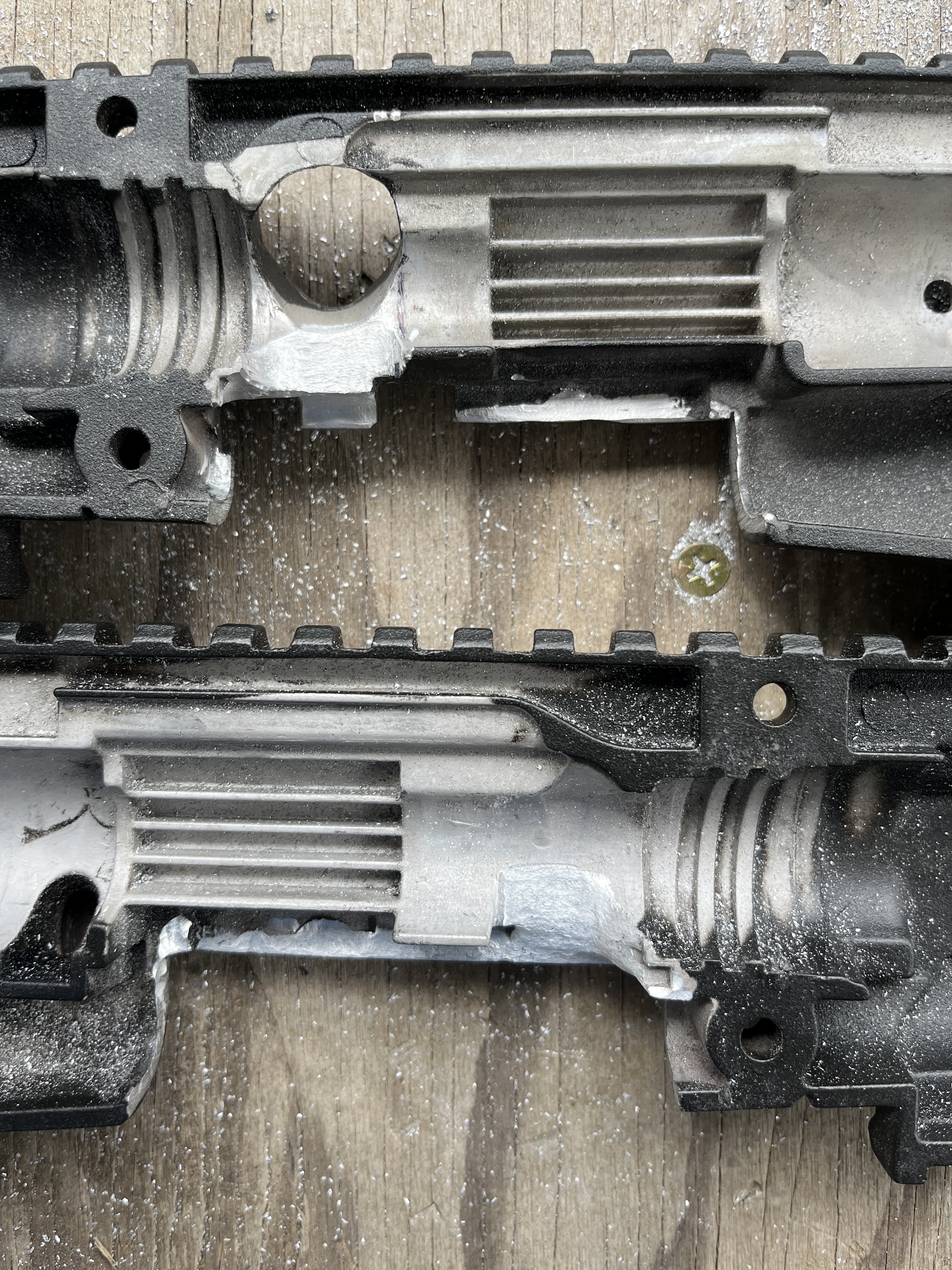

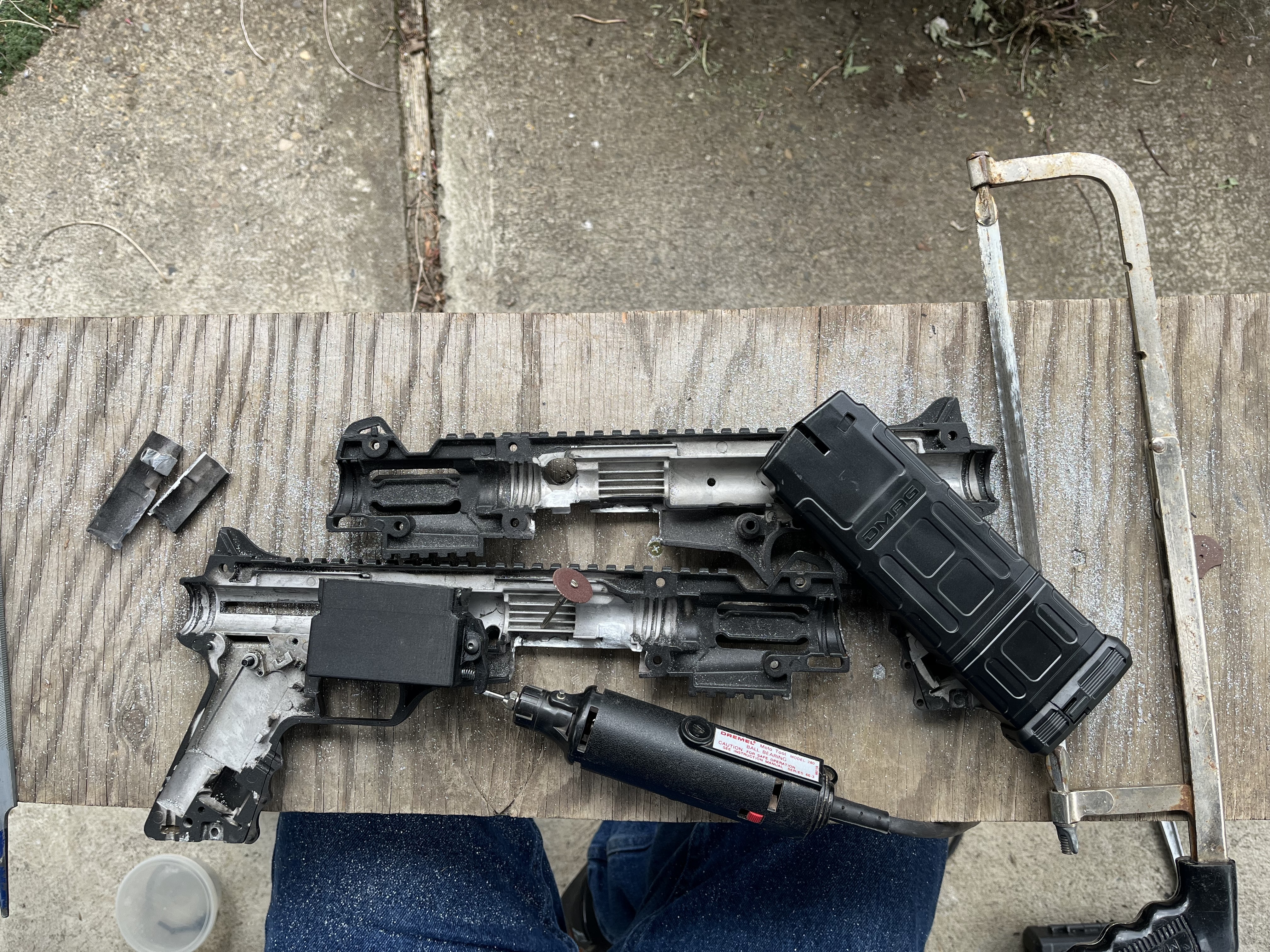

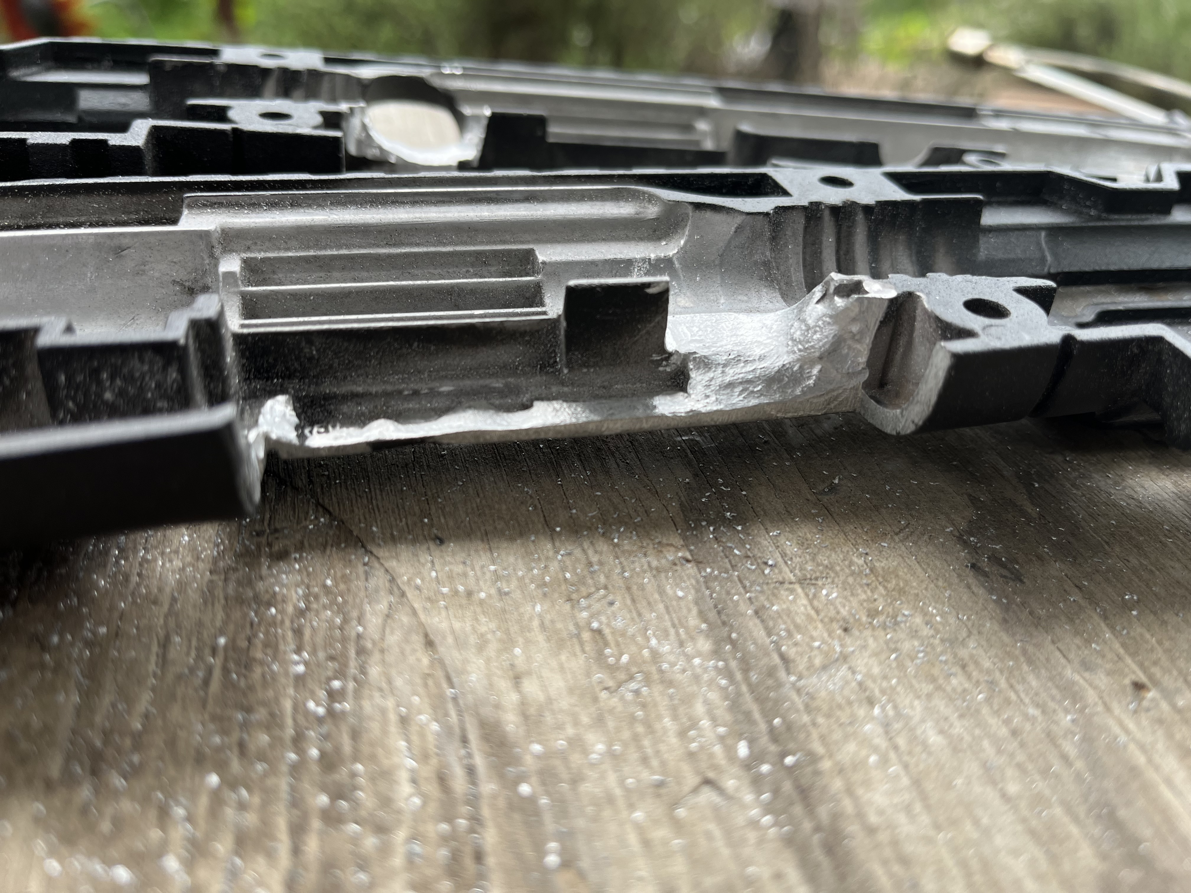

    Magfed Carver One build

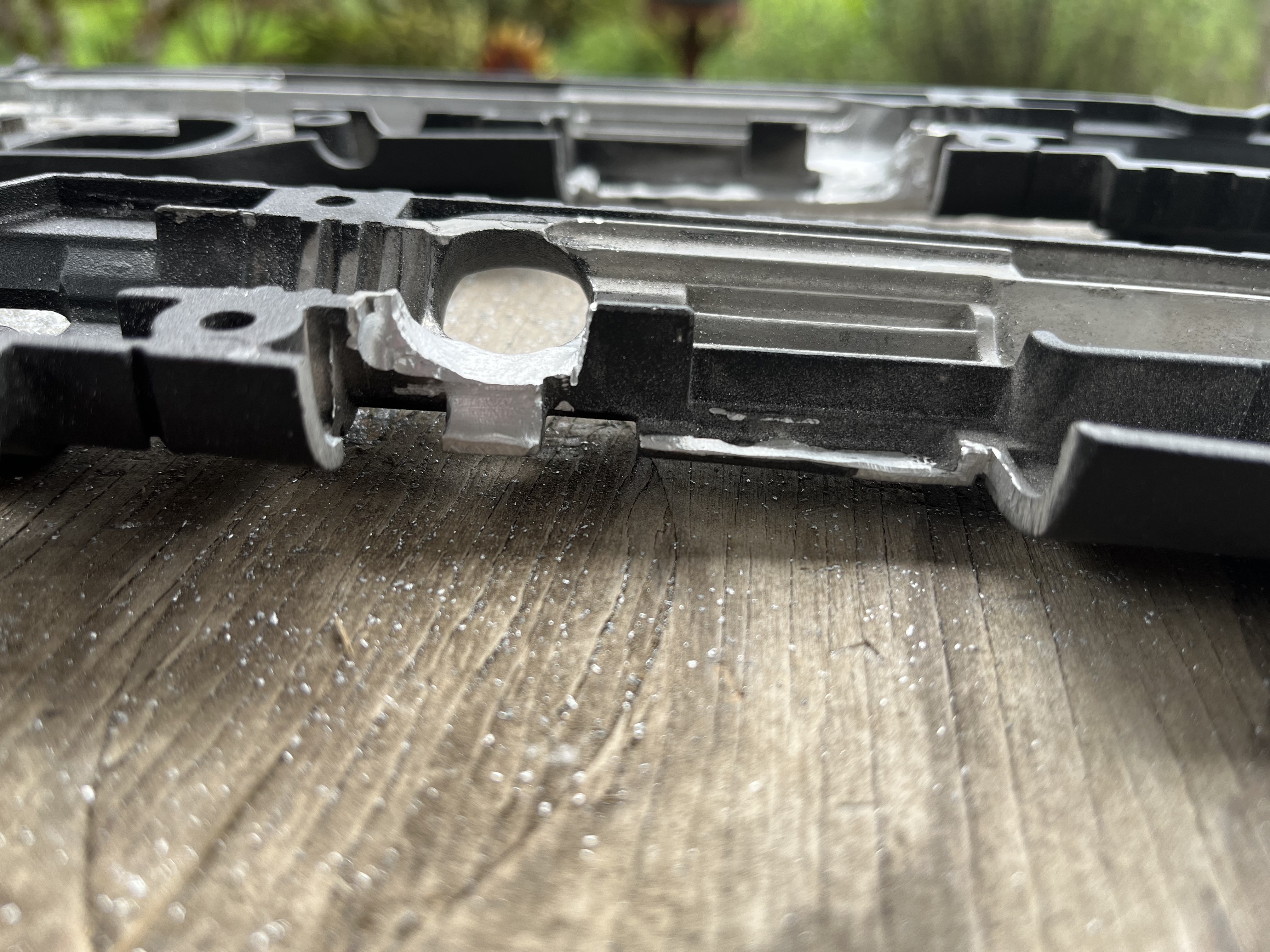

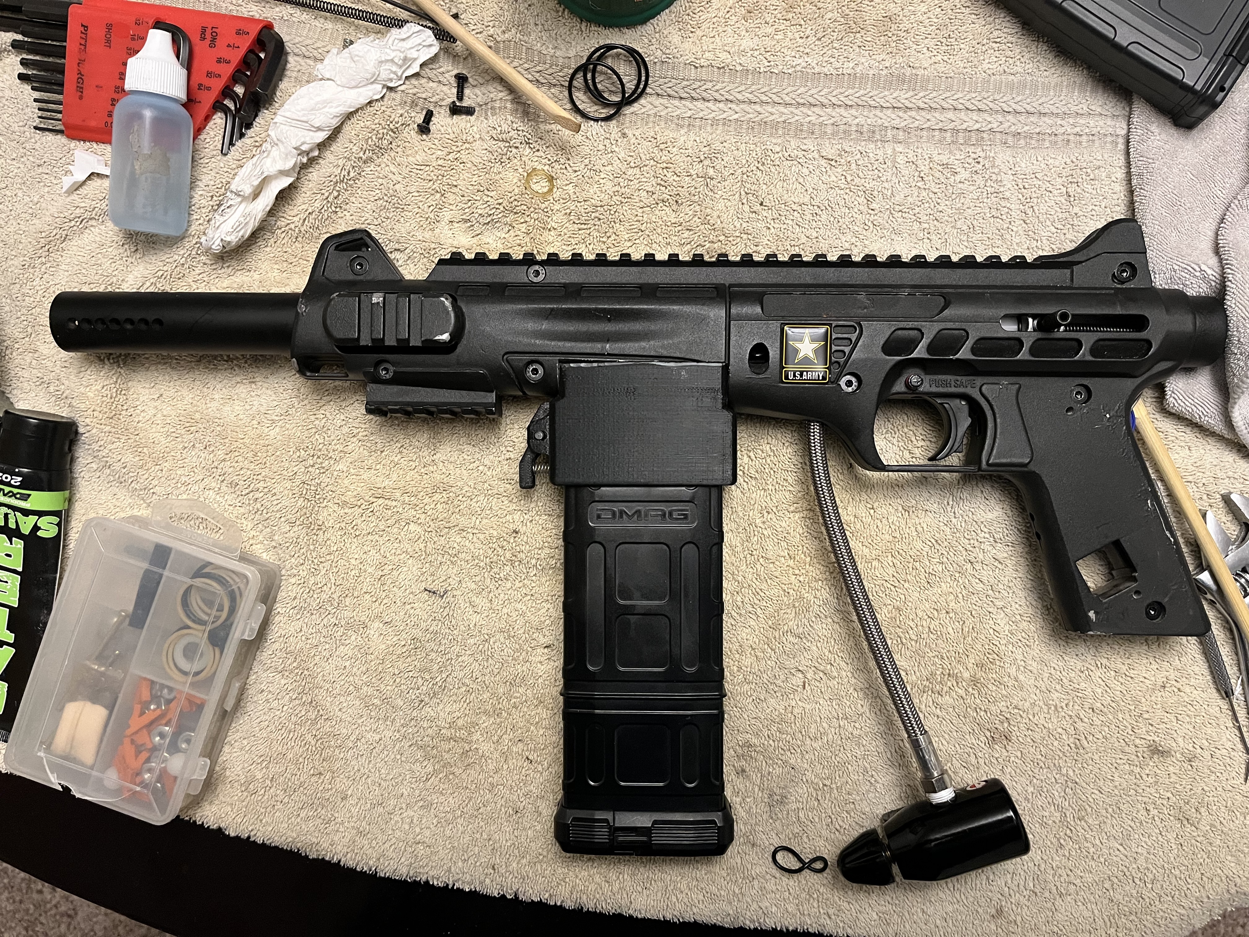

    Dremel, hacksaw, metal file, and PETG printed magwell & detent (essentially a feed neck hole plug). It feeds and shoots at field speeds with cool co2.
    Upgraded with a Zero Kick Hammer mk2 and polished internals - it’s a smooth shooter! Just a few finishing touches left.
    Dice2k did most of the 3D modeling and has a matched pair. I just need a bottomline adapter to be printed. We hope to improve the magwell’s stability in time but this’ll do for SuperGame.

    Was this one of the pop markers?
      • 3396
      Man, they look loke mag fed was their intended use. Awesome work on this one. I need to finish my poo build up.

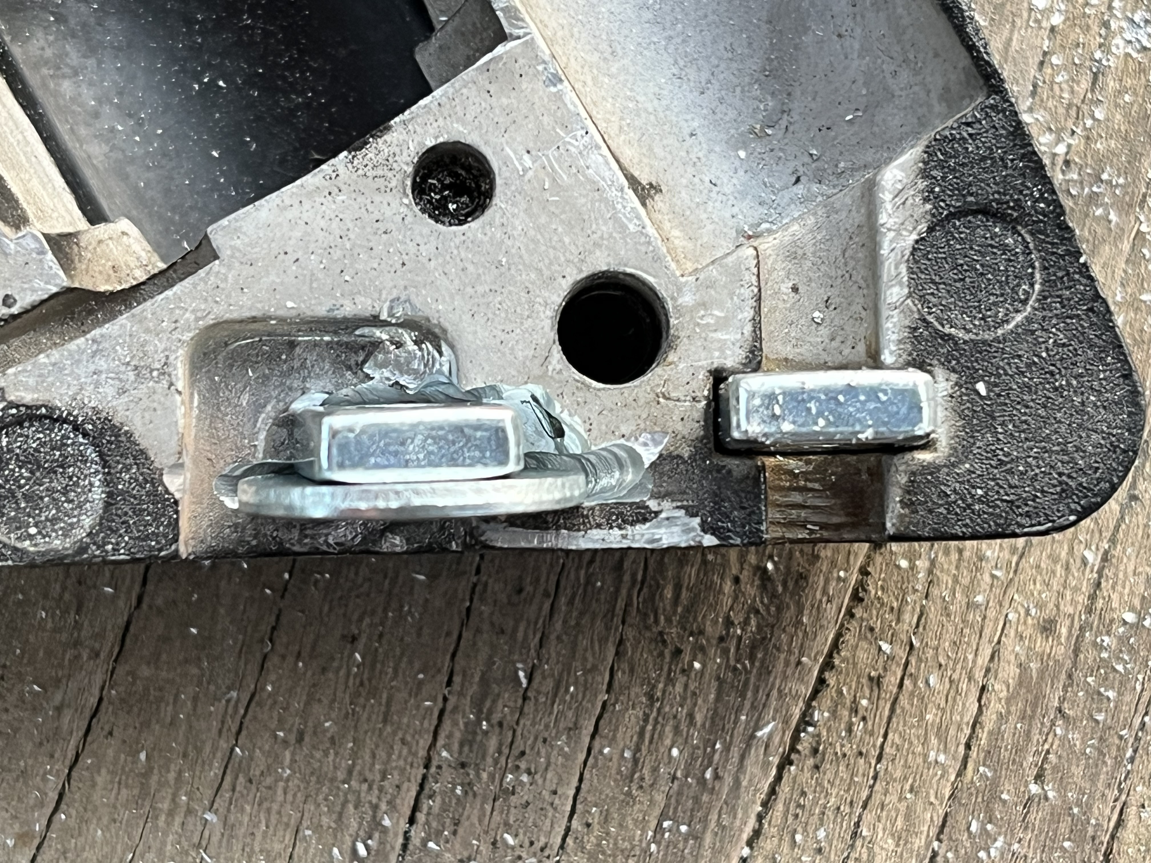

        Very nice job. I've done something similar using a Tippmann magazine well. How is the mag well held in place? I made one a little mistake with my build.
        Can you spot the blunder?
        I failed to make the magazine well easily removable. I will need to modify my design.

          COB it’s just held in by friction. There are nubs that poke into the shell from either side of the mag well. I want to modify it so we can push the rear side in & swing the front up and secure it with a longer bolt just in front of the magwell. We got it good enough for some fun and decided to stop for now. More progress to come.
          my guess about your blunder is your magwell is stuck to both sides of the clamshell with epoxy. Makes it tough to disassemble 🤣

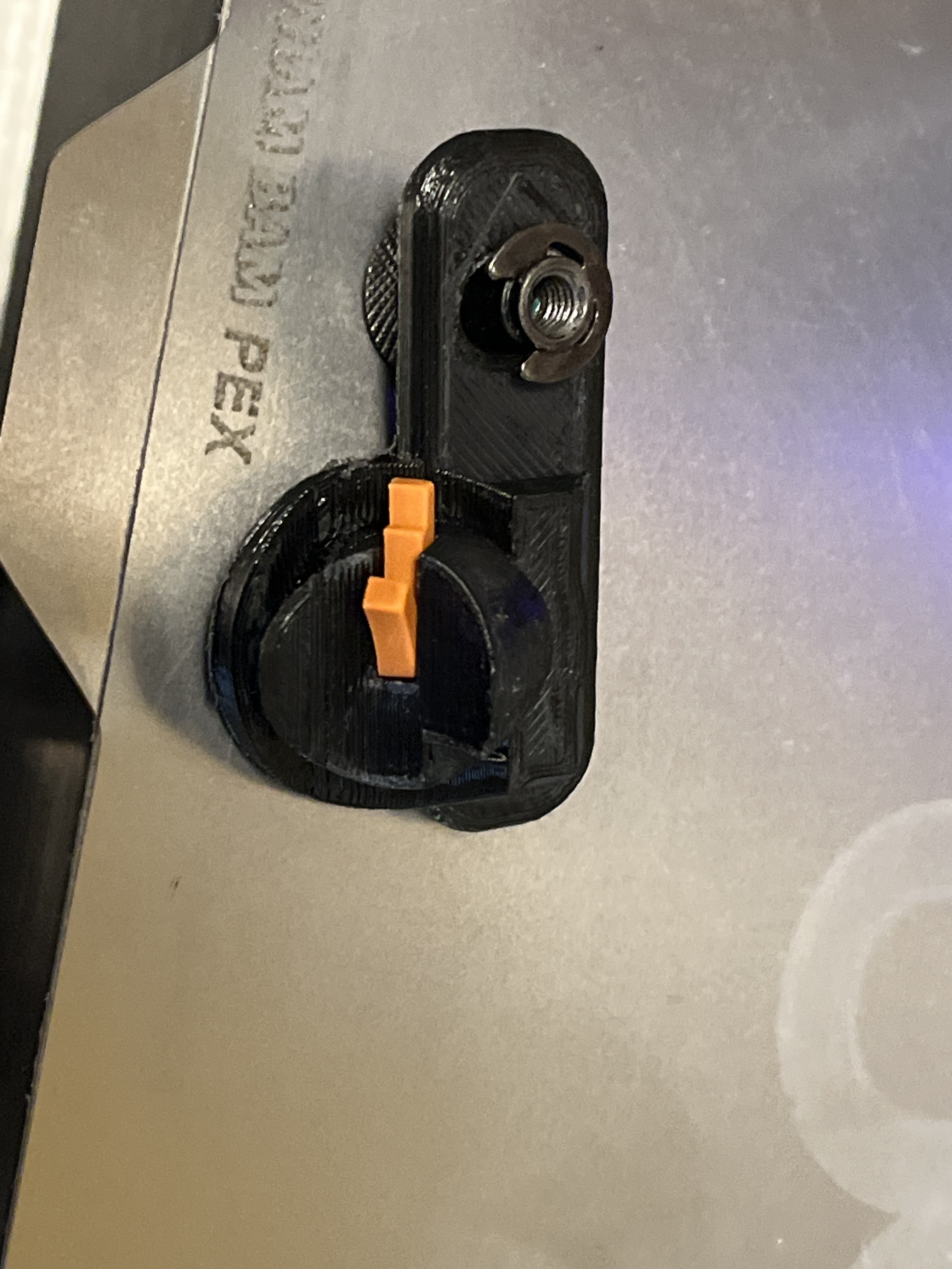

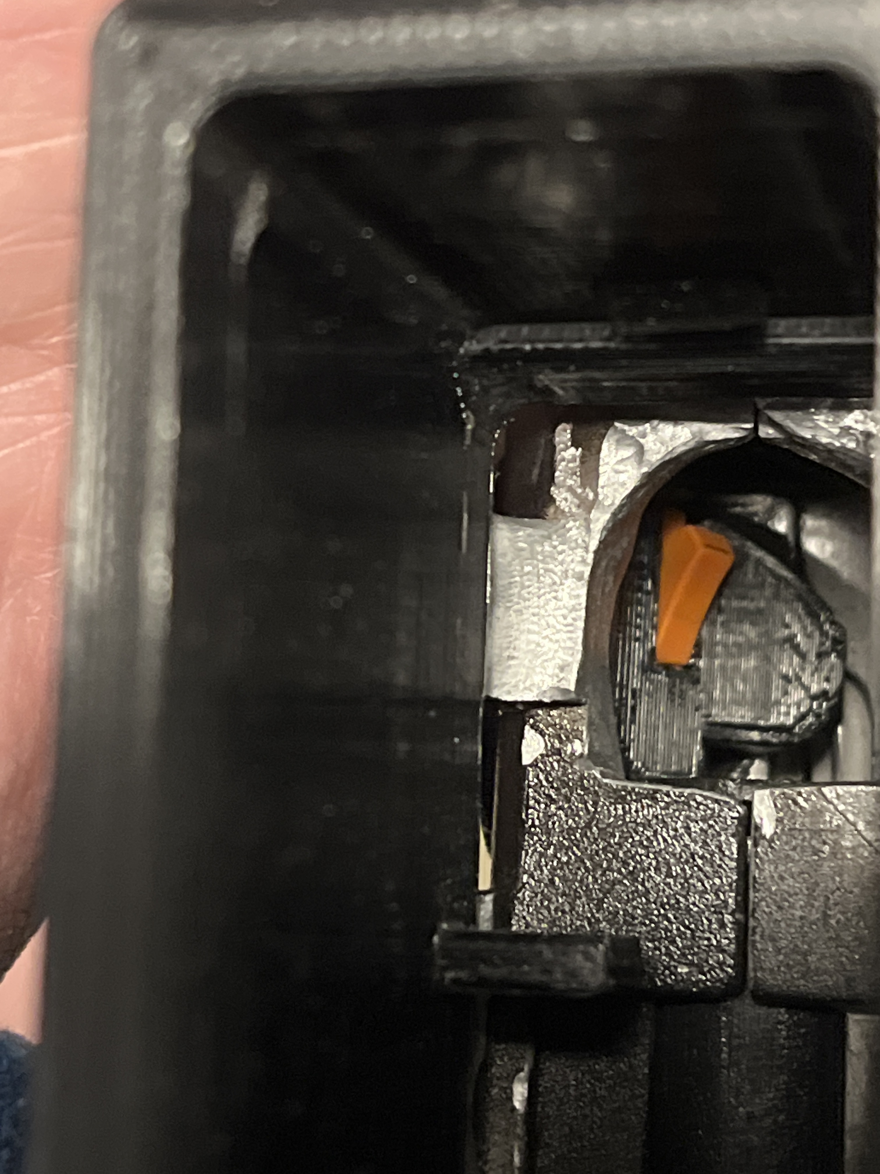

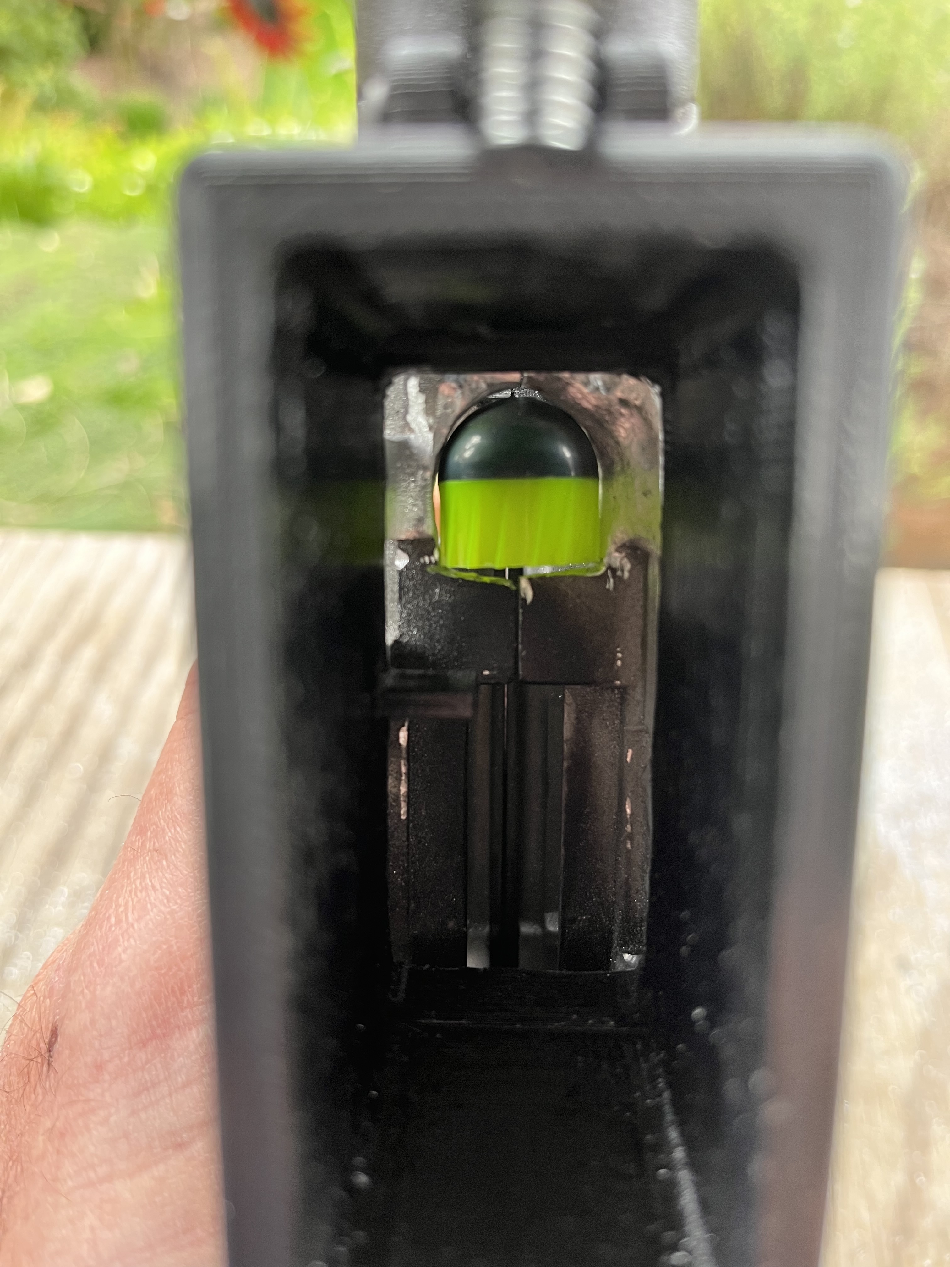

          here’s the detent holder. I need to trim the detent, but works well! Next step is to make this a lok bolt somehow.

            If you are shooting fsr I don't see why you need a detent. It's not like they are going to roll out.
            Maybe make a second feedback cover thing line your detent one there. One with the detent for round ball, one loc bolt for fsr

              I will shoot round ball at SG this weekend, but the lok bolt isn’t about shooting a specific projectile. The goal is to stop the bolt from moving forward and either destroying the ball follower in the mag or actuating the valve when your mag is empty. The loud POP tells everyone downfield that you’re out of ammo.
              the detent is more for round ball, yeah, but if I have a combined design that has a lok bolt with a detent, I can shoot whatever I want 😊

                I see, wonder if you can combine the two. Make the loc stop hold the detent in end of it.
                Just an idea
                  yeah that’s the plan. I found a model that was made for the TMC that combines both, but after modifying the part that screws it onto the marker to fit the carver one, I’m having trouble with the locking part sliding nicely. I’m almost there, just not to the point where it’s reliable.

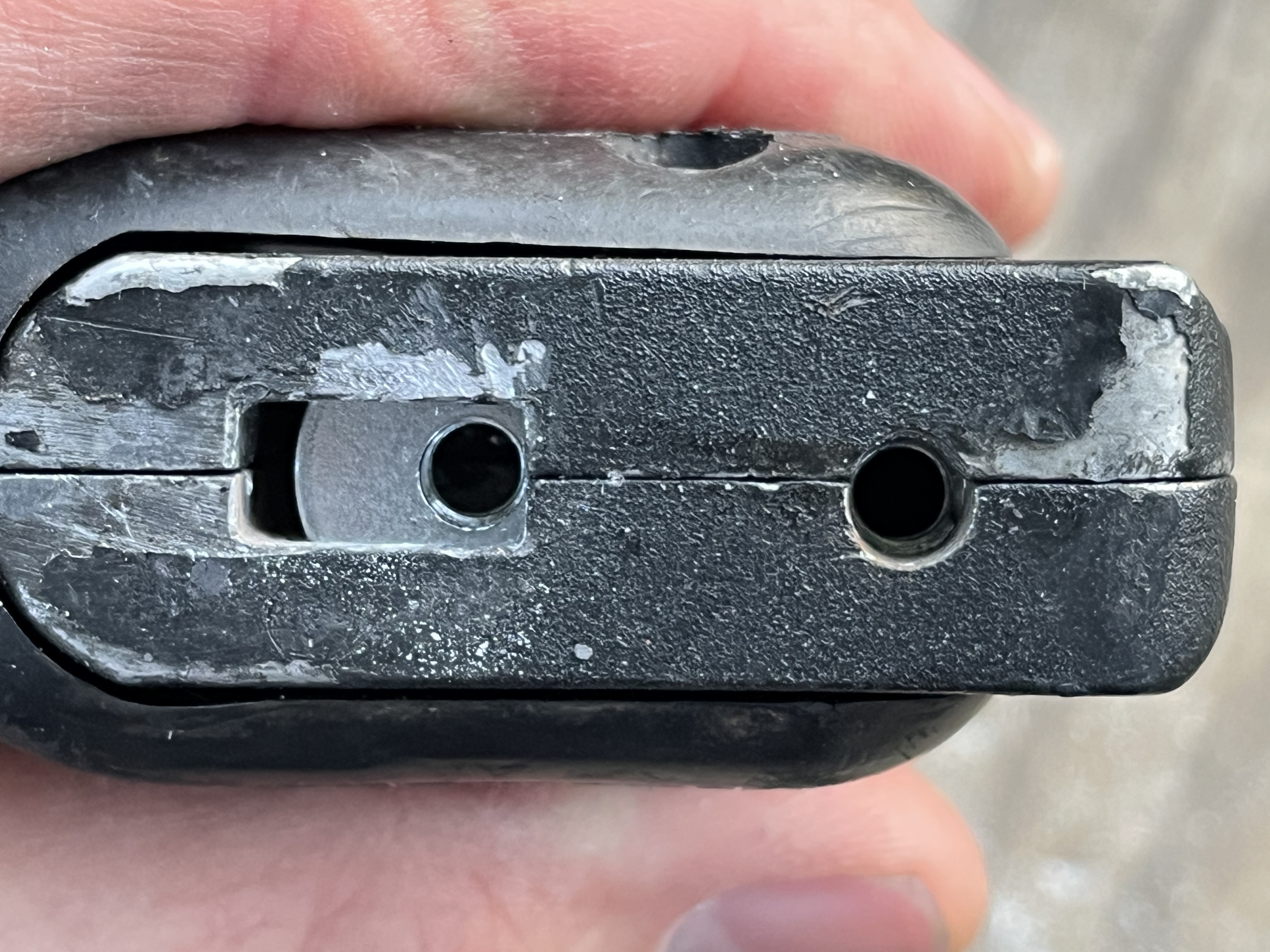

                    After a little dremel work, I have an ugly but functional std bottomline hole solution. Stanks a lot for this one-off ASA, Tippmann.
