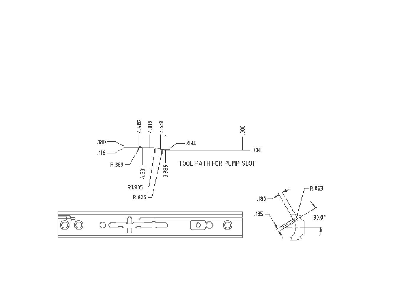

    I am trying to make a pump automag and am looking for the degree of angle required for the pump rod to engage with the bolt. I came across a thread on another forum that said 30° but that seems drastic. Sadly I dont have a pump mag to reverse engineer. I dont need an exact angle but was hoping someone could get me in the ball park so I can machine a rail and body. Thanks!

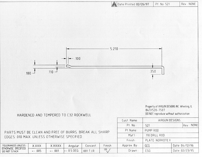

          It is a pretty steep angle, but over a short distance.

            Well, I'm glad RuleofSines posted something else. I do have something, but it's not very....useful. No wonder I never tried to do it myself.
            Click image for larger version  Name:	pump milling.jpg Views:	0 Size:	40.2 KB ID:	367185

            As for the rod. Get it close it doesn't need to be exact. Mines been a piece of wire coat hanger I bent by hand to line up with the 1:1printed drawing. Still good 20+ years later
            I have the drawing for the body as well. I can get it once my workday starts.
