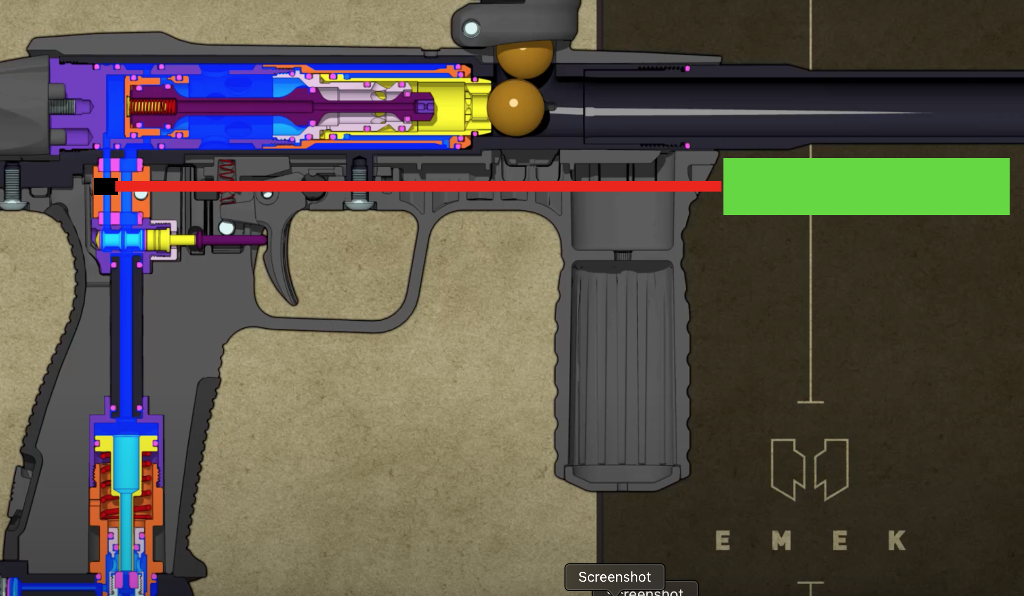

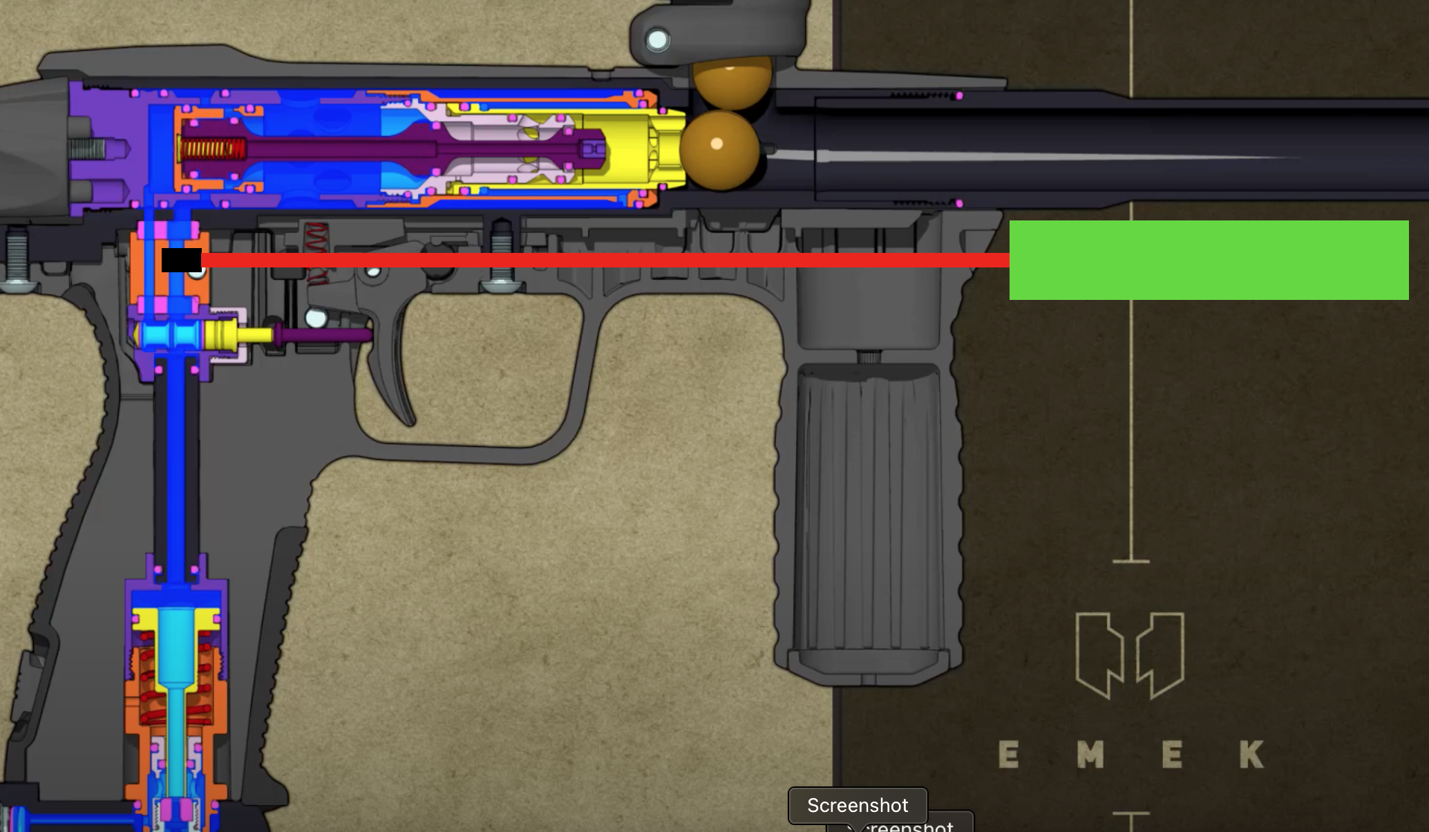

    I mentioned this idea in a similar thread a while back, and for some reason it's stuck in my head again. Some things up front.
    • I don't expect there to be a market for this that would warrant Planet Eclipse to make it. I'm just looking for feedback on the general concept.
    • I realize these markups oversimplify and/or don't address all the mechanics, design, and part fabrication. Again, just looking for feedback on the general concept.
    • This concept won't cycle the bolt like a conventional pump, since nothing attaches to the bolt.
    • Pump handle forward blocks recharge. Can't fire until pump handle is pumped back, allowing it to charge [edit] front of Gamma Core [/edit], and then back forward, allowing it to [edit] first charge the back of the Gamma Core (if trigger is forward) and then [/edit] vent/fire when the trigger is pulled.
    • Pump handle back blocks vent [edit] and charging of back of Gamma Core [/edit], so it can't fire while holding the pump handle back.
    • EDIT: Rethinking this one. See post 3. Autotrigger would be baked into this concept with no way (in the simple markups) to deactivate it.
    • EDIT: After staring at the cycle video some more, I think residual pressure would return the bolt even with the trigger held back and pump in forward position. I think the bolt would stay forward until it's allowed to recharge, at which point the bolt would return to home. I'm not sure, but bolt may return if there's enough blowback and/or residual pressure to bring it back.
    • I think you'd have to pump it after gassing up to charge it for the first shot.
    • Is there some type of brick or cylinder seal that could seal as shown in the markup, or would it need offset channels for each flow path, similar to a 3-way.
    • With all that said, I don't see how more than one shot could occur with this markup without pumping.
    • First image is pump handle forward with marker charged. Recharge is blocked but vent to fire is open.
    • Second image is pump handle back. Vent to fire is closed. Recharge is open.
    • I didn't take screenshots at the proper time in the video to show proper airflow. The images are just meant to show seal location for blocking/allowing flow.
    I'll add more bullet points if I think of anything.
    Thanks.

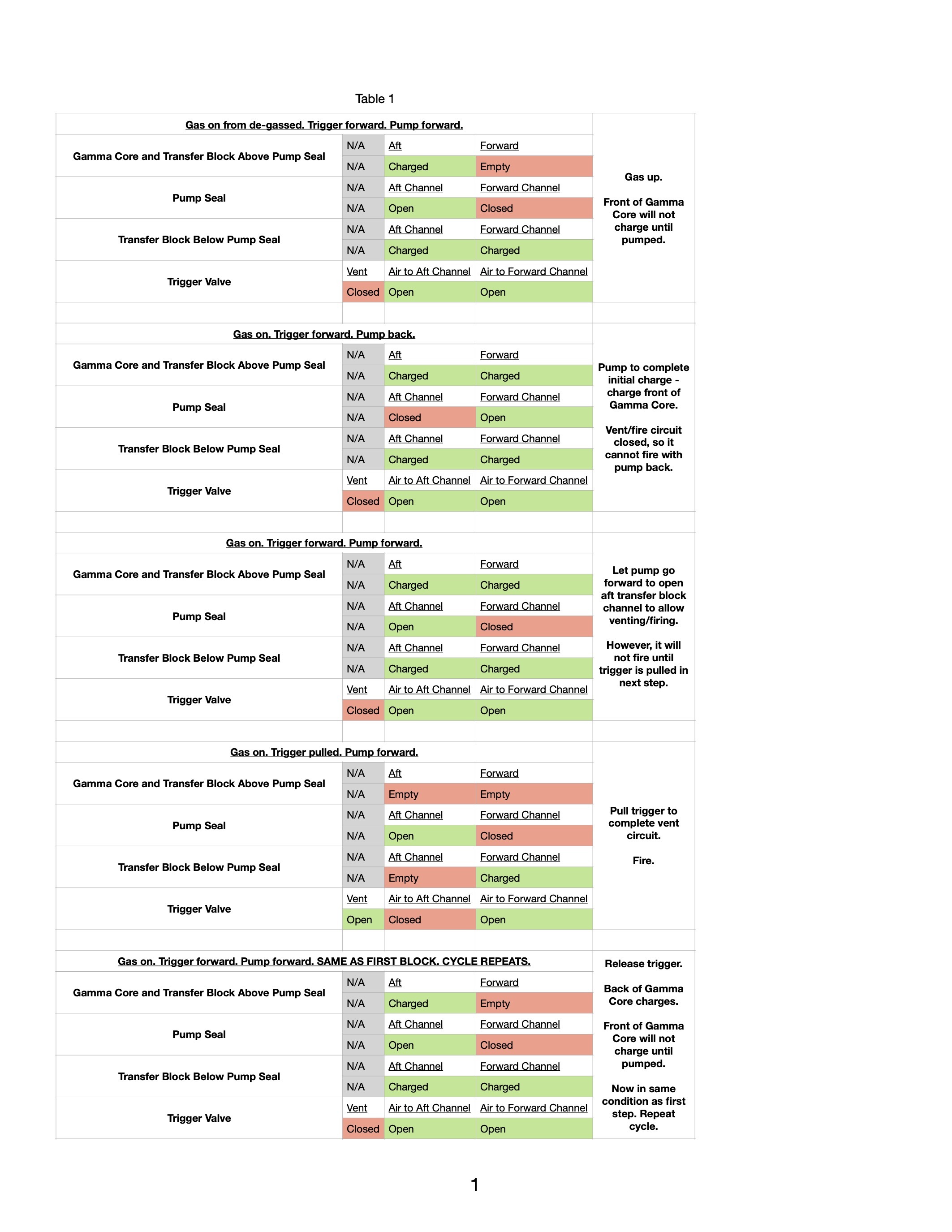

    EDIT: Added chart of what I think the firing cycle would be. Really curious if there's a seal that would do this or if each channel would need to be offset, such that a 3-way type actuation would be required. It would also need a seal or seals around the pump rod.

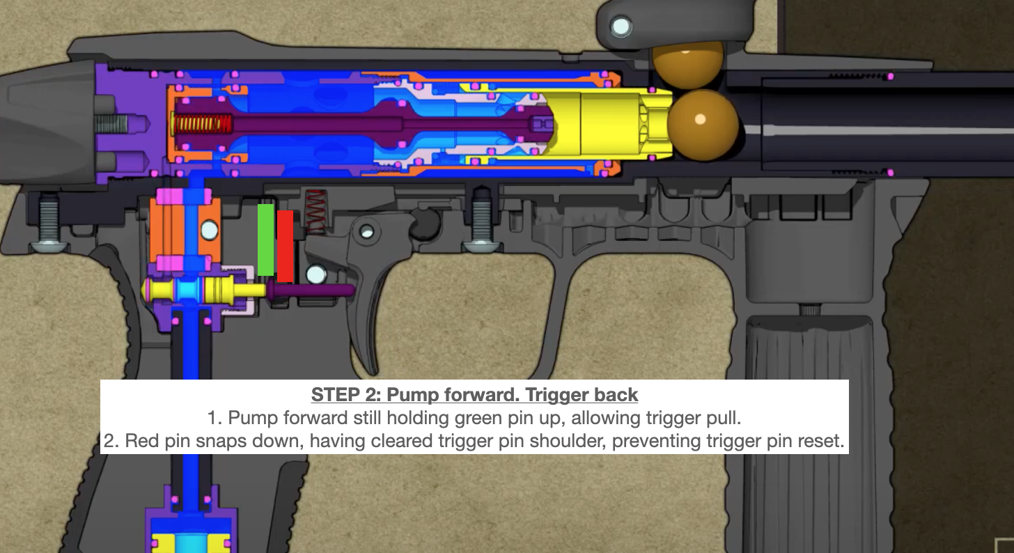

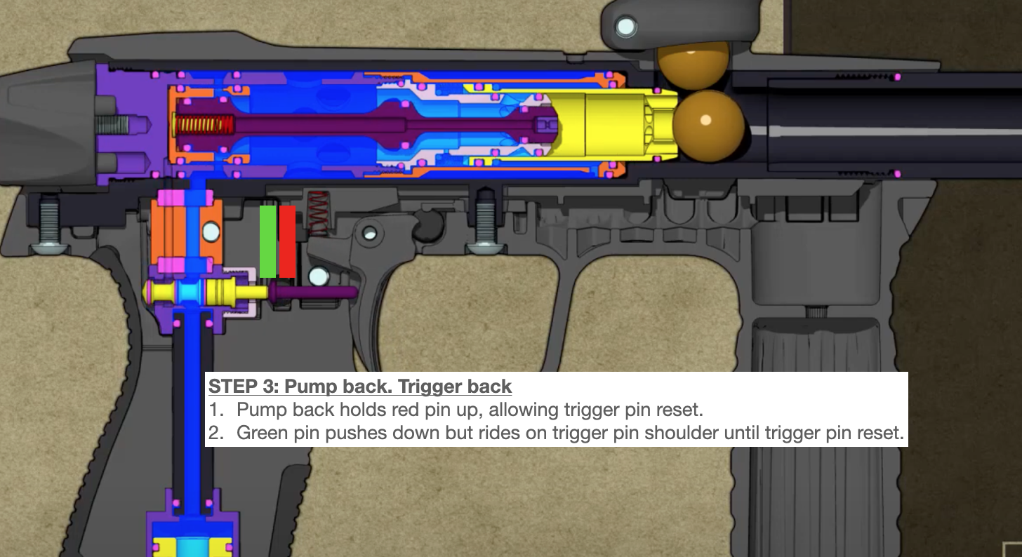

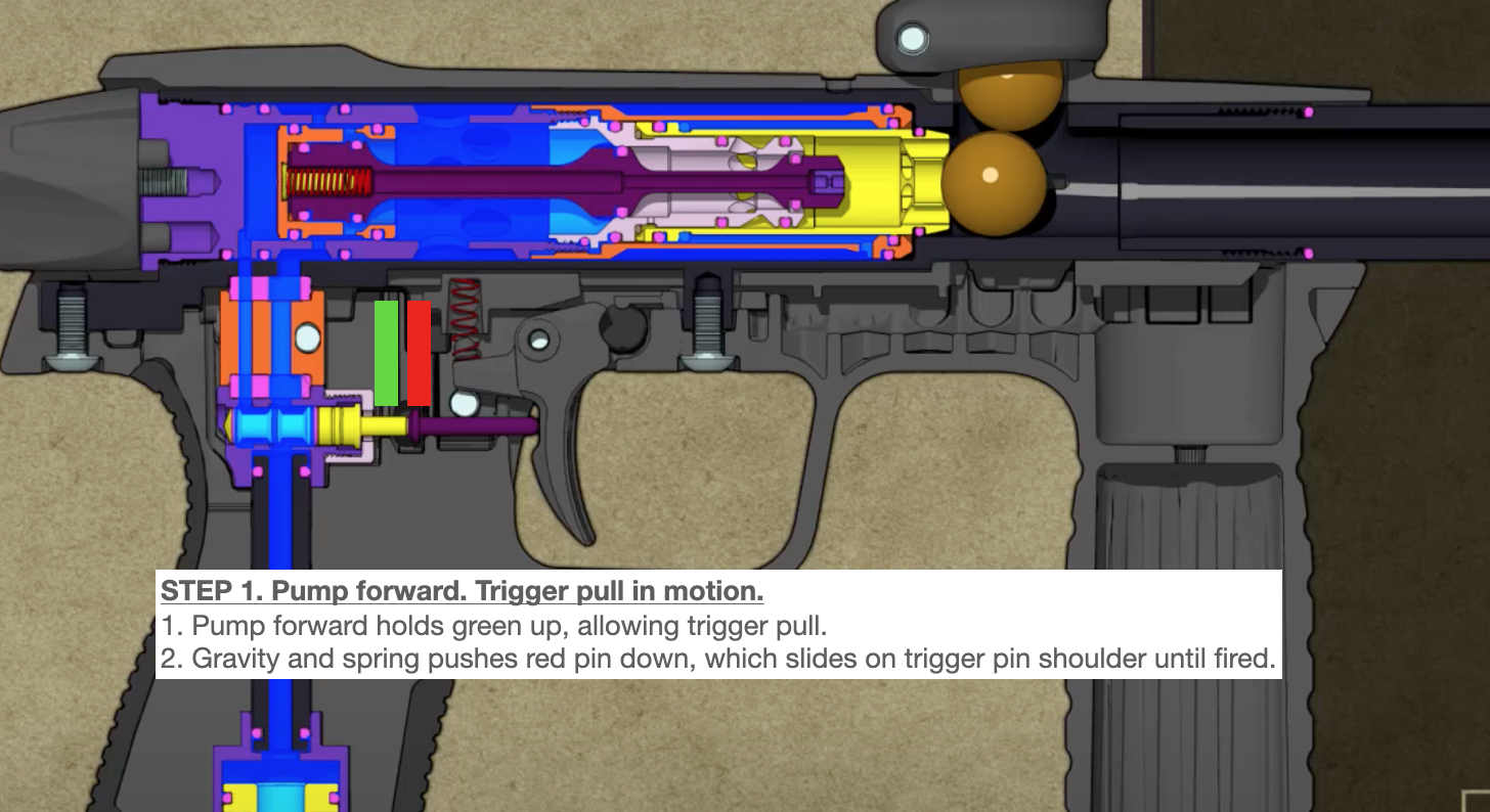

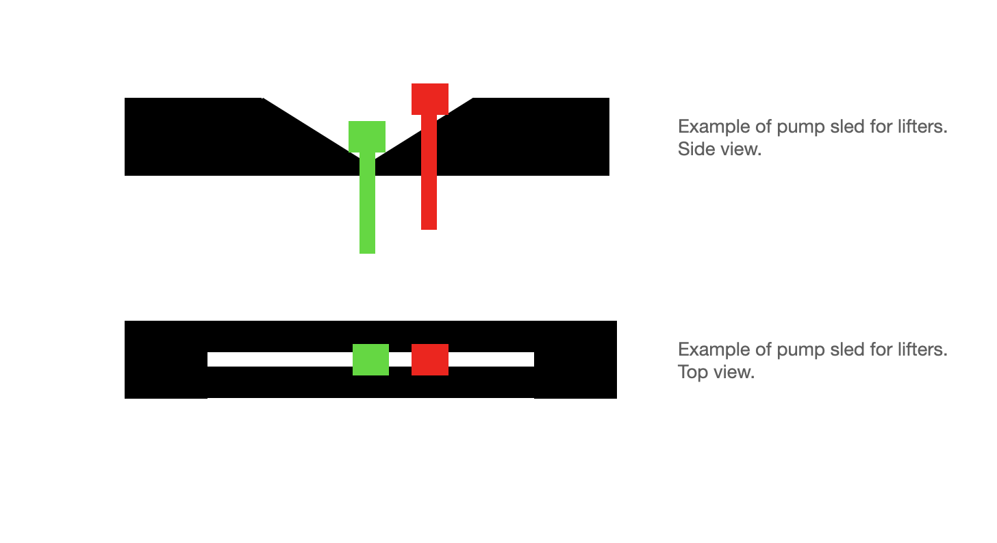

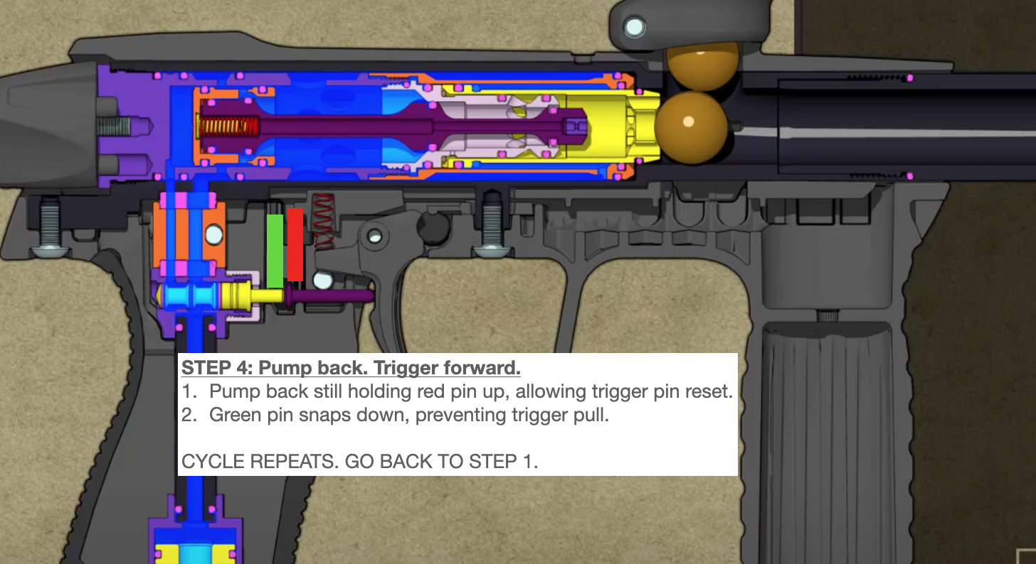

              Round 2. ford Ecapnation or anyone else that wants to play. What are your thoughts on this? Parts are getting small, but based on inner workings of some real steel handguns, not outside realm of possibility. Mechanical instead of pneumatic. Looking inside an Etha 3M grip this morning, I think there's room.
              In my head:
              1. Could be a drop in cartridge, at least the portion that goes into the grip frame.
              2. 3D printed body or similar needed to support pump arms, guide rod, handle, etc.
              3. Minimal milling to grip to clear room for the sled.
              4. It would be a very short pump stroke.
              5. Would need to sort out spring contact points. Could reverse it - springs lift pins, pump sled with leaf springs (stronger than lift spring) as pin contact points, push down.
              • ford
                ford commented
                I mean... maybe?
                As a lazy software engineer I don't like messing with stuff that's already working as intended.
                That's kind of why I wonder if the safety mechanism isn't the place to make a modification. It's already designed to stop the trigger. Running a small cable from the safety mechanism to the pump that engages the fire action feels simple-ish to me.
                That said, I have no mechanical background so I have no idea how hard it would be to make any kind of piece that gets the job done. Maybe a first iteration is a new safety that literally switches to 'safe' after every trigger pull.
