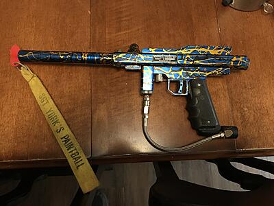

    I got a beauty here. Used to play with it 20yrs ago. It’s just been in storage. Leaks now, took to a shop to get fixed. Says the “cup valve” is leaking and couldn’t fix it. I just noticed he didn’t put it back together correctly. Has the frame split. Anyone able to help me get this guy in playing shape again?

    First off , it’s a beauty for sure and my favorite marker from when I had one. So the cup seal is a pain. What’s not put back together correctly ? They are pretty simple to put back together.

        Thanks! I’ve never taken it fully apart myself. Cup seal a pain? Great. I’ve got some O rings laying around I can try but the repair guy said he tried every one he has. I don’t even know what it looks like though.
        Theres now a gap between the trigger body and the slide body.
        Not sure if I wanna sell it. My sons getting into playing and I’d like to this ole gal up to speed.

          The cup seal is inside the valve body itself. There is a C ring that you remove to get inside the valve body to remove the Cup seal. I was lucky enough to have someone print me a new seal and repair the leak on my Z1.
          is the valve body pushed back into the body nice and flush ? Hat would make a gap if not.
          I can pull one apart after work tonight and lay it all out and snap some pictures for you.
