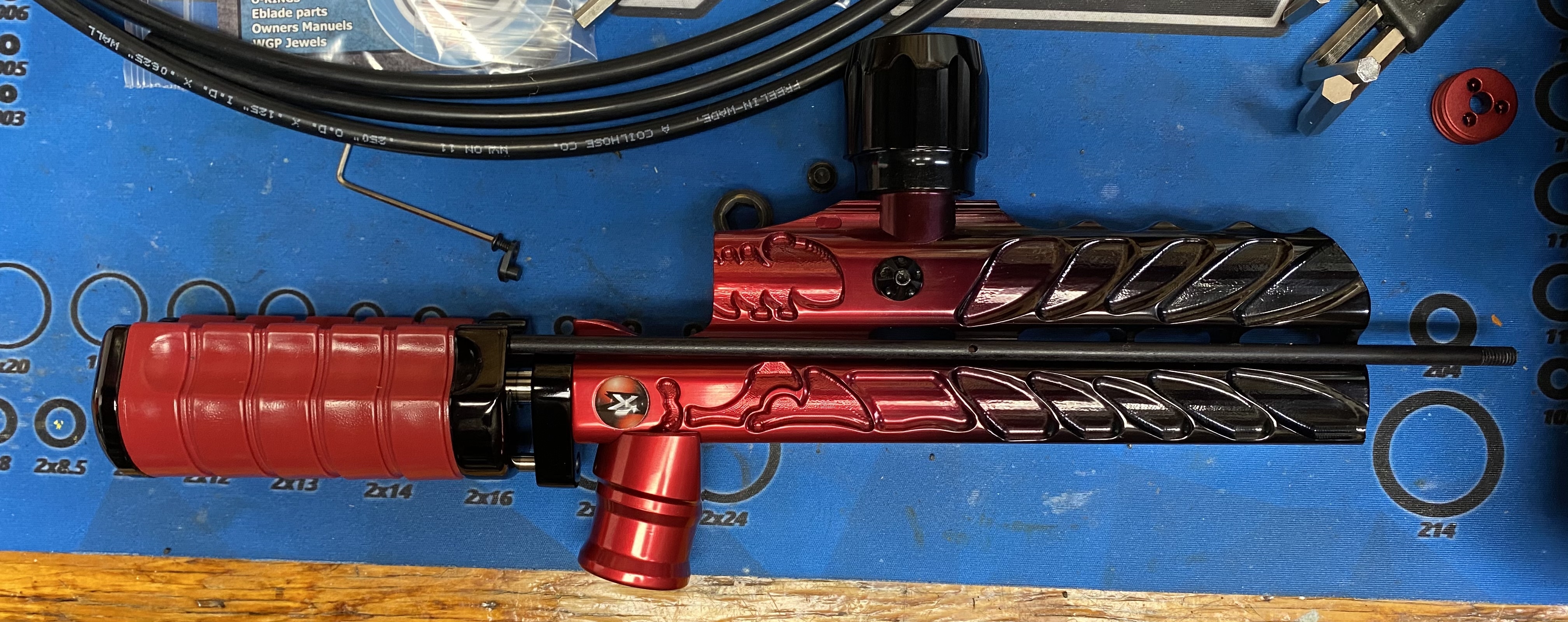

            Just got my Slice Kit in the mail. Turns out I ordered the opposite colour way. Really like the looks of the pump, especially the polished front and back cap. Even dropped it directly on my foot, confirming it is nice and solid.

                I raided some parts off my other sniper to complete the Dragon and get a better feel for the Slice pump kit. I really like the feel of the pump handle. The little divot on the front pump plate is perfect for my finger and very comfortable no matter how I hold the pump handle. Really the only thing I would change would be to offer a full metal pump handle, but that’s really minor as I like the pump handle as it is.
