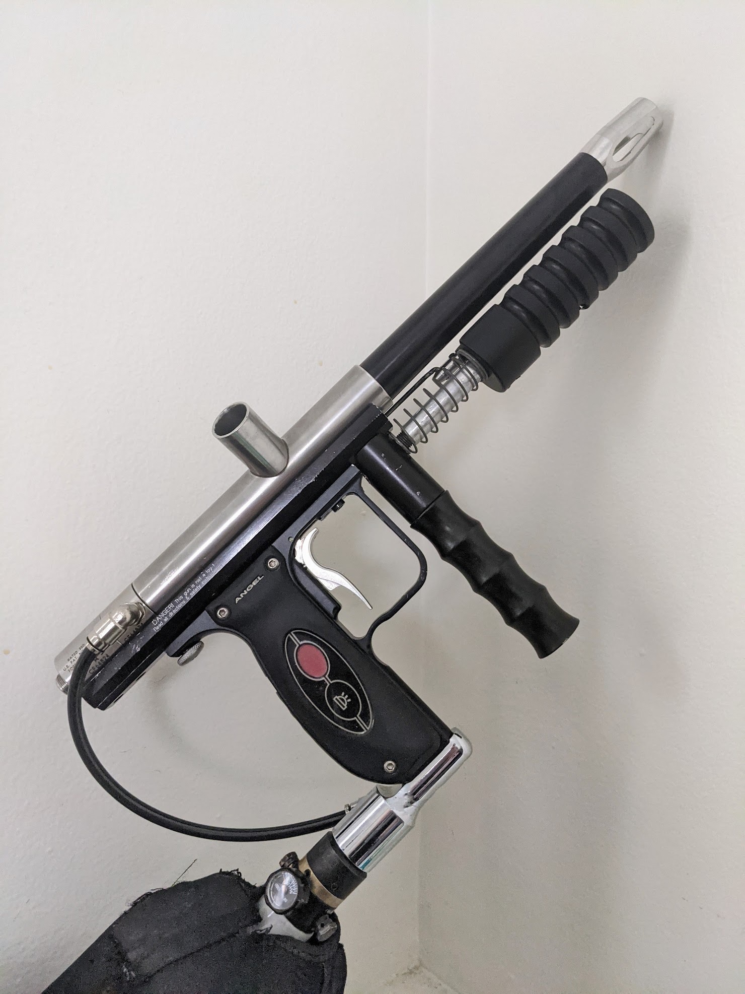

        Angel frames can work. I feel like I've seen DM Ultralite frames as well. I can't yet speak to the long term effects that Superman mentioned.
        I will say on my pump setup the bolt is a little bit tougher to activate with the Angel frame on it.

          I put a heavily modified BKO frame on a (again) heavily modified Classic Mag.
