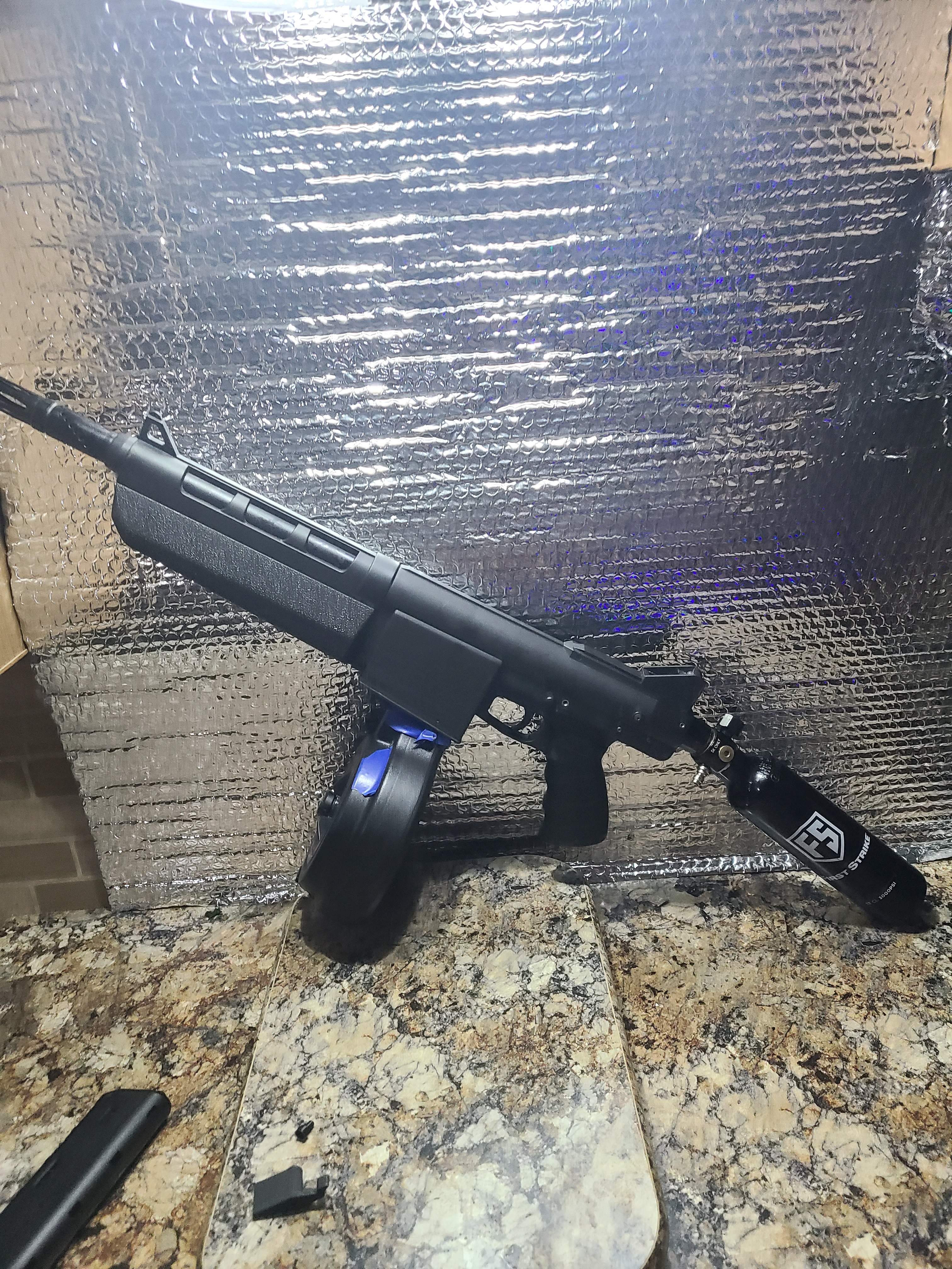

              I'll need to stretch this part a bit on auto cad to make the drum fully set inside the magwell

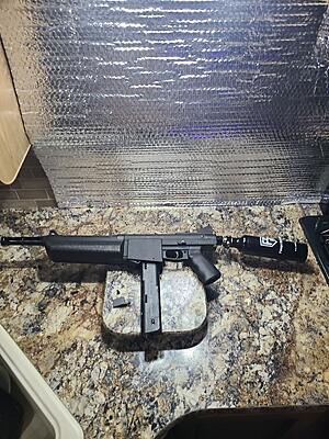

                Fitz zeta mags perfectly and shoots

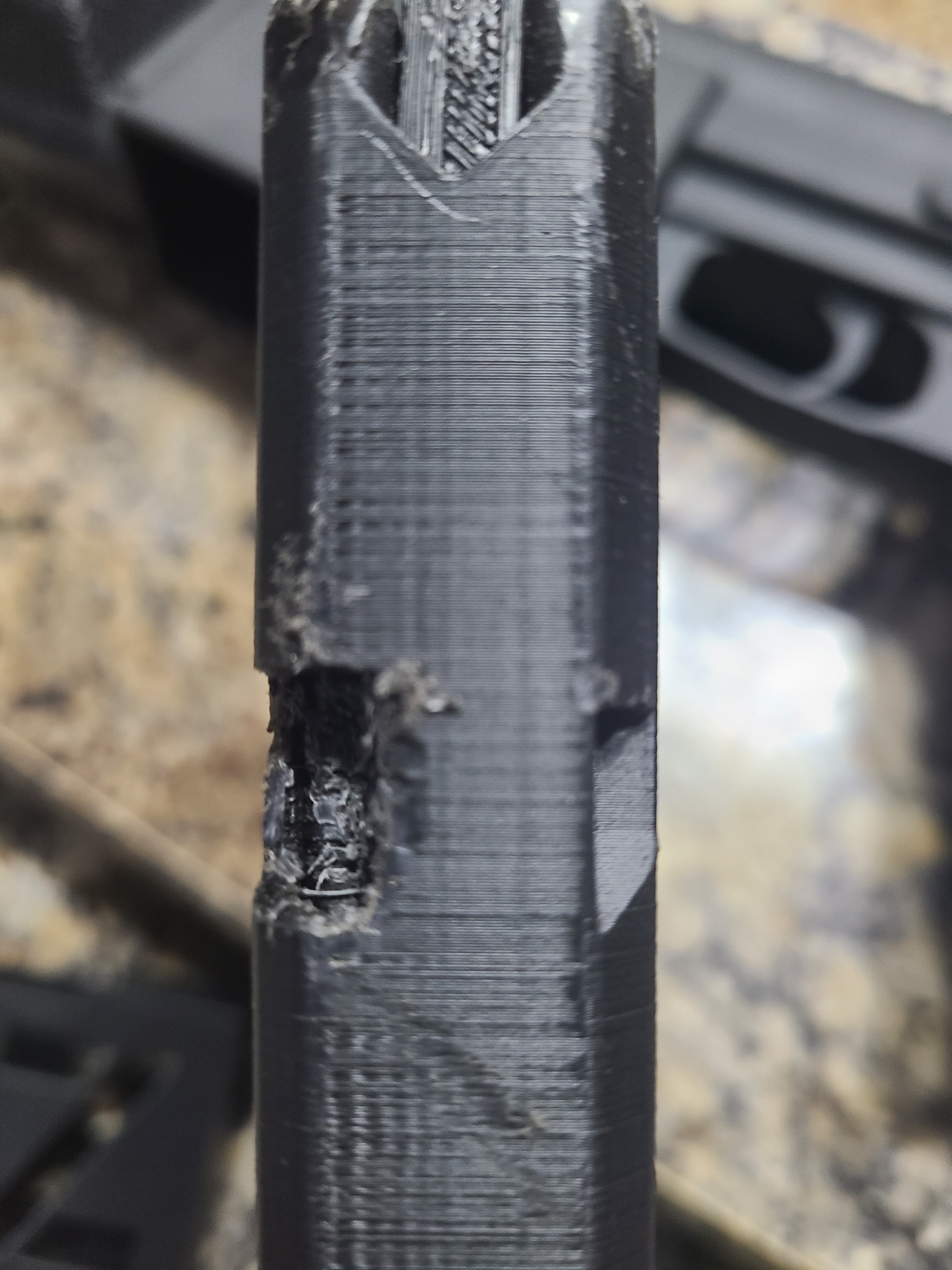

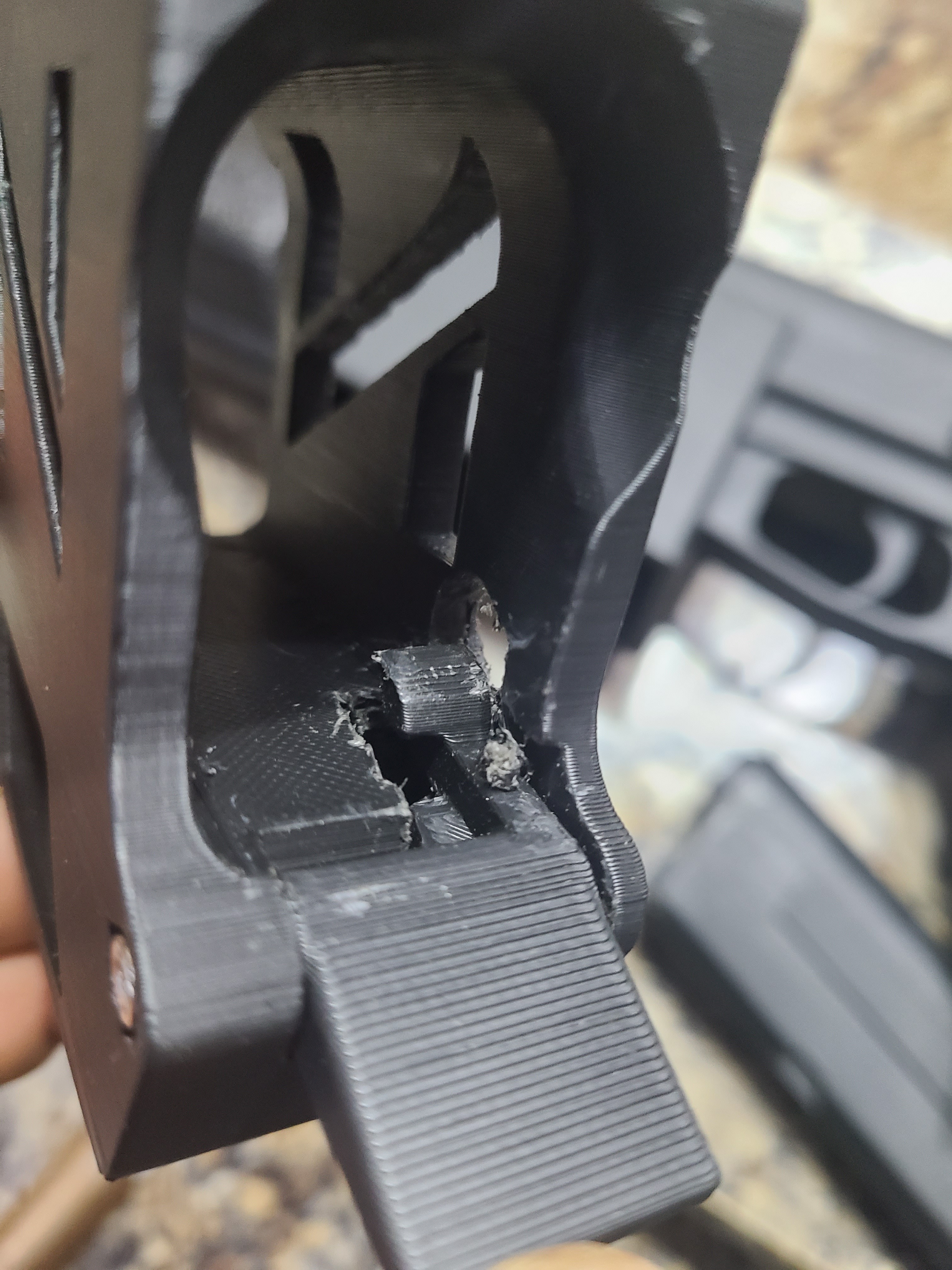

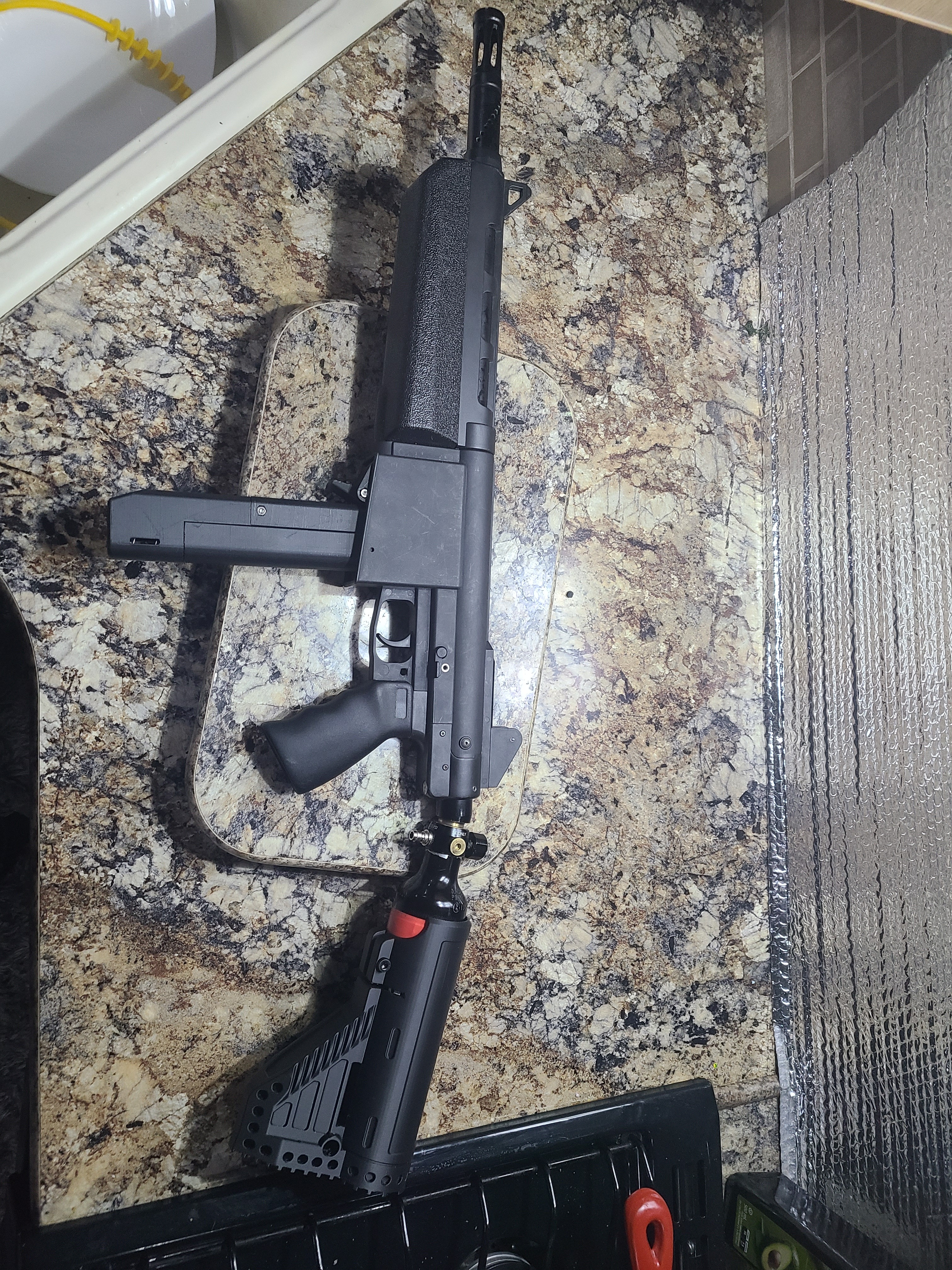

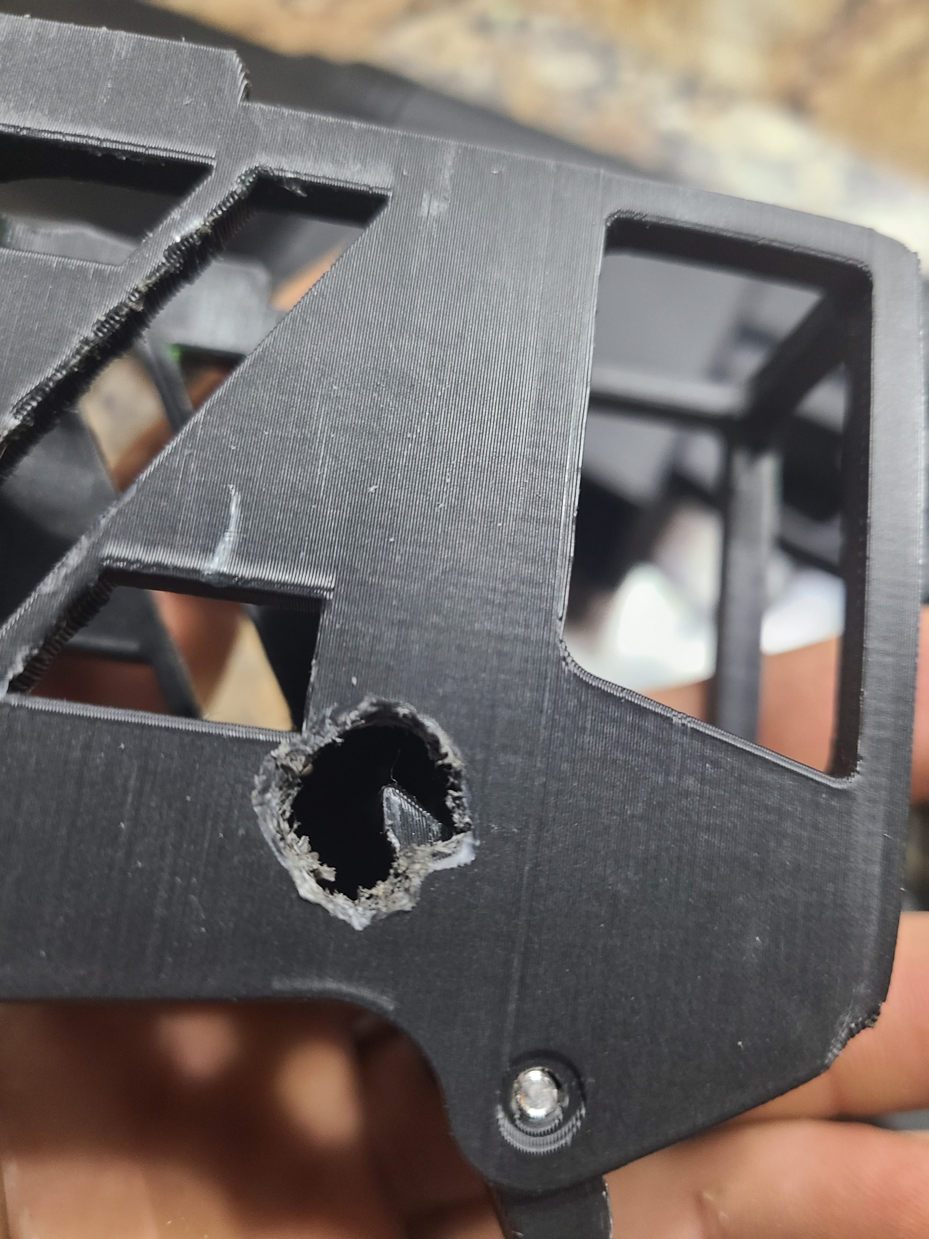

                    Alright so it dosnt fit perfectly lol actually the mag release is on the wrong side lol unless you want to take a dermal to the side of your mags and make a notch ,
                    I tried on my printed ob2 10 round magazine and it works
                    Also the the mag release does not fit inside the magwell , you will have to use a dermal to cut it open bigger so it will fit in its spot, also I drilled a hole right where the mag catches on the mag catch so I can visually see wtf is going on
