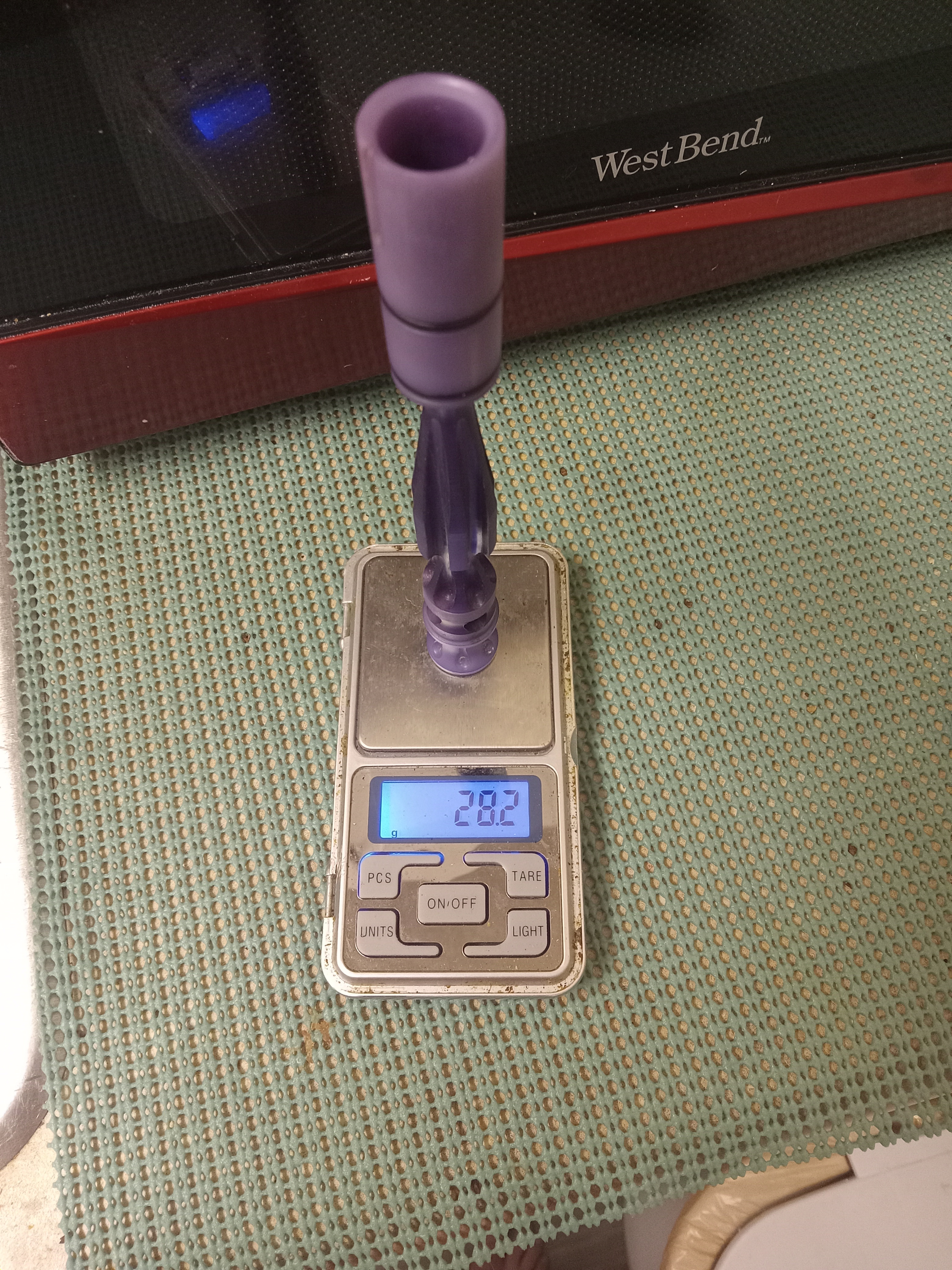

          So I weighed some bolts and stuff this morning while bored
          STO bolt-73 grams
          Stock trilogy bolt-81.5 grams
          stock trilogy back block-26 grams
          some random derlin pull pin-1.5 grams

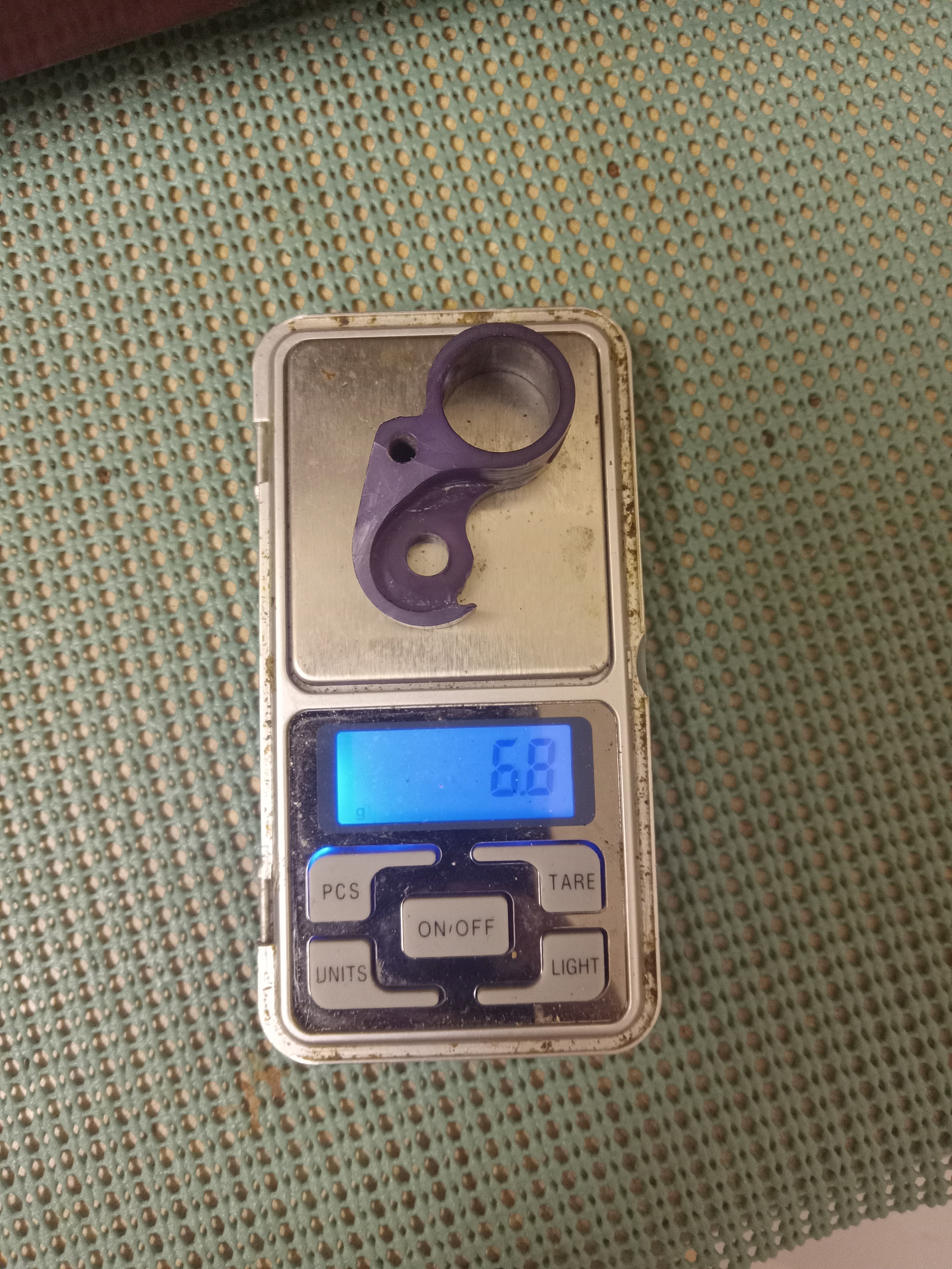

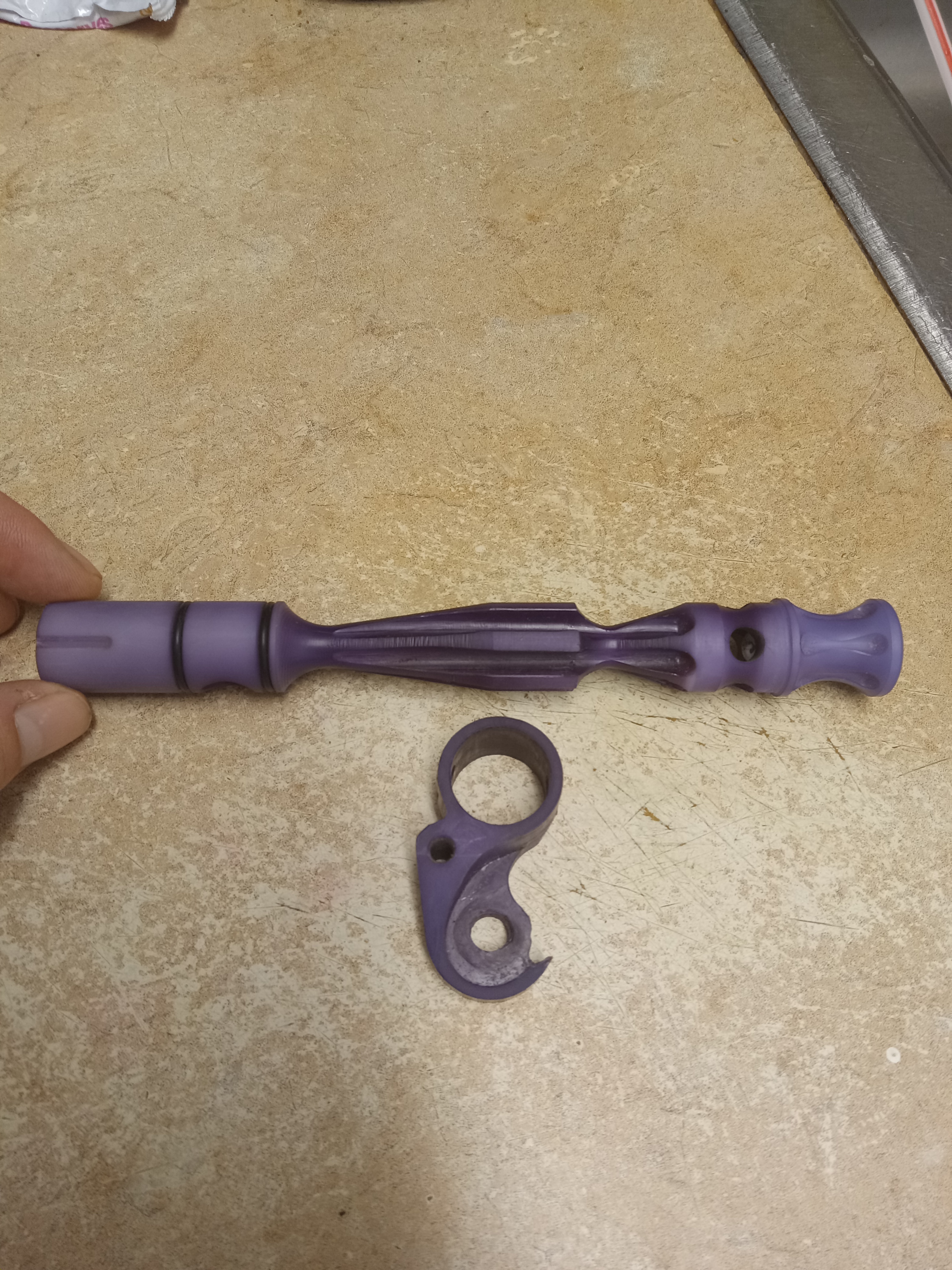

              Ok so I picked up a rare 3ds litestick bolt and back block and someone on here wanted me to weigh them and post it, well here ya go

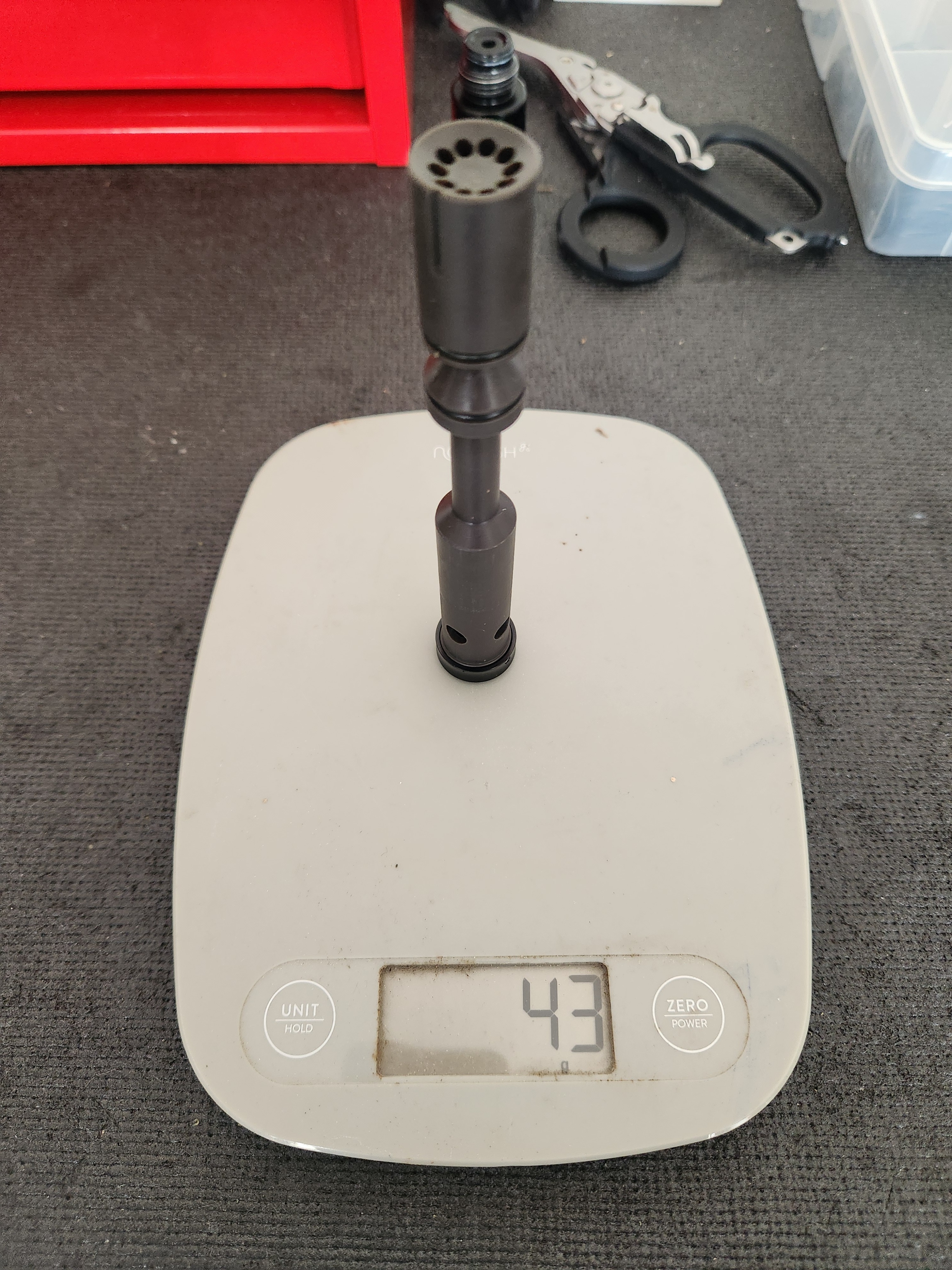

                    In case anyone is wondering...FF w/ back cap is 43 grams.
                    Edit. EVO Length.
