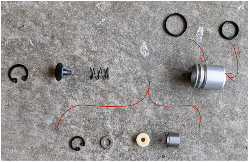

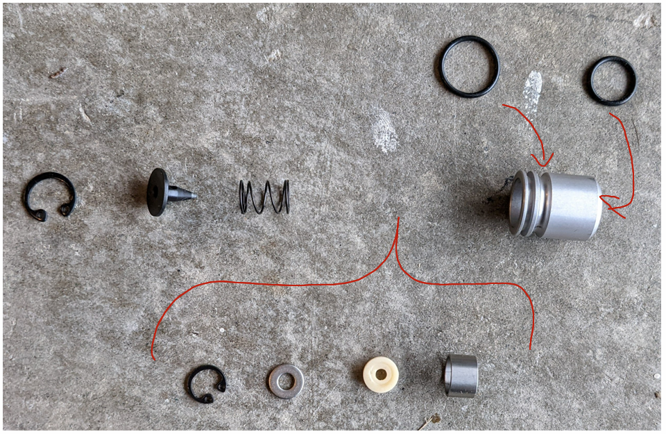

    Here is the pierce pin assembly:

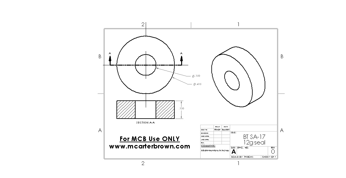

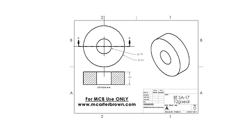

    Don't remember who was looking for it, but here are the dimensions of the 12g seal:

      After a lot of experimentation with puncture sea replacements, I can report the following:
      - 3d printing seals to Xemon's specification using CraftCloud's Elastic Resin (https://craftcloud3d.com/material-guide). This material immediately blows out.
      - Using a -201 o-ring without the smaller retaining ring seems to work well enough. It survived two CO2 changes in garage testing.
      Next up, field testing. If anybody can report back any experiences with alternatives before I do, that would be appreciated.
