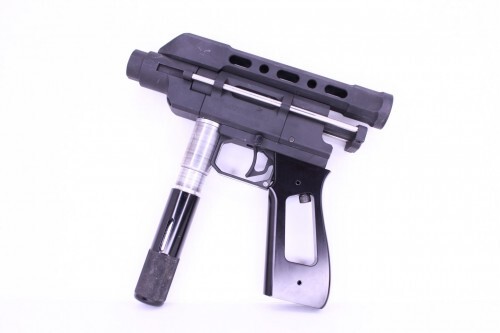

        I have a small pile of Thumpers and a Phoenix, I've been holding off on posting details of the Phoenix in hopes of reaching Brian first.
        One of my Thumpers is notable for having what is supposedly every possible upgrade, including a redesigned breech. That one I can get some pictures of for reference.

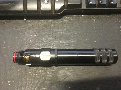

            I just got this in the mail for mine.

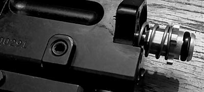

                        Not much to do, just a light lubing of vaseline or super lube if your tearing into it.
                        Make sure not to over do it and go easy inserting the reg and main piston. Air passages are sometimes sharp enough to knick an oring.
                        Check your hammer as it's probly aluminum, they wear a groove causing issues.
                        If you have to tear it down, check on main piston for straightness, the small (1/4" diameter) shafts bend at the oring groove.
                        Run an external reg if you can. start at 300psi and work your way up to velocity. Internal reg can be screwed all the way in to bypass it, if running an external reg.

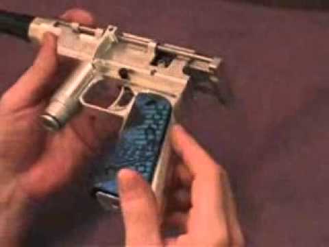

                          I may actually own the Thumper in this video:
