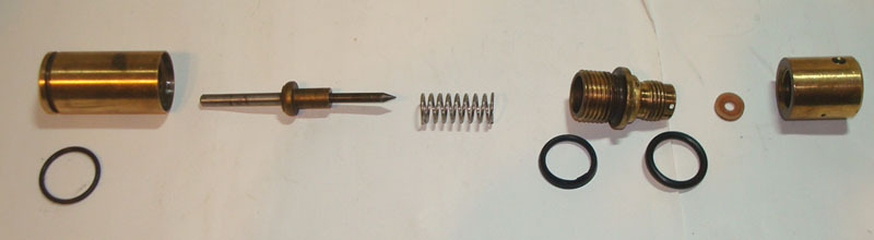

    Non cartridge valve:
    Picture credit: MaD

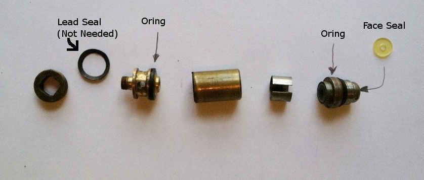

    Cartridge valve:
    Picture credit: MaD

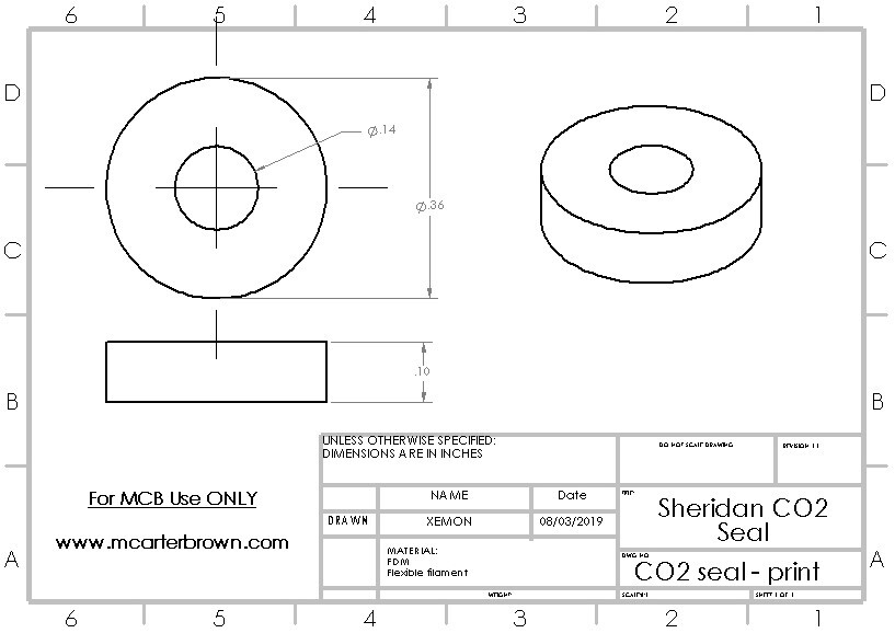

    Here are the dimensions of the CO2 seal:
    CO2 seal - print.JPG ​​​​​​​

            • MaD
              Smurf
              • 3
              Originally posted by packersrule729
              This is great. Much appreciated. My goal is to get a breakdown schematic with photos of actual Sheridan parts, eventually. The resource by Mad(?) on the old Sheridan armory forum was very helpful.
              Looks like some of my pics made it back. I probably have all the pics somewhere. Is there no recovery
              of any of the old forum database?

              • MaD
                MaD commented
                The normal pictures are mine. The black cad drawings are from 3022. Not sure if it was me or others who posted the white ones but they are from Sheridan manuals so not sure it matters?
                I can probably recreate the guides. I have to find pic backups or figure out how to get my 980 pics out of their photobucket prison.

                    Does anyone have the dimensions for the 12g seat/seal?
                    Fred aka ChoSanJuan
                    Team: With Intent
                      XEMON commented
                      I added it to the second post, hope it helps.

                    Idk of it's a wear thing, but my 12g seals had a slight taper to the hole, which let's the pin come down further toward the cartridge. I modeled this on my thingiverse version which has been working well. I can't see how they would have punched that out originally, but they could have been cast that way.
                      XEMON commented
                      They are pretty flexible ... I have ran a drill through mi 3d printed one and as long as the 12g fit, it will seal ...
                      The taper a nice idea to clear the pin ...
