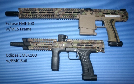

                        I use an Emek if I want to go hopper fed:
                        Click image for larger version  Name:	emf_emek.jpg Views:	0 Size:	82.1 KB ID:	694880
                        Adjustable RoF would be cool.....
                        Walkers Current Feedback
                          Yes but not everyone has a bunch of markers
                            I need to get me one of those magfeds so I can play with frist strike rounds.
                            Is there a reason you don't have any sort of optic on it?

                              Walker commented
                              Just personal preference at this point
