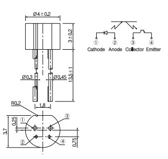

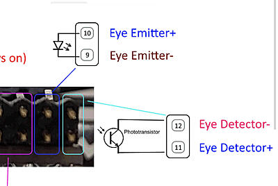

How'd you wire the eyes? Specifically, which wires to what spot? I want to run a reflective eye on a project but have no idea what wires do what on an Eblade eye.
Board Swaps
To be honest I haven’t been home enough recently to touch this project in a few weeks. So I can’t say 100% how I wired it is correct, but should be. I’ll check next weekend.Originally posted by Jordan View PostHow'd you wire the eyes? Specifically, which wires to what spot? I want to run a reflective eye on a project but have no idea what wires do what on an Eblade eye.
I cross referenced the 2 pictures below.2 Photos
