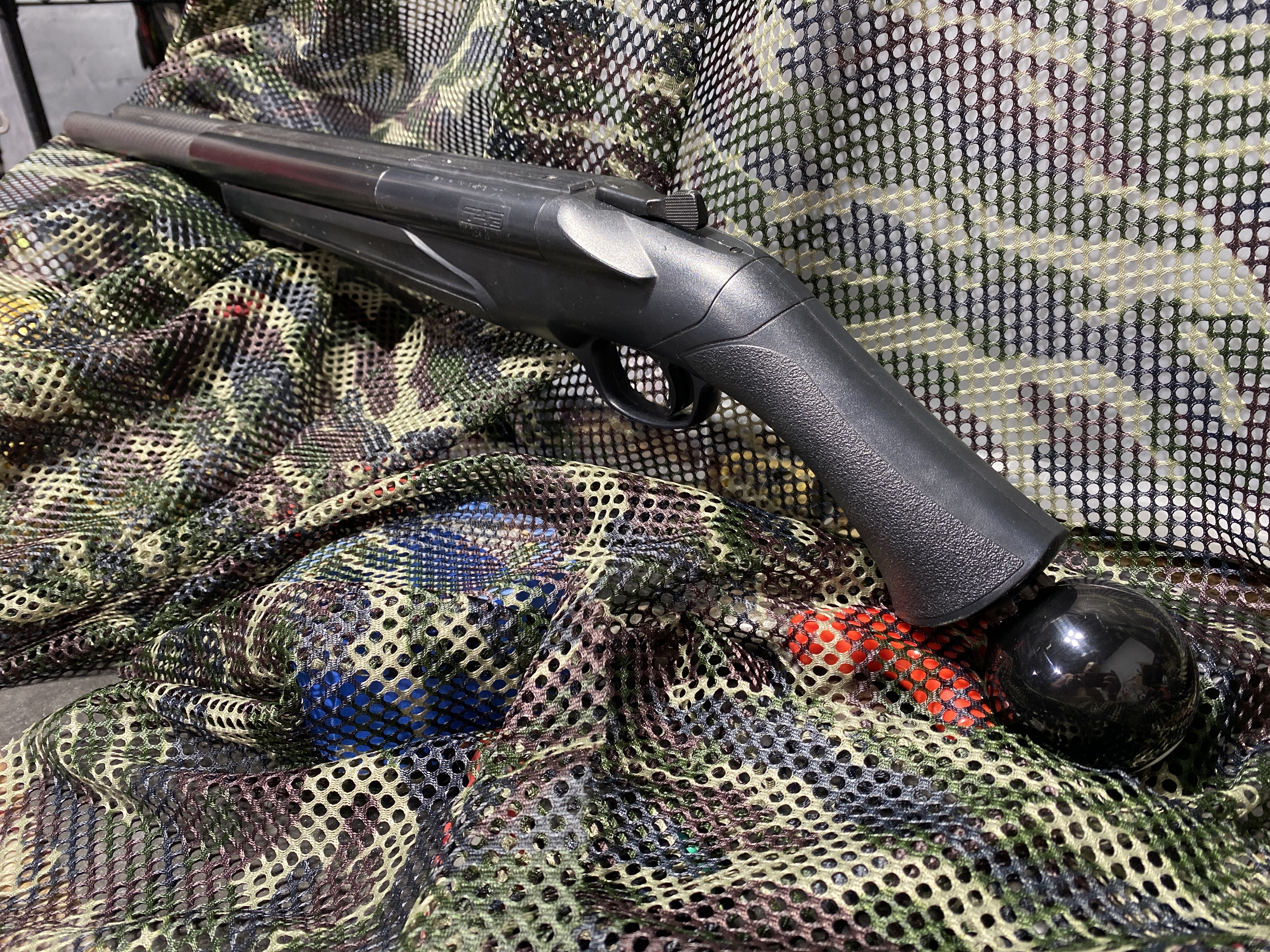

    Started with a T4E Double barrel I picked up from KOB used.

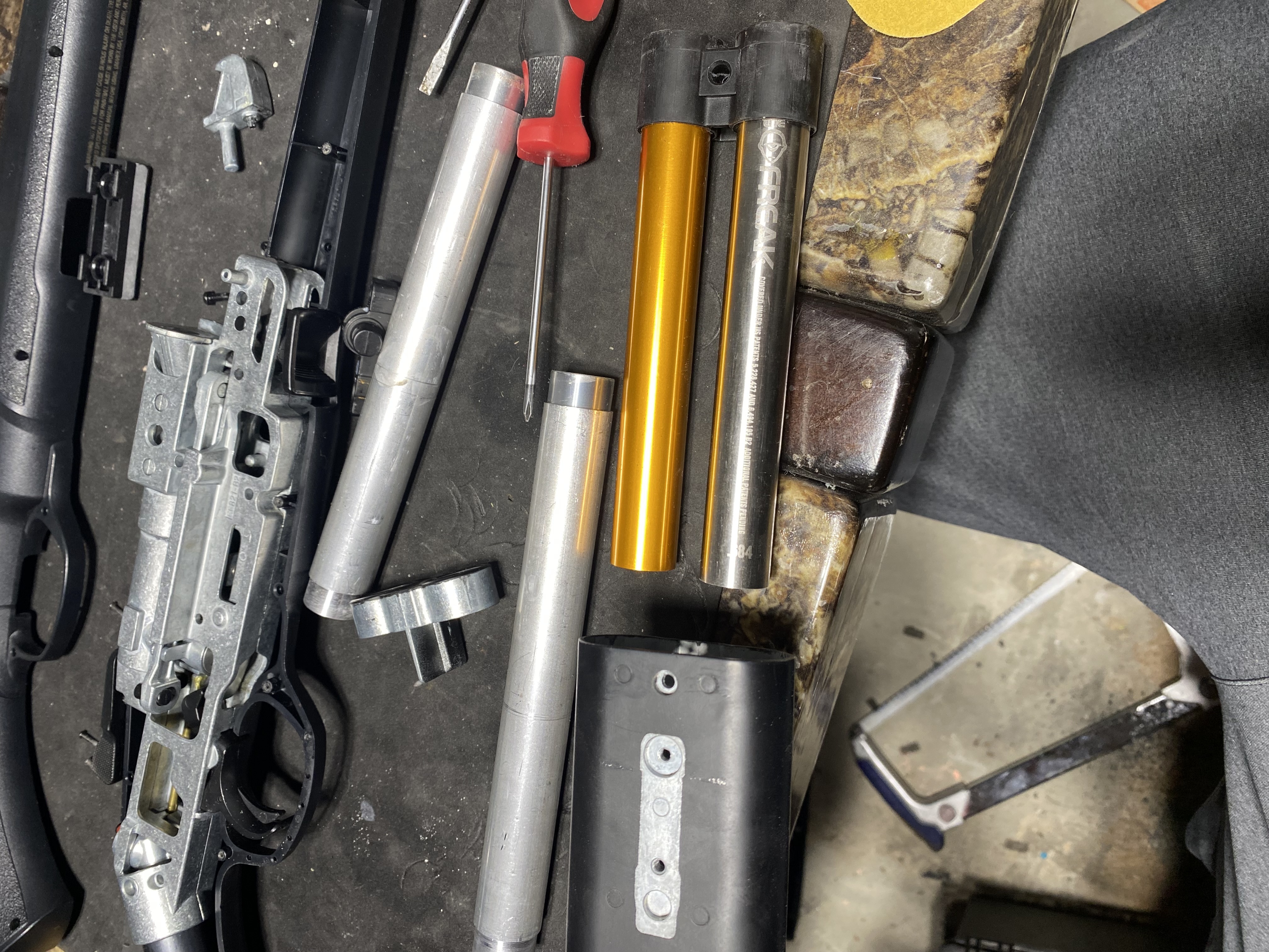

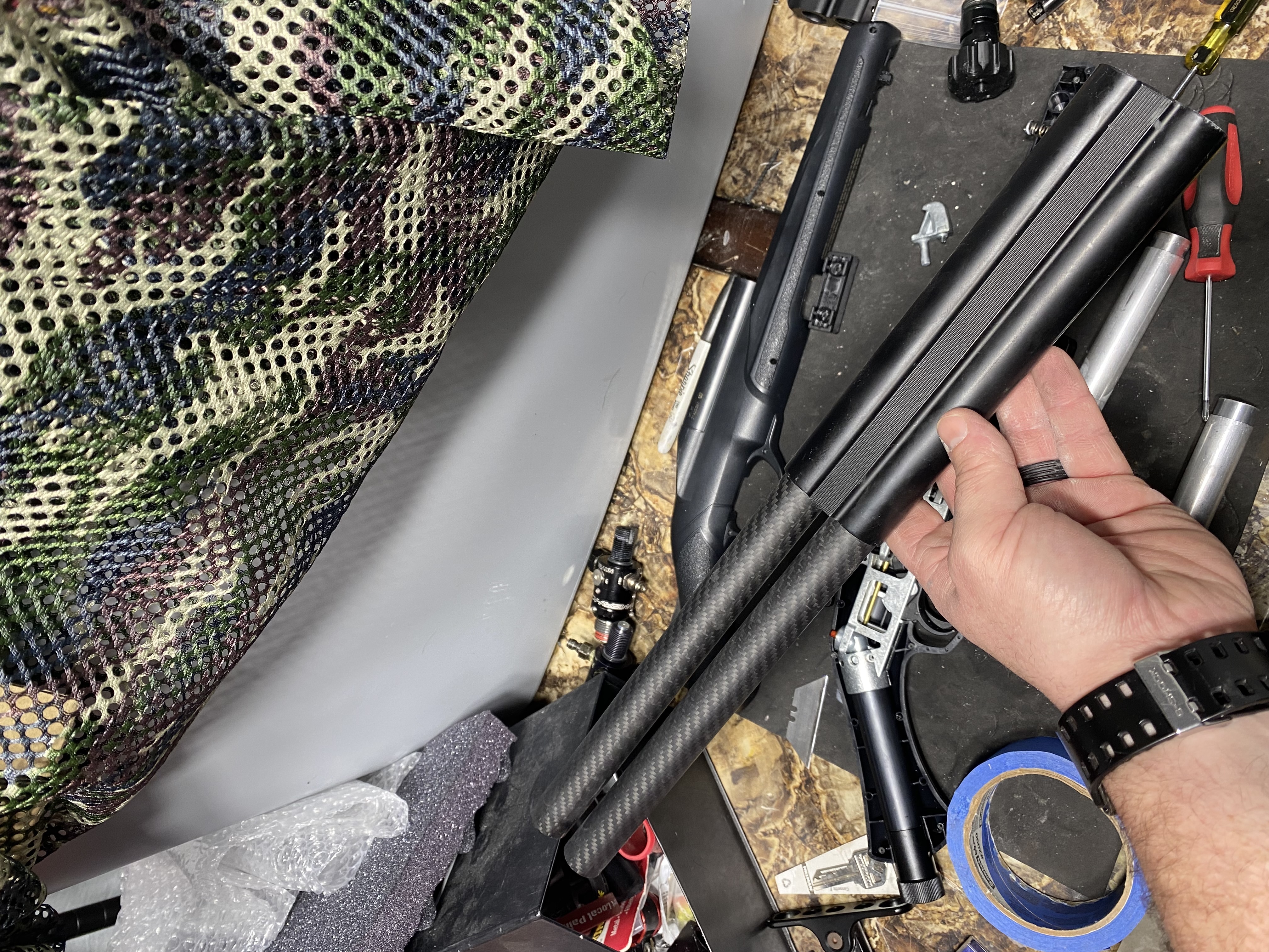

    Pulled the stock barrels. Well guess what fits perfectly in place of the stock barrels yup those are freak bore inserts. I had a piece of carbon fiber tubing I purchased for a feed tube but actually bored out to a .681 so it didn’t work for a phantom SC feed tube so I honed the inside down to capture the .681 freak inserts.

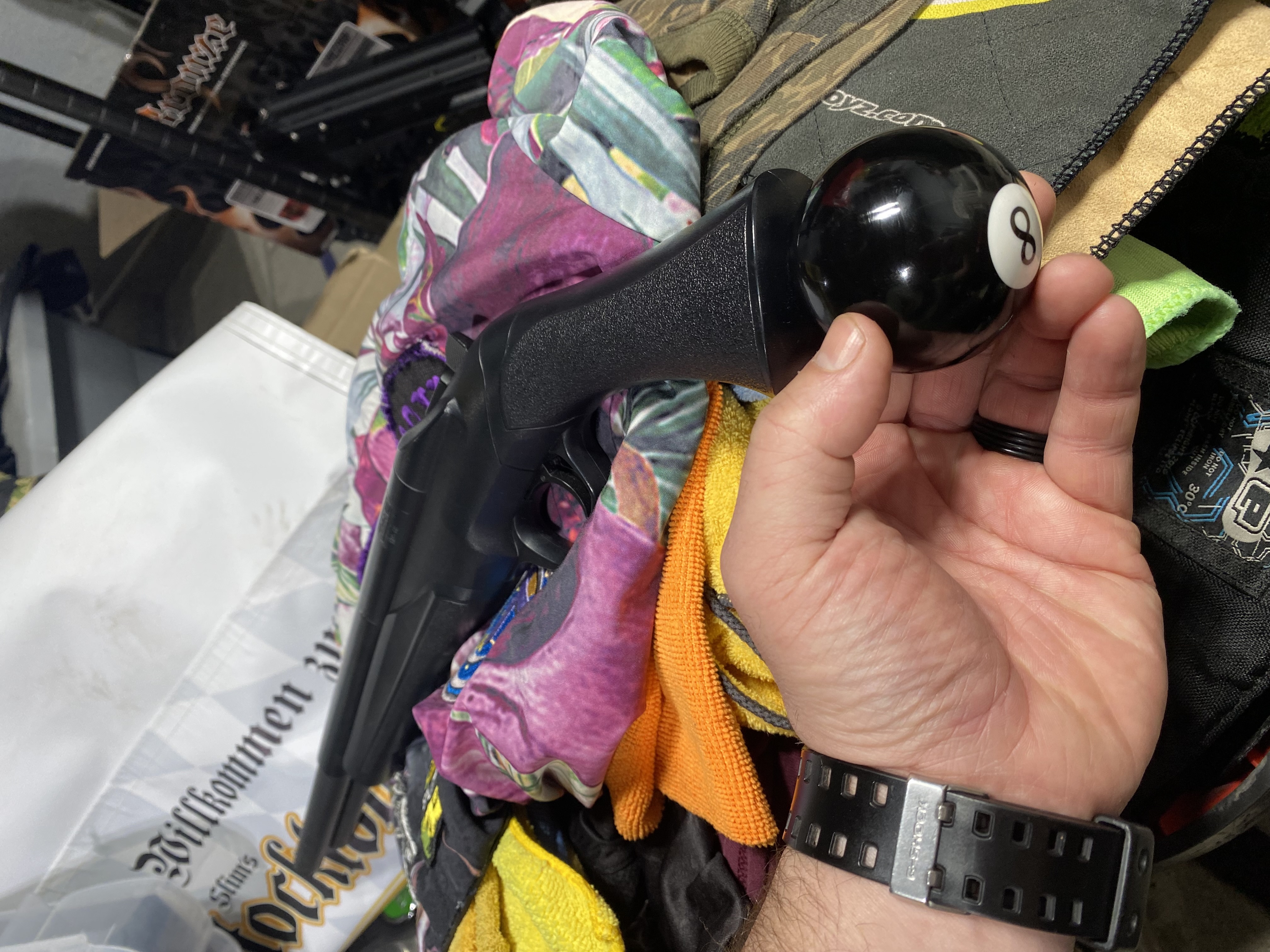

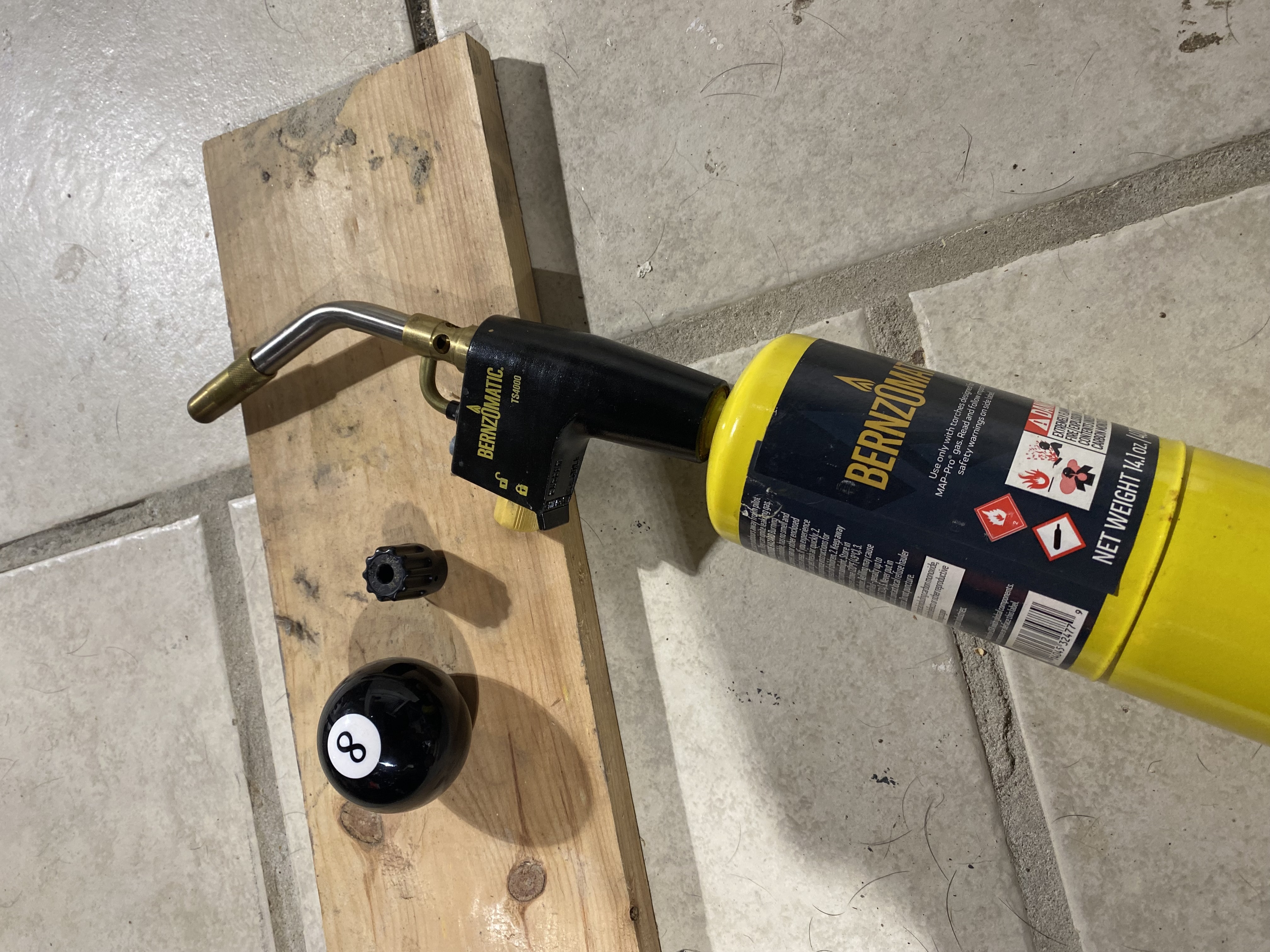

    Forged in fire! 🔥 Found a 8 ball shift knob 2.5” round (plastic)
    Pulled the piercing assembly apart so it was just the bottom cap heated it up and press fit it into the 8 ball knob.
    cleaned up the hole that was now keyed into the plastic and JB welded that sucker in there. Going to sand and paint the top a lil to hide the Jb weld.

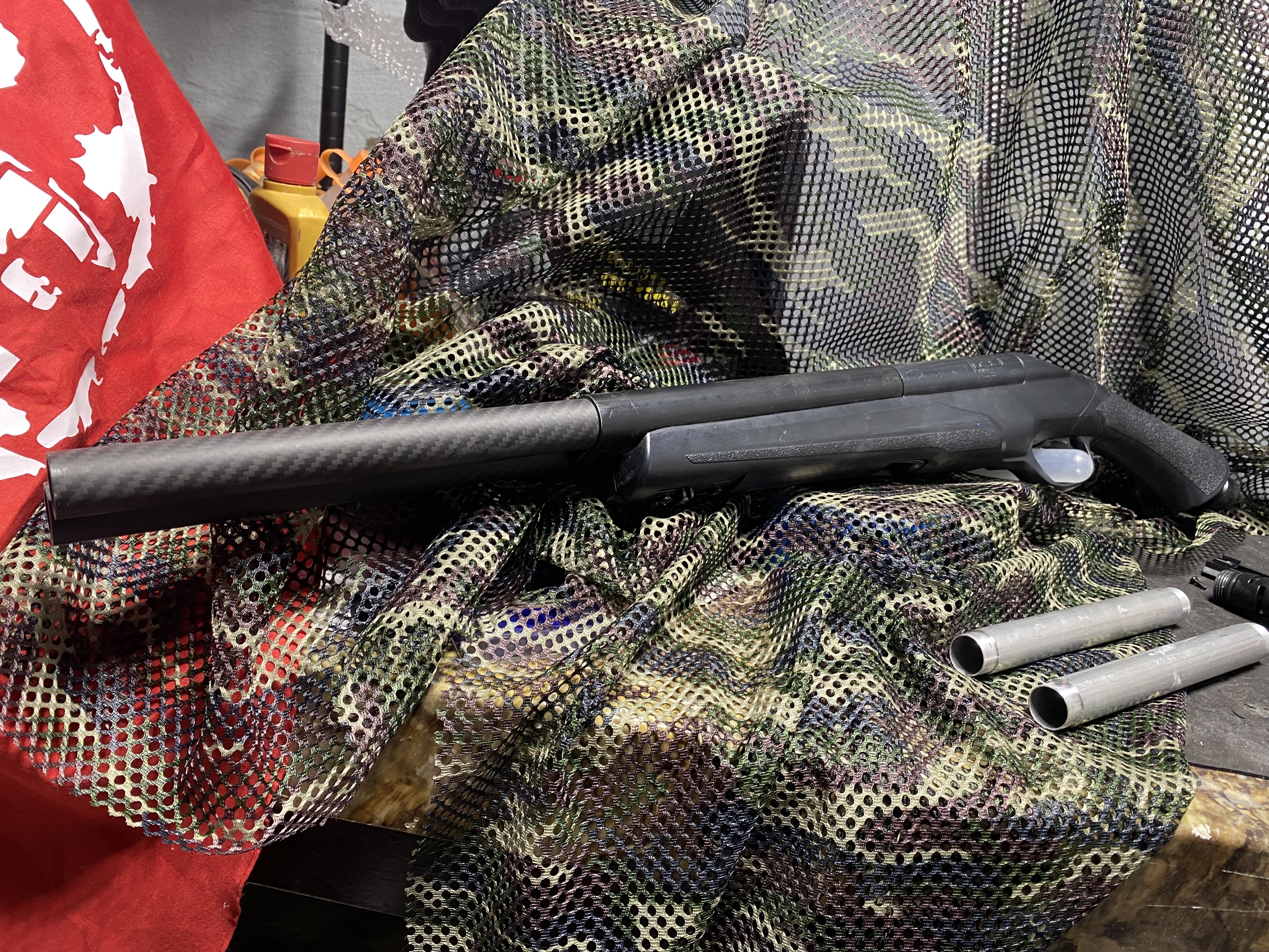

      Shoots great with the longer tighter barrel and freak bore Im getting better velocity even shooting two at a time. Restrictor is drilled out for better pew pew.
      If I can get a Palmers 105* Asa adapter I’m going to go HPA and use a Nicebutt Stock I got in the parts bin for the full length shotgun look.
      So far I got $65 into the marker $15 for the knob the rest I had laying around. The palmers Asa adapter is pricy if I can get my hands on one. It’s a very usable setup so I see myself shooting this a lot. I

        Are those standard length Freak inserts or XL?
          Standard you have to disassemble it to change them out but it’s not super hard to do.
        • Chaos
          Chaos commented
          Chuck E Ducky I suspected that Freak Inserts would fit, but I figured they'd have to be XLs...good to know,Thanks man

        8 ball changer setup I did crack it but JB seems to be holding. Just got to clean it up now. You can twist it off with a full 12 now. Gives you enough leverage.
        I can’t wait to go all tactical Elmer Fudd with it.
