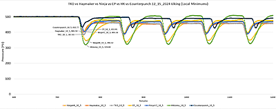

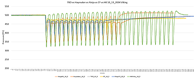

    A local friend asked me to run all his tank regulators across my reg tester. I used to do recharge compares for a manufacturer and had all the wiring just sitting in a box.
    I could put together a spreadsheet of pressure drops, slope of recharge, time back to target pressure, etc but I don’t think it’s really needed. If anyone does want a different plot let me know.
    All the regulators were run the same day on the same AKA Viking at 10.5 balls per second. The focus is on the pressure at the point each shot is fired and how close it is to the set pressure (we targeted 500 psi but applied a gain to those regulators not set exactly to 500).
    Long story short - the regulators perform pretty closely to each other (~20 psi variance initially) and any difference will likely get mopped up by the marker’s HPR. His 2 Ninja regs do seem to creep from target and one has a large pressure drop at each shot but maybe they need more breaking in.

    i always love these charts... perhaps change one of those first 2 to red? those colors are too close to one another to tell apart easily
    • Roger7pball
      Roger7pball commented
      Yep, can do.

    Which Ninja reg is the orange line? Their standard reg? That V2 looks significantly better, it seems (within the graphed relationship). And the CP has the best drop-to-recharge ratio?
    • Roger7pball
      • 572
      • Arizona Bay
      It’s the regulator all the way on the left, HK Aerolite2. Says powered by Ninja on the reg so I just referred to it as NinjaHK. It was nearly new so my guess is it needs to be broken in.
      The CP performed great, their HPRs I have tested do great as well.
        • 4509
        This is great, thanks for doing that and sharing. I've always thought CP stuff seemed to perform outside of their lower price range and it's nice to see that backed up with SCIENCE.

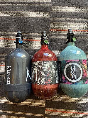

        My friend picked up one of those $35 HK tank regs. 450-550 psi output model. Being so cheap I had no idea what to expect. The pressure drop each shot is the worst but it does the best to get back to target pressure. Interesting, maybe their piston moves more quickly.

          The Powerhouse Counterpunch added to the mix. Seems to be the best so far for keeping pressure up, but big picture any tank reg will work just fine.
