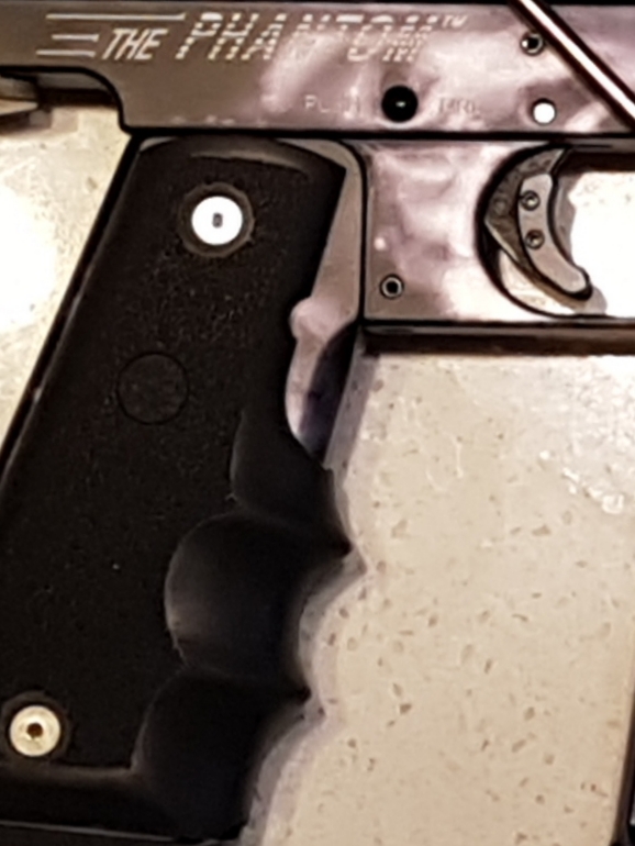

                  I would replace that grip. Everything else is probably fine.
                    Thanks for the added comment lawn..cant like it for some reason
                    zeta...na man the dye sticky grips are awesome. I do have some empire lady ones too for 45.

                    I just picked up my first Phantom and have a question about the 45 grip frame. Does anyone else find it slightly long? I know I've had this for all of two days but find with the wrap around grips that the gap between the bottom of the trigger and the swells of the bottom two fingers is too far. It has the basic wrap around grips so maybe others are better. I will probably end up making myself some anyway.

                      I had a pair years ago and wasn't really a fan of them. It's more the positioning of my hand here than anything.

                      I use the hogue palm swell grips. The ones that don’t wrap around The front. I’m pretty sure that all wrap around grips will sit too low on a phantom.

                      I agree, they are all standard sizes. I will make some eventually and can put the grooves where I want them.
