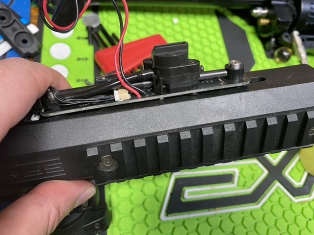

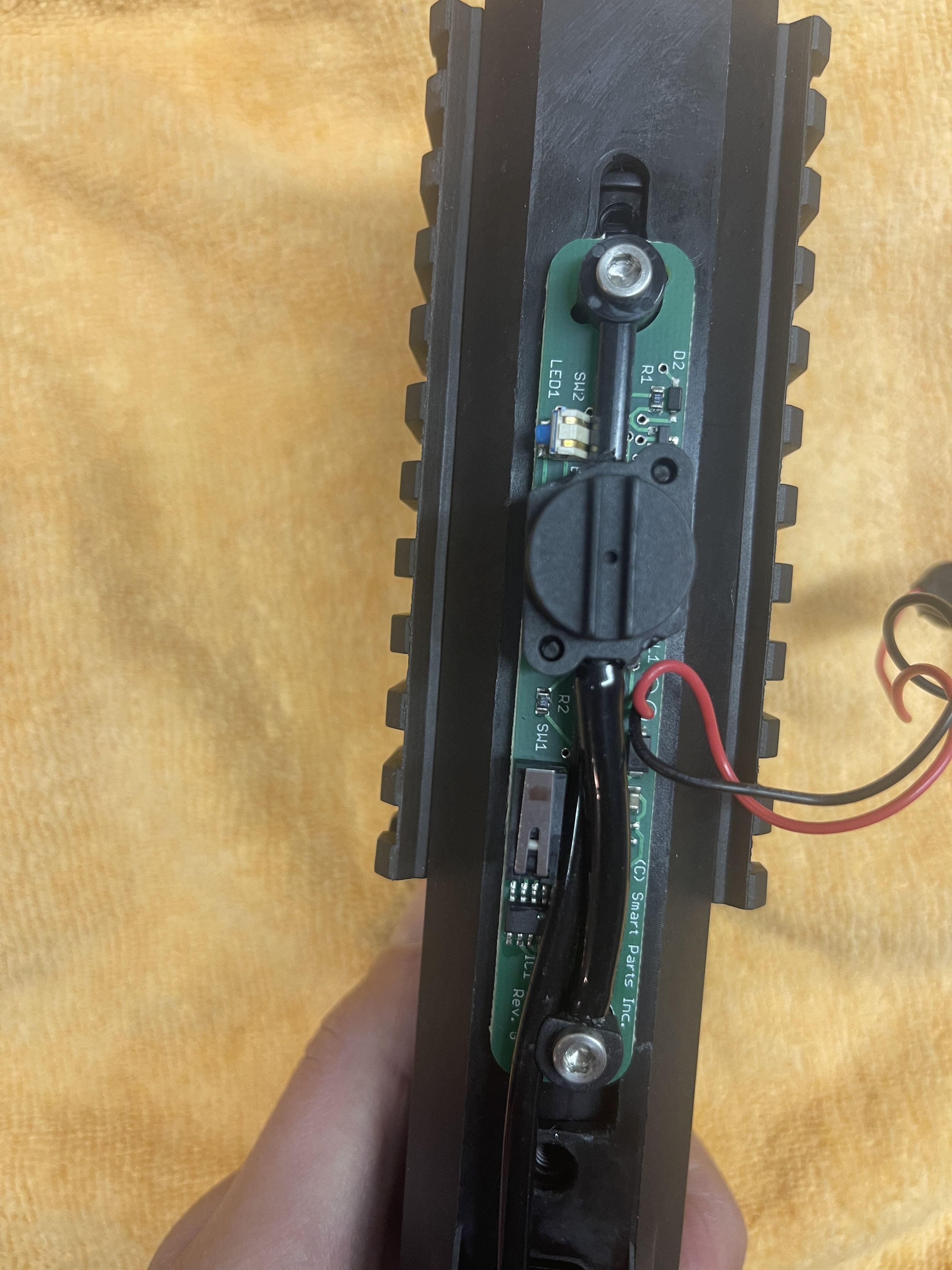

    Just picked up a done out SP1 with a TechT L7 bolt and blackheart board. Trying to get it up and running but it’s leaking from the board area. I’ve grease the seals and tighten the bolts but still leaks.
    looks to be the solenoid:

    Sounds like solenoid or fitting if its leaking at the board.
    Can you air it up with the frame off and wiggle hoses? Pitch of the peak change when you mess with the tubing?
    Also, put a nice fresh battery in, a fresh air tank, air it up, shut the eyes off and try to shoot a bunch. It may reset the noid, but im not sure it thatll really get ya somewhere.
      • 4520
      I have a spare noid in the bits and pieces. Just don’t know if the noid is serviceable or not. Rather get the one I have working.

        In 99% of the cases it is a hairline crack in the solenoid cover to the side where either of the two screws are. If you remove the solenoid cover you will see the crack. Or rather - you will not see it. You have to know what you are looking for, and even then it is pretty hard to find it - but it is there, trust me.
        It is a very well known issue on all of the SP/GOG markers that use this solenoid and cover, and is due to over tightening the screws to the cover. In fact, it is even surprisingly common to receive these "pre-cracked" from GOG, brand new, straight out of the box.

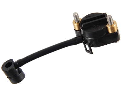

        When you reassemble the noid, do not use the screws. Use a nut and bolt. I use a 4-40 with a filed down nut.
        The upgraded solenoid covers ( part # ENV058) have brass nuts on them. They are not available form GoG or any US online vendor. You may have better luck in Canada.

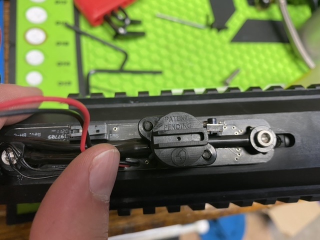

                Just throwing this out there if it helps anyone who bought a cheap SP1 as their first Smart Parts/GOG marker to find out too late that the solenoid cap is prone to cracking and replacements are impossible to find and stumbled across this post hoping to fix it like I did.
                I came across a LNIB SP1 on Marketplace for $40 to get it home to find it leaking badly from a cracked solenoid cap. I stumbled across a video to replace the cap on an Extcy with a Proto Rail cap. As I happened to have an old 2011 Rail solenoid with an intact cap sitting around I swapped them out and it works great now. Just be sure to use the Rail screws. I had to trim off the two corners at 11 and 5 o’clock (see pic) to get it inside the grip frame.
                Hope this helps someone out!
