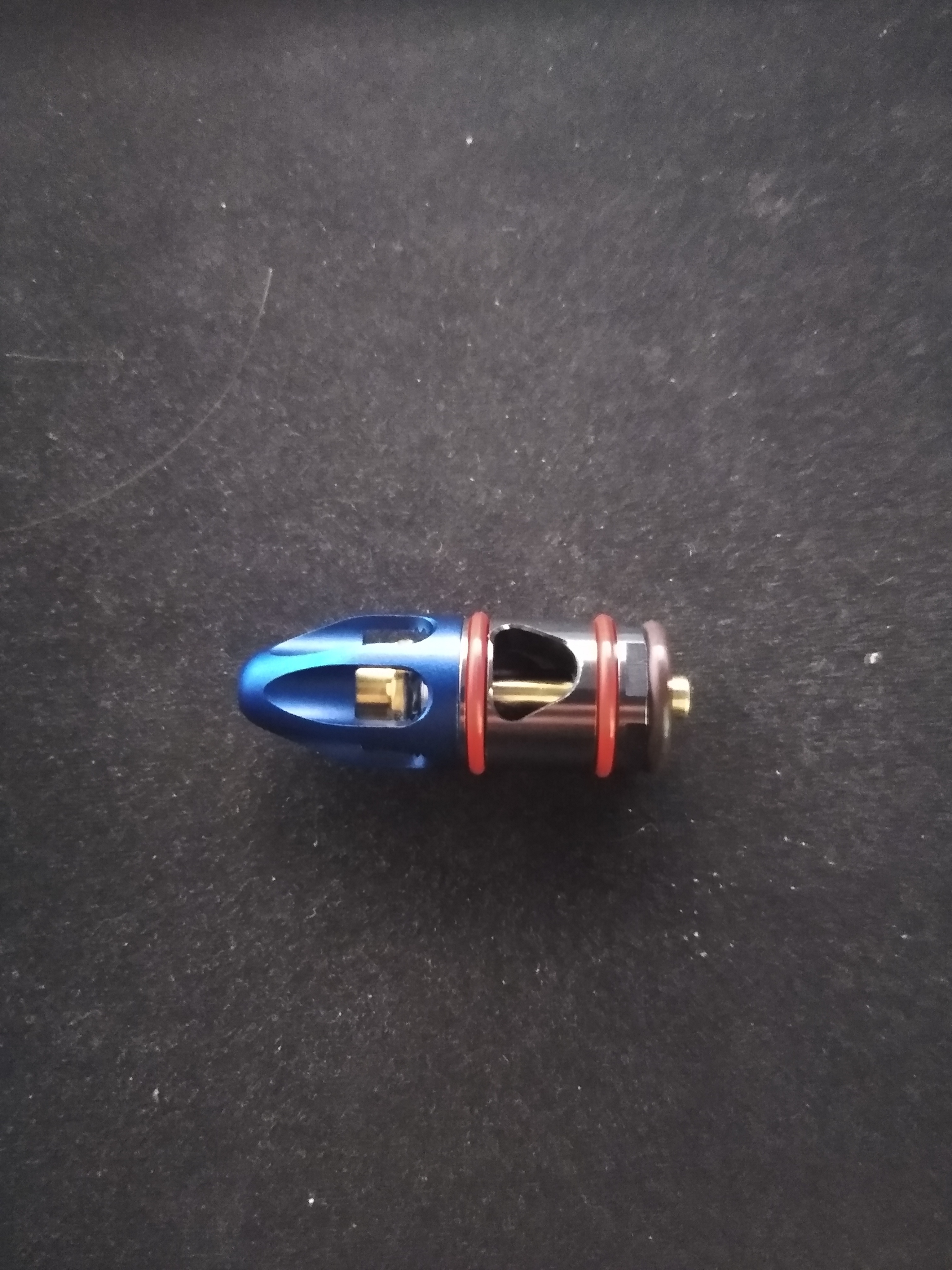

          I ordered from dye on Monday and fedex dropped it off a couple minutes ago
            That exhaust port is massive.

          Just saw a video posted by Jason Antle on FB and it shows him testing the valve in one of his custom bodies. Approx 160 psi. I just ordered one for my own trilogy, which is currently running a PPS low pressure 11/16 valve.

            It's nice having access to a new morph valve, which I like in trilogies to eliminate the Spyder spring.
            This looks like a good copy. Should you go out and get one? I'll shoot it tomorrow and let you know.
            Keep in mind, there is more maintenance with this valve design using 3 dynamic orings vs one hard cup seal. (morph and Lazarus)
            The claim on increased consistency is a stretch, considering the addition of 2 more failure points and a soft cup seal. Lot of that is HPR dependent as well.
            "Breach Sensing Technology​" lol cheesy marketing. morph has Venturi breach sensing.

            • imped4now
              imped4now commented
              The designer of the Lazarus historically despises the Morph...FYI. It's not a "copy."
              I own all valves pictured (and don't despise the Morph), so I'm not spouting random BS or trying to argue. The Morph "senses" the firing pulse due to position, while the Lazarus has direct communication between the shot pulse and spring chamber. I suspect the Lazarus has less opening force, but also less closing force, especially given the difference in spring rate.
            • latches109
              latches109 commented
              imped4now we will just have to disagree. I see a copy with some "improvements" / applied their opinions on the design.
              Function is the same, the morph also has holes to the spring chamber, you have to deal with vacuum some how.

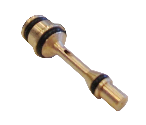

              Would somebody please give me a simple breakdown of how a valve can been "breech-sensing"? My base understanding is that these types of valves (I know they're different, I'm generalizing) are adjustable from the HPR side so you have pinpoint control and can balance the valve operation more finely. Is this reasonably close or am I missing the point?

                Breech-sensing: There is a hole on the exhaust side of the pin and inside the bore where the spring sits, with a communication passage between the holes. The U-Cup seal seals off the "spring chamber" side of the pin. When the valve opens to fire, some of the air rushing to the bolt/ball travels into the hole, through the passage and into the spring chamber (the closing surface area of the valve) to provide a closing bias. This is the exact same concept seen on any modern breech-sensing spool valve - IV Core, Gamma, ARC, etc. This is why there is an orifice at the tip of the valve with a passage extending the length to the small chamber behind the valve - to provide extra closing bias.
                CS1 example: http://www.zdspb.com/media/tech/animations/cs1b.gif
                Gamma example: http://www.zdspb.com/media/tech/animations/gtek.gif
                In the Gamma's case, the air saved by the advanced valve closure is responsible for resetting the bolt to its home position.
                The breech-sensing concept was introduced by Lurker with the Control Freak poppet and in a production marker with the PE IV Core.

                Ah, I get it now. This is backwards from that design I had that drove me nuts; it's a neat feature to trigger it closing (although I'm curious just how much impact it has). This is rapidly moving up my list...

                You believe "breech-sensing" is marketing? It's not and it's over a decade old at this point....absolutely nothing new.
