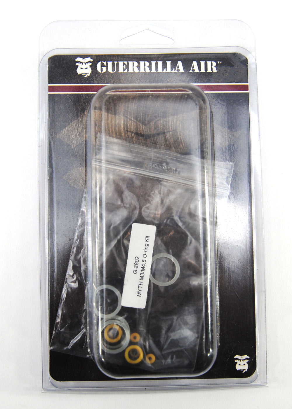

And if you want to get super fancy, you could try measuring pixels from one of the rebuild images..... (https://www.pbsports.com/cdn/shop/pr....5oringkit.jpg)Comment

Wow. Those are some yellow o-rings in that picture.Originally posted by Matt DrownAnd if you want to get super fancy, you could try measuring pixels from one of the rebuild images..... (https://www.pbsports.com/cdn/shop/pr....5oringkit.jpg)
