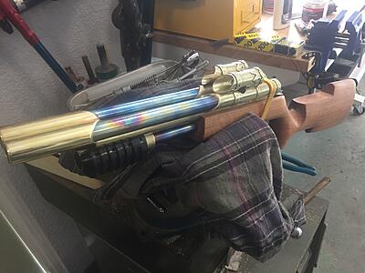

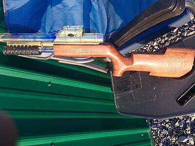

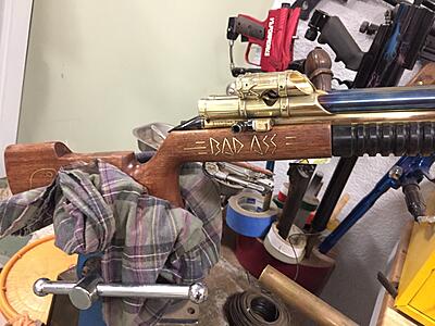

    Got the ole thumb back in working order and some more work completed on " Bad Ass".

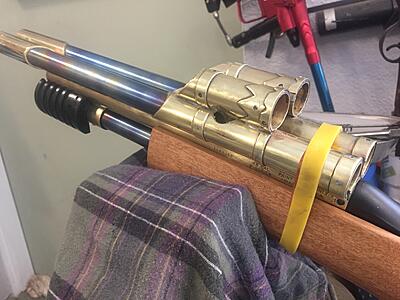

    Went through three rounds of soldering to get the feeds and the rings soldered... thought I could solder the rings on without jigging it up and almost made it before I got it to hot and everything fell off..
    had to start over and then I misaligned one feed the second round and had to give it one more go..
    finally got her but it was a pain... not going to let that happen again..
    i flame anodized the titanium barrels before soldering them in, made a new stock for her ( tac-50 style) and started a brass inlay of a sheriff star on one side the the butt...
    Internals are installed and rifle trigger group installed. Had to cut and re weld the trigger to work with the pistol hammer...
    Here is some pics of her now...
    More to come, bolts, feed plugs, different pump grip, more inlay on the stock plus the stock finishing...

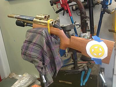

                        Had some free time on myhnds and I managed to finish the stock with some inlay..
                        I also inletted the stock and mounted the body.
                        Sneak preview....
                        i will take some better pictures and post up later..
                        Taking form and getting closer to the finish line.

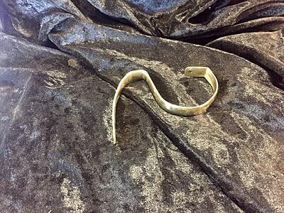

                            i also completed the brass inlay and made a trigger guard from a piece of old barrel.
                            we are getting close, I just need to make some feed plugs, mount the trigger guard, install a drop with asa.
                            if I have it, I'll make a brass butt plate for her also...
