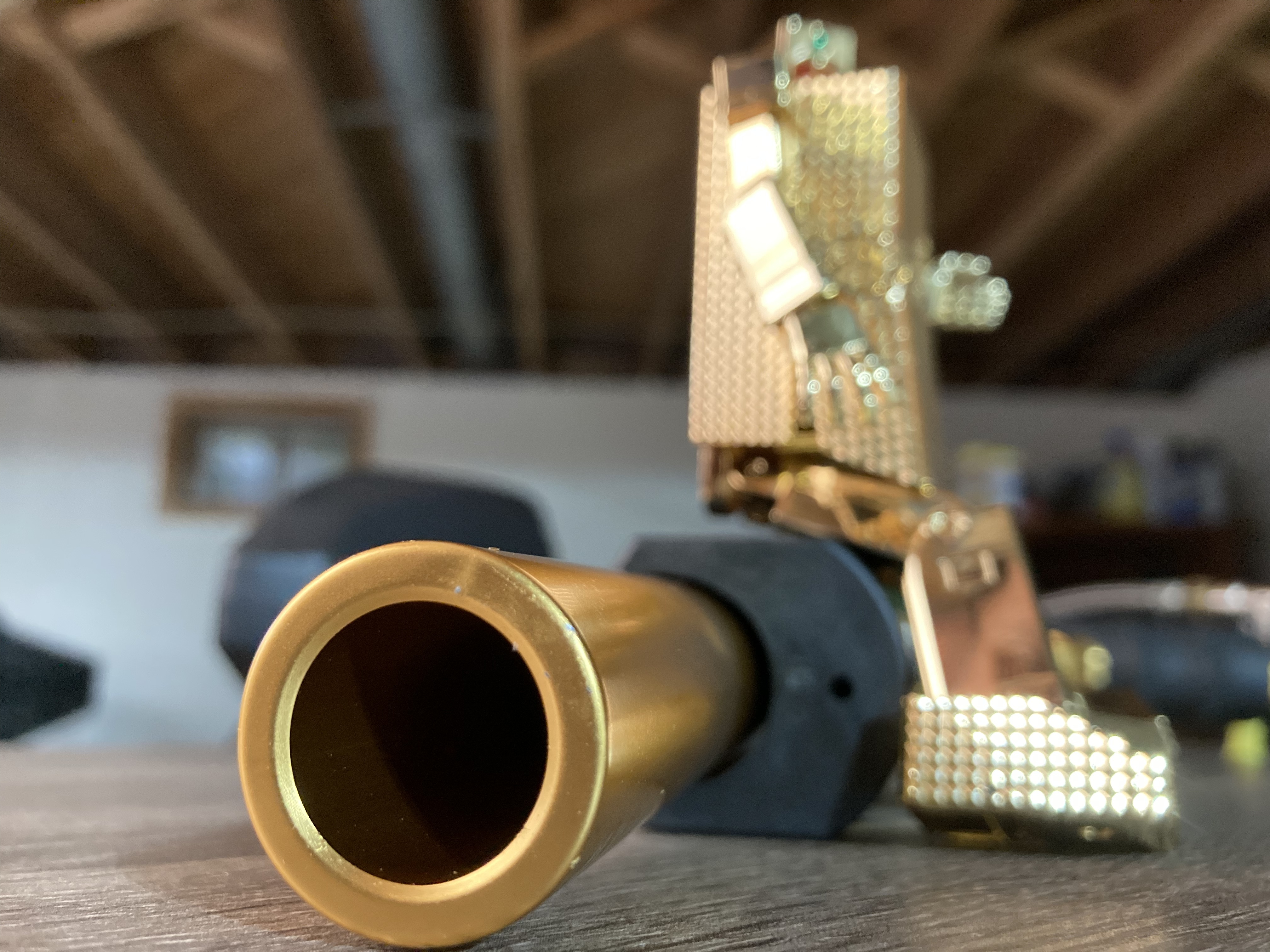

    BTW, the barrel is awesome because it’s so thick it’s basically flush with the block. I do wish it had some porting or at least a more well rounded opening. It’s loud as $&@?, which I like, but I’m not so sure how accurate it will be once I start caring. It’s a little shorter than OG Sterling barrels and has no brass liner.

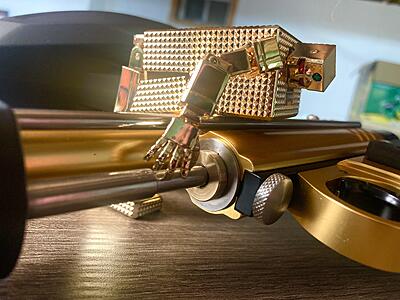

    Attached are pics from a late night shooting and swearing session with Mr Crystal Cut himself, Gold Lightan. You can see he loves the color but hears a leak from somewhere…

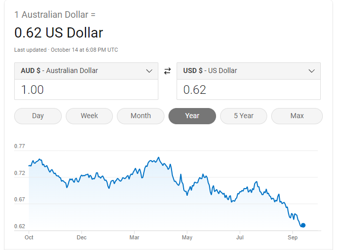

        Keep in mind too the Australian Dollar has been in steady decline. So these markers are getting cheaper by the day.

        Yeah, my total bill in AUD was $670.20 which on that day in USD was $457.10.

            What I meant by “thick”.
              They offer them freak bore for a lil more it’s in the drop down. Brian got his done they did a good job to.
