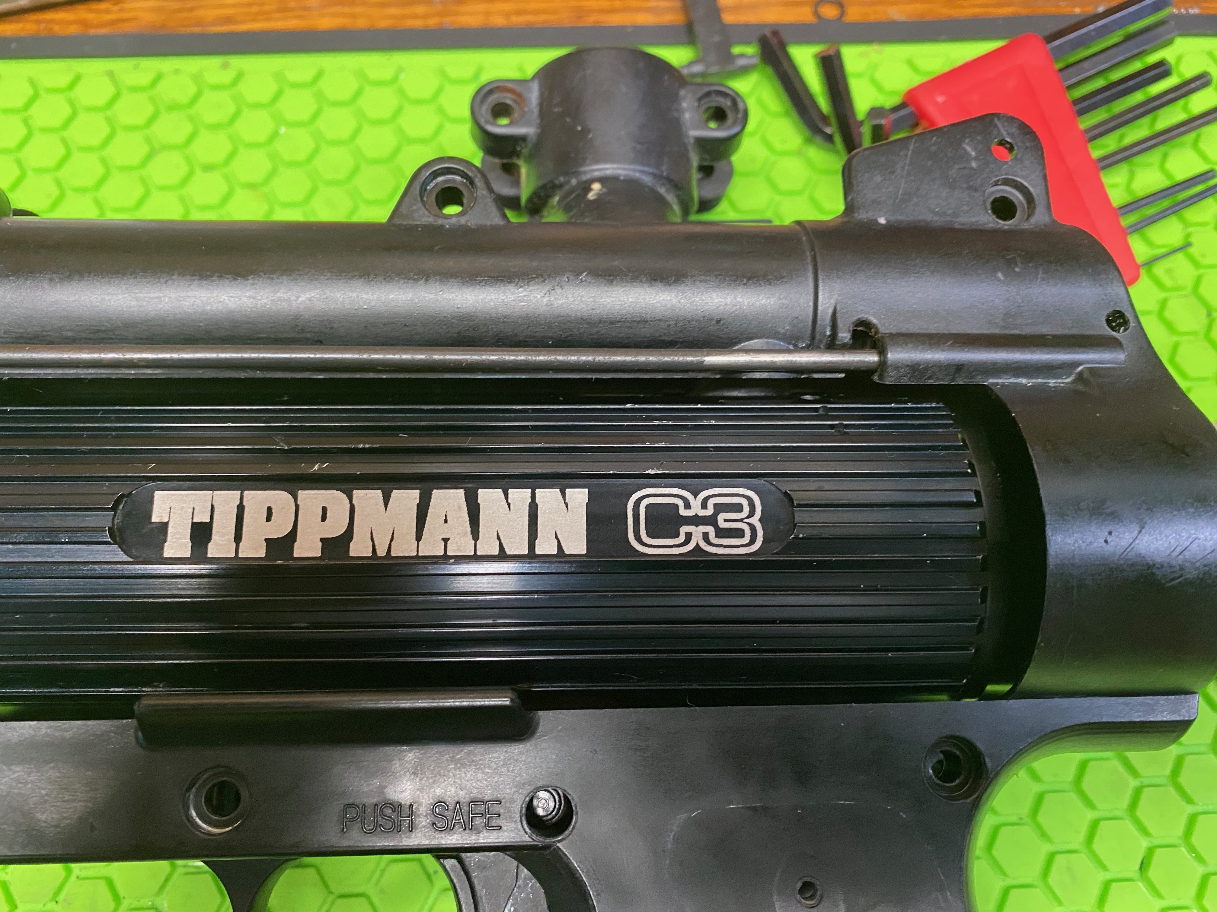

Adventures With Tippmann C3!

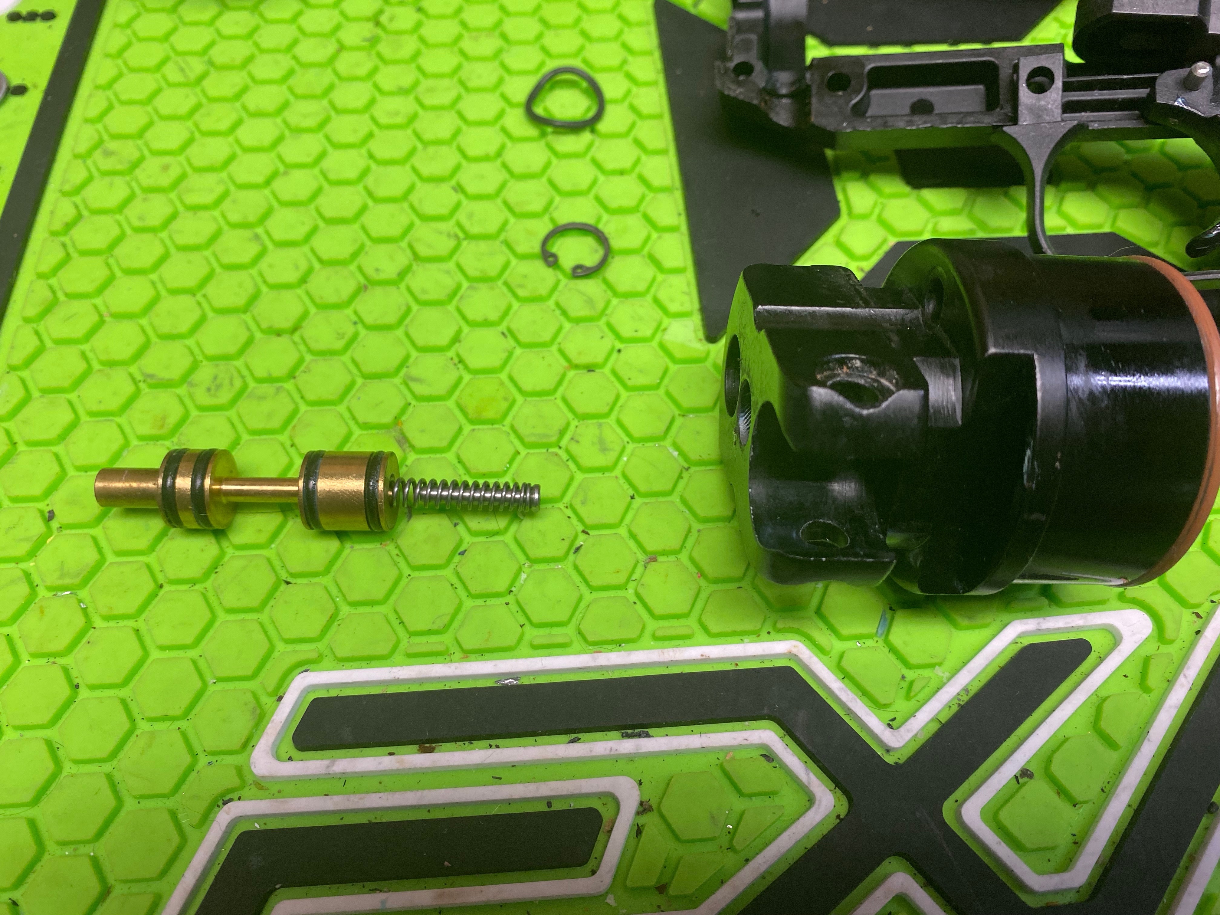

    And here's the valve in assembled form with the clip shown above.
    Click image for larger version  Name:	20A-C3.jpeg Views:	0 Size:	2.93 MB ID:	165562

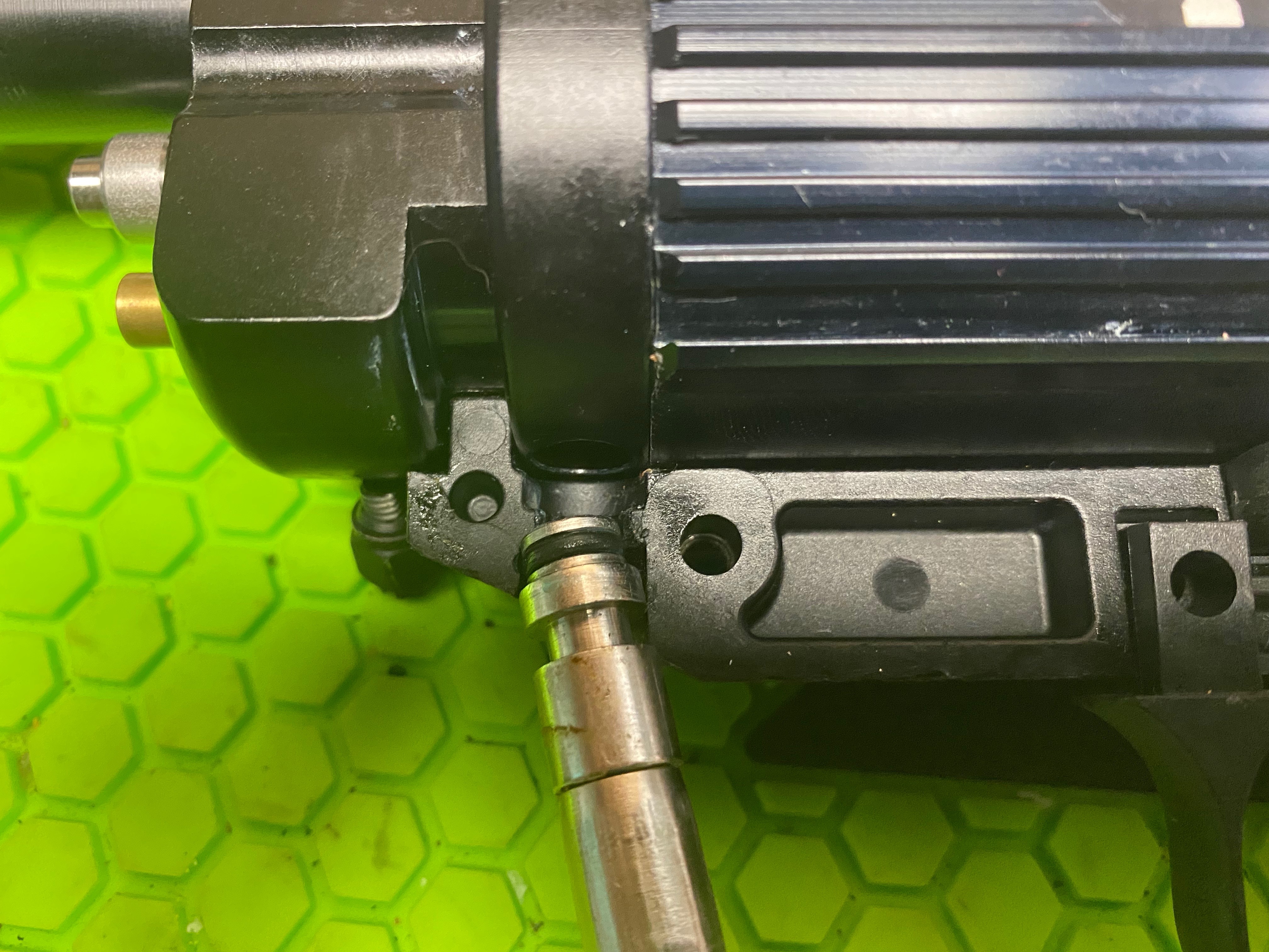

    And the final little connecting for the combustion chamber is this gas line from thegas line is this little connector with a o-ring. Not threading at all, just held in place by the o-ring and the groove in the clamshell:
ID:	165617 So this is oriented to the front of the gun as you can see the main pump rod and the fuel pump rod. This fitting is the end of the steal braided gas line.

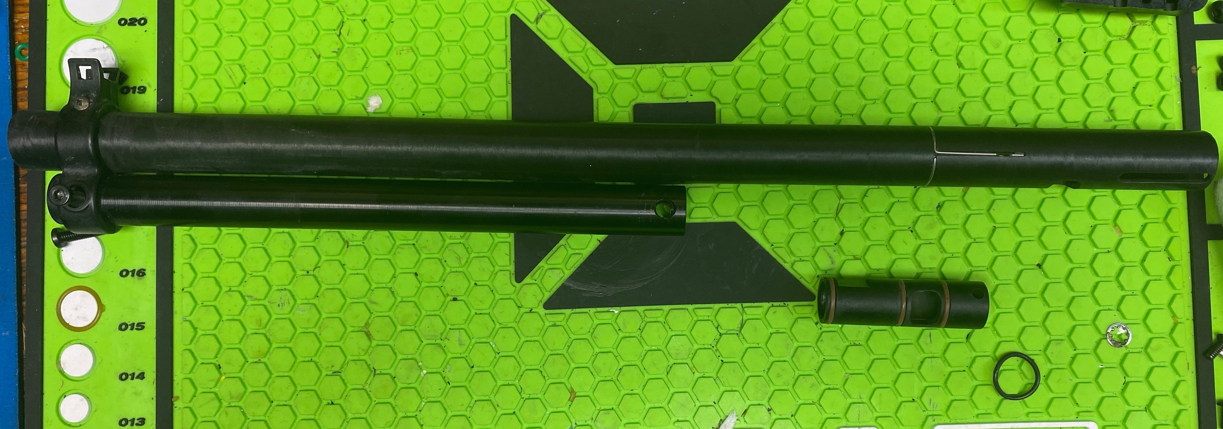

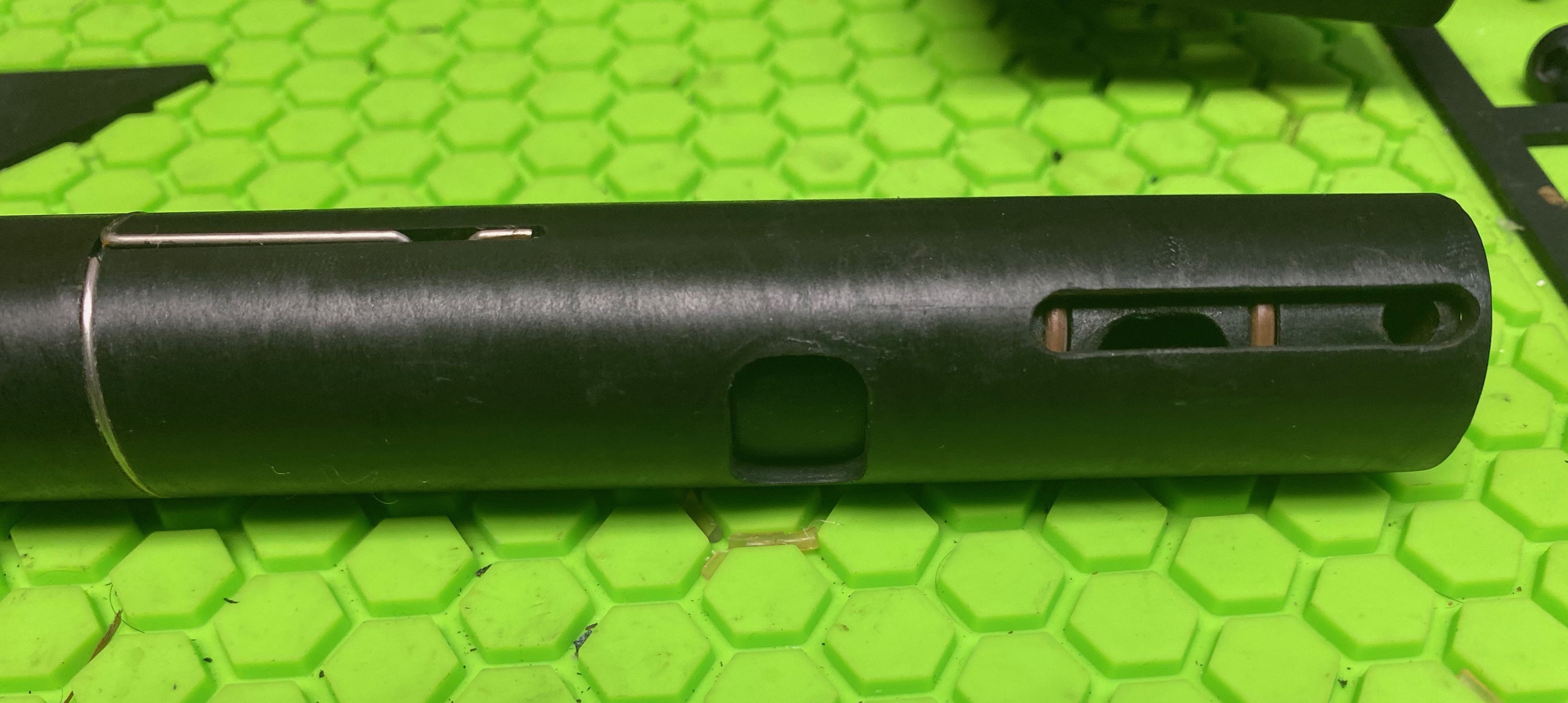

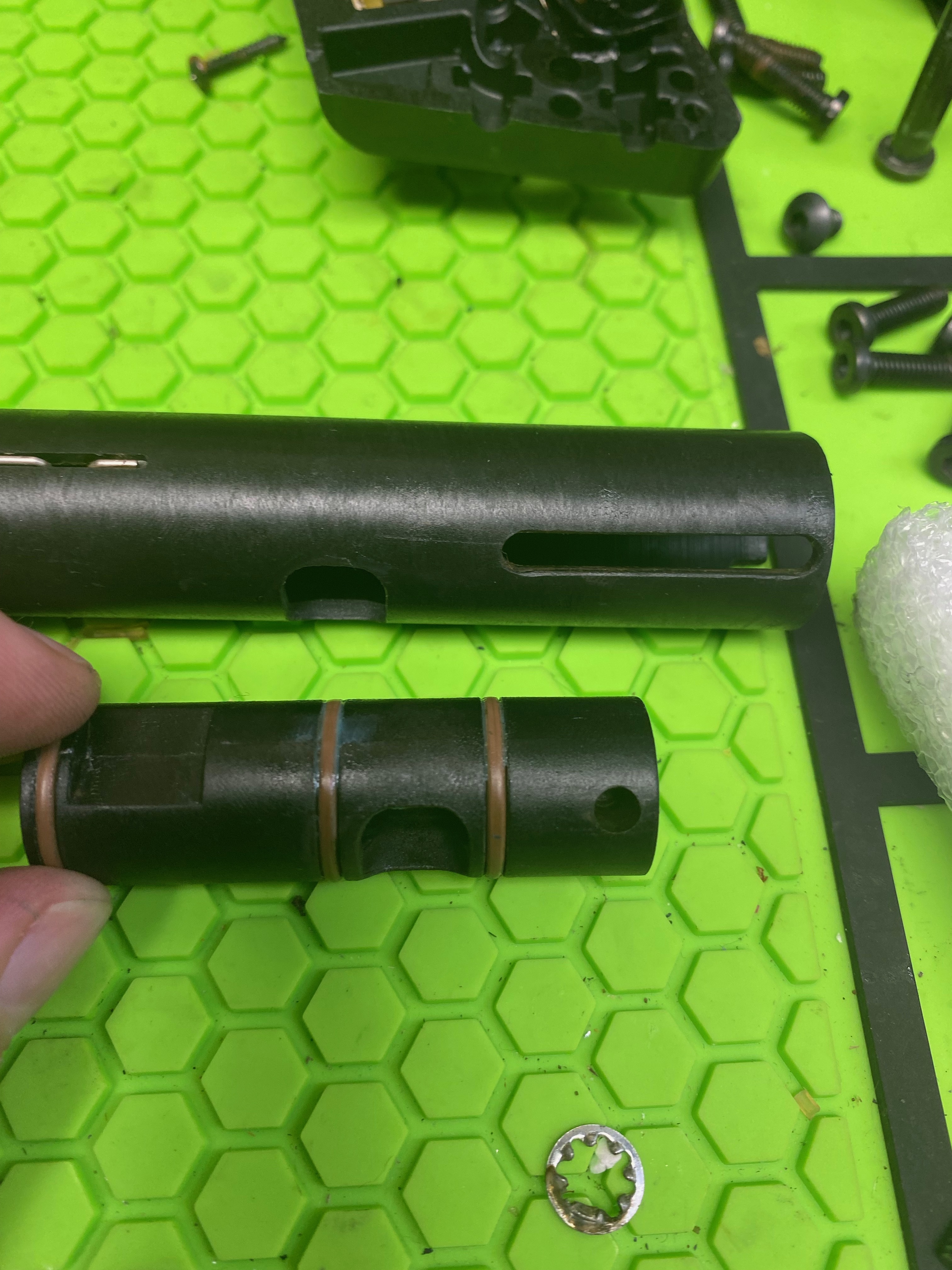

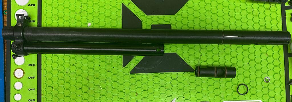

      Moving on to the barrel and pump assembly now. The barrel appears to be very long, but as the ball enters very close to the back of the gun the barrel length is not bad at all. The top tube being the barrel with wire detent, the bottom piece acting as a guide rod for the pump handle. It attaches to the body via a Tippmann pushpin. (not shown). There is also the bold and the PITA o-ring shown.

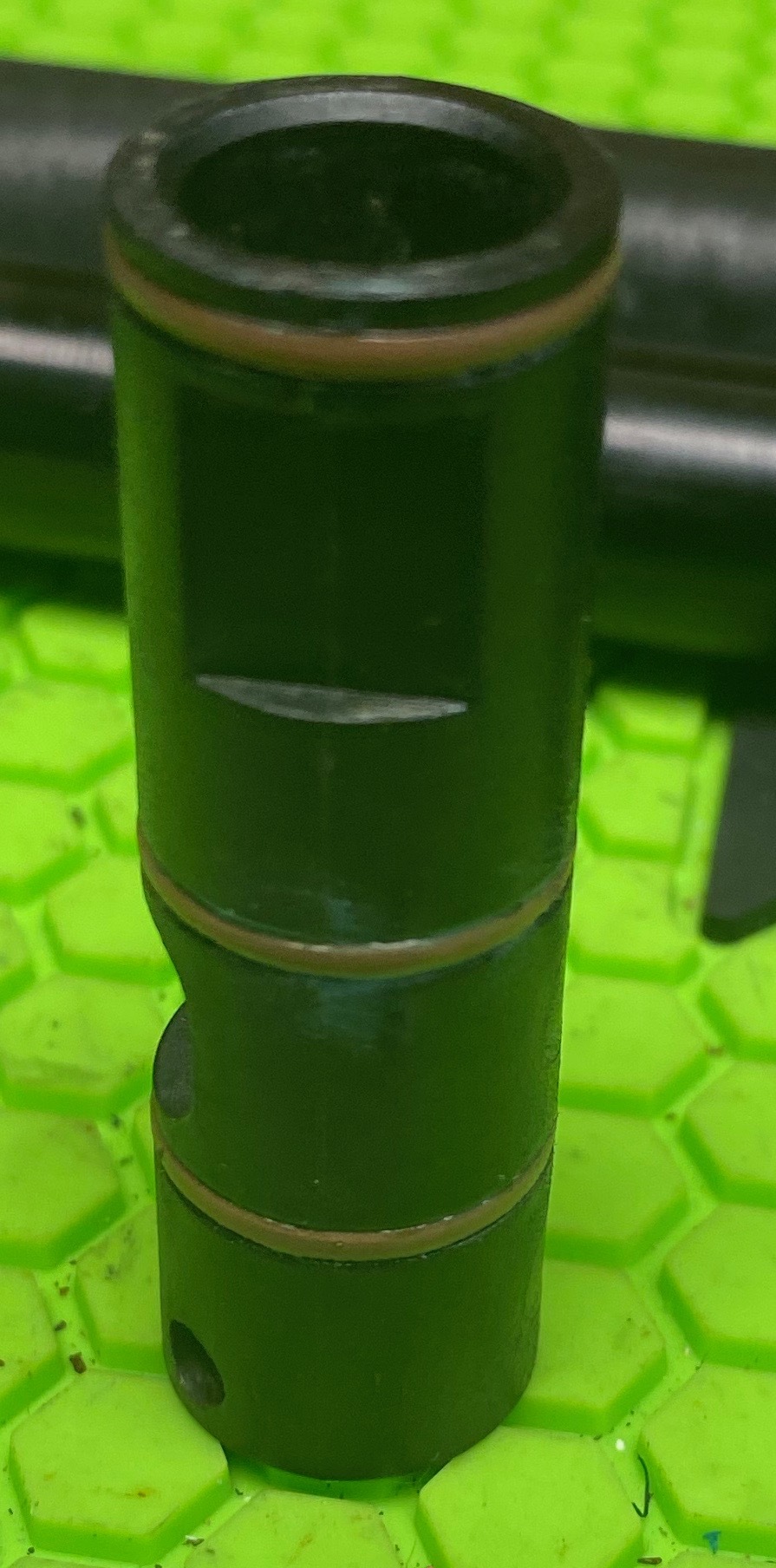

      So the bolt itself has 3 o-rings and a large opening to handle the gas to propel the paintball ball. There is a hole towards the back of the bolt (bottom in the picture) for the pump rod to sit.

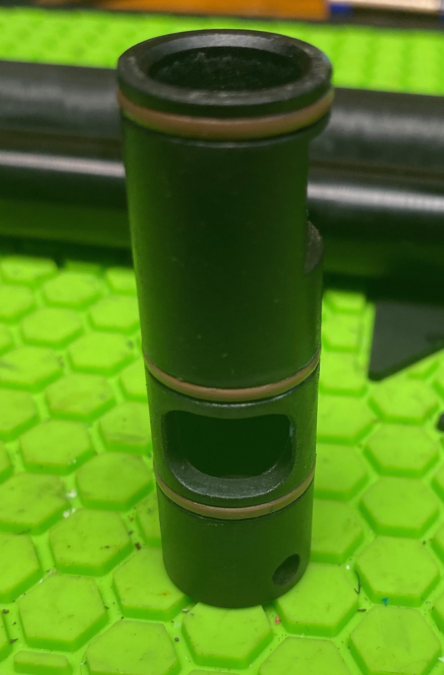

      There is also a flat spot on the bolt which is likely meant as a cut-out for the wire detent?! Taking a wild guess here.

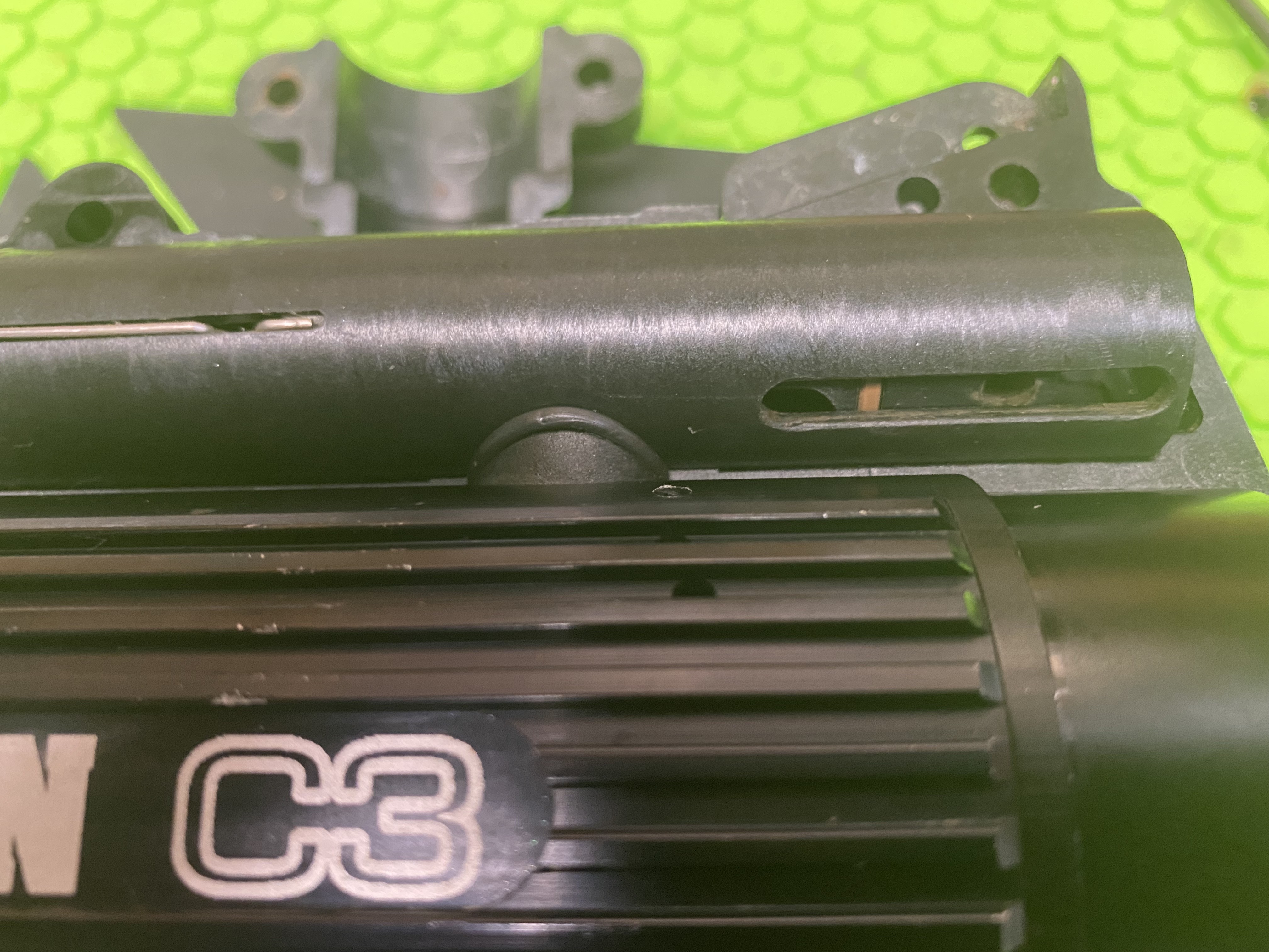

        • 4521
        #19
        So here is the barrel, bolt and PITA o-ring properly installed. Do this by lifting the combustion chamber out of the clamshell, aline the barrel and the o-ring and lower it down as a single piece. Otherwise the damn o-ring will move. You can also see the hole in the bolt for the pump rod. If the bolt turned during this process use a pick to turn it to the correct position.

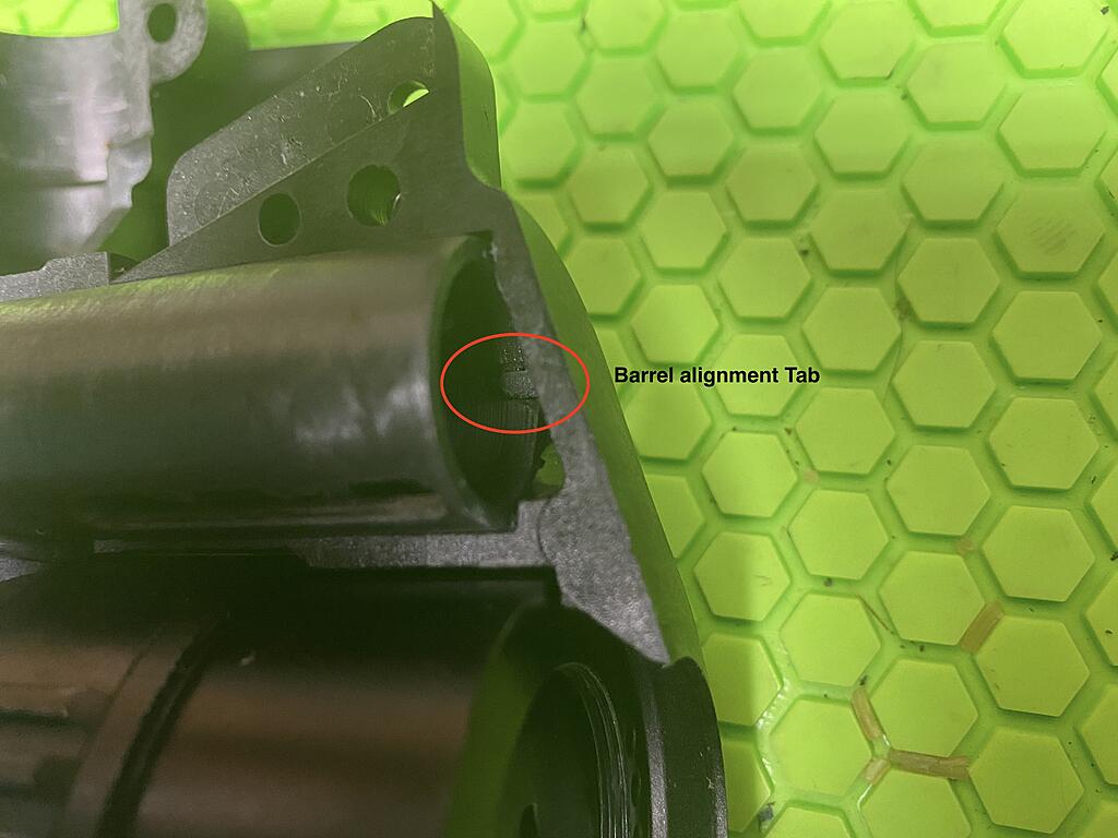

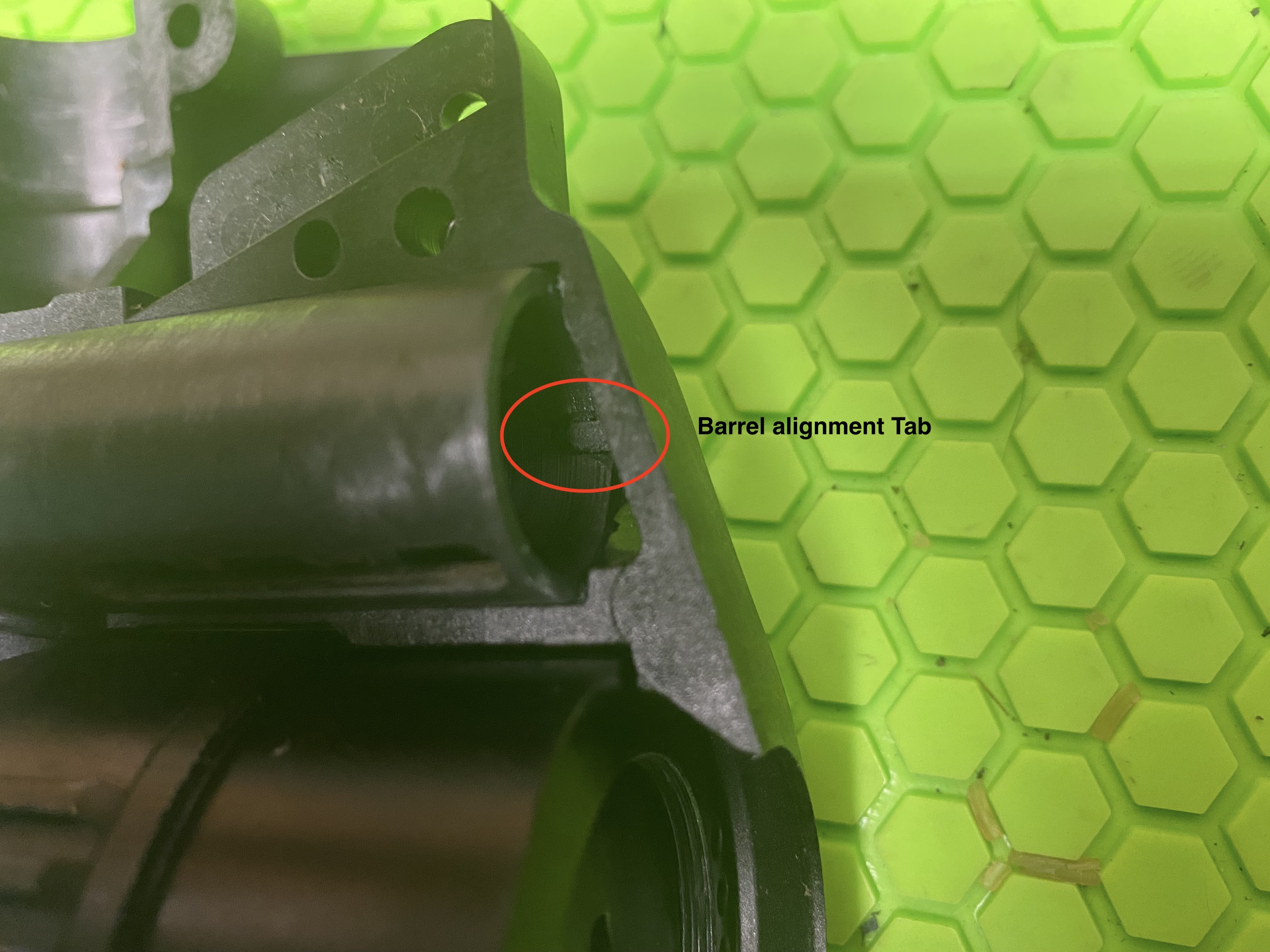

        Finally, make sure the barrel is properly aligned. In the clamshell frame there is a little solid tab that the barrel needs to sit in. It's hard to see in my photo, but if the barrel does not sit properly in this tab the clamshell will not go together properly and your o-ring will pop out again.

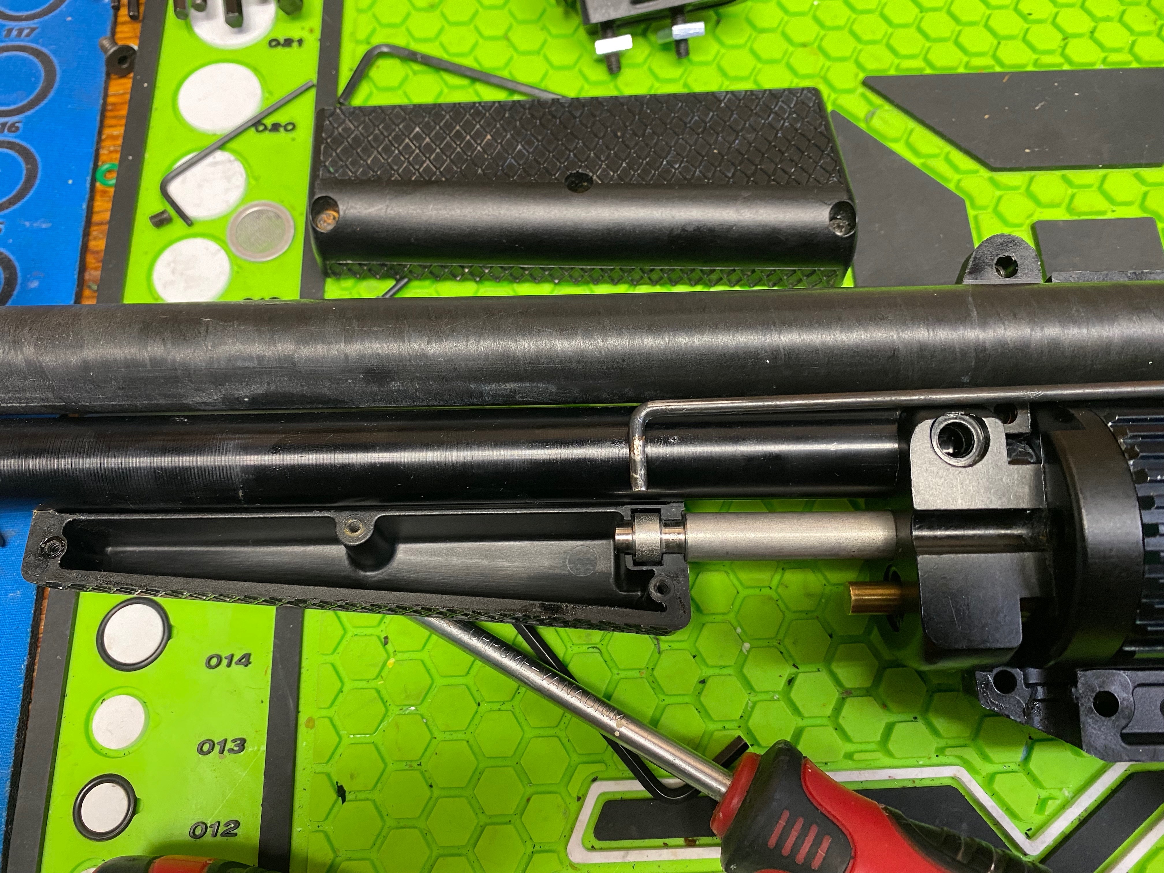

          With the back of the gun all dealt with we can move to the front again and reassemble the pump handle. The pump handle is held together with 3 screws that look to be the same fine screws as used in the cyclone feeders bottom plate. As you can see in the photo there's a recess where the silver main pump rod connects. The connect for the pump rod itself is only on the other section of the pump handle.

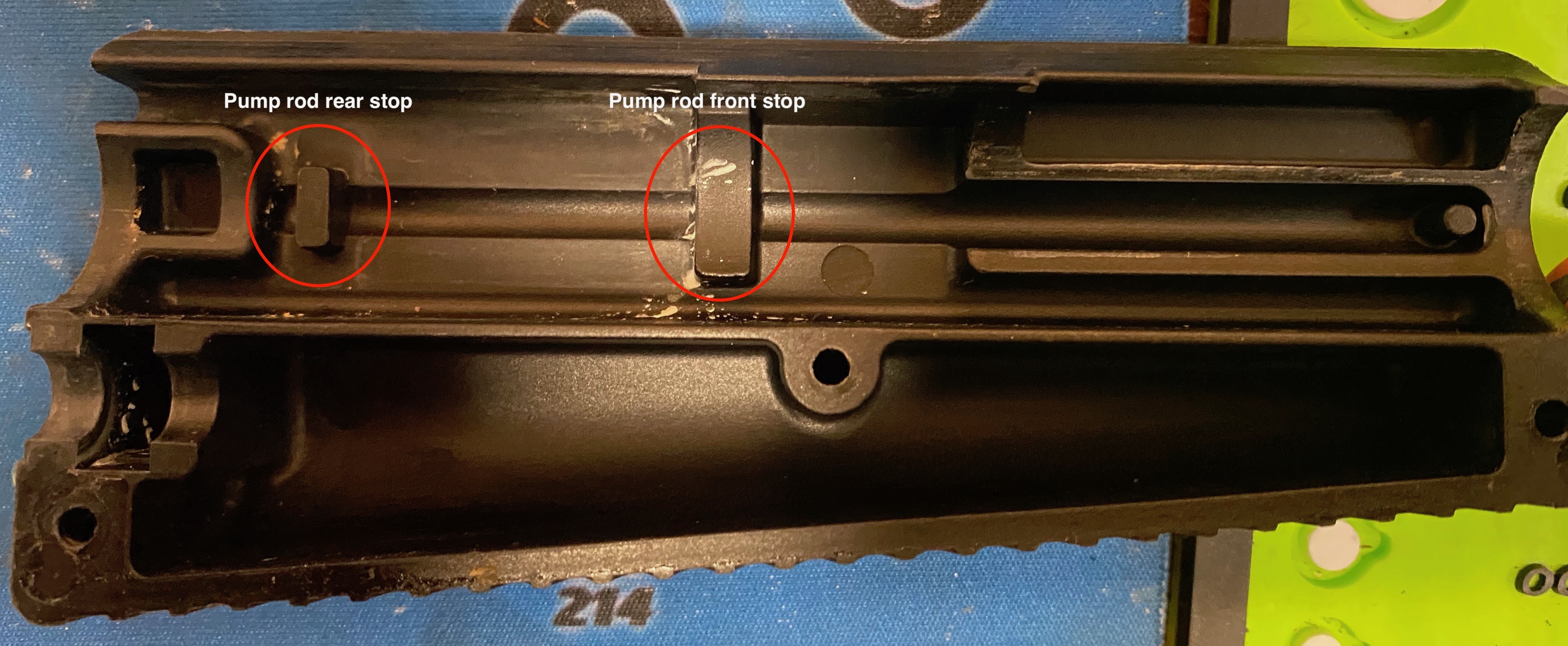

          Here's the inside of the other half of the pump handle. The pump rod just sits loosely between the two pump stops.

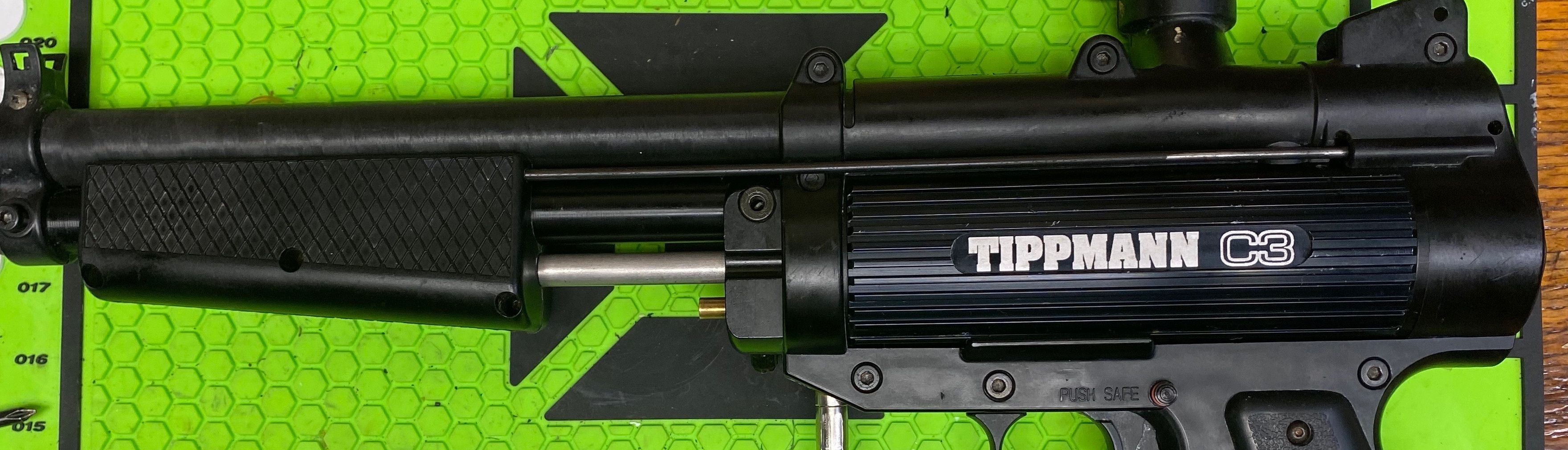

          This now shows the entire pump assembly in its final form. The butt end of the pump rod is what actually contacts the copper gas valve to add the propane into the ignition chamber, so you must pull the pump handle back hard enough to depress the spring or there won't be any/enough combustable fuel.

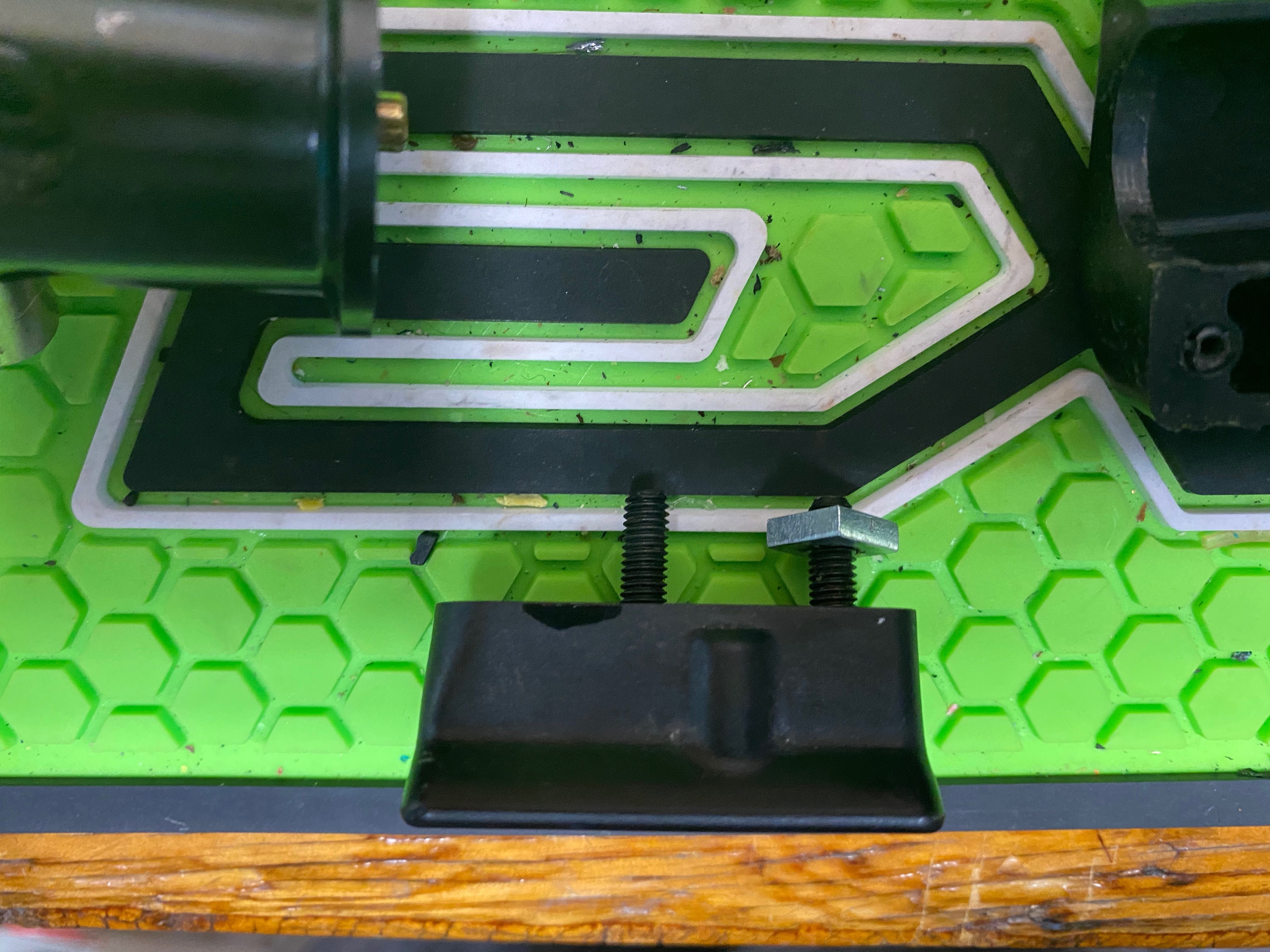

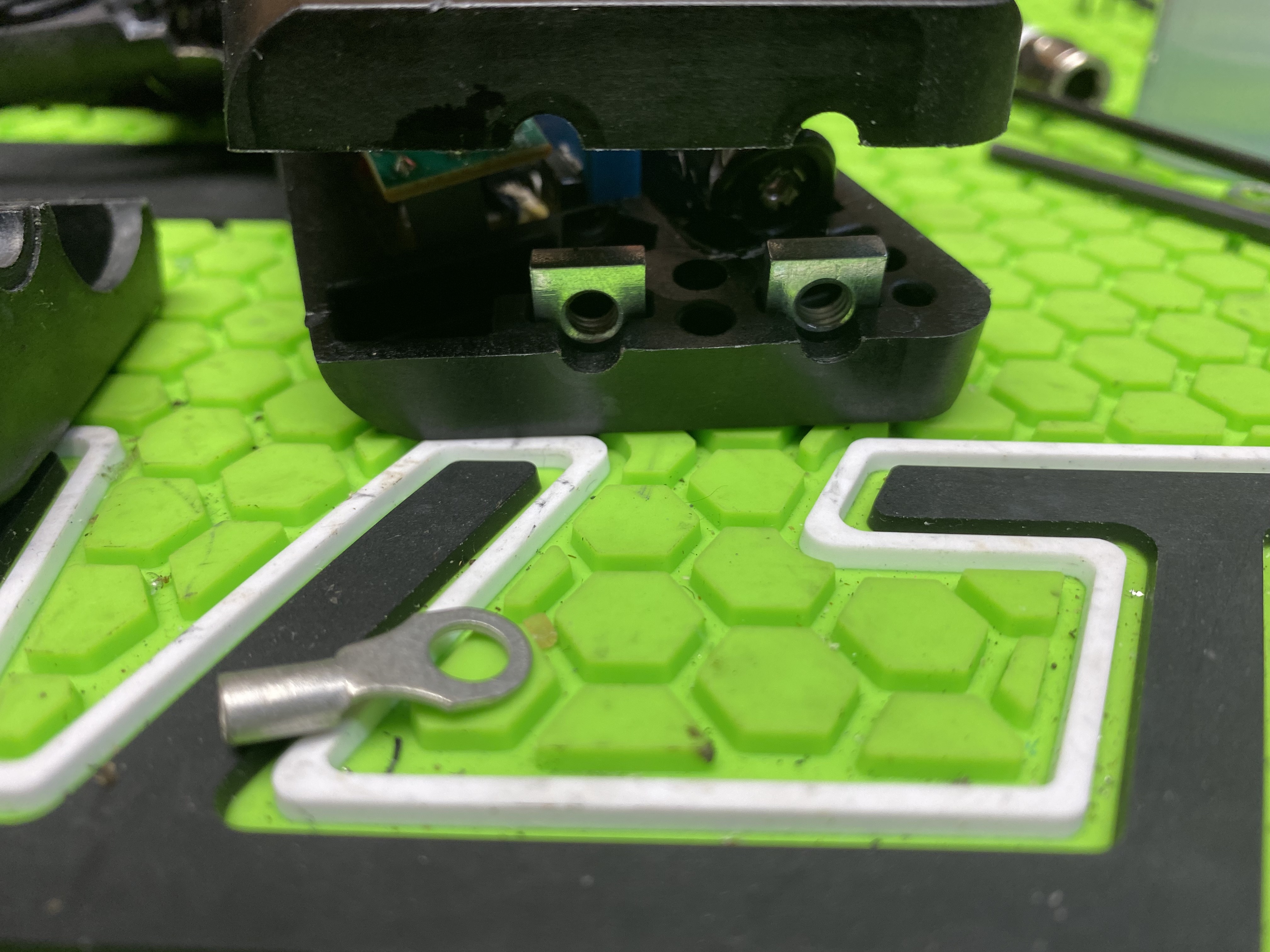

            Finally, a quick look at the annoying bottom line assembly. It uses the typical square nuts sitting in a plastic cutout method which I dislike. It took a little jiggling of the circuit boards and things to get the clamshell in the proper place and these nuts were a pain as they kept moving.
            This little bracket then screws into these nuts, and the main "ASA" screws into this bracket:

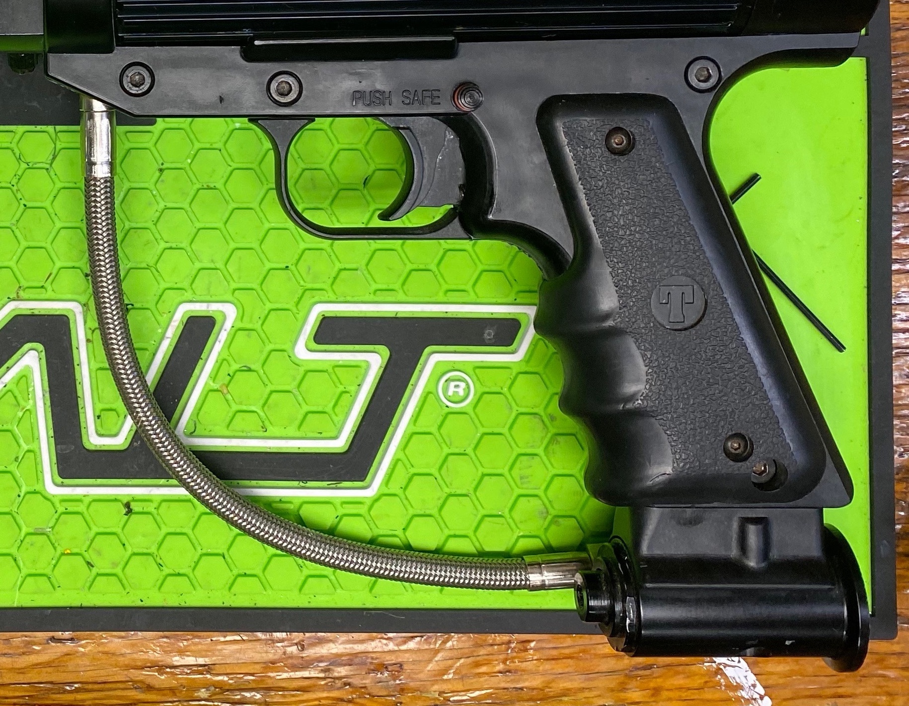

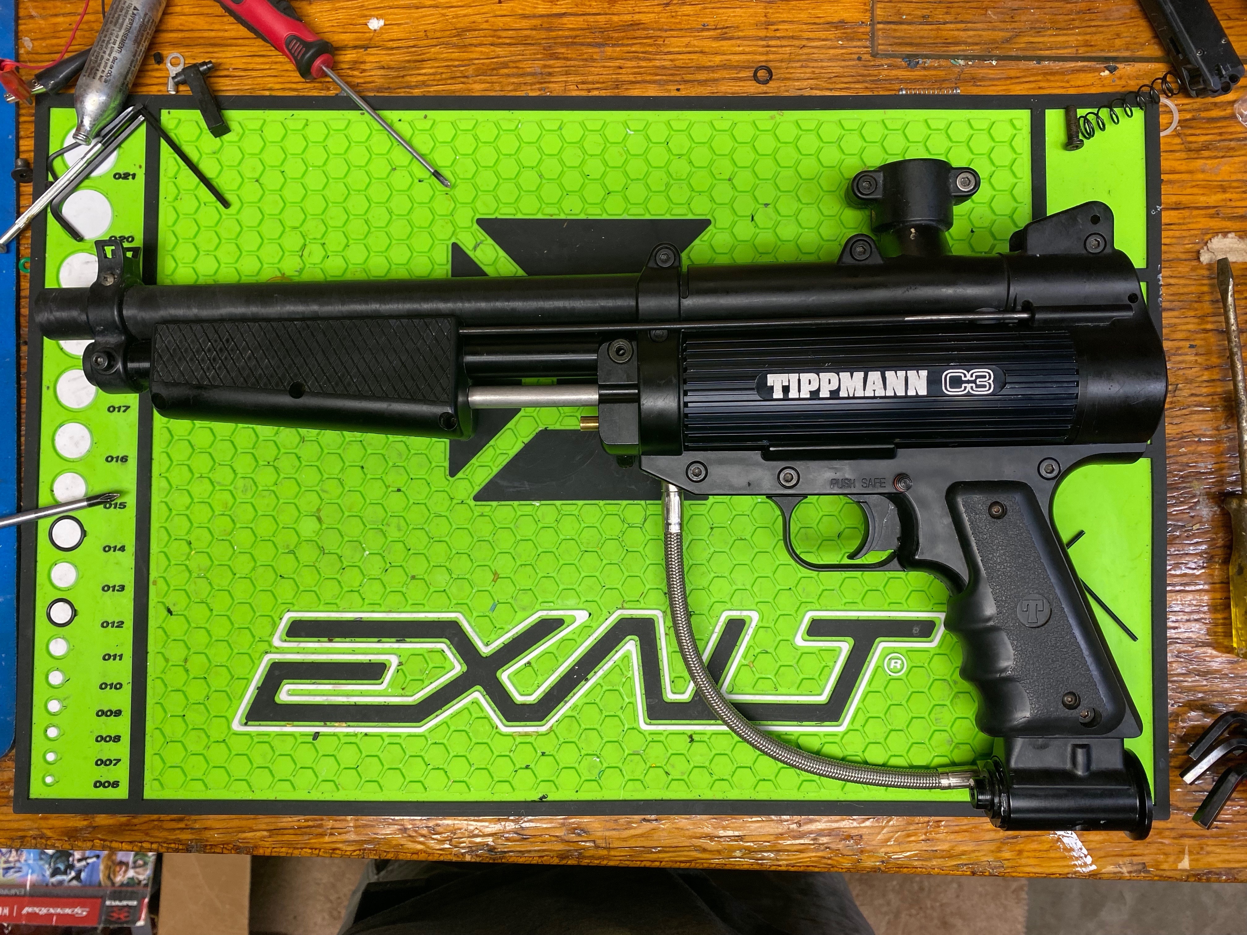

            And in the end the bottom line looks like this when properly assembled:
            And there you have it. All back to together!
