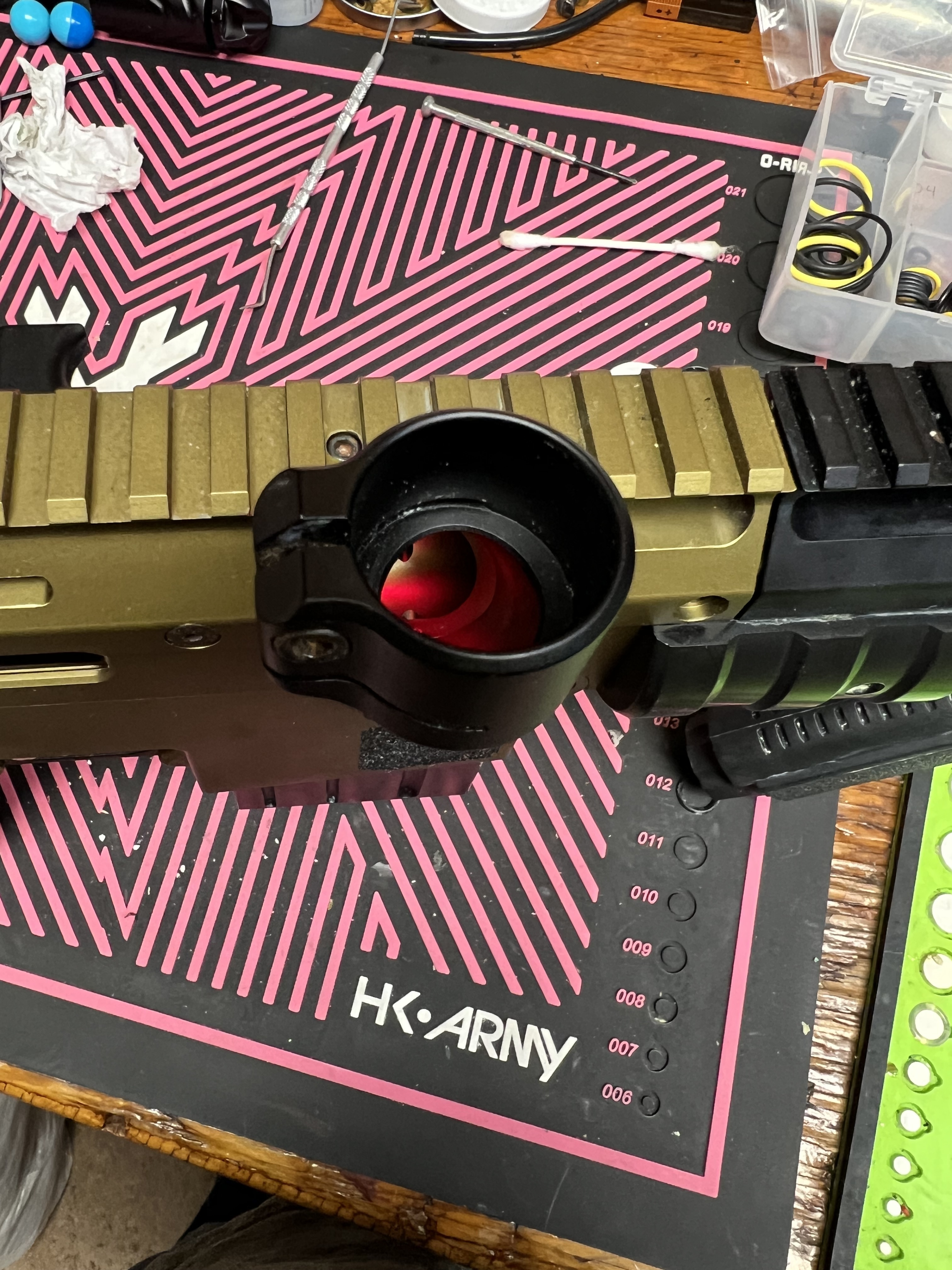

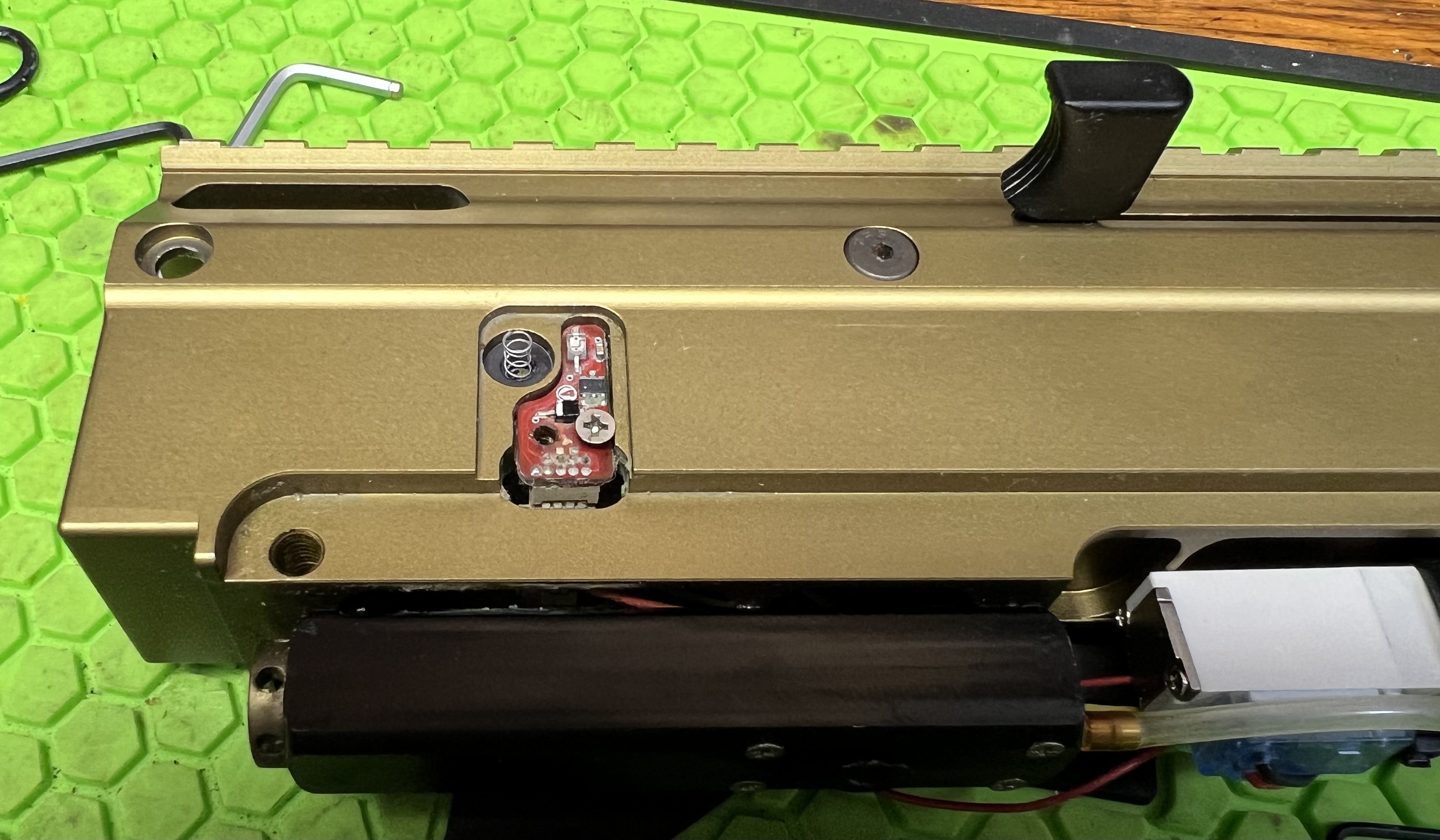

            So moving on to the eyes and detents. As it turns out this has upgraded 4C laser eyes!
            Click image for larger version  Name:	IMG_4238.jpg Views:	0 Size:	1.29 MB ID:	724888
            In searching for a replacement bolt tip I saw the eye upgrades and the red board is apparently laser eye. And this is confirmed with a red glow when the trigger is pulled.
            Click image for larger version  Name:	IMG_4290.jpg Views:	0 Size:	2.14 MB ID:	724889
            Checking out the detent, this has a metal detent that looks like it was beat to hell. In test firing it seemed to work well at least.
            Click image for larger version  Name:	IMG_4237.jpg Views:	0 Size:	158.4 KB ID:	724886

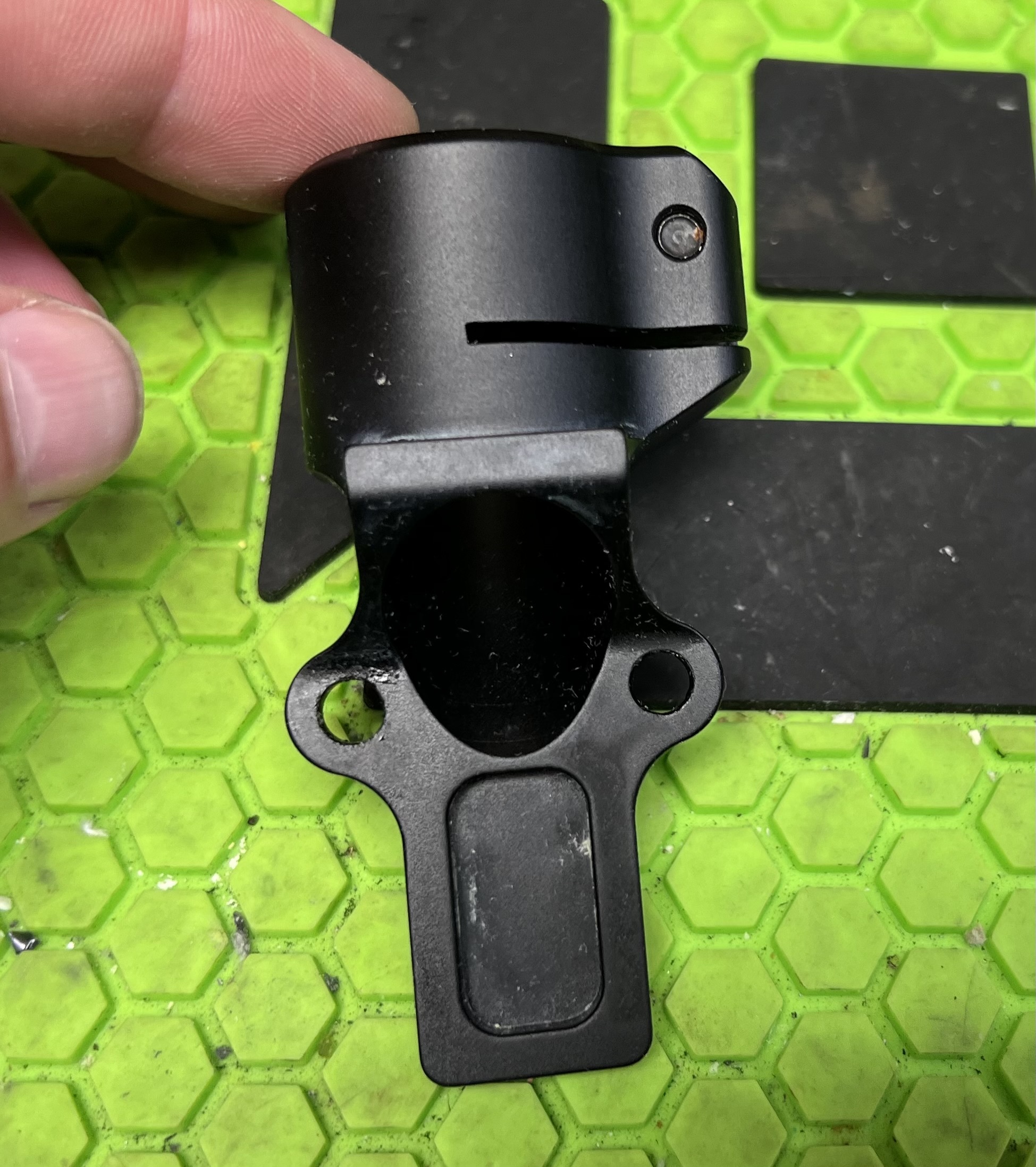

            And the on the opposite side of the body the offset feedneck covers the eyes and has to detent. This is the offset feedneck:
            Click image for larger version  Name:	IMG_4239.jpg Views:	0 Size:	897.8 KB ID:	724887

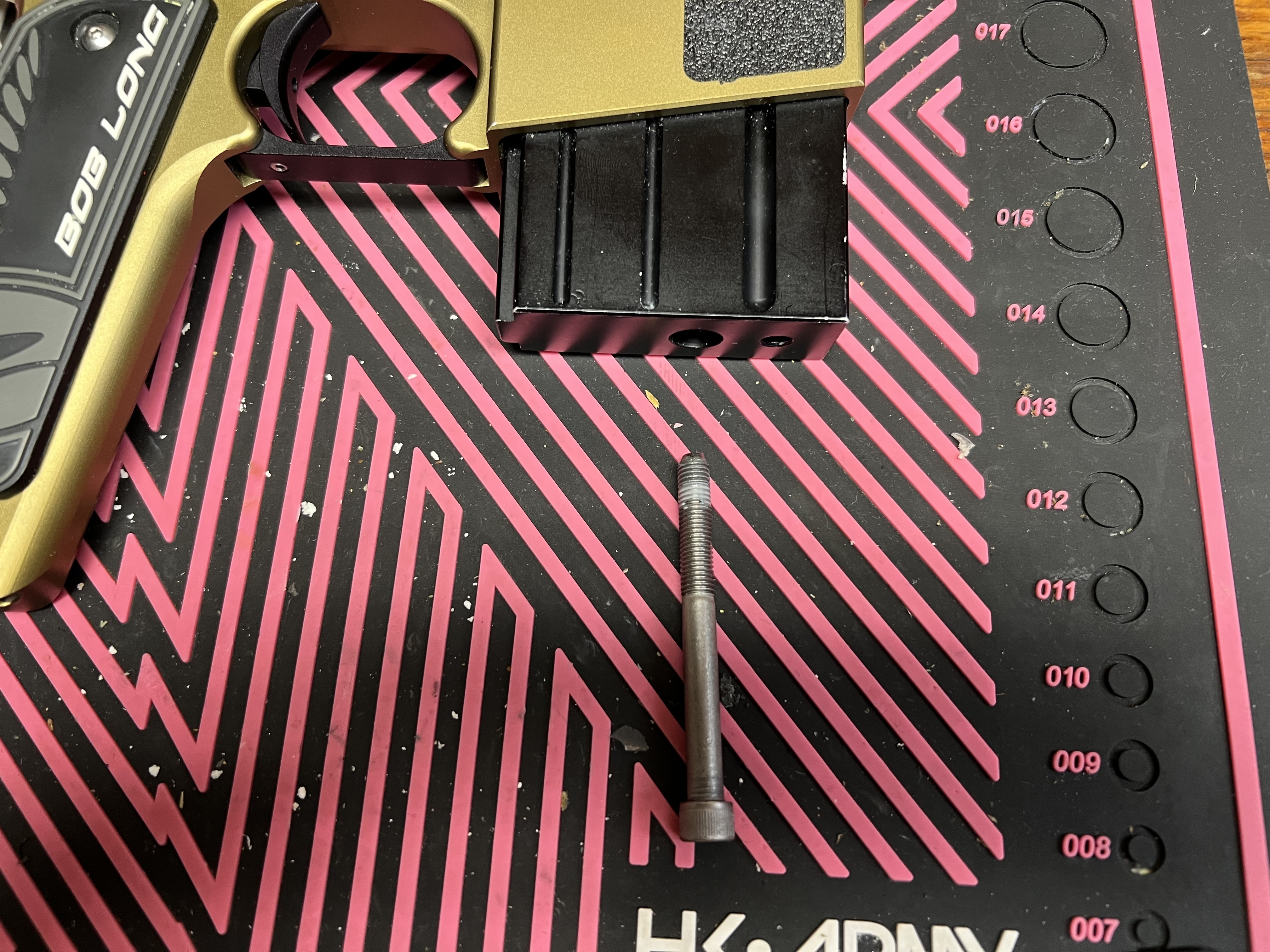

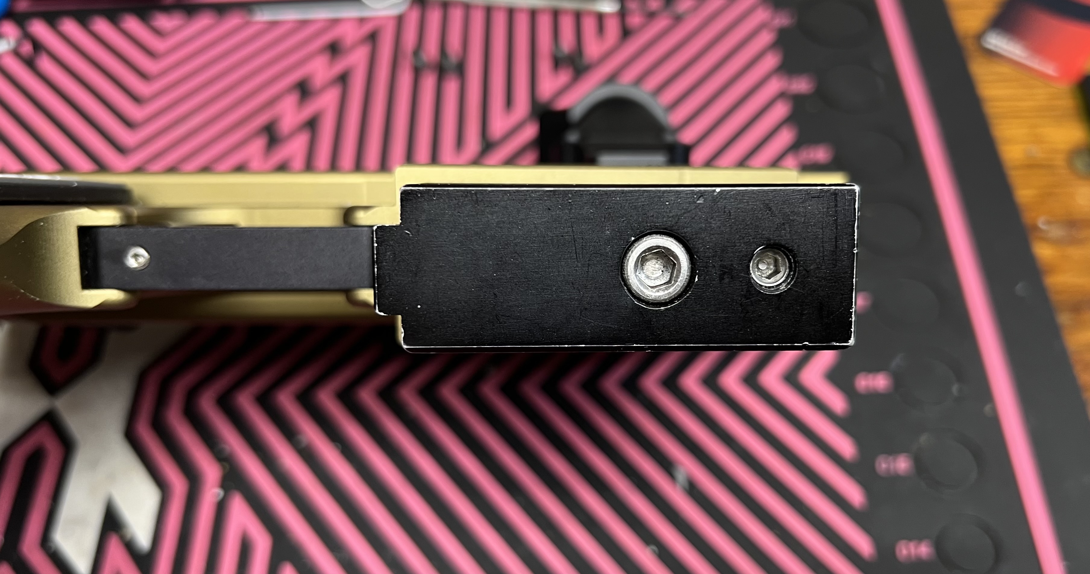

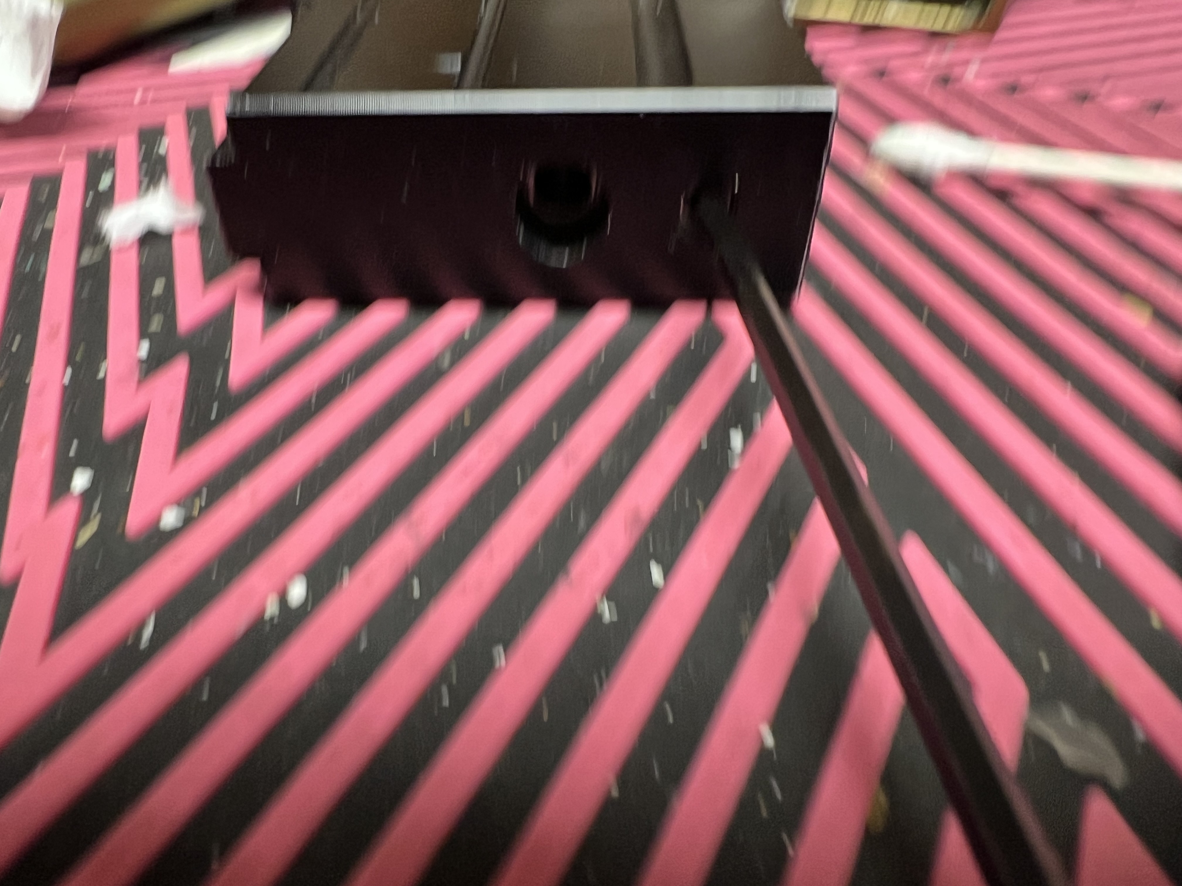

              So the HPR is located in the false mag. You remove the large bolt at the bottom that secures the mag to the body.
ID:	724896 Click image for larger version

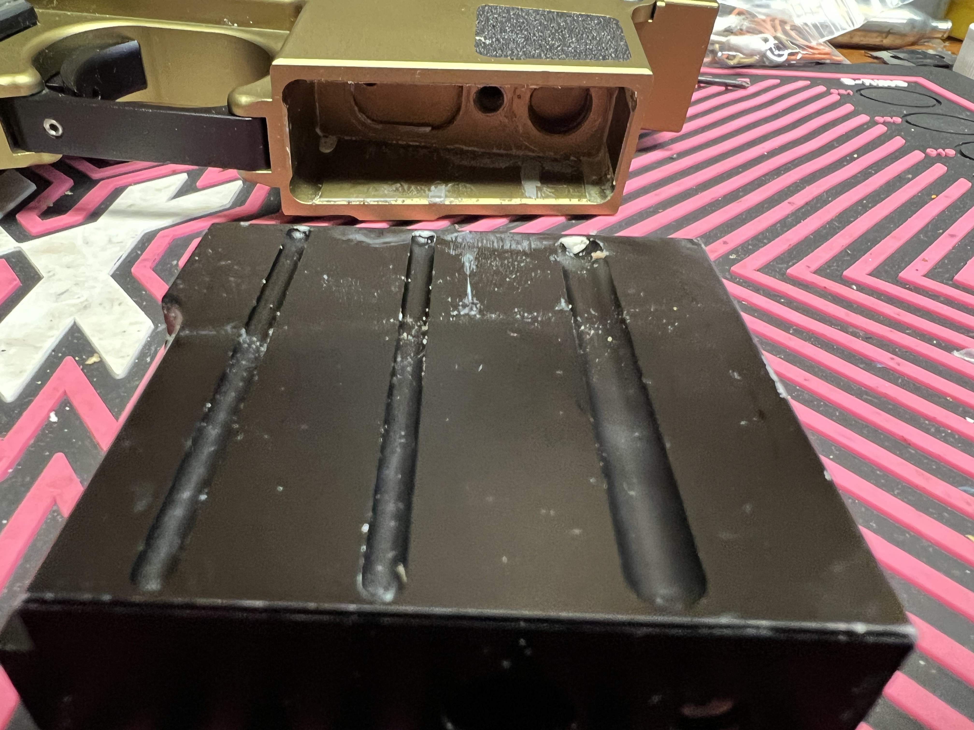

              With the bolt removed you should be able to just pull the reg out, away from the body. Years of excess live made this stick pretty good, but after some positive encouragement it came out:

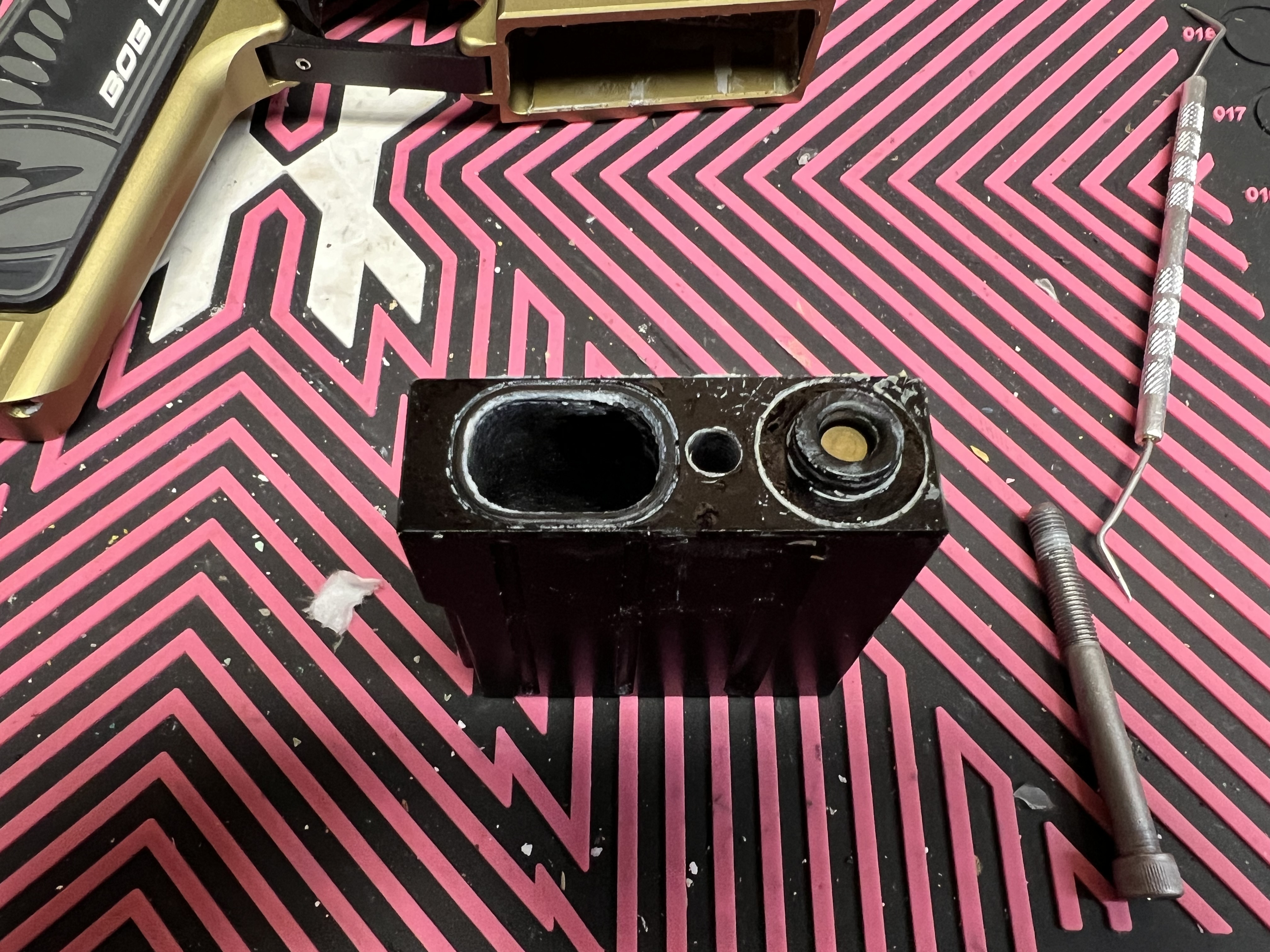

              And here is what the top of the reg looks like, where it connects to the body:

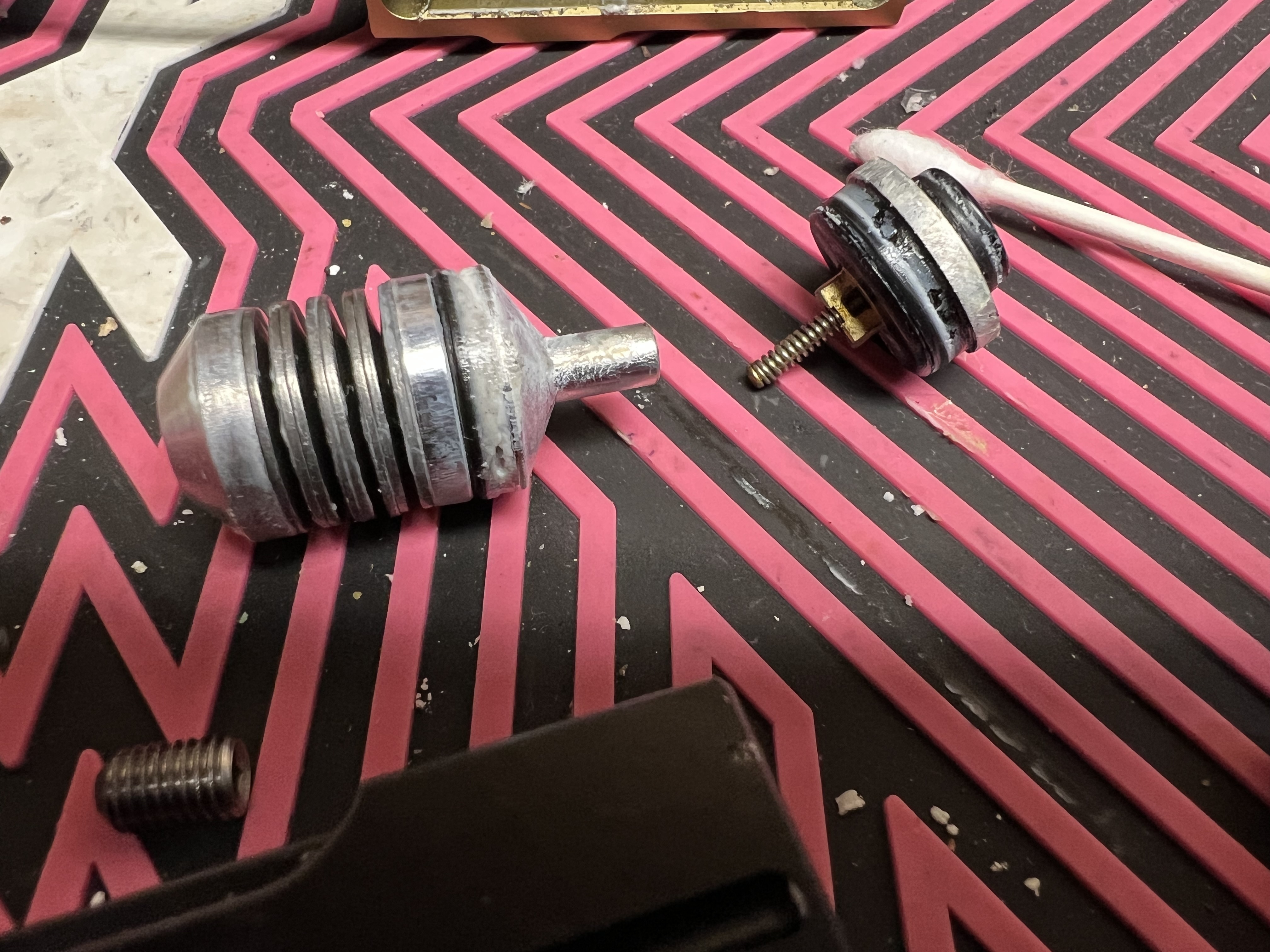

                Now time to clean up all the excess lube and rebuild the HPR.
                First step remove the HPR adjustment screw:

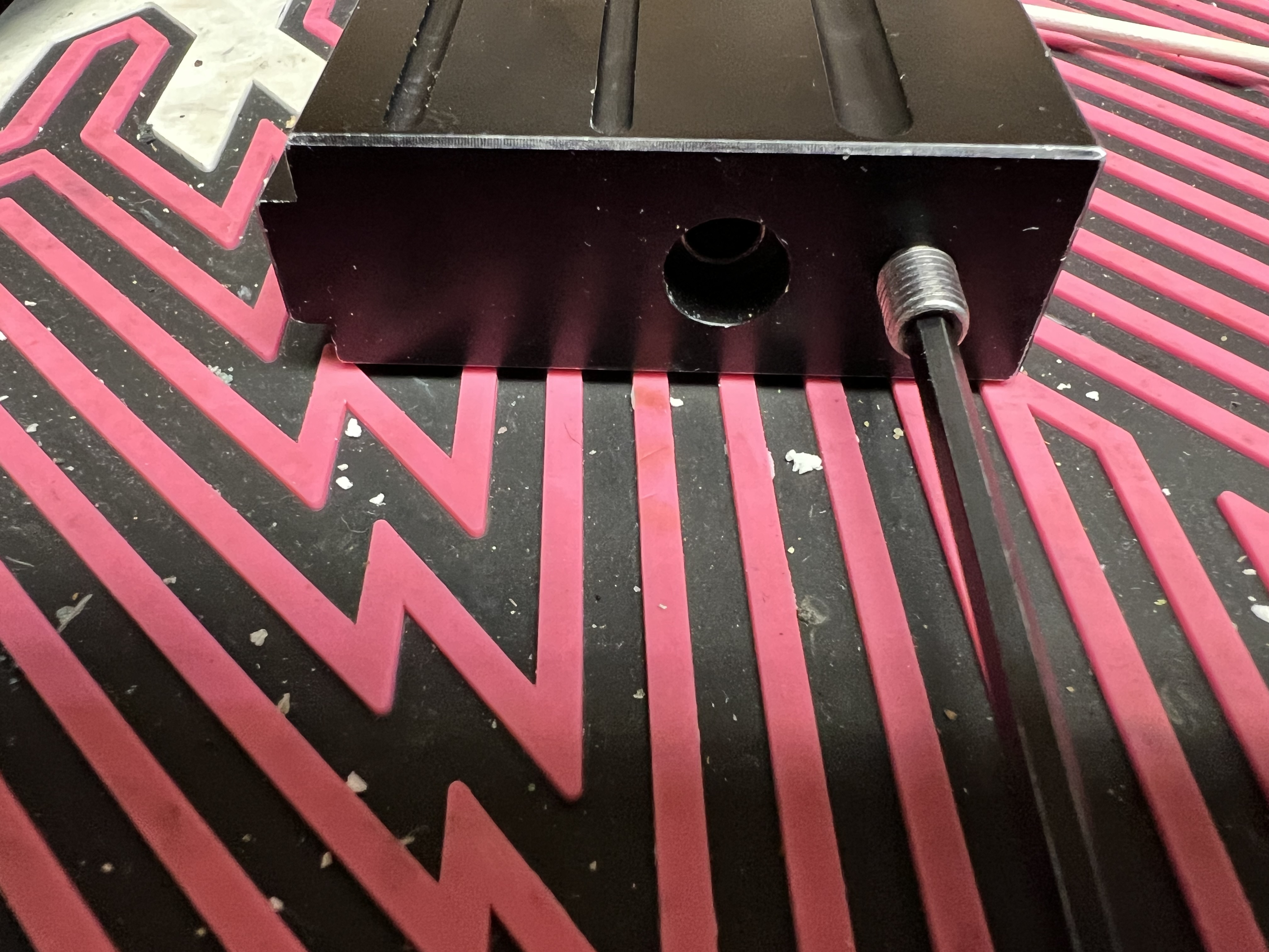

                And the use the Allen key push the reg internals out.
                A quick cleaning and replacing some o-rings and show be good to go.
